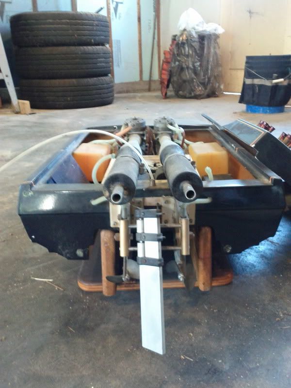

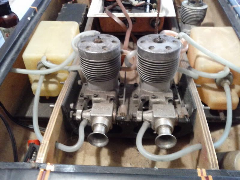

Pics opf fuel and coolingh lines for reference

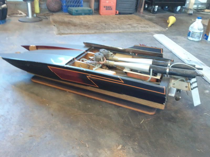

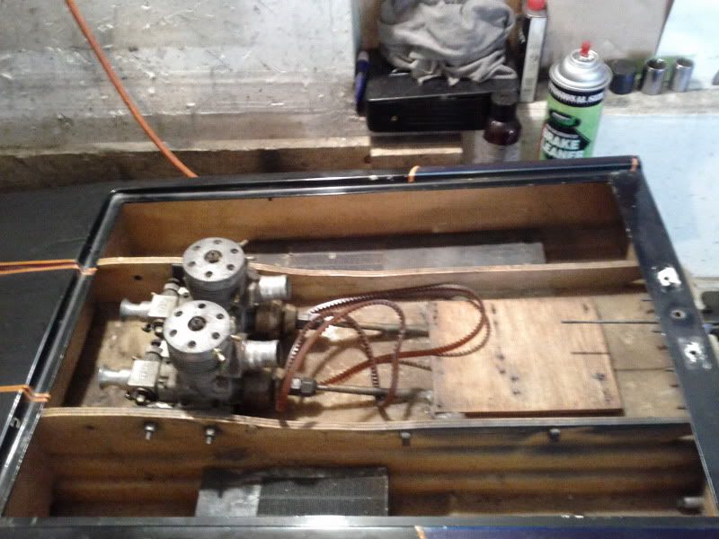

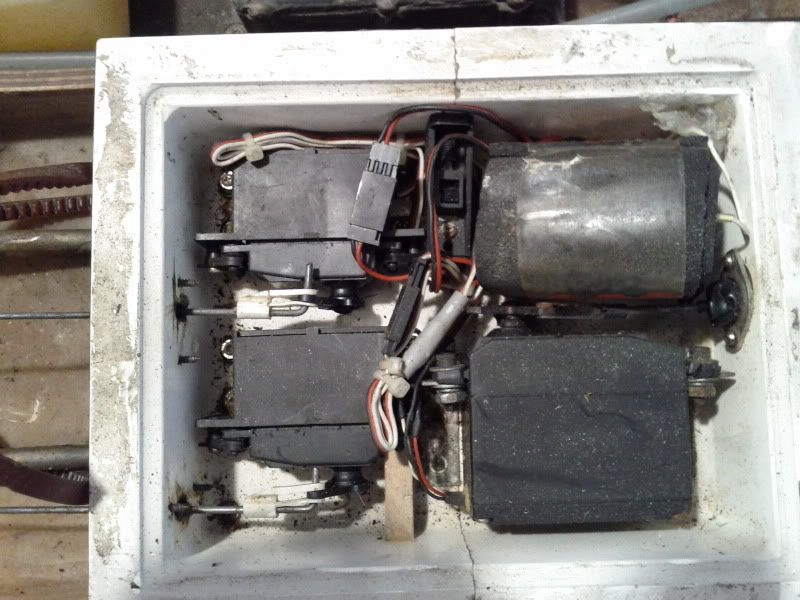

Radio box removed and all components taken out (Radio will likely be upgraded to something modern. The tech has come so far and this thing has been jumped out of a lake at about 60-70 MPH due to lost signal back in the day... It will kill someone if it hits them), servos are fine... Super high speed throttle, high speed hi TQ rudder:
And so it begins, teardown, radio and fuel shit out... Ill pull the motors out and the transom shit tonight or during the week so I can get busy stripping the hull and repairing anything that needs it.
Stay tuned.  There will be rape. Serrious 28000 RPM FURIOUS rape.
Ill update as I go through refurbing shit if anyone is into this shit and gives a crap... Probably will anyways...
Ill post vids once the motors have been completely disassembled, cleaned lubed, reassembled and polished up. Probably run them both in the mounts in a vice with a fish tank pump circing water like we used to do on the bench LOL....
Hope to have it dune in a month or so. Should only need a couple hundred bucks thrown at it, maybe 3 and he gave me enough corvette shit this weekend that I have on CL to more than pay for it  :O).
Trying to get everything out so I can start prepping the hull and fixing a couple things to get it ready for paint. Black again, with a big Clay smith woodpecker lpainted on the rear left corner of the boat that wraps around all sides to look like its 3D kindof, reaching to about where the hatch ends up front... ALA my valvecover  :O).

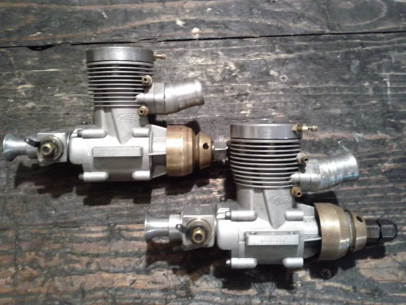

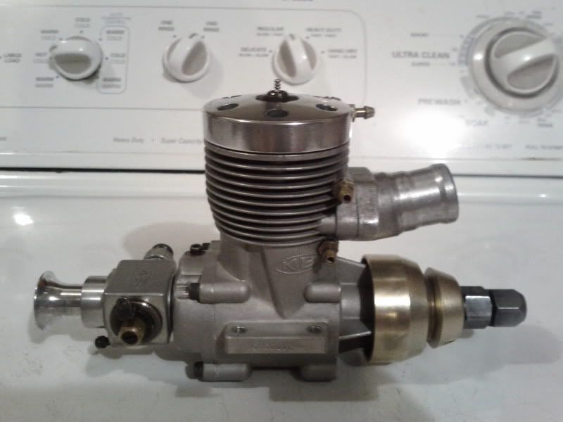

Motors are out
Motor mount is out... Motors are clean externally.. (looks like all aluminum and brass is going to clean up very nicely)
Brake cleaned the shit out of them, WDed the ex port and carb, barells broike free, it puked a bunch of varnishy shit out of the motors and all moves nicely now. piston aproaching TDC is weird (glow plugs already out) went to take the heads off and see if something wierd is going on (as mentioned they were shaved) but 20 year old allens eat a dick. Heads shattered on 1 on each head to where im going to have to fuck with it more later to get the heads off and make sure all is good, so i loaded em up with WD and theyre just gonna sit till later.
Ill pull all the steering shit and drive cables/ props out of it tomorrow or next weekend. At that point the hull work can start, and I can get it ready for paint. All the injector stacks on the lid weremade by us. They are 7/16 tubing flared at the ends and epoxied at the base t the lid, painted red on the tops. It didnt havethat shit. 2 are missing so I will be making a couple replacements.. Im done for today. Made way more progress than I planned.
REALLLy want to TRY and keep the time correct motors in it. They were almost new when it was put away  (20 years ago) lol. I thik it will all work out. I dont think its the case bearings, I think somethings up with the rotary disk for thew intake. Cant tell till the heads off... I COULD take off the intakes, but Ill mess weith it more during the week, and next wekend if I dont have my fuckin gears for the Accord yet.

The motors have been completely dissasembled at this point. They are MINTY, pistons and sleeves included. 1 motor looks brand new. Makes sense, probably is as I have an extra that has a hammered sleeve he had laying around that I dug up too... BUt Ive completely gone through the motors. They are good to go. Weird thing is 1 has a .002 button shim and one has a .005. Going to order a couple new .005s, couple carb gaskets and orings, and 2 new water jackets since they are super cheap. .
You effectively "time" the motors via shimming and fuel by how the fuel burns and compression, but both should be the same. MAkes sense that 1 had a bit of pitting on the head button from detonating... Ill make them both the same and it will be dialed. I cant believe how good the motors are for sitting so long. They are flawless inside.

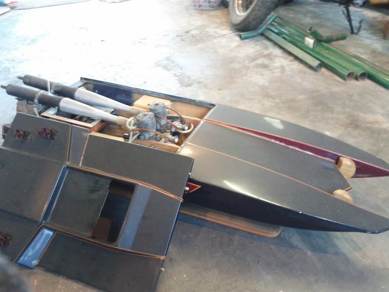

Boat is GUTTED, will be starting to strip it this weekend and get it to my Brother in law for basecoat of paint and to get the motormount powdercoated.
Shes coming along.
small Insomniac update:
tore down,
cleaned up
douched out
head tolerances checked to verify shim is right
assembly lubed
new glow plug
rebuilding, needed 1 part scavenged from the blown motor I have, and had to rob 2 minor things from the other runner so I have to order a few things for the other motor but its cool as i want to order a couple extra tings anyways)
Aluminum all polished up, wont have to buy new jackets as I hit them with 600 nthen 800 then blue magic and they turned out beautifully. and sitting on my dresser waiting. Ill order the parts to finish the other motor tomorrow. fiure gnext week both motors will be ready, will have the drives apart to see what I need there, and the hull should be all sanded and done this weekend ready for paint...
Going to strip, polish and paint the pipes tomorrow
Turned out pretty fucking sweet for a 25 year old motor. Looks fucking new IRL. Levi always did admire my make shit shiny skills LOL

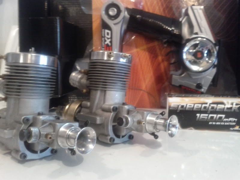

DOUBLE VISION:

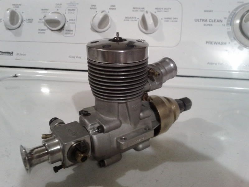

Motor number 2 taken apart, cleaned inspected, lubed and shined up. Both are ready.

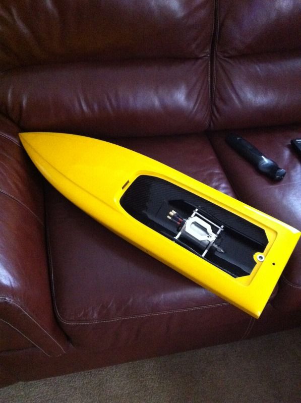

New baller radio with optical tach, temp and speed reading  (Obvioulsy only be able to monitor 1 motr which sux as 2 would be SWEET for syncing/tuning the nitro motors).
New Battery pack for the Rx (Battery tech has come SO FAR)
Hull inside has been cleaned up, new hardware for hulls drive shit (stainless) bought... Now the shitty part that ill sandbag on... Stripping this fucker and getting the hull ready for paint. Dads all about it. He cant wait to get it running. When he heard I was at the hobby store yesterday, he told me to wait... bought a brush less boat a set of bigger Li batteries and all the shit I needed for the motors... The radio too LOL.
Pretty sure the boats going back to him LOL..... He lives on his 70 foot boat on Lake union anyways... Makes sense.  Super fun getting him involved in something both of us can fuck with. The Nitro boat is ALOT of work and takes 2 people to run believe it or not. Theres ALOT that has to happen to get them both running stable and the fucker in the water, No way 1 person can do it all.ESPECIALLY with the dramatic weather changes up here, hence him buying the brushless setup (Traxxas Spartan).
With the batteries and shit he bought for it it should do 60-70 and run for 40 minutes a charge LOL
