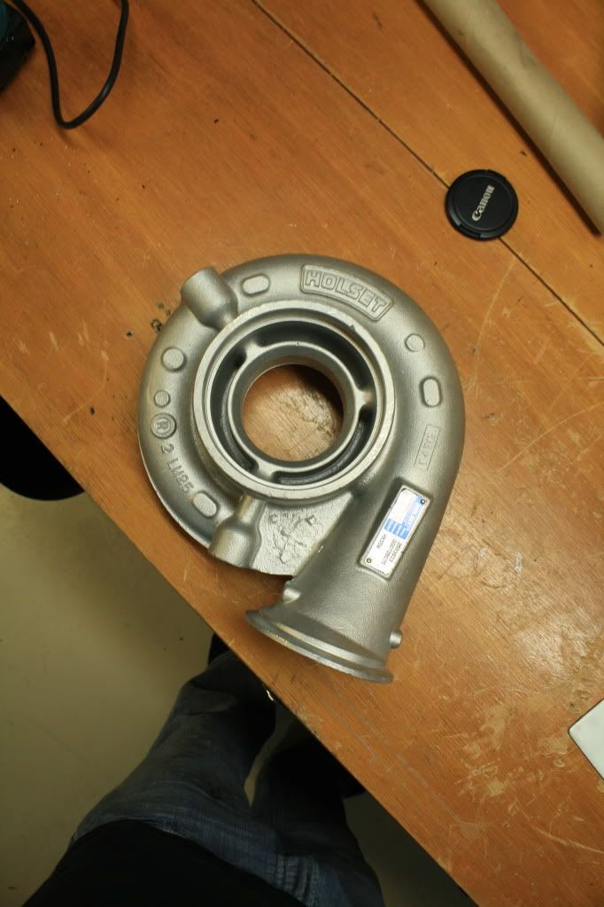

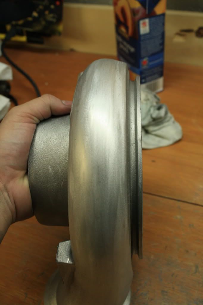

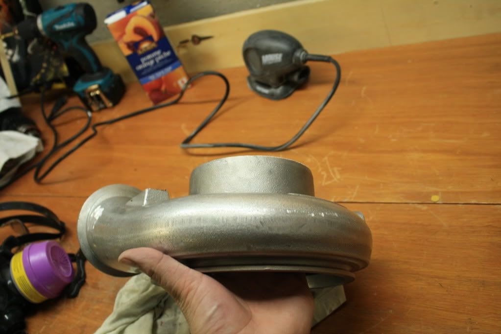

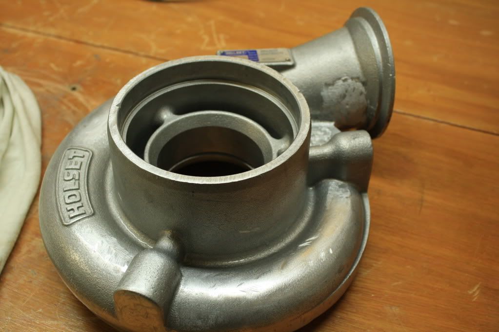

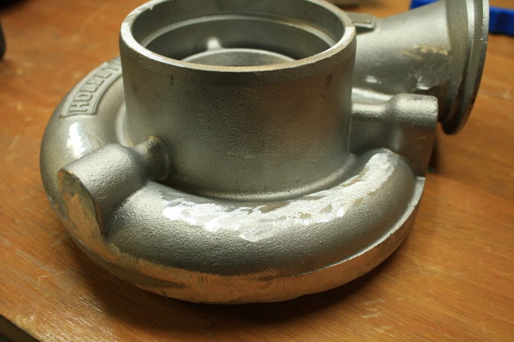

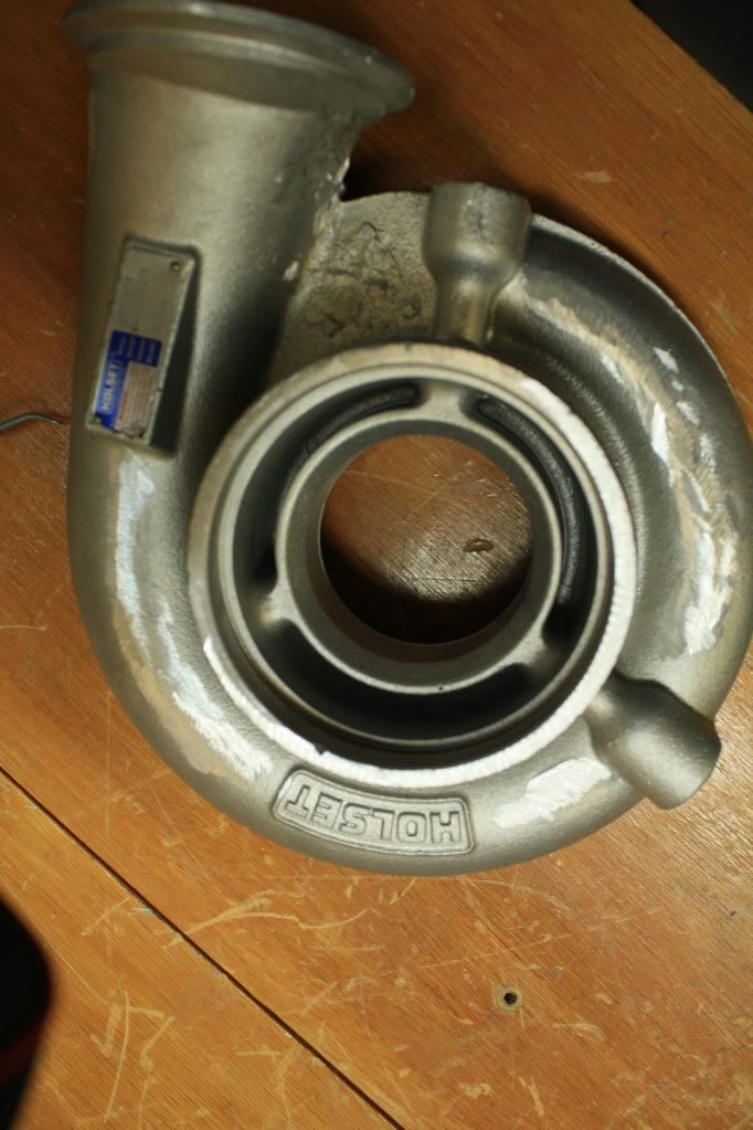

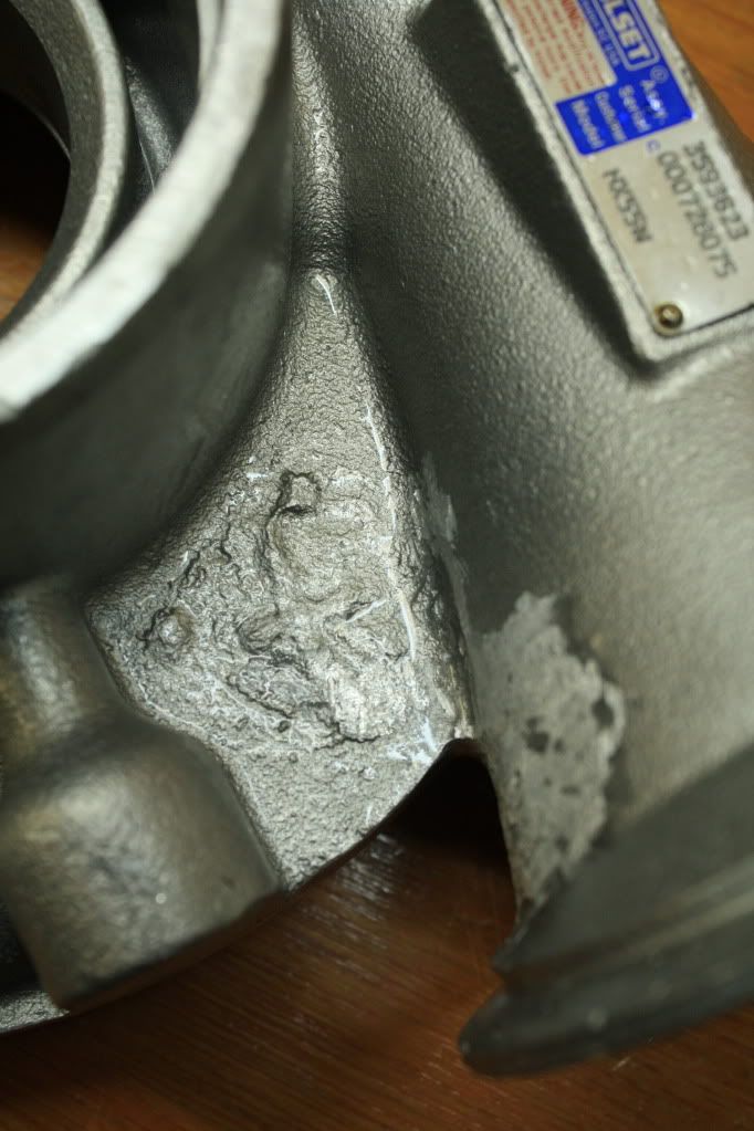

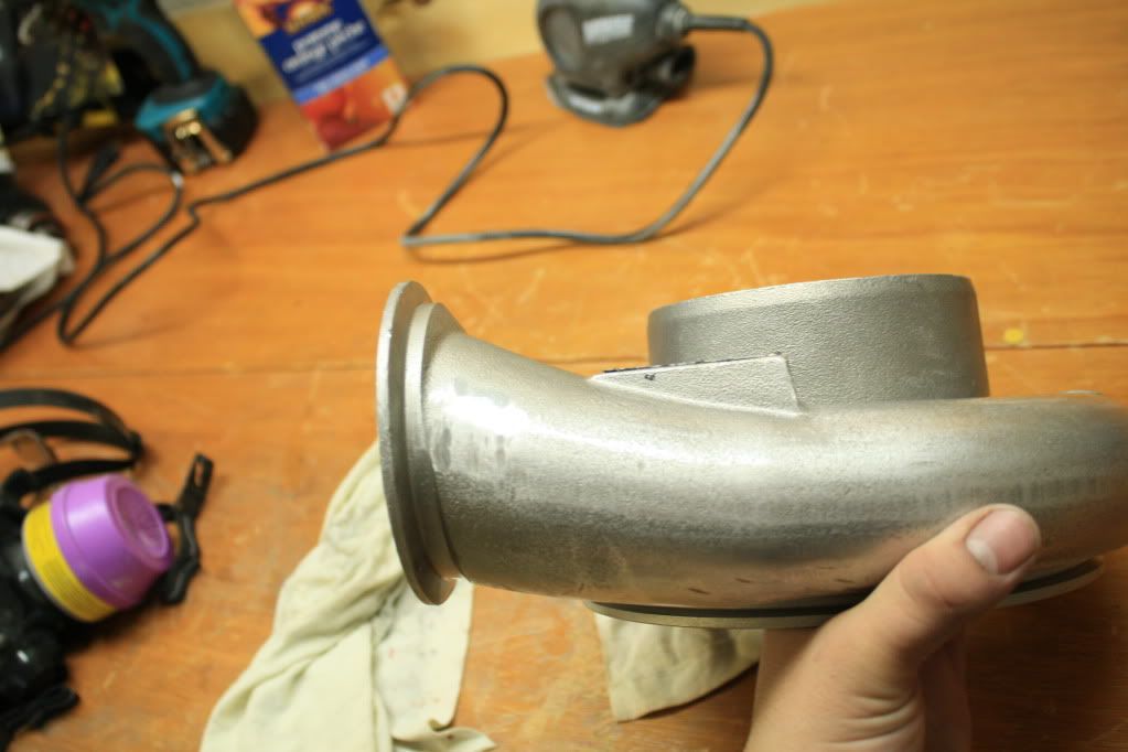

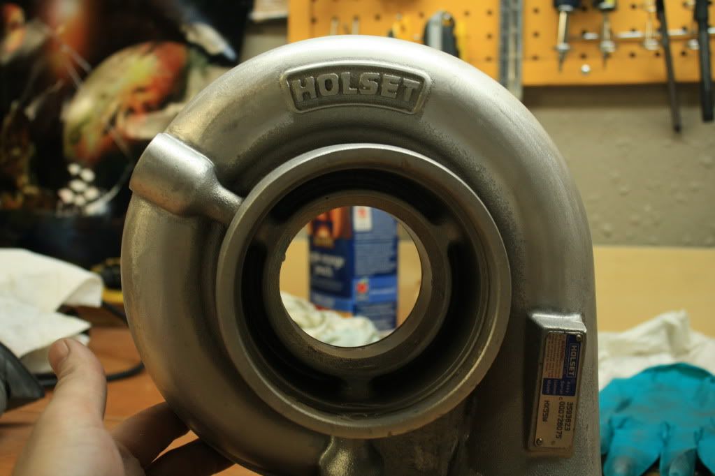

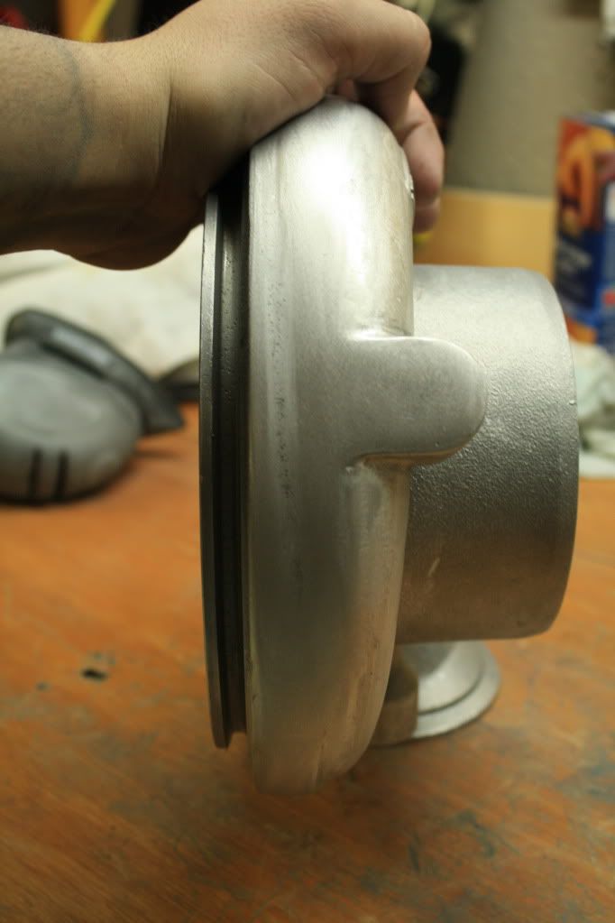

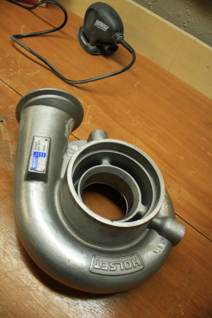

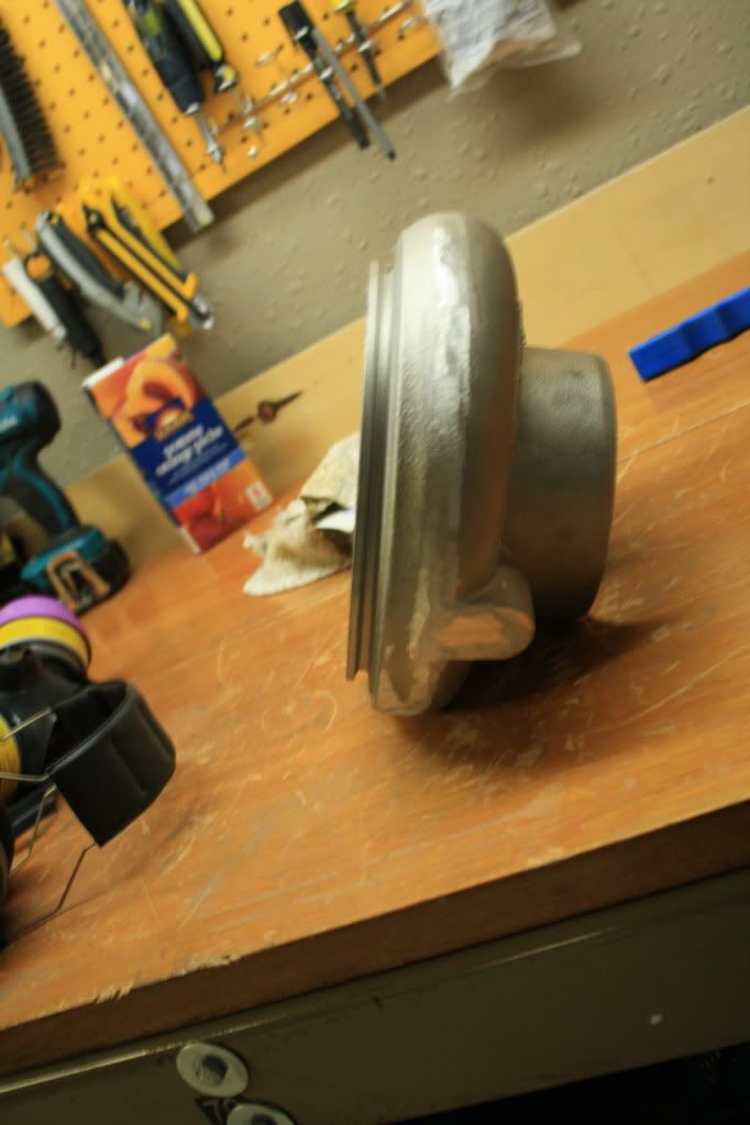

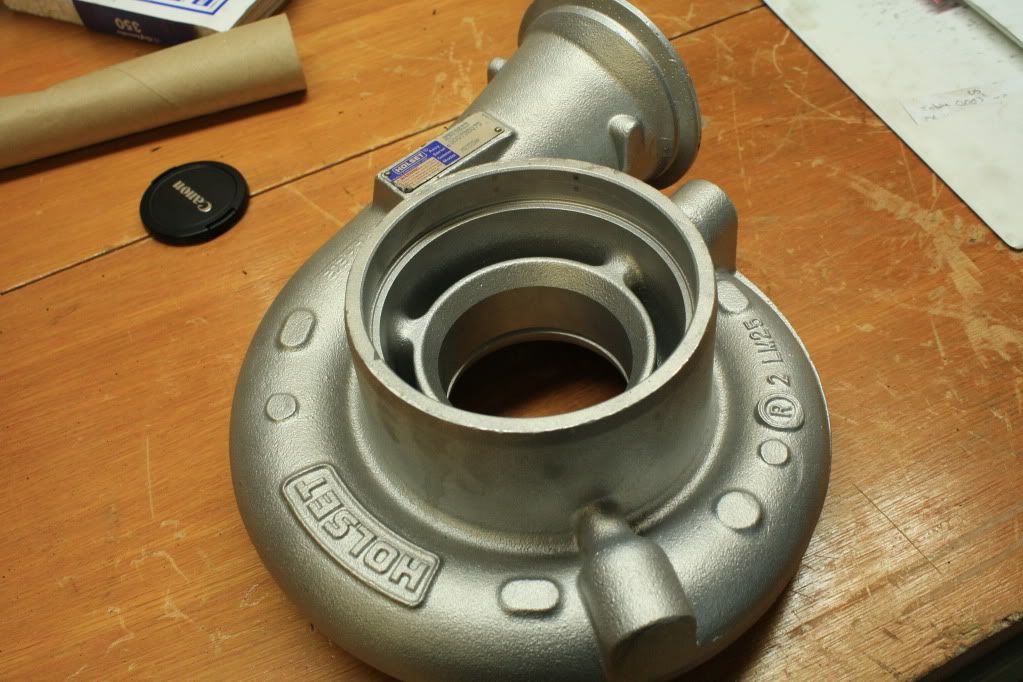

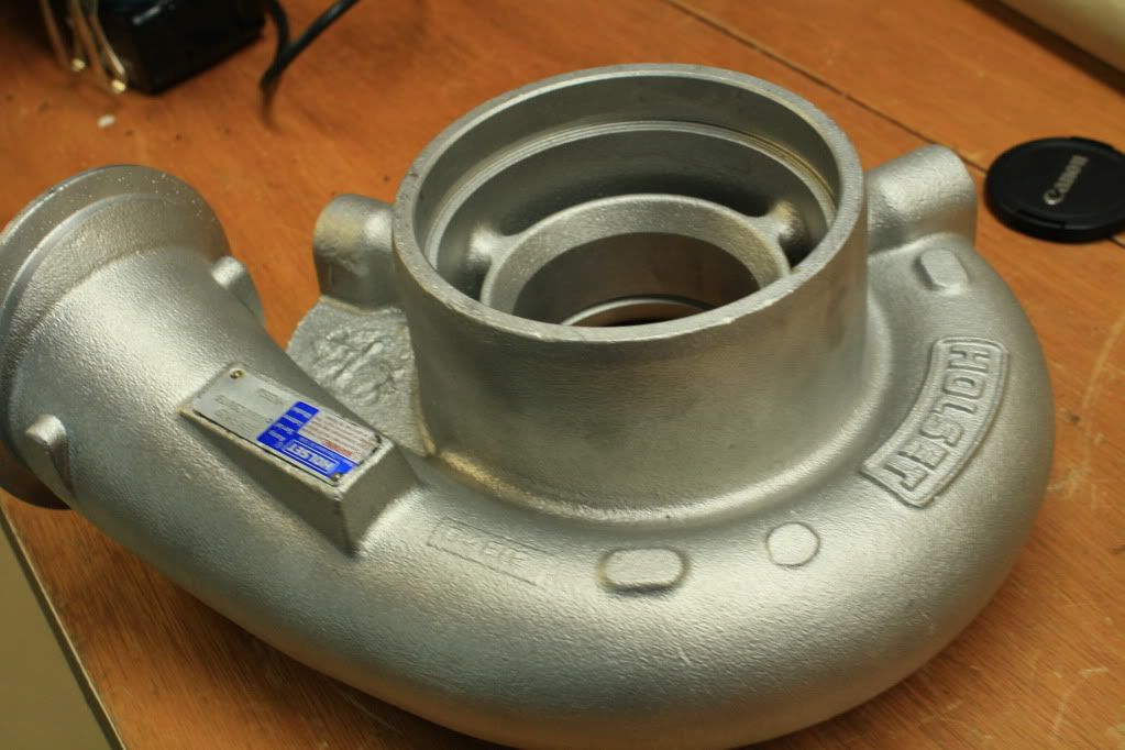

got some advice from Andy Benn and Easy E (pink shirt cdn)
used a carbide bit for a bit then it got full of alum so I switched to an angle grinder. I shouldnt have went so crazy with that thing but I guess live/learn. Had to go down to 80 grit to get the gouges out. All this in about 2 hrs. Spent another hour last night on it after these pics. Looks better.

Are you trying to polish it?  Start with a 3M pad on a die grinder, then start sanding it.  Stay away from the carbide bit nigglet.

I am using a mouse sander with 80/120/220 then hand sanding with 400/600/1600
going to try and find some dremell attachments to sand in the tight areas today.

Levi, fuck man, leave that compressor alone, you are just gouging the shit out of it. I still have to weld on a neck to that thing so just leave it alone for now, gouging the shit out of it just makes it look terrible.

It looks alot better now. Can barely see any marks. Maybe another 10 minutes then on to polish it. Don't worry I'll leave that part alone.

To me I would think if your gonna go that route then different stages of media blasting then a big polishing wheel would be best. But why fuck with a holset?

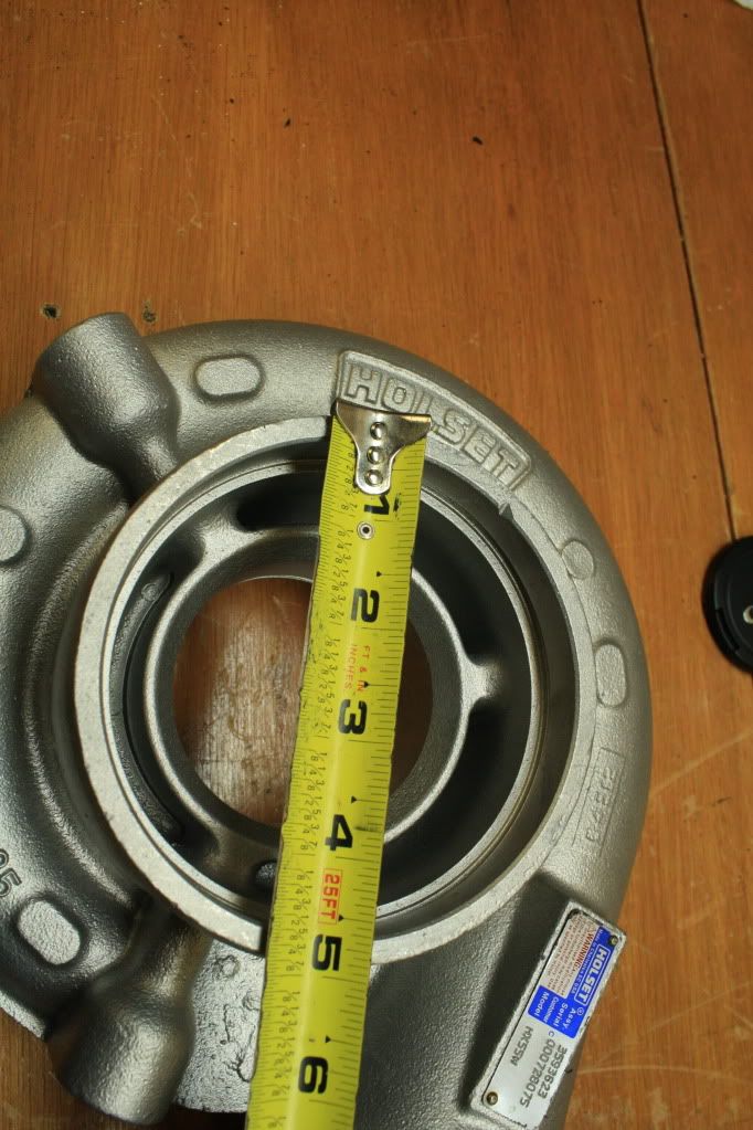

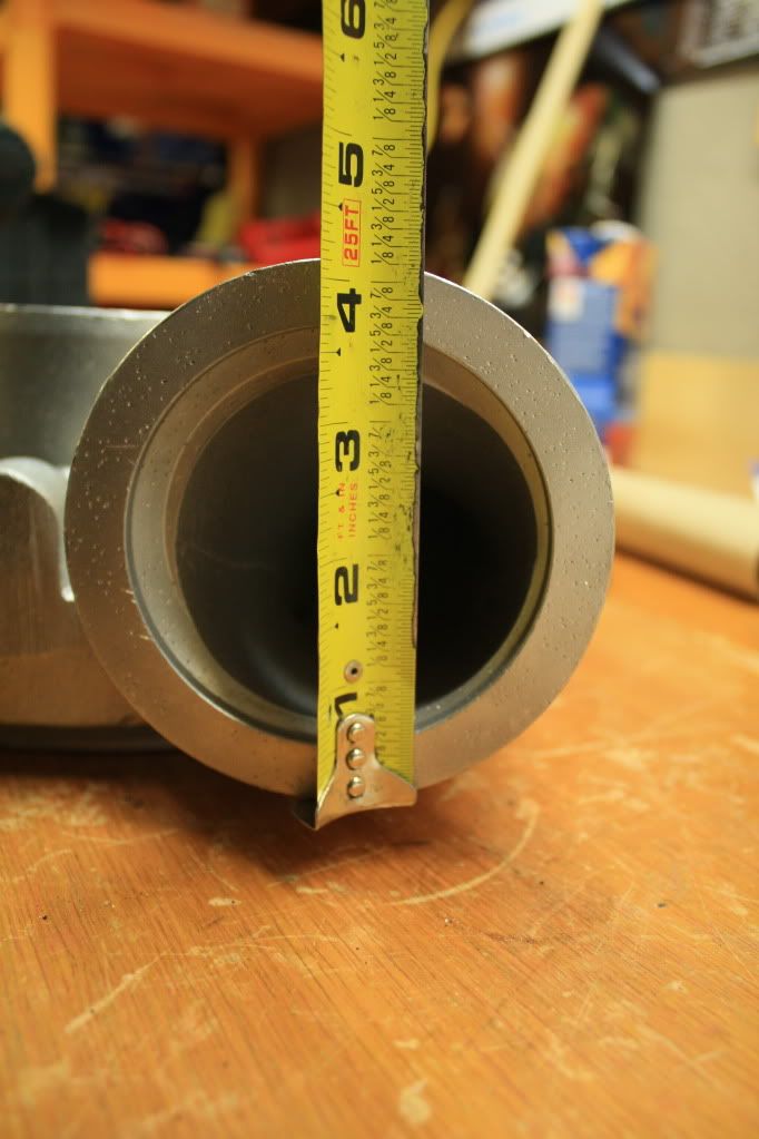

But guess what. If we figure out its too big I can always sell it.

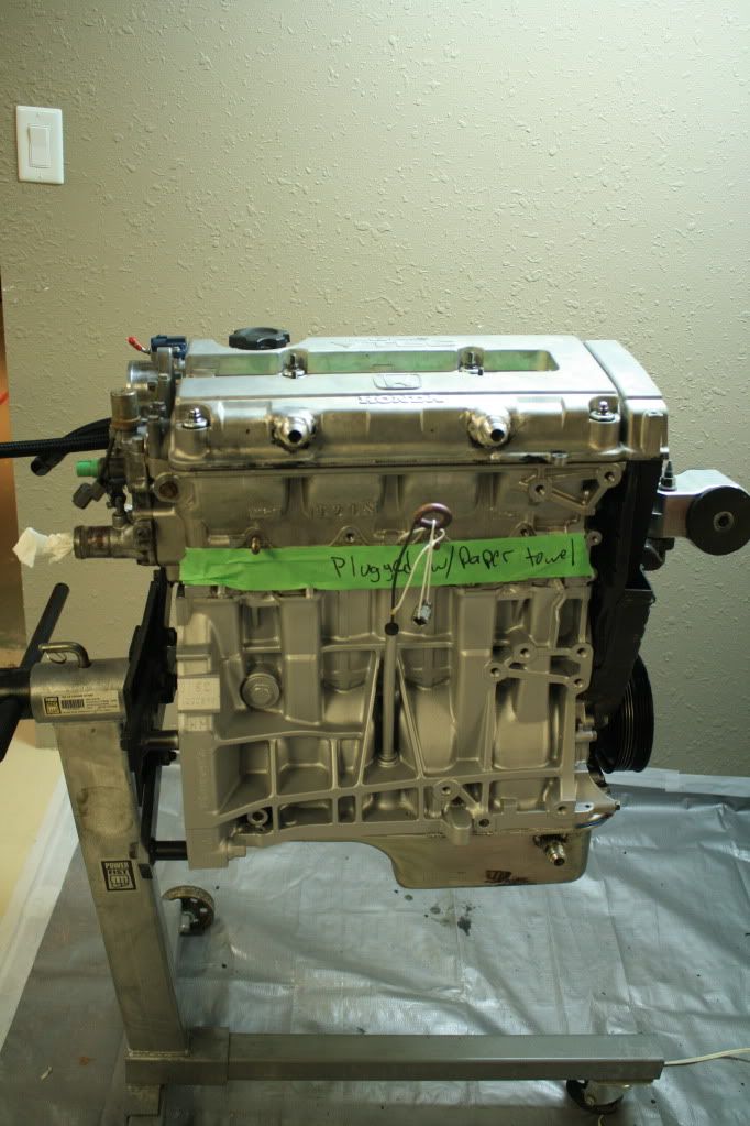

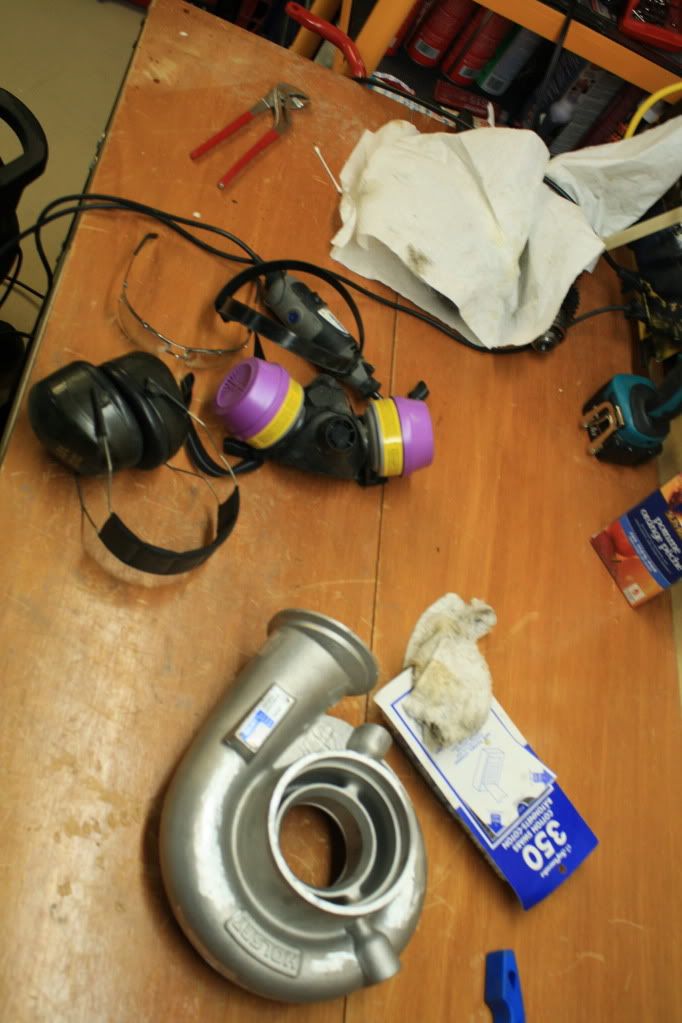

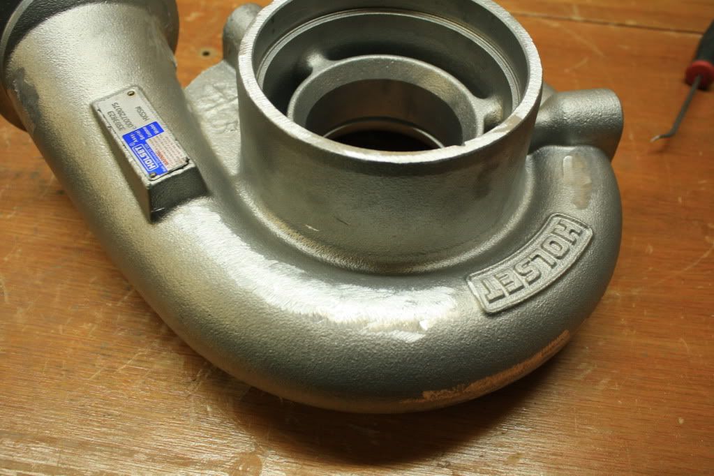

To the machine shop
ok here is 240 grit

Paint it black now. Or maybe caterpillar yellow! Or mexi Chrome.. But besides that its coming together. So whay are you sending the motor to the machine shop?

ballin!  How you gonna get into the nooks/crannies?
Re: UI's 703hp Purple beast - Polished Compressor cover. Pg 26
« Reply #779 on: April 09, 2010, 12:10:35 AM »
I dont think he is gona.  :?:
