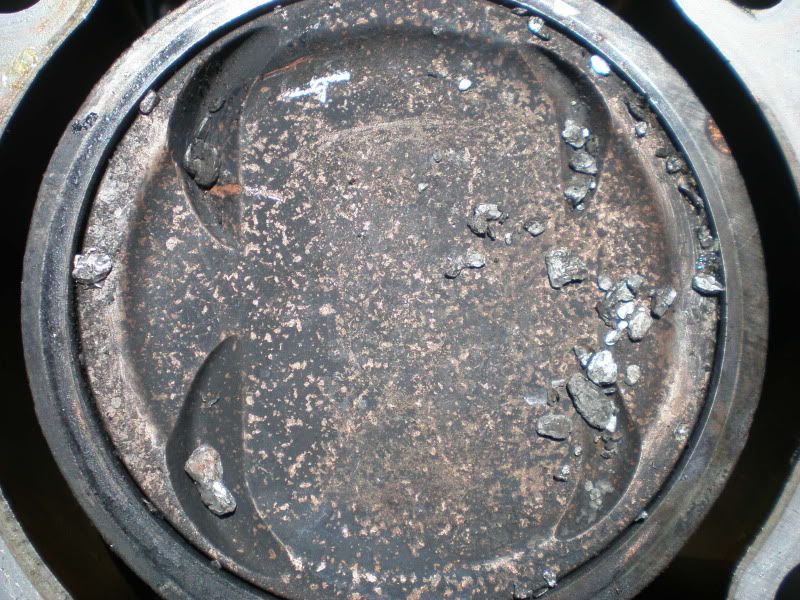

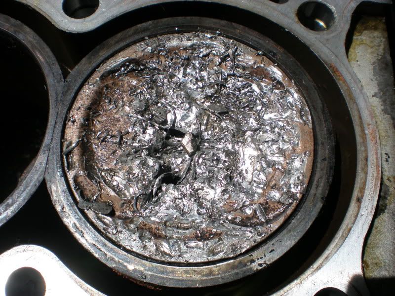

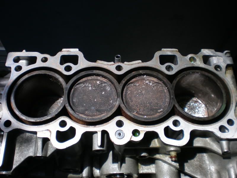

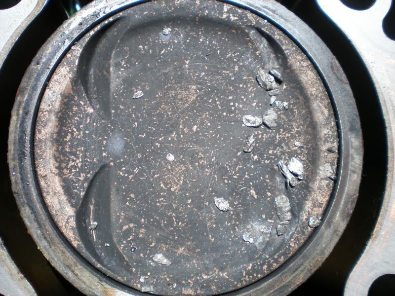

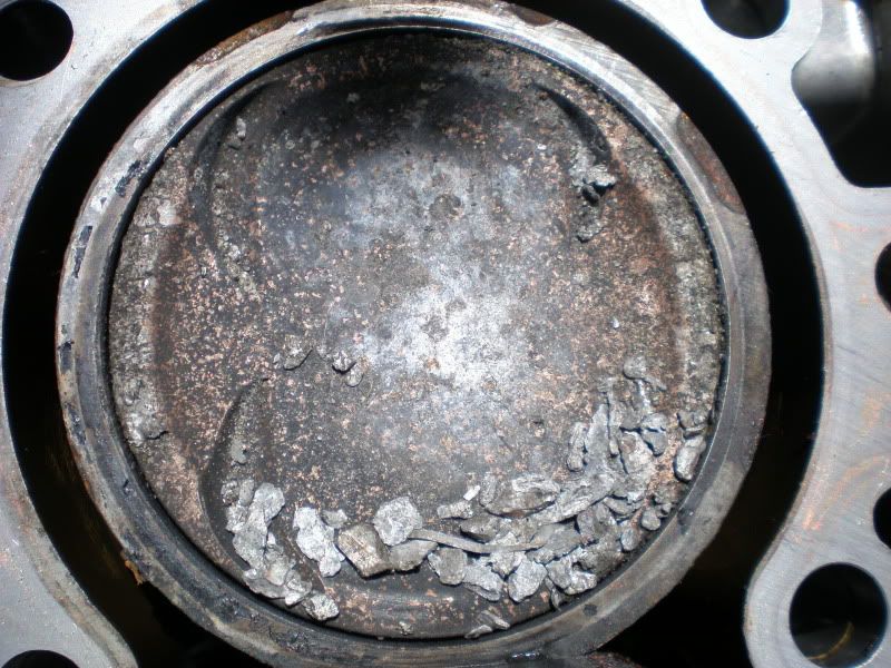

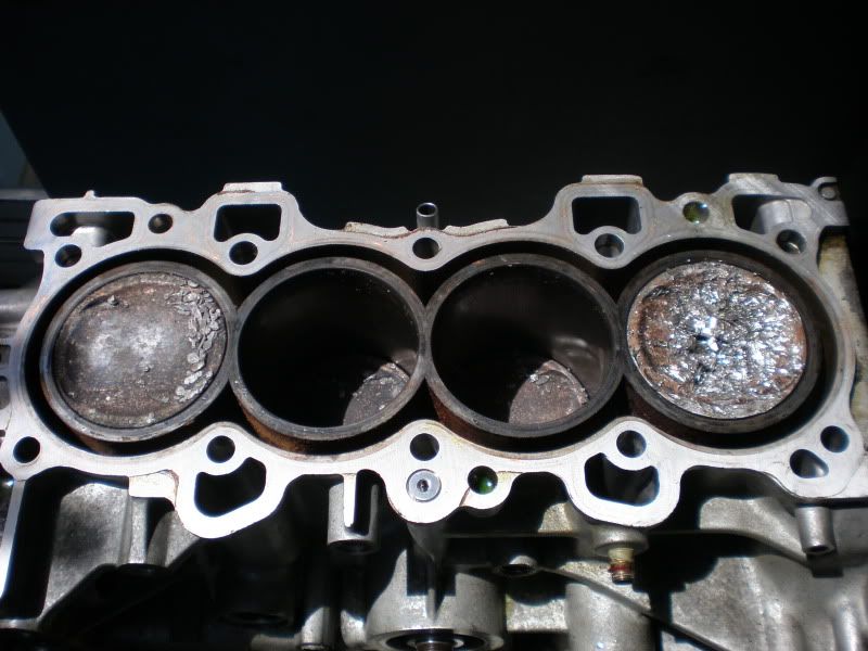

Ok so here are some carnage pics. For some reason no pics of the head on this memory card so those will have to come later.
Pistons 4 through 1:

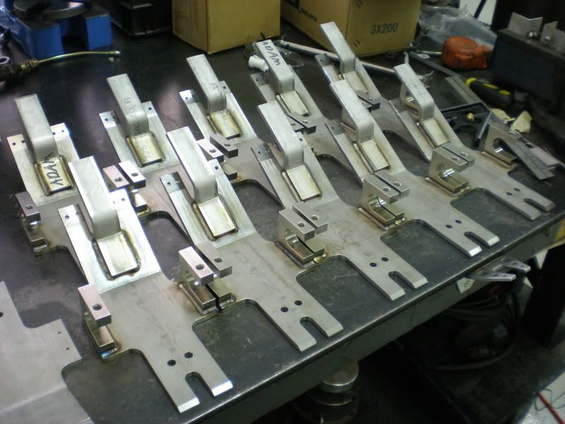

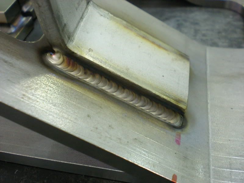

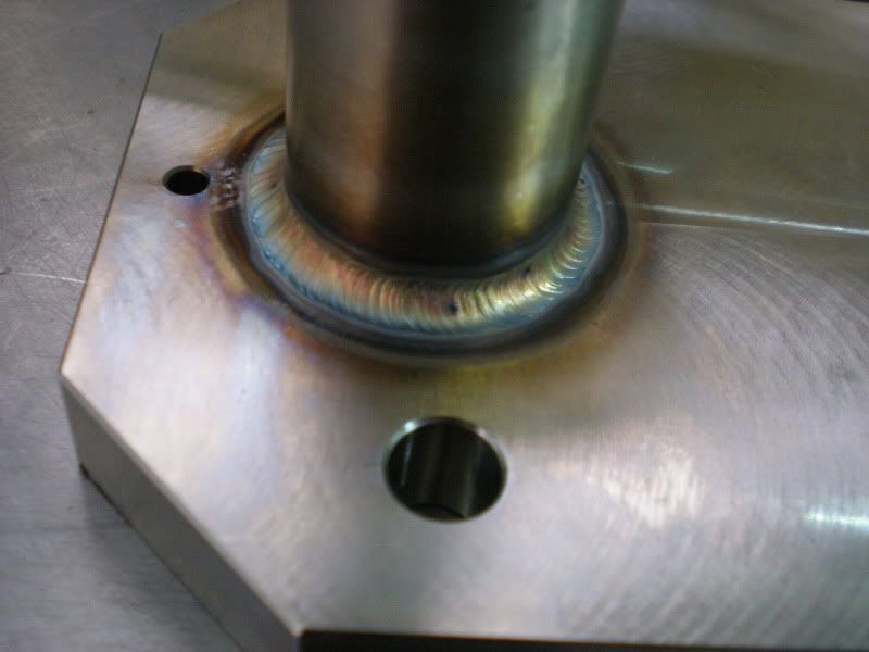

And here is Thursdays random emergency welding job, added only because blown engine pics are lame. (for some reason the pictures of the parts with the tube standoff didn't save except for the one weld closeup.)

Jesus fuck... Looks like a box of rocks got dropped inthat fucking tthing, again

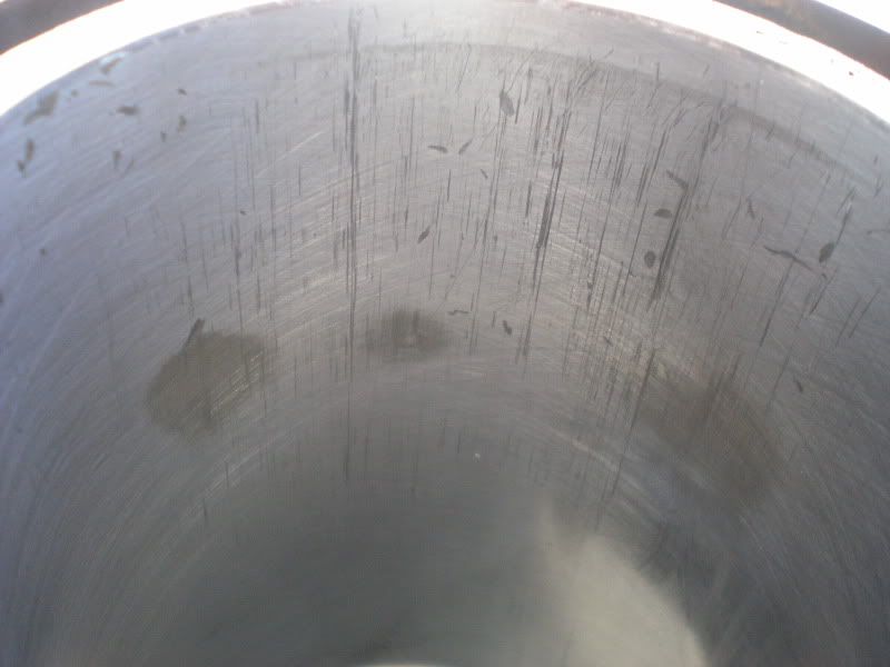

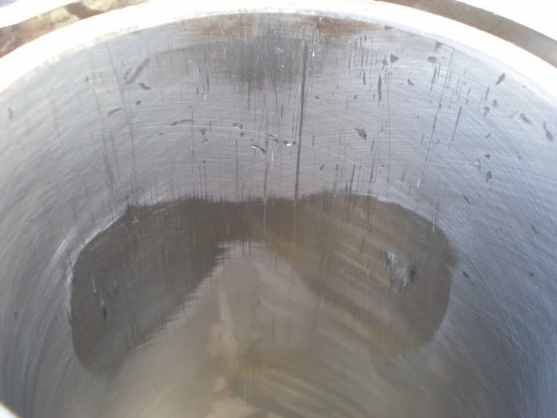

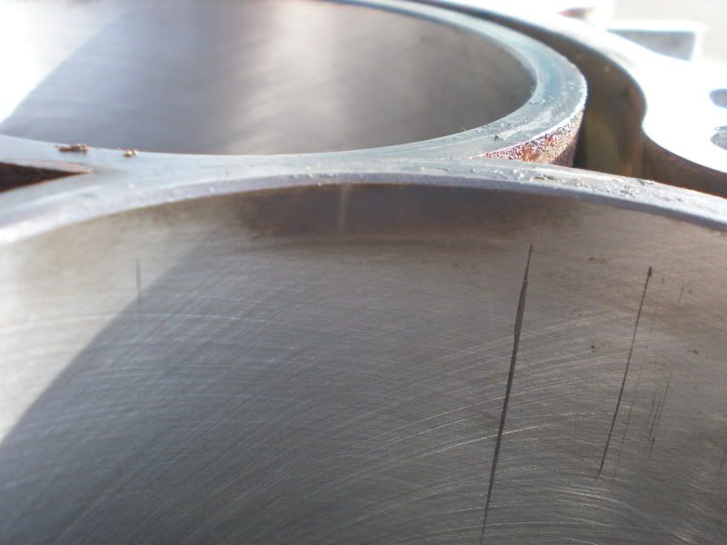

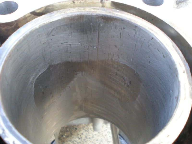

More carnage pics, I got my friend to hone the cylinders today and this is what we found after we took .0005" of each cylinder:
#1
#4, intake side:
#4 exhaust side, .017" deep :o

Ok either way, no amount of anything would get that out

Well I could bore it .040" over, but I have a couple issues with this:
The .017" valley is large, and it is not worn that deep, it was THRUST that deep, so it has been formed, seriously altering the grain of the sleeve, and likely causing a great deal of stress to the sleeve carrier.
Also this sleeve is getting thin, if I punch these out to 85mm I think the wall thickness is going to be around .100"

Exactly. I have doubts on my success of removing the #4 sleeve, without disturbing things too much.

I'm wondering if the reason the sleeve pushed out had anything to do with the fact I already bored these sleeves out 1mm oversize :(
The sleeve thickness at current is .090", if I took .040" out of the sleeve I'd be left with a .070" wall :o Too thin.
