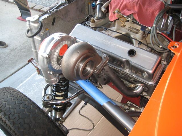

went with some cxracing t70 t/4 .70 a/r cold .96 hot iirc.. went cheap for intial setup then will update the turbos .. ordered some shaorty headers and gonna do topmounts..well see.. pics coming soon!

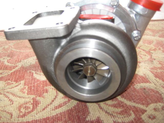

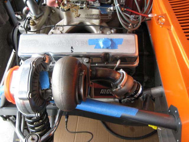

well recieved some of the parts so far.. at least i can start some mock ups..

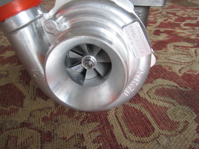

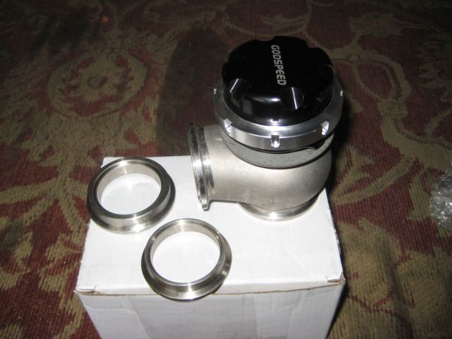

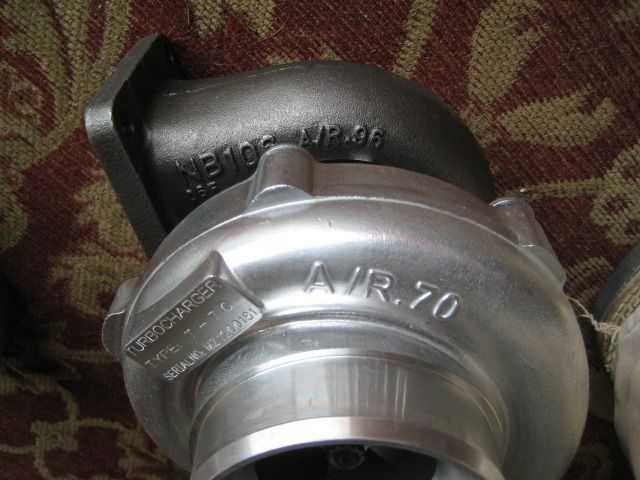

cx racing t70's .96 ar hot/.70 ar cold 3in v-bands.. these are for mockup and first tune,check shit out deal..
i went with these 44mm gates from godspeed for pricing, 109 shipped ea. and came with all the vbands and hardware..ill give it them a shot..if suck...in the trunk they go..

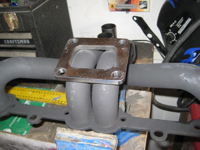

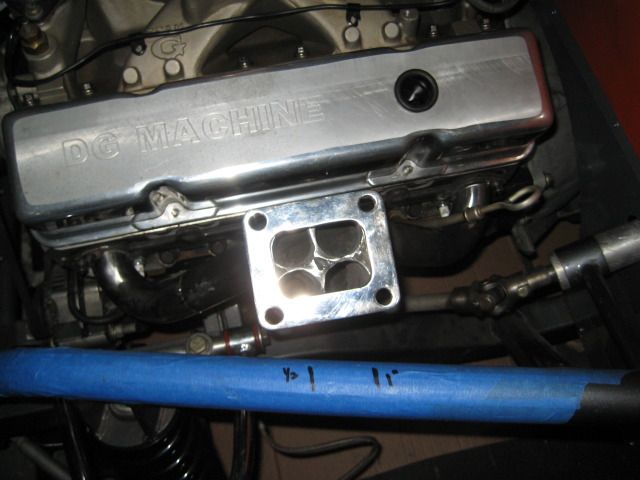

and im going to use these jeg's block huggers for mani's..cut off the 3 bolt flange, and modify as needed for my t4 flanges,for the topmount setup..
these flanges..

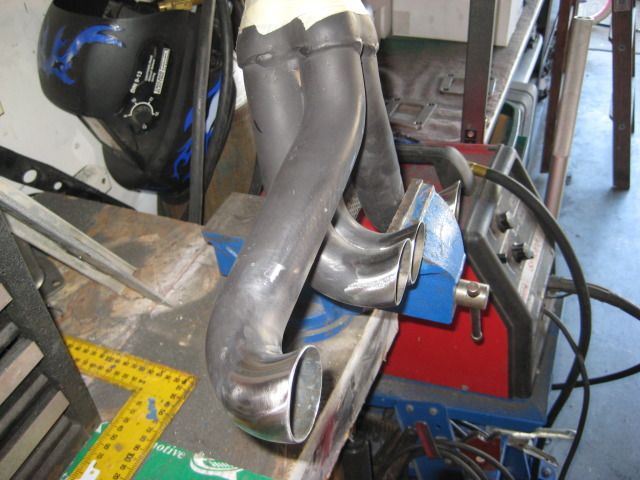

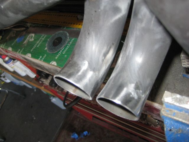

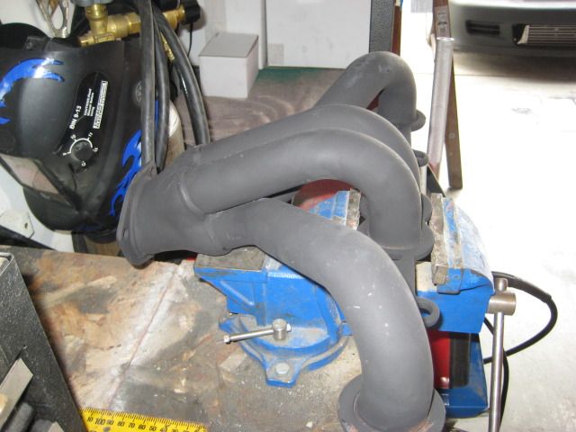

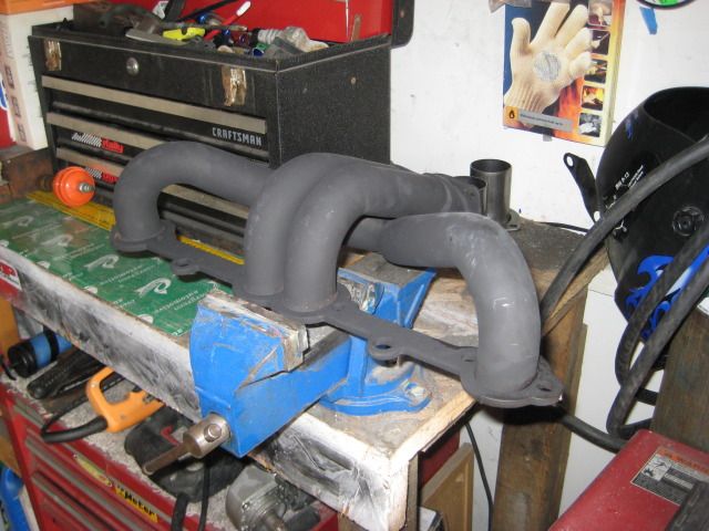

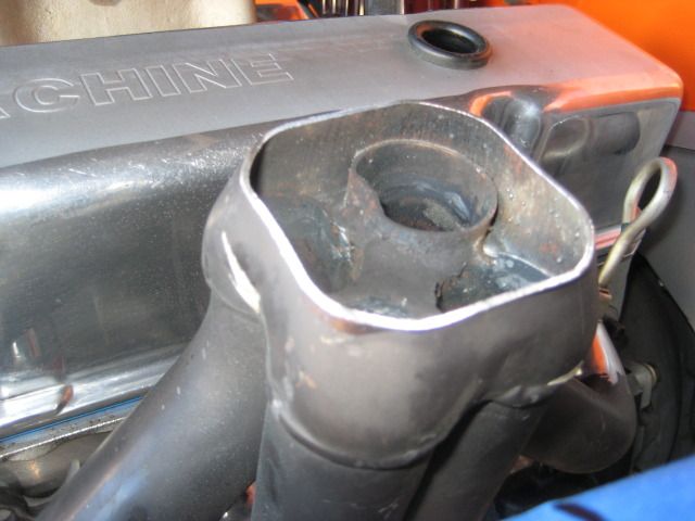

well started on some of the fab for the mani's... dri vers side...

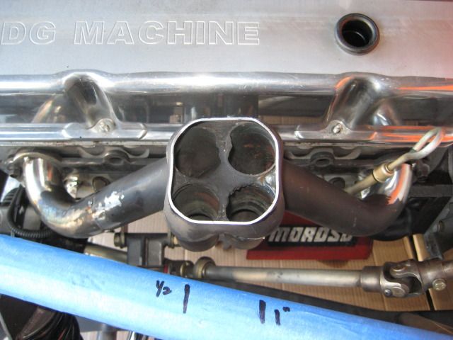

damn need to clean up the inside of the collector...lol

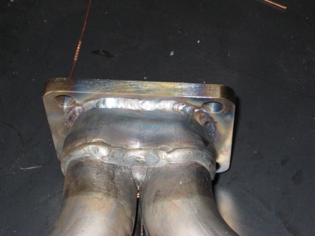

flangness...

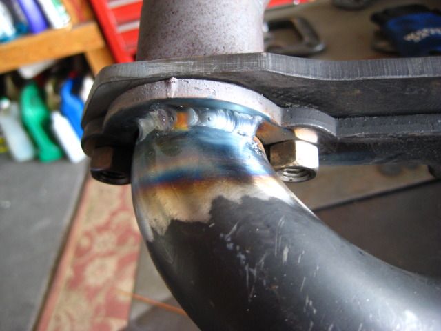

getting somewhere... alll tacked, need to scoop up the tig from pop's shop and finish up..
gonna start on the pass side soon... will post up more fab in a bit...

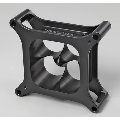

Sweet. What's internally done to the motor? Roller cam? Rods and what heads are on it? What intake is that and how even are your plugs specifically 2,8,3,5. If they are not very even the situation will only get worse under boost. I would also suggest.a 4 hole tapered spacer asthey are all the rage and for very good reason.
I just had to junk a block that was in a wissota latemodel at around 630hp because it cracked a no. 4 sleeve so be cautious. Dart shp blocks are an awesome cheap alternative as they have. 350+ sleeve thickness at stock bore.

das, were you referring to the carb spacer , as the 4 hole ? because there is a 1"spacer but its open plenum style..

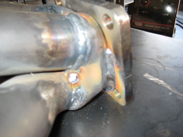

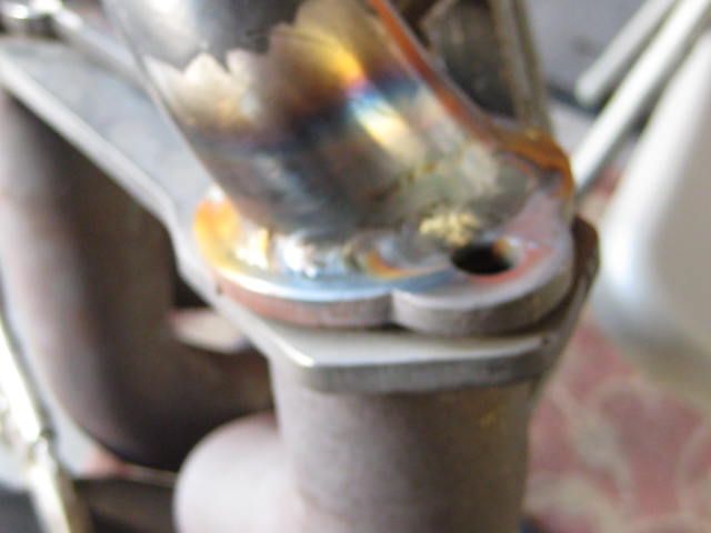

now remember i'm no pro at tigging, but these will work for a backyard shadetree kinda build... plus its fun to try and learn the skill... practice,practice...yada yada..  the welder is a lincoln squarewave 175 #6 cup...
now i need to finish the flanges and wg tubing and such.. more to come....

« Reply #45 on: August 01, 2012, 05:58:39 PM »
How thick is those flanges?
Are the stud holes opened up a little to compensate tor thermal expansion?  :noel:
JACER63
  • Posts: 167916
  • well shit..
Re: Just an upcoming Twins build..63 full framed Nova.. small update**
« Reply #46 on: August 01, 2012, 06:50:31 PM »
russ , irrc they are 1/4" flange on the headers, 16 g tubimg ... and no i did not have to open up the holes bolts still fit nicely...it was tight though..  :noel:

Call Wilson they will set you up. We also make these in house so maybe i can get you one back door. among other things

das, are those 1" or 2" and whats the cost per say... :Jew:  also are they billet, aluminum, ?

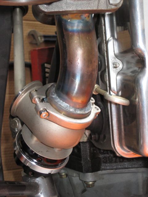

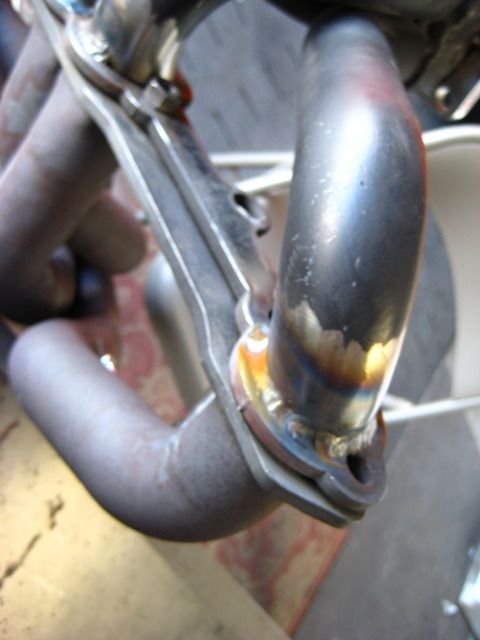

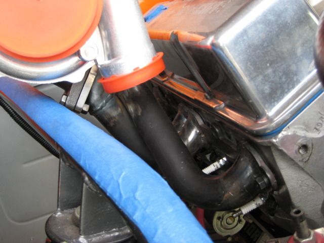

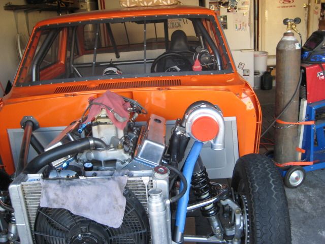

small update.. the driver side mani is done.. now on to the down pipe..and dump
also finishing up the flange for pass side...
the pass side was a bitch.. had to remove the collector,and shorten the runners, then replace a shorten collector.. reweld, and blah..

i will be upset if you ditch the carb :( oh and the spacers are 129 for a 1" 189 for a 2". lmk if you need help modifying the carb for blow thru
das, that might be an option if the pricing is right.. after all said and done, a f.a.s.t efi unit is appealing.lmk nog
