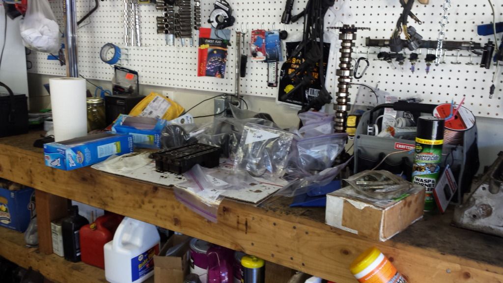

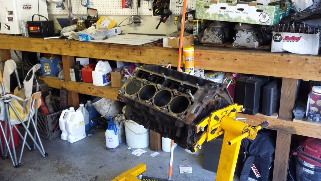

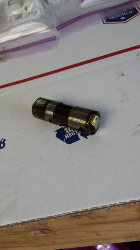

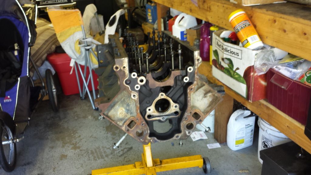

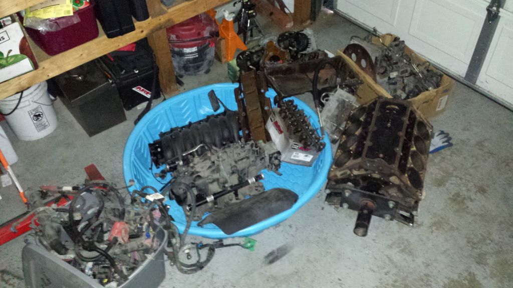

Good news butches. Engine looks minty. inside. Lifters still had nice clean oil inside them. And all the rollers look good. SO I tore it down to the point to where Im now gonna clean the shit out of it and reassemble. Dont even think Im gonna double check with platigauge. IDK well see how eager I am. At any rate not much for pics but I did pull apart and label everything like I always do
Clean oil on lifter
All tagged and bagged

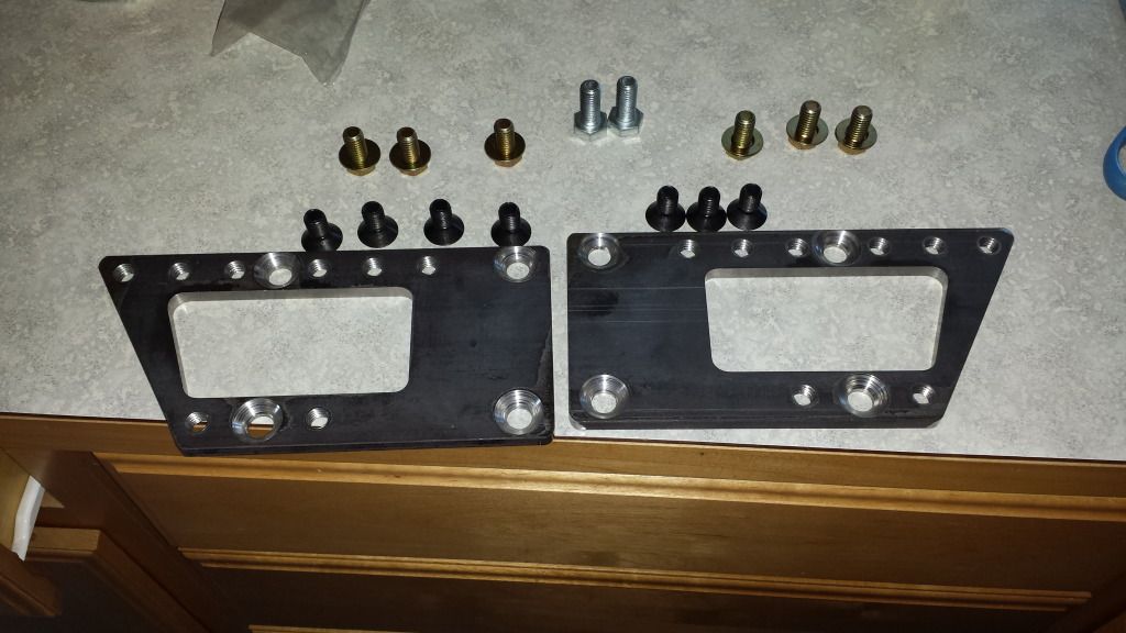

And these showed up in the mail today. Missing 1 bolt. Got a hold of the ebay seller and hes sending few extra in the mail. I was gonna make my own adapter plates but for $40 shipped im not even gonna waste my time
Now Im gonna head out into the garage and see what it will cost me to ship some shit to the other side of the county and hopefully make another $125 to fund some more parts.

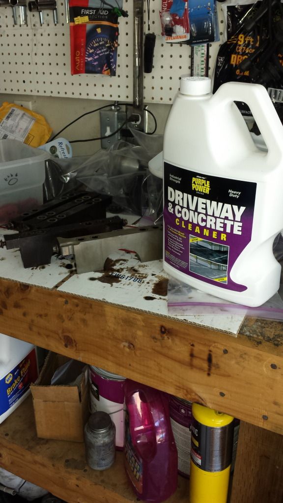

Purple power driveway and asphalt cleaner is the shit for cleaning parts. All I did was spray it on, didn't even really let it soak and moved the cleaner around a little bit with a washcloth. Turned out pretty good.
You can see I only cleaned 1 cap, but the rest of them are right next to the clean one. This stuff fucking rocks. I can't image what it would do if I had a nylon brush to scrub it with.
« Last Edit: June 30, 2014, 07:18:20 PM by ratcityrex »
driveway cleaner is the shit.  :noel:
so you just bolt your gen1 SBC mounts to those plates and your done?
Yes sir.
way too easy. not even sure you can call that an engine swap. more just replacement engine like that.
