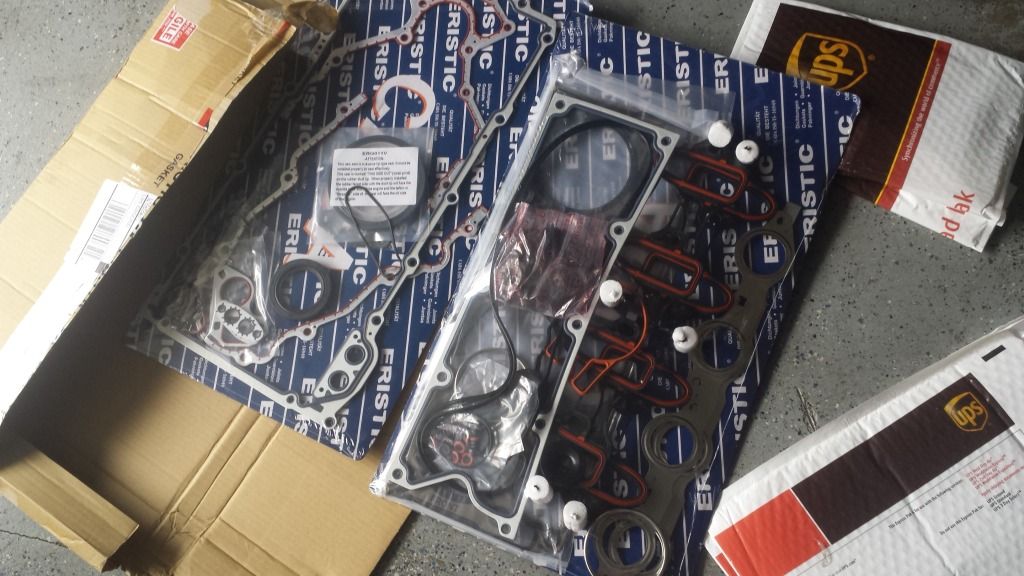

And this showed up yesterday....
A full gasket set.

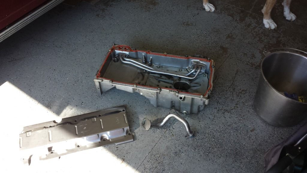

So some parts have been being sold so I've been replacing them with new parts.
Gto front sump pan, pickup and windage tray.

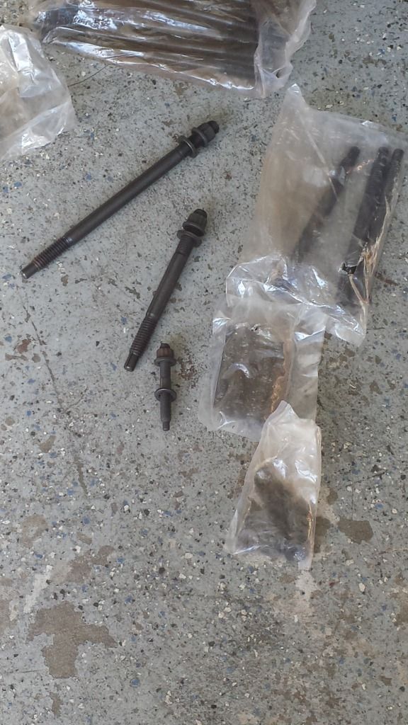

China head studs
For some reason, I trust those head studs.  lol.   :noel:
Lol seems retarded but I've only heard of a few people having problems. And those were with alum blocks.

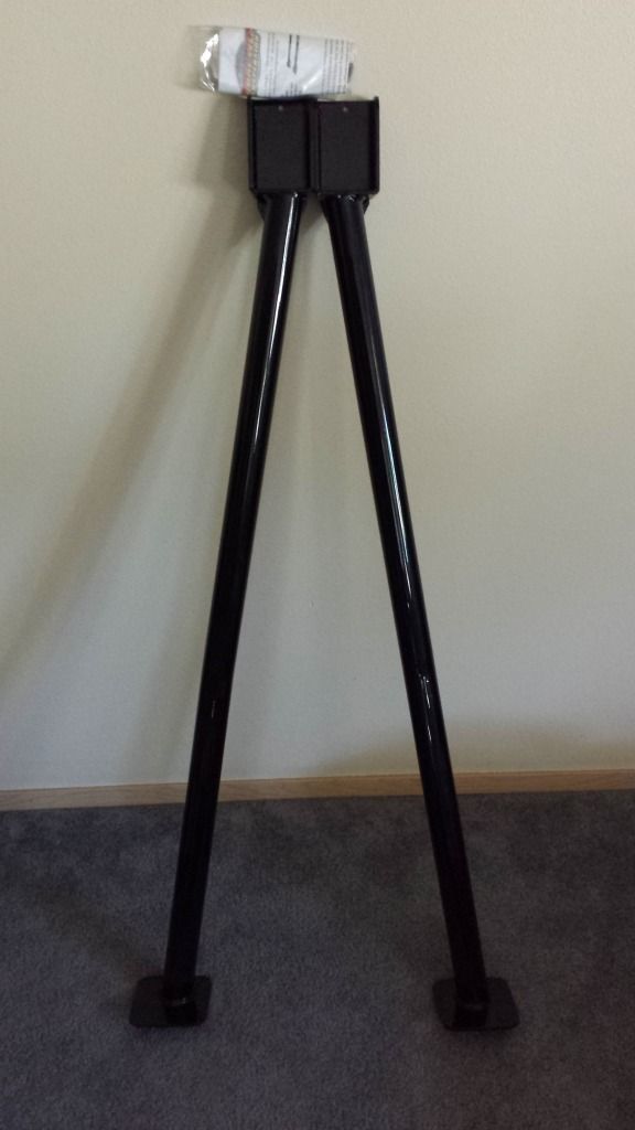

Well I was gonna go to my local metal supply and pick up some material and make some sub frame connectors, but summit was having free shipping on anything over $99 so I ordered a set of global west sub connectors. Last thing I want is this car to turn into a taco once I hammer the power down.

So as you can see, my sub frame connectors showed up. Now I just need to get under the car and burn them in.

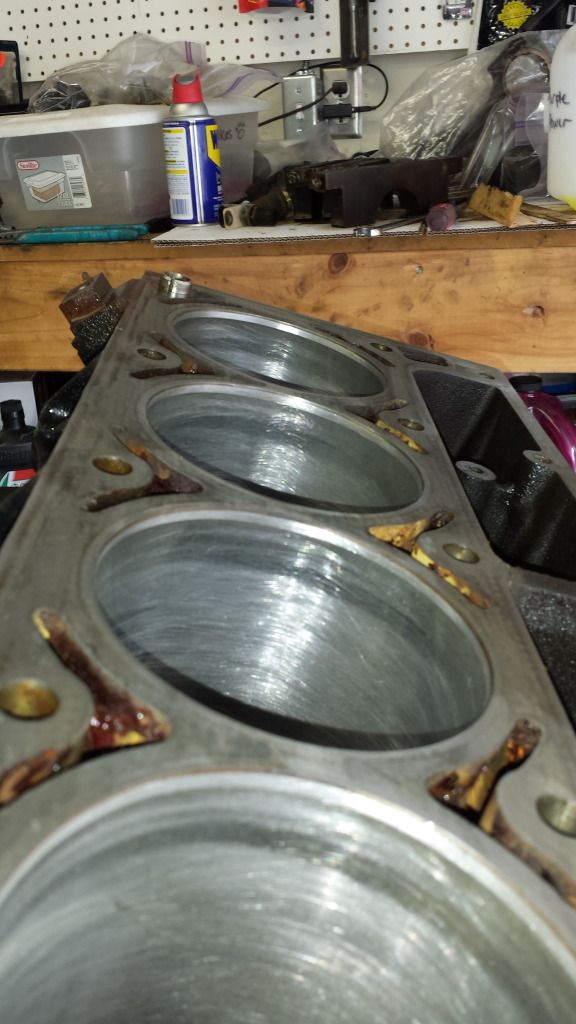

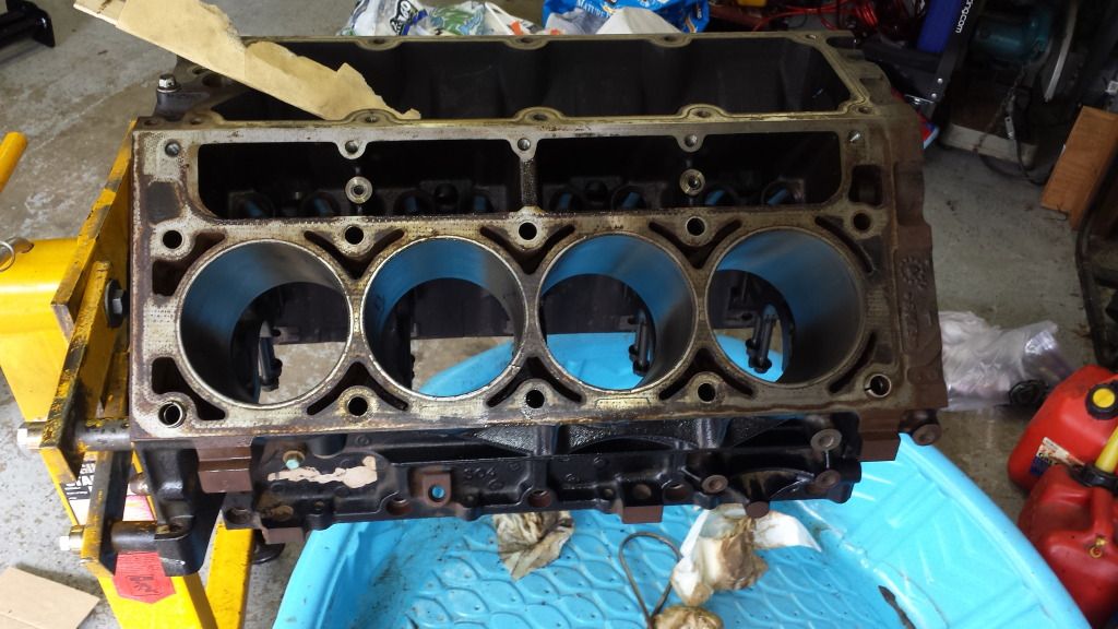

Ok, so I got the block cleaned the other day, checked my cam bearings with a set of snap gauges, worked pretty good. Cam bearings could probably be replaced but fuck it, they are still with in spec. So I did a quick hone and cleaned the block surface so the new head gasket has a nice clean surface. Then I pulled the #1 piston out of my ziplock and pulled the rings off. Checked the top ring, measured out at .031" and the second ring was .039" seems a little on the loose side for me. But idk. Might buy new rings, might say fuck it and run it. Gonna check a few more cyl, and then make a decision.  On the 327 I opened the ring gap up to .022" and .028" and never had a problem. They were cast pistons and 4.060 bore, the lq4 is a 4" bore and I believe they have  hypereutectic pistons. This is gonna be a street motor that I beat on boosted so........ fuck it, on to the pics
Dirty
Clean
Quick and dirty hone. I spent all of maybe 2 min to hone all 8 cylinders.
