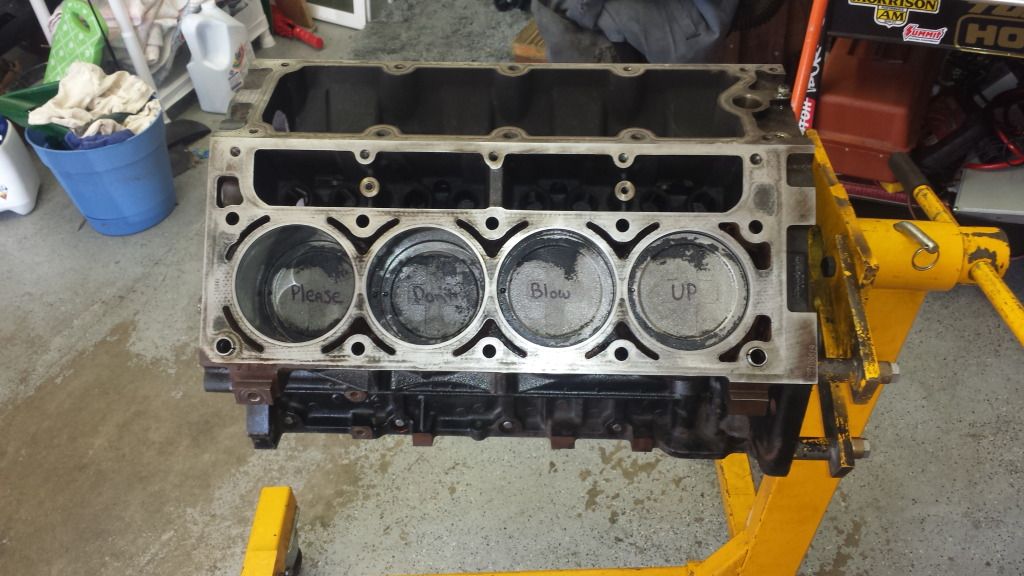

Oh and pics
.0017ish. Close enough for me.
Scoring have 3 that link like that and 2 that look good.
Minty crank
Your plan sounds good. Leave the rings, better to be a touch loose than butted and broken.

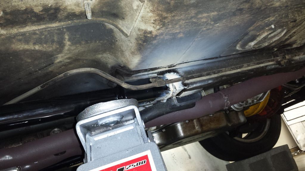

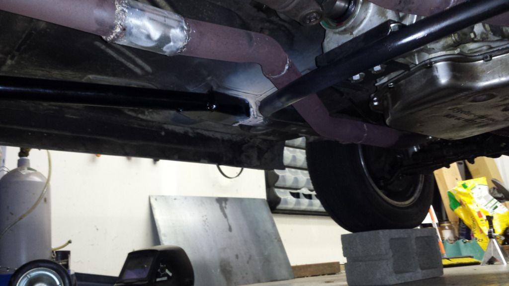

Well sold the ss trunk trim and made $300  today. Welded in my subframe connectors tonight. In rhmt fashion I flux cored that shit.
And here is some flux core madness. Laying on your back under a car welding above your head in a garage that's 88° @ 9 pm at night is not my idea of fun. And on top of that it kept trying to catch the undercoating on fire. So I would weld for 10 seconds and then put the fire out and then do it all over again.
Drivers side rear
Drivers side front
Pass side rear
Pass side front
Welding next to the fuel line was kinda sketchy
Looking good! Leave the motor as is. Ring gap is just fine!
Might have missed it, but did you level the car up before welding them in?
Not talking about on the suspension, the actual car itself.
I did pull out the tape measure and the car was 1/16 of a inch different from front to back. So I just left it like that. Pretty sure the tolerances from gm in 1966 weren't even that close.

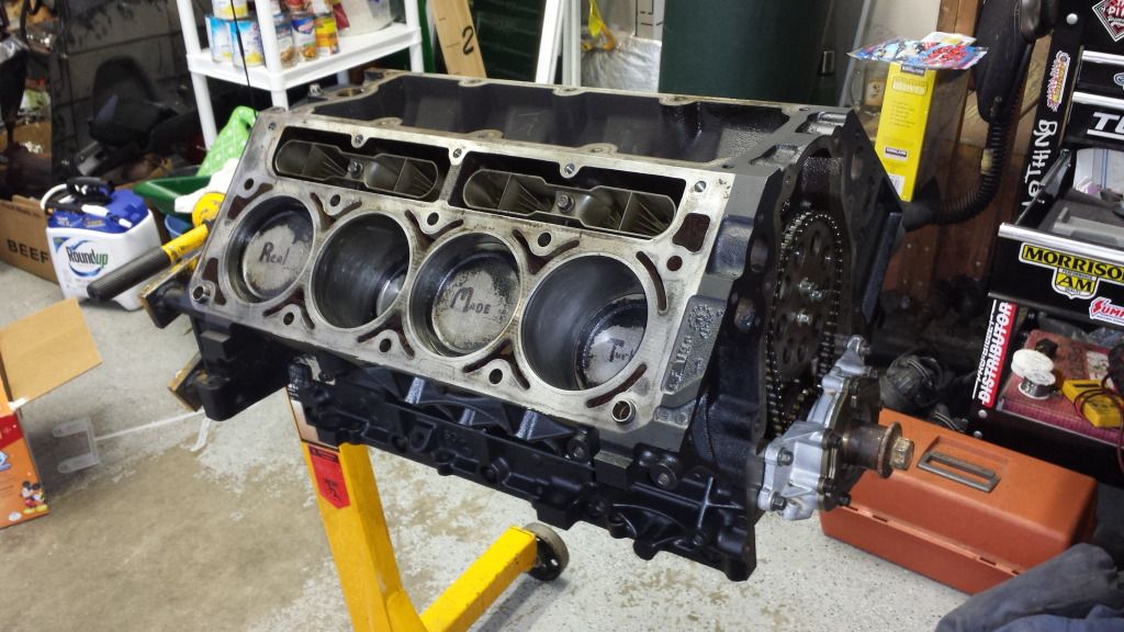

Ok so I have the whole bottom end together. Plastigauged 1, 3, 5 and 7 also since I didn't have the numbers b4.
1.  .0015
2.  .0016
3.  .0017
4.  .0017
5.  .0017
6.  .0015
7.  .0017
8.  .0016
So all is good there and here is the pics.
So next steps are to paint block, install cam/chain/gear, inspect oil pump and then install or order new, paint install covers.
