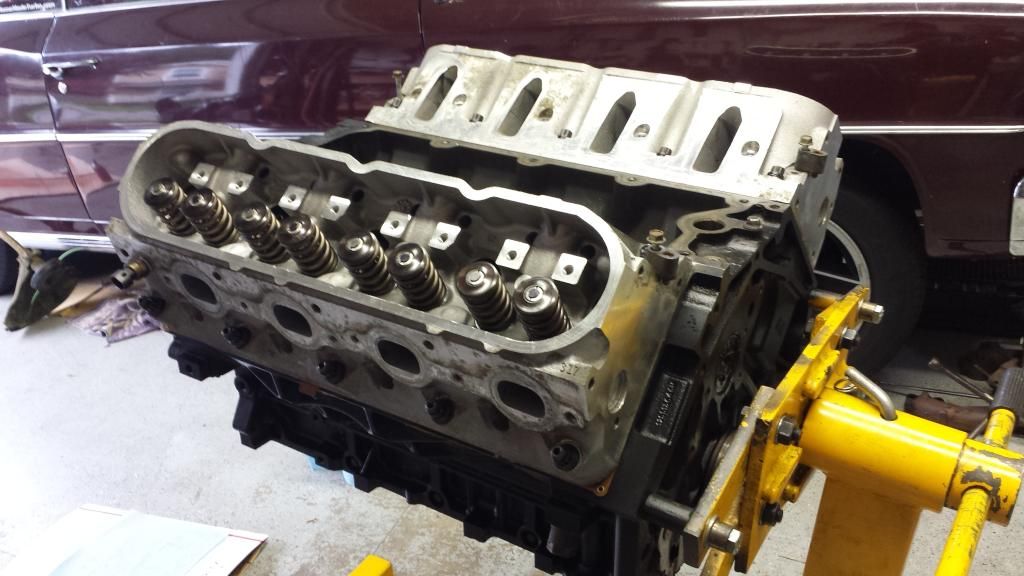

Well i got up a couple hours early today b4 i headed off to work. Got one head bolted down.......

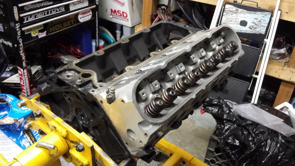

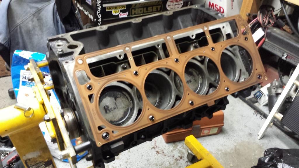

All cleaned and some alpermotorsports ebay $100 head studs. Ebay $120 engine gasket set. So I checked the head gaskets out and they look great. Mls, so I copper sprayed them and shinched everything down. Torqued down great. Got 1 side done. Hope to get the other head on this week.
Other head cranked down

pic fail.... only a passenger head in your last 2 posts...  ::)
Fixed, now I need help selecting a turbo. My origanal thought was to use a t72

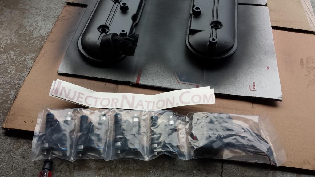

Ok, so I got my injectors from Hiprofile at injectornation.com today. And painted my valve covers. Also put my knock sensor cover on and knock sensors installed. No pics of that though.

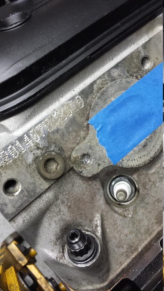

Yep, broken easy out inside that bolt that's broke off inside the head....... might end up pulling the head and taking it to a machine shop after I try drilling it in the morning ::)
That sucks. Easy outs usually make me want to fuck my asshole with a cactus. The only kind I use have a reverse drill bit on one side and a stubby swirly tip on the other. I've never broken one of those, and 1/3 of the time the bolt twists out while drilling (since it's done in reverse).
I've used reverse drill bits before, but I already had this drilled out and figured I would give a easy out a try. 1st, only, and last time I will use one.
Unless you have a carbide drill bit handy, don't waste your time and drill bits trying to drill through that easy out. They are hardened and really just don't take to drilling through well.
That situation is probably the single thing that drives me the most crazy, as I am always sure I can get it out with an easy out and almost always end up at a machine shop...  :'(
I would weld a nut to it!
I do have a set of carbide bits, if it doesn't work I'll try welding a nut to it. But being that it's recessed in the head I have a feeling that it will end up at the machine shop.
I think it would be fine, remember the weld will not stick to the head, also during the welding the whole area gets hot and might even make it easier to get out.
So the first exhaust manifold bolt I ever broke was in a ford escape v6. Due to the position of the motor I couldn't drill it out while it was in the car. I had to remove the whole engine to drill it. Even with 90° drill adaptor I didn't have enough room in the engine bay. So one I had the motor out I used a reverse direction drill bit, it caught wile I was drilling g it out and backed itself right out.
So it looks like this is very common with the lsx engines with the stock bolts. Pretty much every successful thread I've read was people welding a nut to it and letting it cool for like 30 Seconds and it backs right out. I guess it could be worse. It could still be in the car and I could be trying to do this.
The thought has defiantly crossed my mind.
I have removed 1000's of broken exhaust bolts/studs from ls and triton motors and everything in between. I have had great success welding nuts on. Sometimes it takes a few nuts, lots of back forth, back forth. I am a pro at getting broken/seized bolts out. My shop is known for magic lol.
