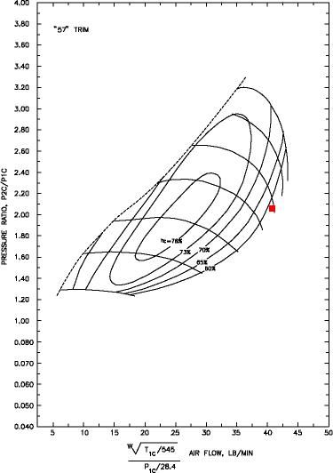

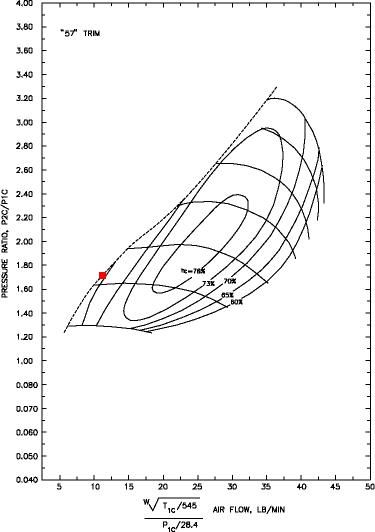

Idk. The maps for 2 57 trims fit pretty nice.
I have pics of it but photo bucket is being gay but at 10 psi and 2k it's on the map and at 6200 and 14psi is its still on the map.
I had dreams of a couple 57 trims on the novacorn mounted low and back like a factory would do it.  lol.
57 trim, 10 psi 2k rpms
same but 14psi and 6200 rpms

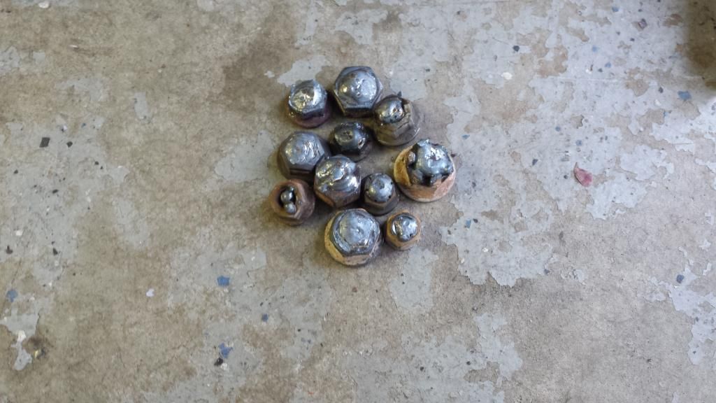

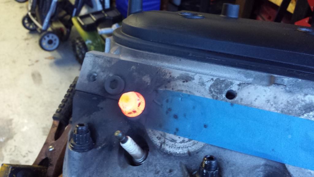

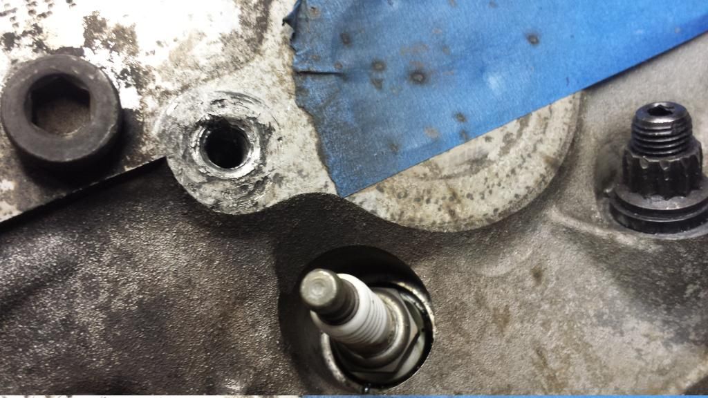

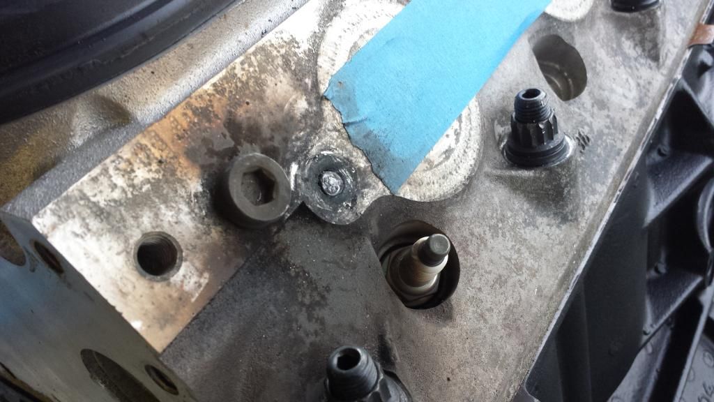

So I tried like hell to get this broken easy out bit out of the head. First I tried just welding a nut on. Let it cool off and then tried working it back and forth. Just comes off and I'm left with the bit still stuck. So I tried welding on the end of the bit to build it up so I could then weld a big nut on it to really get some heat into it. Just twist off......fuck!!! Looks like I'll be pulling the head and taking it to a machine shop to have them drill it out.
On a good note, I traded in my 40cf tank for my welder in and upgraded to a 125cf tank. Dude behind the counter hooked it up huge. Only charged me $97 out the door with the tank filled and everything. And now that I have the correct tip and wire this welder does a pretty good job.
forgot about that. so i tried that the other day on an LS/PR4 head. cranked welder to nog (3/4 is as high as i usually go) welded nut to it. as soon as the fucker wasnt glowing anymore i spun it right out. worked champ.
it was still stupid hot when i removed it. seriously as soon as it wasnt that scary orange, i threw a wrench on it.
is the weld getting down there? or is the wire just sticking to the nut and filling it?
Well the first few times it was sticking to the nut and would spin right off. So then I said fuck it, put the clamp right on the block and welded a nice little mound on the end of the easy out (it's broke off about 1/8" in the head) then slapped a nut over my mound and let her rip. I mean the whole nut was bright orange when I was done. Tried it while it was still hot,  also tried it once it cooled off. No matter what I did it would pretty much just break the weld off the easy out or leave the mound on there and break the nut off that. Shit I even tried welding a bolt on top of the mound. Still a no go. And of course the easy out broke off at a angle so trying to drill it make the bit just want to walk off to the edge of the bolt hole.
If it was just a busted off bolt I think the welding a nut trick would work. But since it's a easy out I think I'm pretty well fucked. Gonna probably try it again next week but if nothing then machine shop it is.

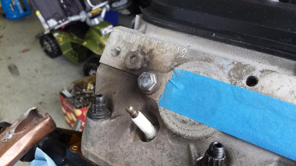

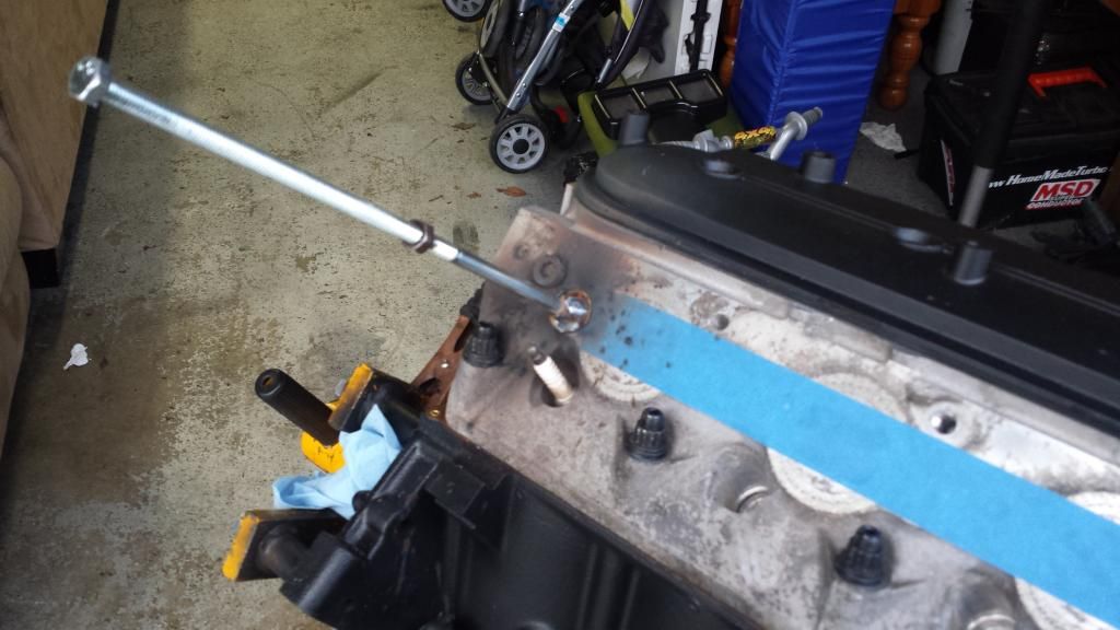

Got it out.......

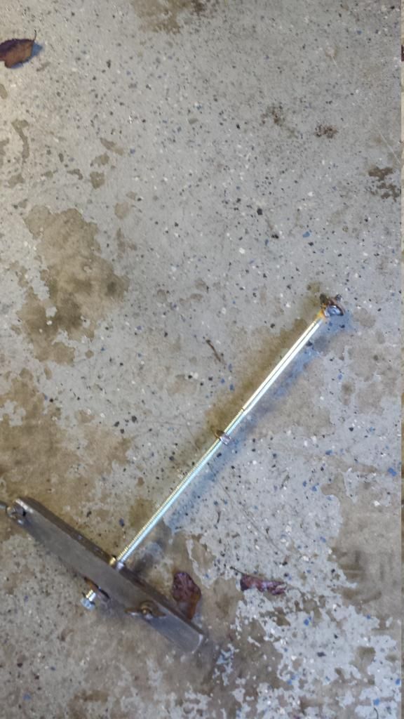

I figured if I could get the broken bit out I could then get the broken bolt out. Well first I welded a washer to the broken bit, then while that was still cherry hot I welded a long bolt to it. It then attached another bolt to the end of the bolt with a nut and made a makeshift slide hammer with a brake flaring holder. And then i yarded on that bitch about 20 times and got it pulled out. I then welded a nut on the drilled out bolt and slowly worked it back and forth once it wasn't red anymore.  Took about 5 min just working a little back and forth until it came out. I think I'll have to run a thread chaser down it just to make sure the threads are ok but they look fine.

Fucking macgyver on that home made slide hammer, I'll have to remember that one.
Tried posting that 3 times on the bitch house, it doesn't like me today.
I knew what needed to happen. It was just putting it I to action without the tools. Fuck it so I'll make my own.

For the money I think I would try the twin CDM 57 trims. On good fuel they should be good for ~800hp.

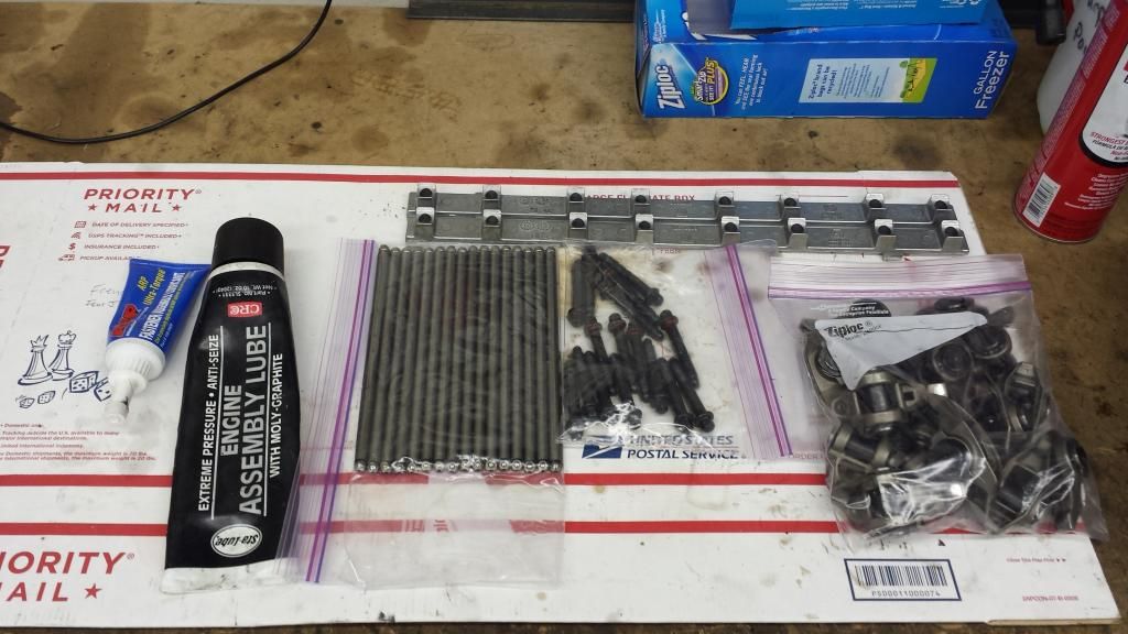

Well all valvetrain parts are cleaned and lubed up and ready to go in. Only got about 20 min of garage time in this morning so the only thing I was able to get done was get the pushrods, bolts and pedestal rails cleaned and ready to drop in

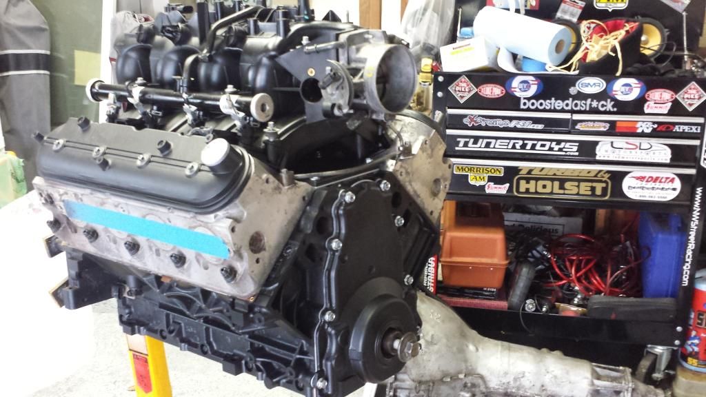

So I skipped taking a few pictures but, i got all the rockers and pushrods in, Valve covers painted and new gaskets in/on and bolted down, timing chain cover painted and lightly tightened down (still need to drive the balancer on b4 i crank it all the way down), Cleaned up the steam port caps and crossover and got those bolted down and last but not least I set the intake on to take a look at what it will look like when it's almost done.
Pic
Getting close now. Just need to put a freeze plug in intake manifold to plug the big egr hole in the side, and drill out the purge hole and rtv in my iat sensor, make a couple of fuel rail spacers and drop in my big injectors, bolt on my oil pan and rear main seal/cover oblong the holes in my flexplate for my converter to bolt to and the motor will be ready to drop in. Then it's trim and plate my shock towers and start fab on turbo shit.
