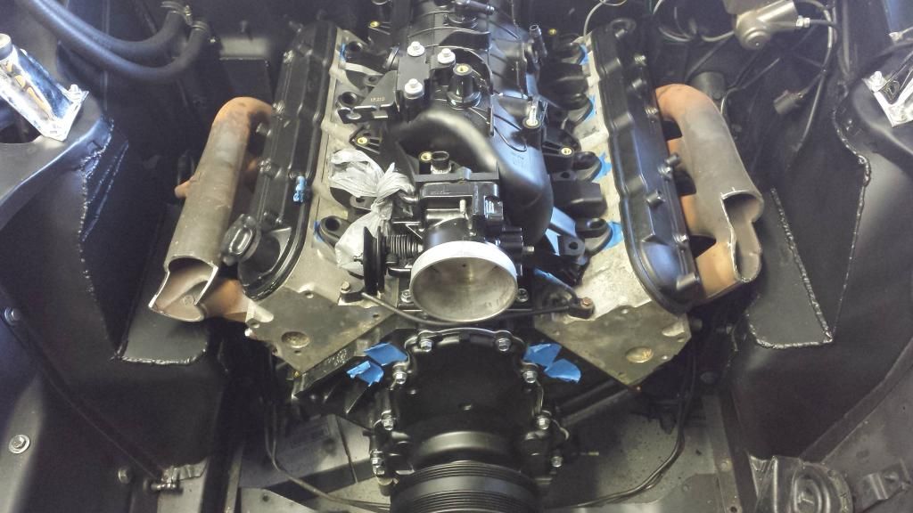

Well it looks like the truck manifolds might fit. Gonna have to do a bunch of trimming on the exhaust manifolds but looks good. Drivers side fits as is, Passenger side don't fit worth a shit. I will have to cut it up just to see if it will fit. Might take a whack at it on Monday. Would still like to see if I could find a set of C6/ls3 vett manifolds or some fbody on one side and possible something else on the other.

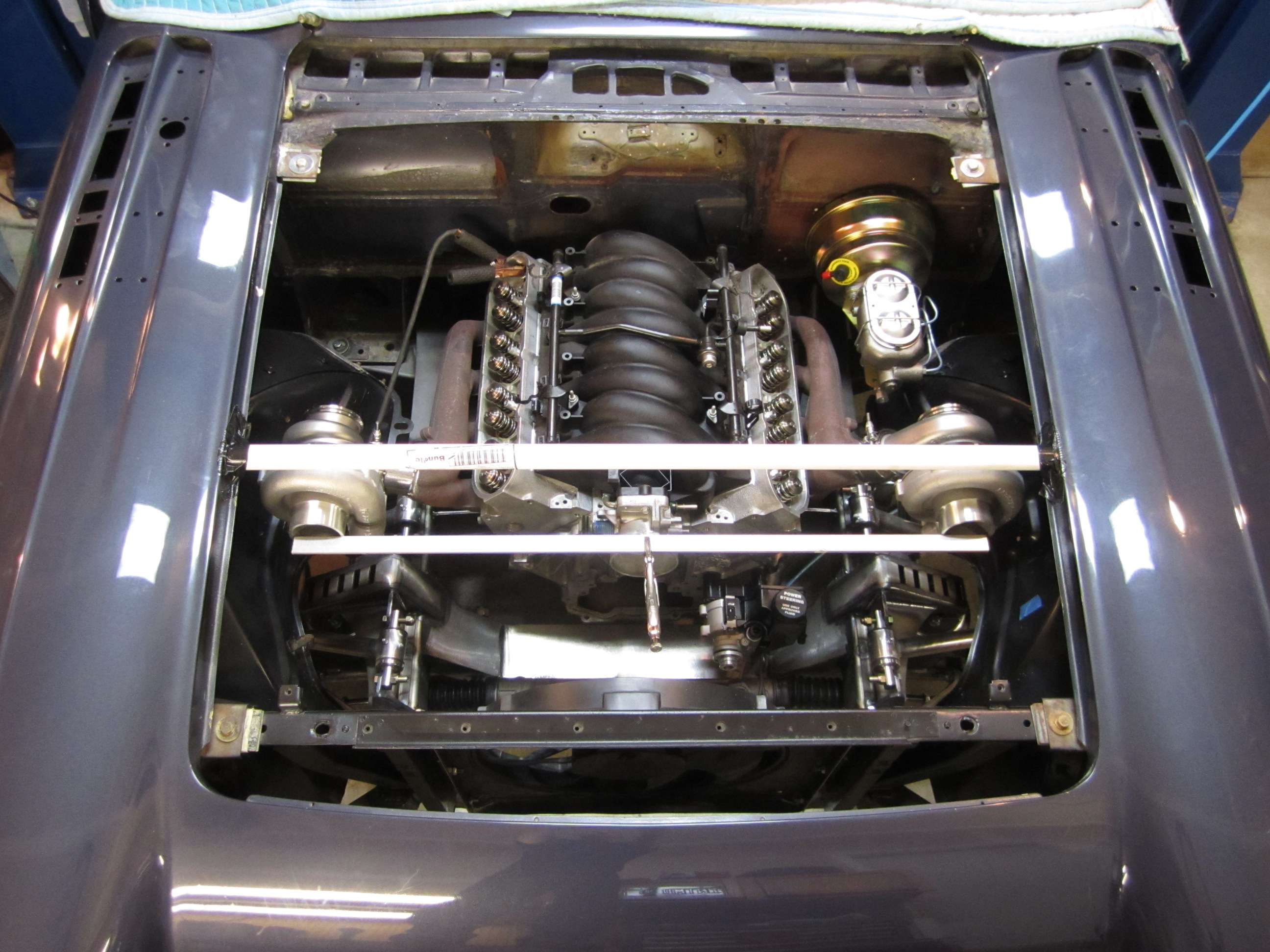

Kinda like this

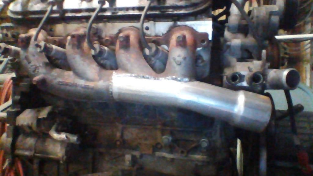

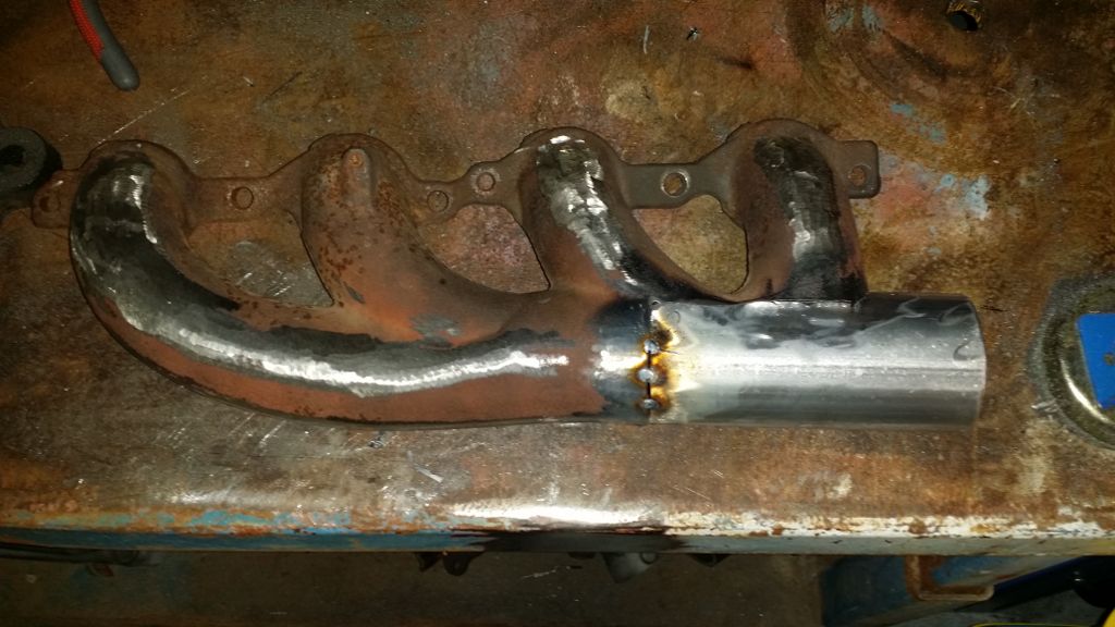

« Reply #642 on: February 16, 2015, 08:52:51 PM »

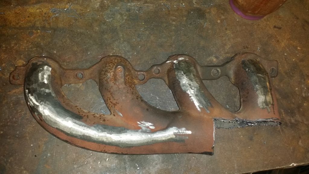

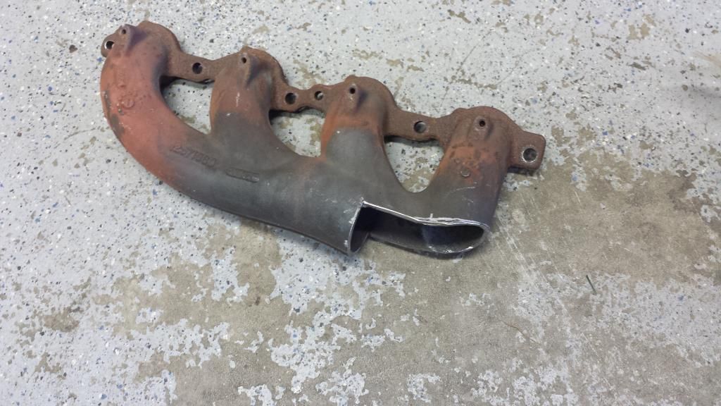

Here's where I'm at now...
Drivers side cut
Pass side cut
And bolted on....
And now I need to order up some pipes from Adam at Columbia River and then some t3 flanges so I can start placing the turbos.
Re: NOW WITH TWIN TURBO LQ4 ACTION~~~~~~~~~~~ 1966 RAT CITY RED ROCKET!!!~~~~~~~~
« Reply #643 on: February 16, 2015, 08:59:38 PM »
Those look like they will fit perfect. Some pipe grafted in and some t3 flanges and the hotside will be good to go!

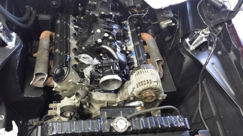

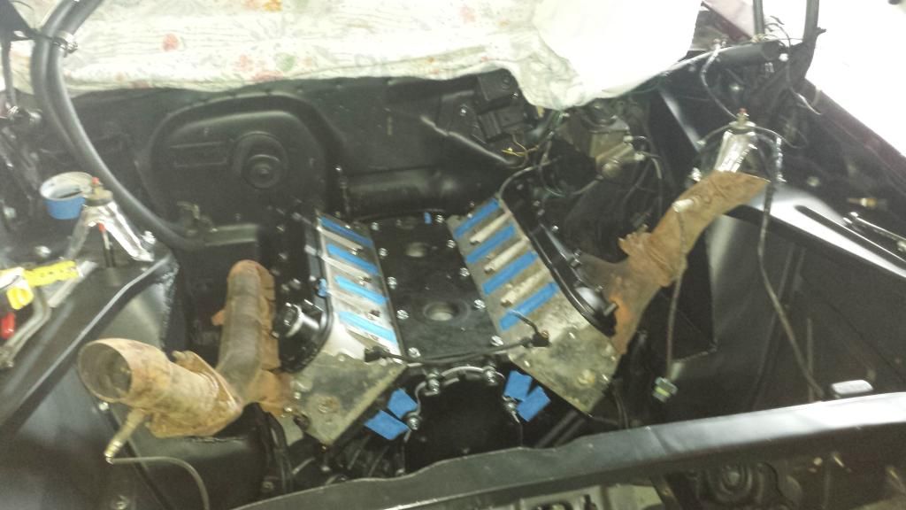

Well I picked up a couple of bolts to just hold the pump on and I cut up the power steering/alt bracket. This is where I'm at now
So it's gonna be a tight fit....lol
thinking about trying to get a fbody alt mount and mounting the alt down low and out of the way. Or say fuck it and build a exhaust pipe upper and lower radiator hose....lol kinda running out of money quick. Gonna find myself stalling real soon. Have about $200 left to spend and I don't even have a intercooler, charge pipes, charge pipe couplers, The list goes on....lol
