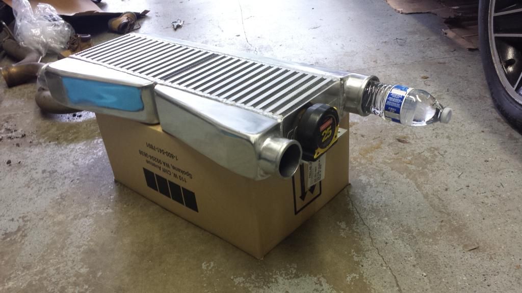

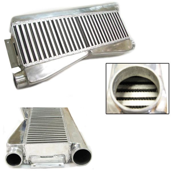

So this is the intercooler I ordered. Will be here next week. Got it on ebay. It was $175 buy now or offer. So I offered $130 and he counter offered $155 shipped. So I snagged it.

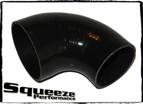

Here is the throttle body coupler I ordered from Squeeze performance. I also ordered a 3.75" t bolt clamp. If you use the couplon code "sloppy" you get like 25% off. and free shipping on orders over $20. Got the coupler and clamp for like $21 shipped

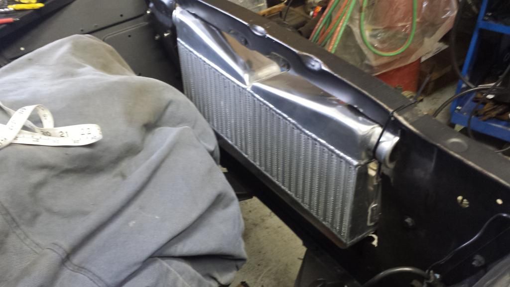

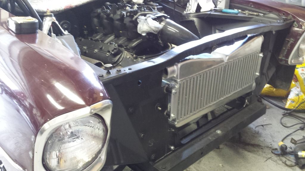

Well I decided to not pull the trigger on the new radiator just yet. So I figured I would start mock up of the intercooler.
Intercooler is pretty good sized
looks like you need to do some more trimming. gonna be awesome. got a pic of it a little further back?

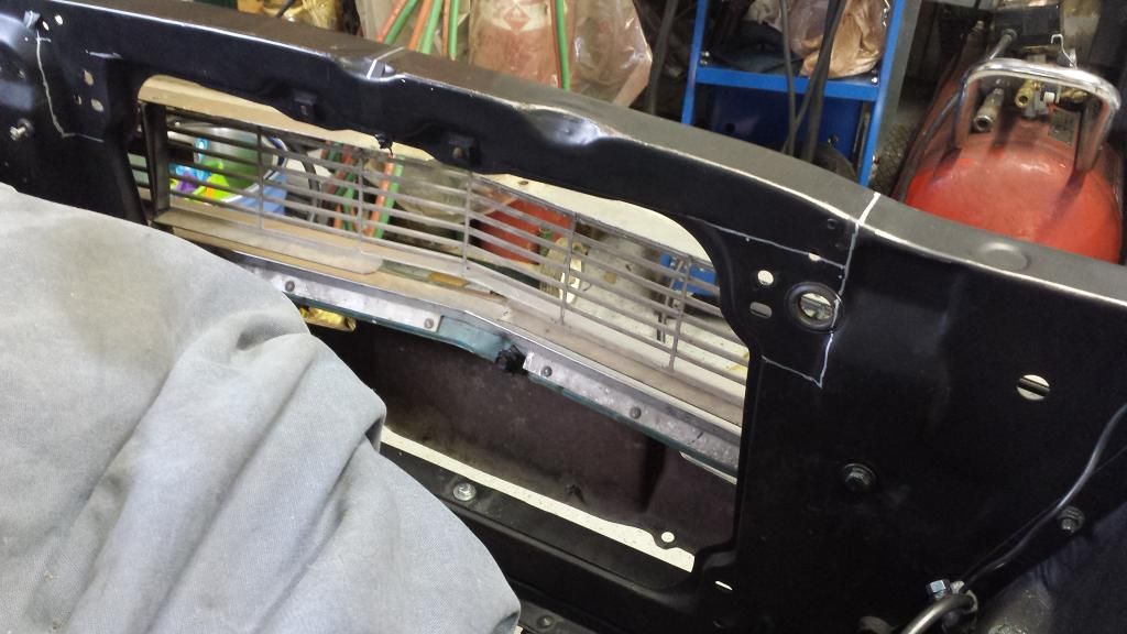

I have to trim out for the silicone couplers, I'm going to pull the grill and the front bumper assembly tonight and get my Depth set then I'll order up my couplers. but before I do that I'm going to dig through my bucket that I have of extra couplers

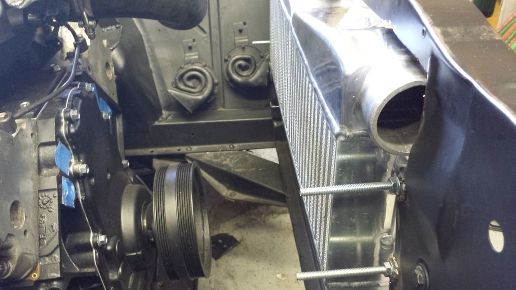

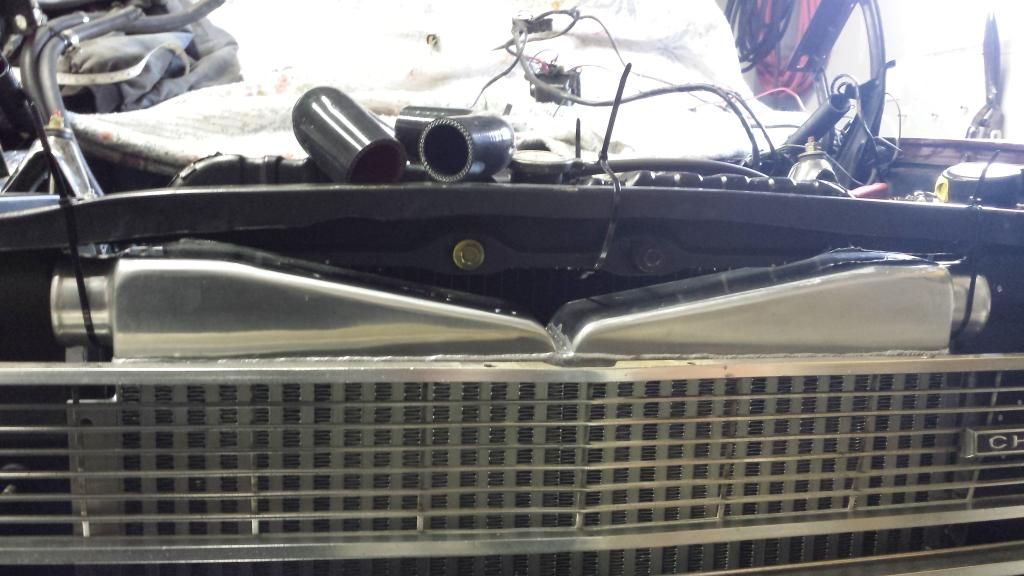

So here is the intercooler bolted in. I pushed it as far forward as I could before hitting the grill. I was able to gain about a extra 3/4" over what I thought I was going to.

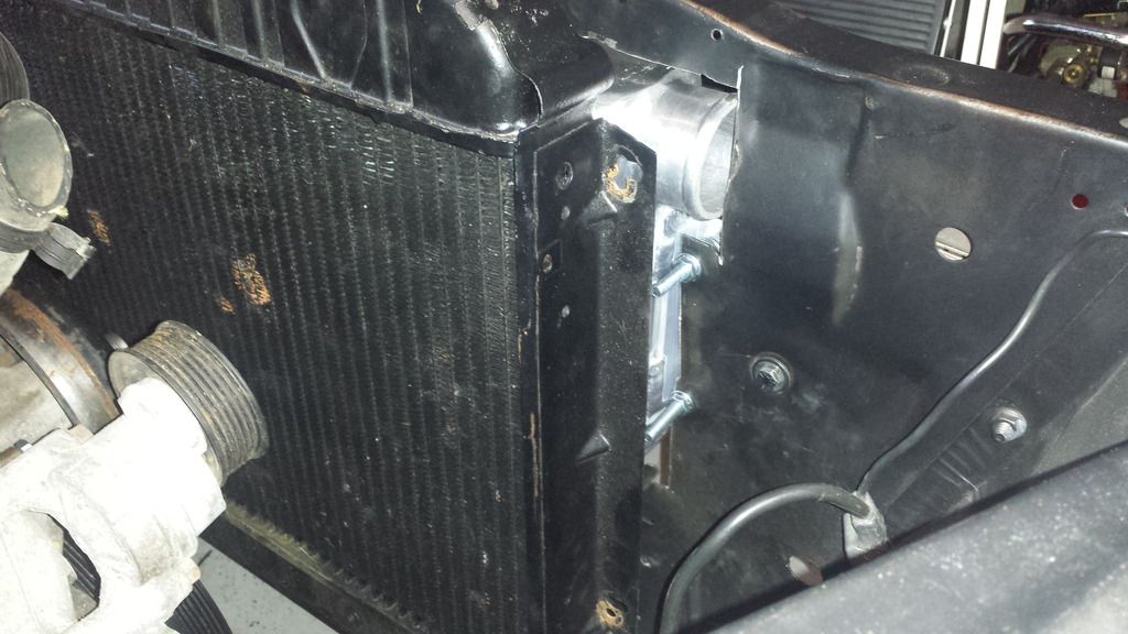

 So in the picture you can see the bolts that hold the intercooler on are a little long. I got some that are even longer and I'm going to drill holes in the radiator flange and mount the radiator on the same bolts. That way I don't have to make any crazy brackets that hold the rad in place.

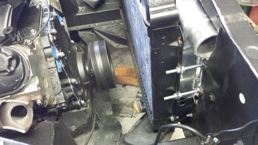

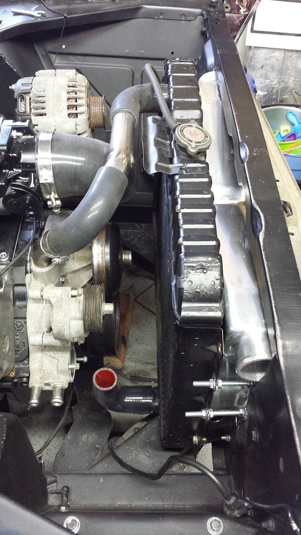

Intercooler Installed for final fit

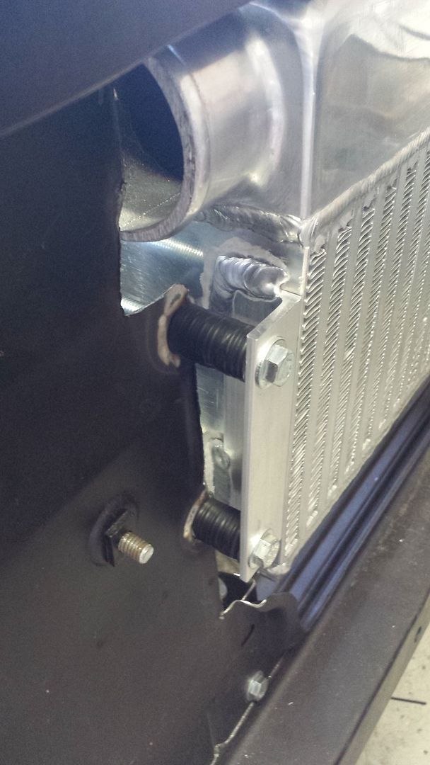

baller shims (washers stacked and then wrapped in electrical tape to hold them together)
Extra long bolts to mount my radiator on
radiator mounted

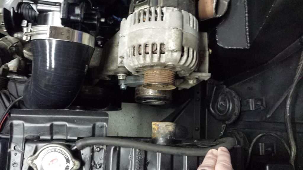

Upper coolant radiator hose made

My charge pipe couplers showed up. I ordered the wrong fucking silicone 90° couplers that come off the turbo. Fuck!! Needed 2, 2"-2.5" 90° and I ordered 2"-2.25" 90° and other than that, all my employees are quitting at work. Have a feeling that my 2 hours a week that I have to work on the car are gone for a while.....lol fuck me!!
And the dumb asses on ebay sent me 2" 90° couplers instead of 3". Well, I guess I can start mocking up my turbo manifolds. And sump my gas tank.
