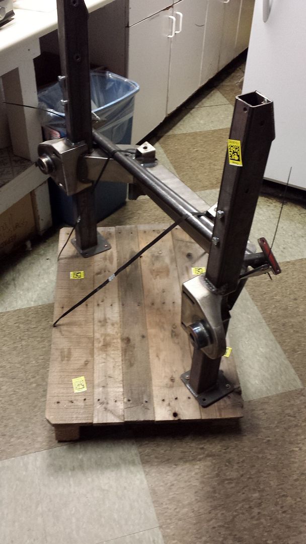

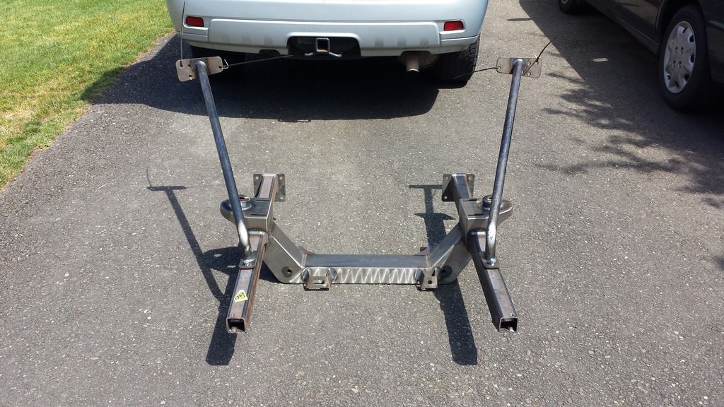

Well the front clip showed up today looking like this
So I unstrapped it and pulled it off the pallet to get it in the back of my rig. Got it home and went to just hand tighten the support bars that come from the firewall down to the frame. There is 2 bolts on each frame rail. Looks like the plated that bolt them to the frame rail looks like they are drilled just a little off. No big deal. Looks like I will have to oblong the hole just a touch.
Here it is with 1 bolt holding them down
I will say the welds are pretty damn good. Clean lines and good penitration on everything. Gonna start tearing into my stock front end for disassemble this weekend.

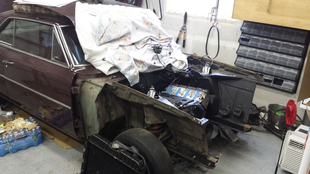

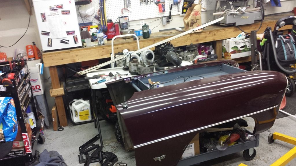

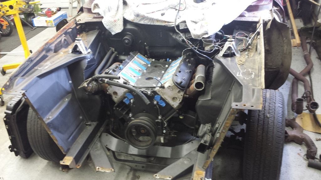

Ordered up my spindles today. I guess once they get here I'll pull my wheel and hub and see how my "theory" of brakes/wheel hubs work out.
So the disassembly has begun. Now I'm at the point where I need to borrow my step dad's engine hoist and pull this back out and swap front ends.

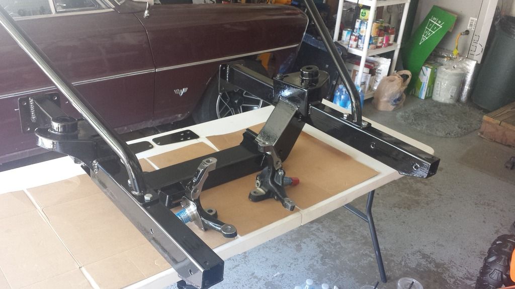

Well I painted the frame last week with POR 15. It's kinda funky, you paint it in with a brush and it dries smooth. It's hard as a rock and requires at least 2 coats. Weirton thing is after the first coat I let it dry about 30 min and go to put the second coat on. Goes on kinda tacky like the first coat is drying and then once it fully dries it has little bubbles here and there like I painted dirt into it. Not that I care all that much but looks kinda shitty compared to how it looked right after applying the second coat. Will say that it looks just like powederciating.
So today I pulled the spindles out and was gonna por15 them as well and low and behold they were already painted. Sweet!!!
