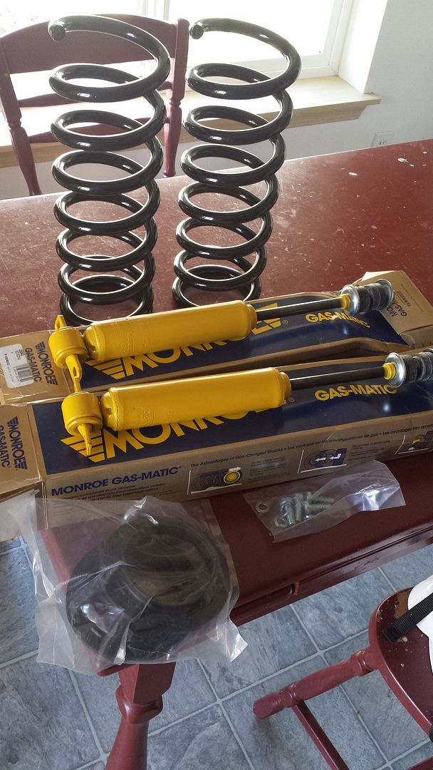

Ordered up a set of springs and shocks. Went with 325# springs. Figure it will lower it a little and eventually I'm gonna go to coilovers do these will probably work for now. I hope.
Sounds squishy.
Just the way I like it..... :?:
Springs, shocks and hardware showed up. Need to get in the garage and start assembly!!!!

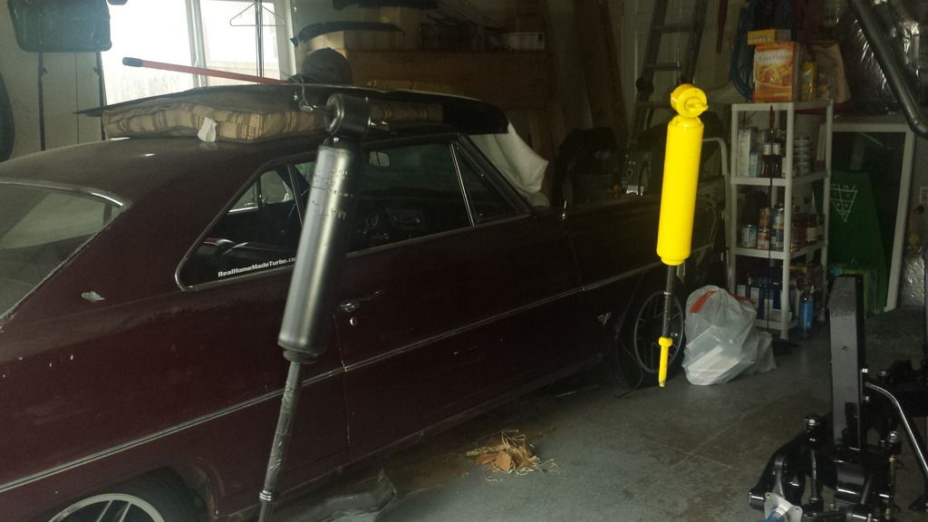

Front on mine is still spring shock but adjustable shocks.
I'll roll with this for a while. Eventually I'll go to a coil over with a dual adjustable shock.

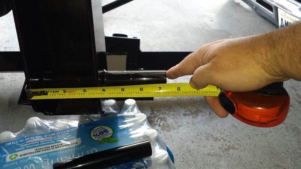

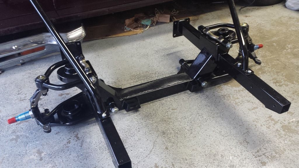

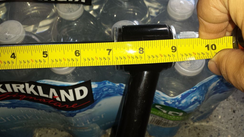

I was gonna do a dry fit on everything b4 i bolt it onto the car. That way if I have to mod anything I can do it while it's off the car and I can take it to a friend's to have anything machined and whatnot. If I need to. So I went to go bolt the lower control arms on just to see how they fit and they don't fit....lol so I'll get pics and post up what I'm talking about. Need to take about 1/4" off of the lower a arm support sleeve so the a arm will slide on. I'll take pics of what I'm talking about later.
So here is what I got. The frame portion measures 7 5/16"
 And the arms with the washers measure 7 1/8"
 so should I just say screw it and cut 3/16" off the spacer that's welded to the frame so the a arm fits in? Because I'm pretty sure that's what's gonna happen....lol
Hell, that's probably what I'd do.
Good, because that's what I did. They fit good now. Might hit them a little more with the sanding wheel to just make it a little easier to put the washers in.

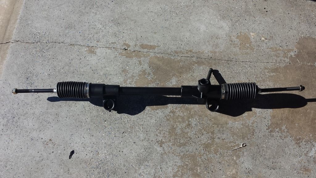

Ordered up a steering rack today. Comes with tie rod ends and bushings and bolts to mount it up. Not to bad for like $74 shipped....... :D http://pages.ebay.com/motors/link/?nav=item.view&id=321608795346&alt=web
Little work done today. Didn't like the ricer yellow on the shocks so it got the low gloss black treatment. Finished dry fitting everything up and after I trimmed the lower a arm sleeve/spacer off the frame the lower a arms fit great.
So my ebay mustang II rack and pinion showed up today. Came with mounting bolts, mount busings and tie rod ends. All for $73 shipped. Not a bad deal. I didn't care for the mexichrome pain it had so I gave it a good coat of the old low gloss black. Turned out pretty good.

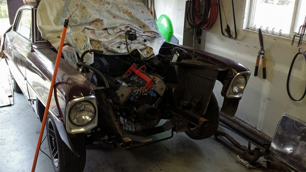

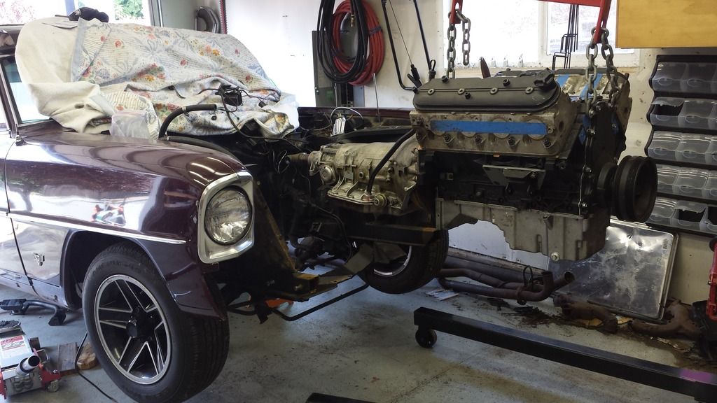

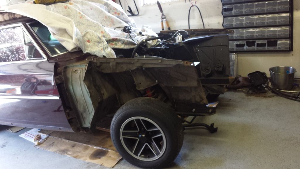

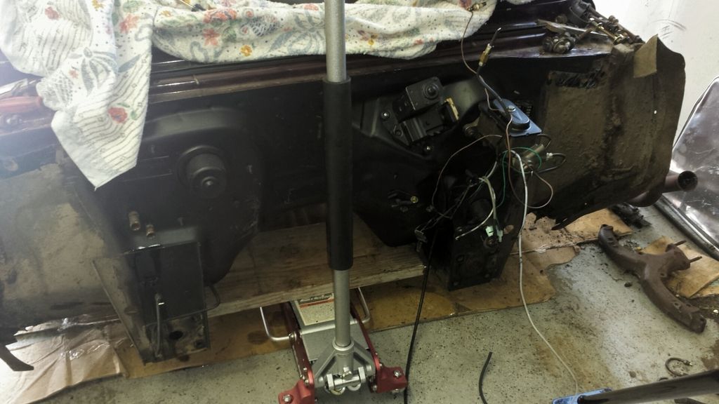

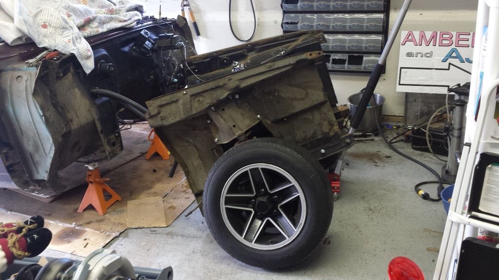

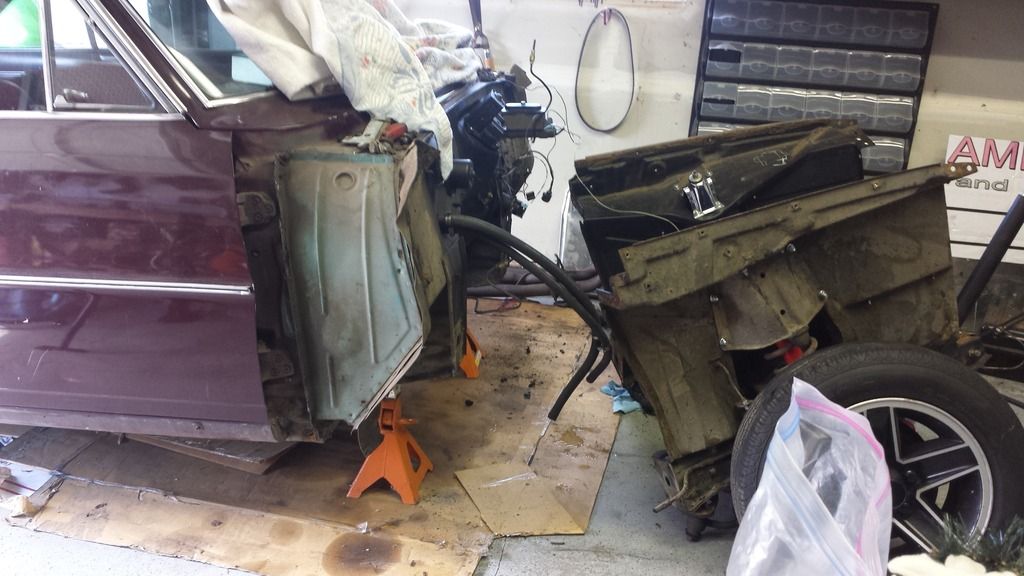

Well, the removal has begun

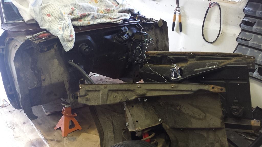

Fenders off, and steering box and steering column shaft pulled.

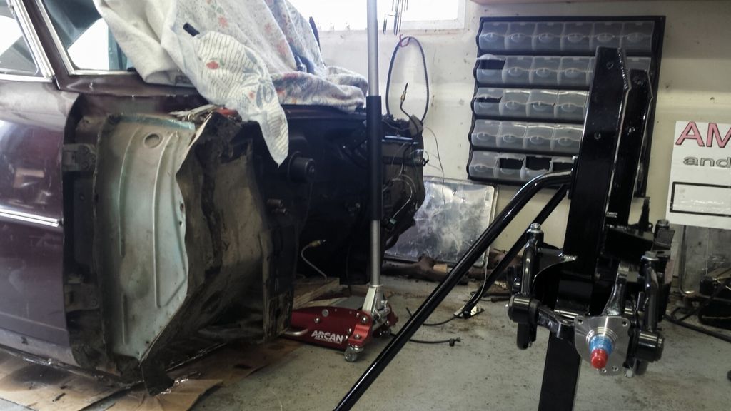

So now the next step is to clean the firewall up and give it some paint love. And then bolt the frame on, and go through the transmission and put it back together then bolt the engine to trans and slide it in and weld up some frame motor mounts. Pull the motor back out and and then do final assembly.
so awesome.
is it as easy as it looks? your car use to be turquoise?

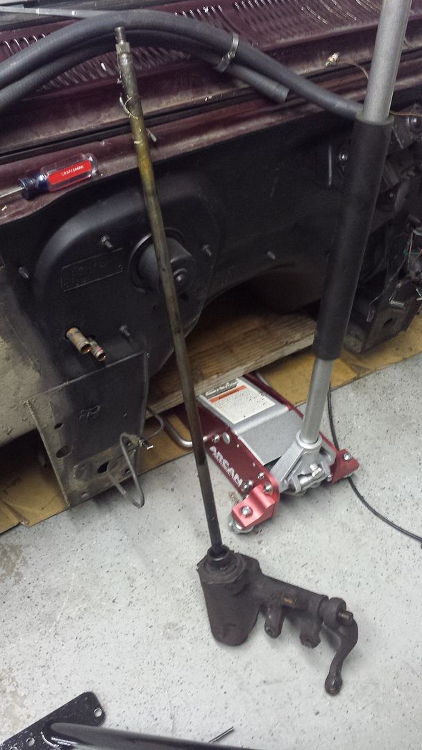

Yes and yes. Pull pass side motor mount off frame, undo 2 bolts inside car that hold column to dash, pull steering wheel, unbolt the 3 bolts that hold the steering box to frame, Unbolt the pitman arm from the center link, undo brake lines and fuel line, then unbolt the 14 bolts that hold the frame to the car. Roll it away.
doesnt the steering box come apart from the column shaft?
It might, but from what I've read the 66 and earlier dont. But the 67 does.
