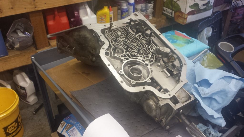

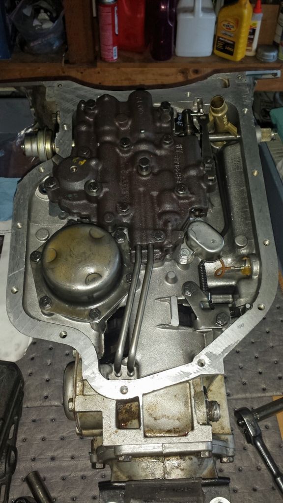

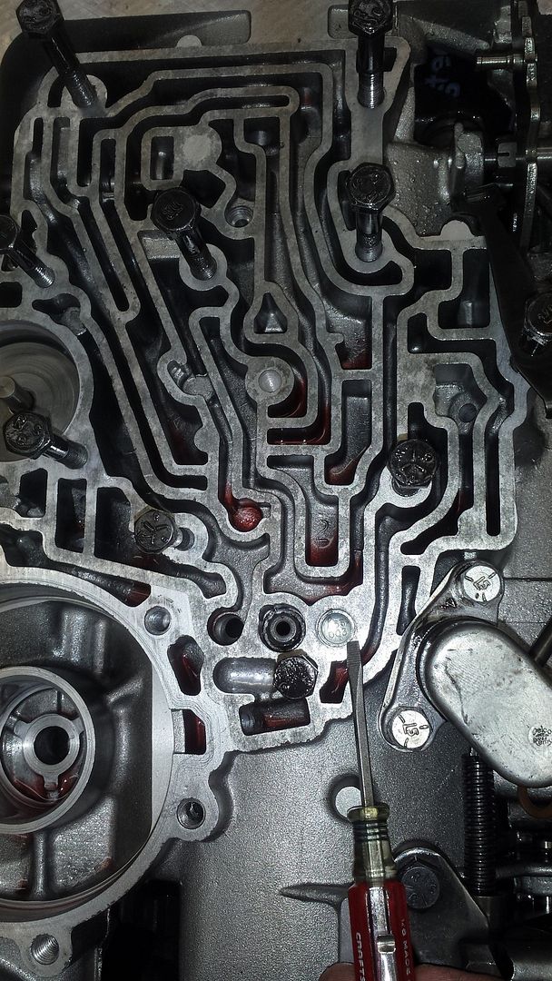

Well, I got most of the th400 back together. Nice and clean inside. Dual feed mod is done. Now it's time to mod up the valve body and slap that shit back together.

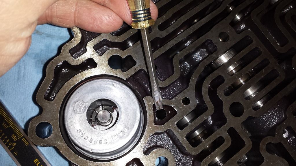

Here you can see I installed the dorman 555-003 7/16 cup plug.
Here I'm pointing to the spot that needs to be tapped with a 5/16 set screw. You can also see the cup/piston on the left. That is a shattered e/c clip inside there. I don't know how it never fell apart but it didnt. So it looks like I'll be hitting up the hardware store for one. After that I just need to do 2 more little tricks to the valve body and separator plate and slap it back together for good. It's amazing that all these mods for this th400 are pretty much free and it should be able to hold 700+ whp. Pretty pumped, so close to being done.

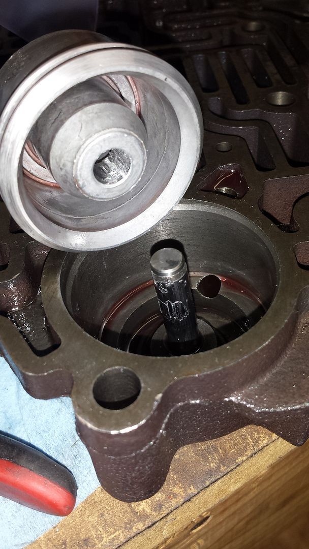

Well I went to pull the broken E clip out of the valve body, and I had to use a pair of channel locks to work the piston up. got it off and the piston out and the piston shaft is all galled up. So I spoke with @jakes performance about driving the old piston pin out and replacing it or if I would have to get a whole new valve body. He said since im plugging the feed to it and removing the spring for it that I should drive the old pin out and use a 1/4" bolt and just bolt it in place to keep it from moving and I will be 100% good to go. Man I love free mods and great advice!

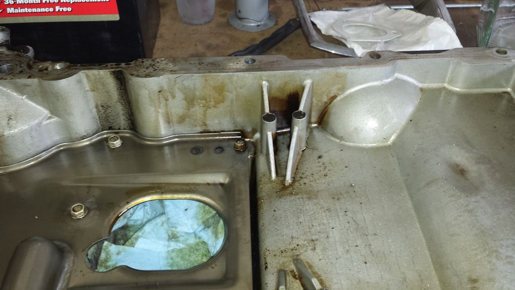

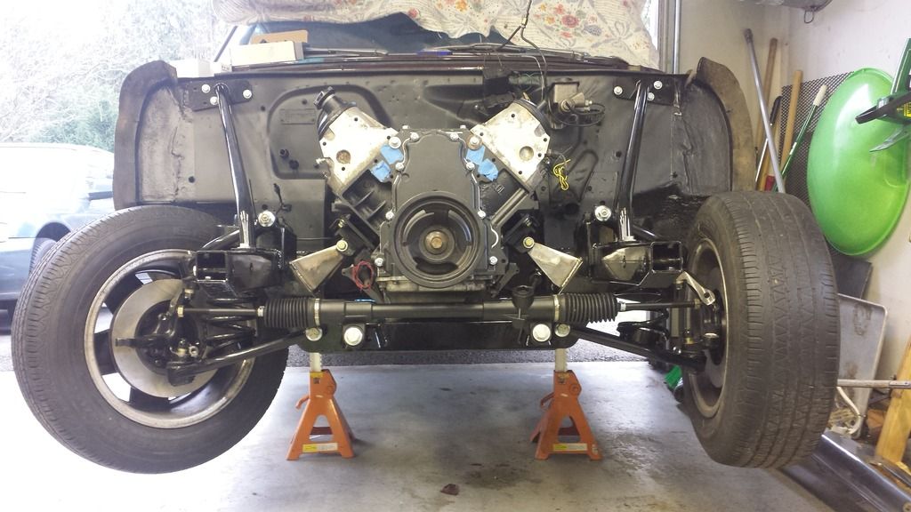

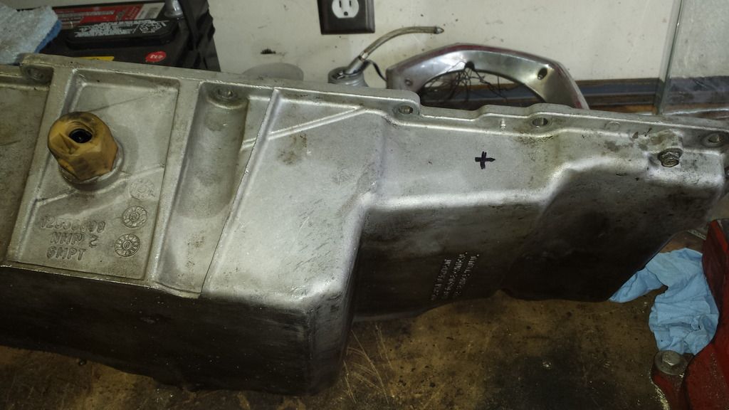

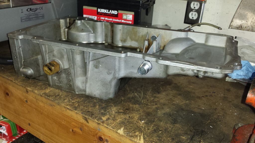

Ok, so I bolted the fbody pan up and dropped everything in to check clearances. All looks good so back out it came so I could pull the pan and tap the oil returns for the turbos. Here's where I'm at now.
All in and fitment looks good.
Empty once again but all the suspention up front is done.

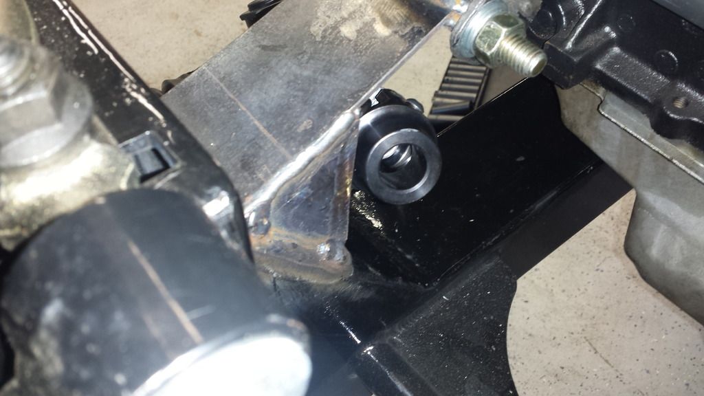

About 3/16" of clearance between my set screw on the u joint and the frame mount
About 1/4" on the backside
Here is the pass side pan where I'm gonna tap it with a 1/2" npt and screw it down.
Here is the drivers side, I'm gonna put it right between the webbing.
And all done

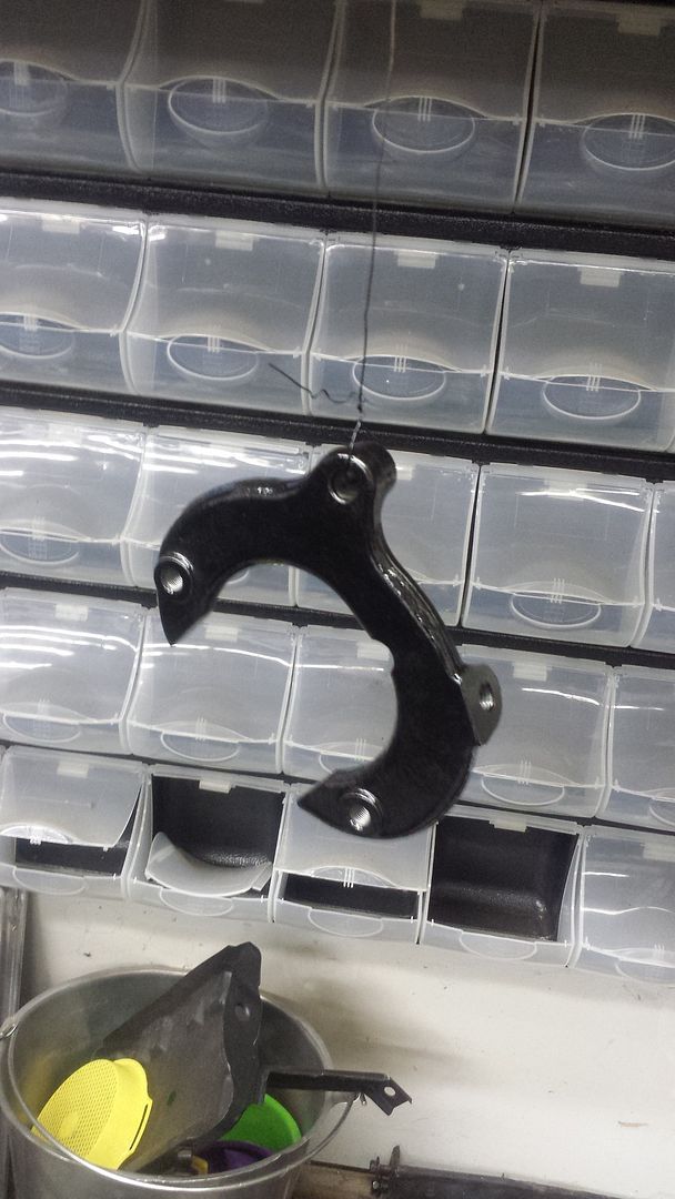

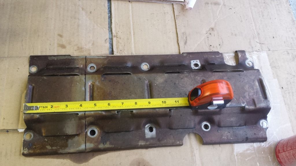

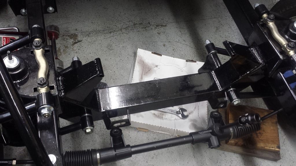

Well, I got the frame mounts cleaned and painted, and I figured since I had the paint out I would paint up my brake caliper brackets. And since I had my grinder out to clean up the crossmember I used it to also cut down my truck windage tray. I cut 4 3/16" off to make it the same as the f body.

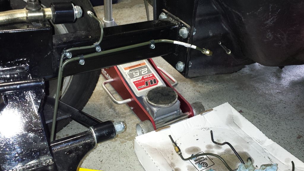

« Reply #825 on: December 20, 2015, 04:52:34 PM »

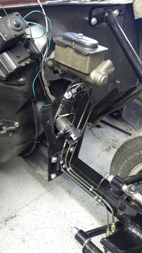

Little bit of brake line work. All bent and flared. Just have to do one flare on the line that runs to the rear of the car and then slap the calipers on and bleed the system. If no leaks then I'll stuff the motor and trans in.

looks nice and clean. looks like you spent time thinking out the placement. not like the hackjob after thought of the disc brake conversion on my car lol.

Hard brake lines are all done and connected. Inner fenders showed up today. I have bought and returned 3 different rotors, and 2 different brake calipers. Trying to figure out what I needed. Got tired of fucking around and after all this fuckerey I ordered a set of 11" rotors that are 5×4 3/4 from speedway. So once they show up, I hope my junkyard calipers that I picked up a couple of months ago fit. I guess ill figure all this shit out once the rotors show up.
New rotors showed up. Turns out after all my research it looks like they are ford granada rotors with Chevy bolt patter cast into them with the Chevy 7/16 studs too. They were $39.99 each and another $60 for shipping, but if I spent $100 it was free shipping. So I bought another bearing and seal set. Which brought it to a grand total of $107 shipped. If I can reuse my bearings and seal that are in my chevelle rotors I will. And then I will just have a extra set of them sitting on the shelf if I ever need them.
We're getting ready to sell our house so I'm packing up boxes this weekend to move into storage but hopefully in the next few days I can sneak out to the garage and slam these on and bleed my brakes.

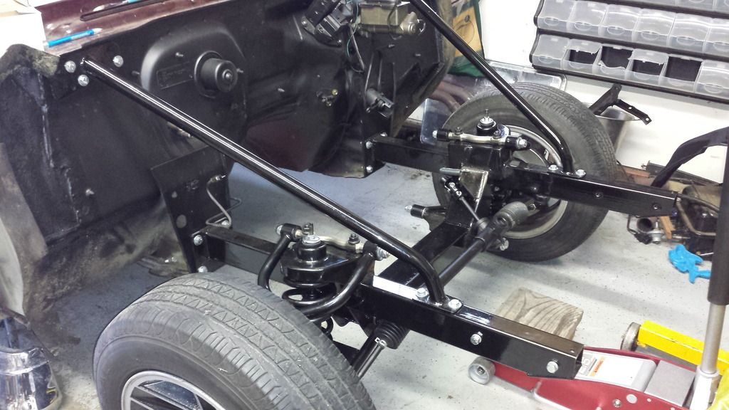

So, new rotors fit perfect. Went to bolt on some rubber lines from a 81 camaro and they fit great besides I had to move my hardlines because when the tire was at full crank it would hit them. So I recently and today I put the pads in. Went to go blead the brakes and the drivers side brakelines is leaking at the caliper. Probably has a old washer or something stuck to it that I didn't see. Gonna pull it tomorrow and try to bleed it and get it back together. Probably won't happen until the weekend though. Once the brakes are all done, the motor is getting put back in and then fit my inner fenders and all that.

On another note. Photo bucket is being gay and not uploading pics. But the brakes are in. No leaks and blead enough to see that there isn't fluid all over the floor. Motor is back in and now it time to test fit the inner fenders.

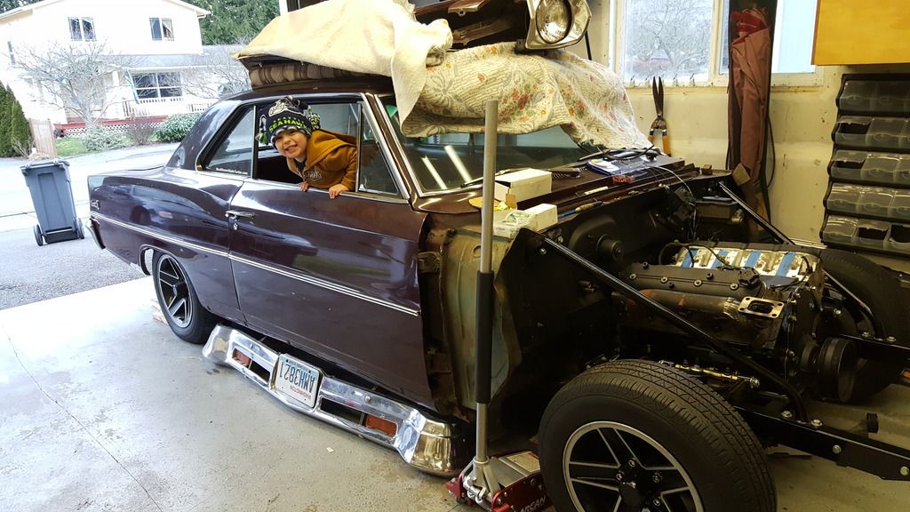

Idk what happened but pgotobucket just uploaded the same pic 9 times. Anyways, the boy has been asking me for like 2 weeks to go for a ride in the nova. This is as close as he gets for a while.
