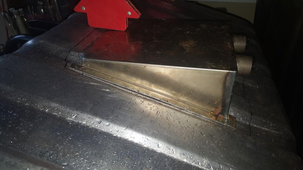

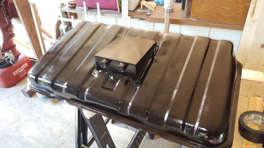

Yeah the fenders make me want to bash them with,a hammer. Which might just happen. Or I just won't run any. So today I started work on my sump for my fuel tank.

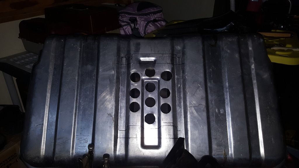

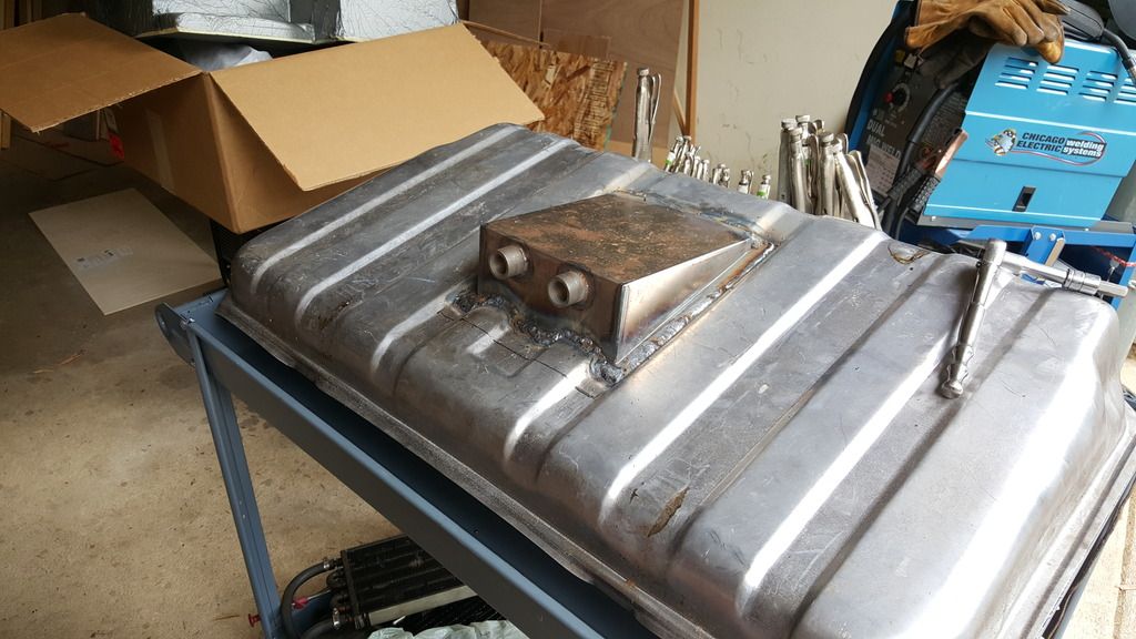

All trimmed, now I just need to drill some holes for the fuel to get into the sump and fire up the welder, set it to nignog and burn it in.
Ok, holes are drilled and the large chucks of metal are out of the tank. Now I just need to wash it a shit load of times and then weld the sump on. Gonna give it a shot tomorrow if I get time.

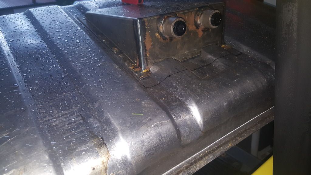

Welded it up. Filled it with water and got 3 little pin hole leaks. Circled them with a sharpie and emptied the tank. Gonna weld up the pin holes tomorrow. Don't really care how it looks because I'm going to under coat it black with wheel well liner so it just disappears into the undercarrage. Also going to probably put that gas tank sealer shit on the seams where I welded it on the outside too.

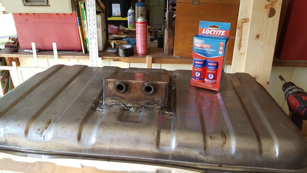

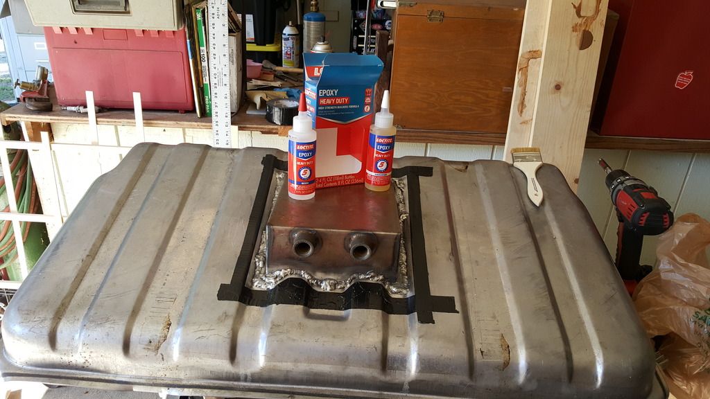

Well the tank is summed. Fixed the pin holes and then epoxyed over the welded areas. Then I used undercoating and then once it dried I hit it with some paint.
Taped off the area I didn't want epoxy
Layer the epoxy down, waited 10 min of so and them peeled the tape off.
Here it is all done just waiting to cure
And now here it is all painted. Just waiting for the paint to dry for a few days b4 I shove it back in.

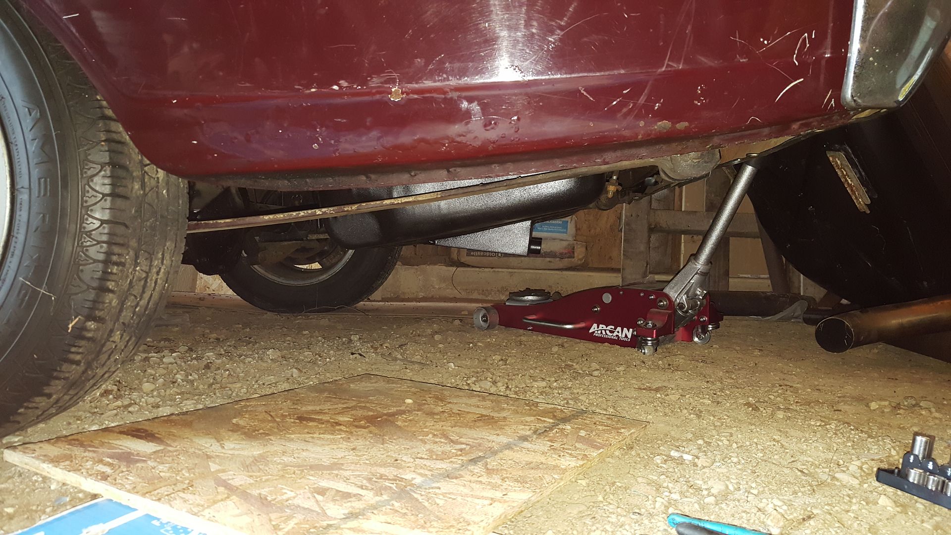

Well, the fuel tank is in and the sump looks killer. Blends right in. Just the way I wanted it too.

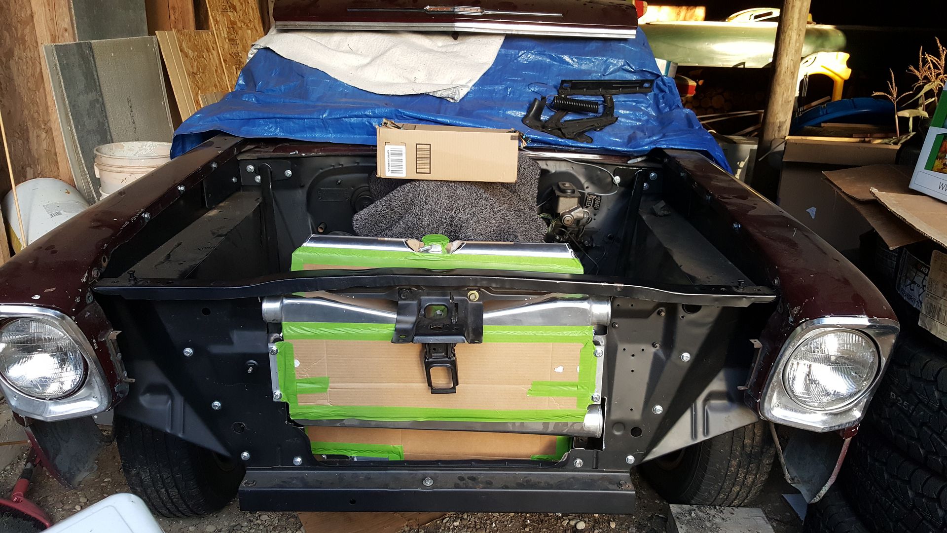

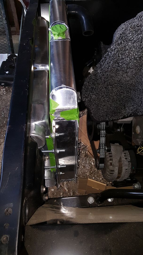

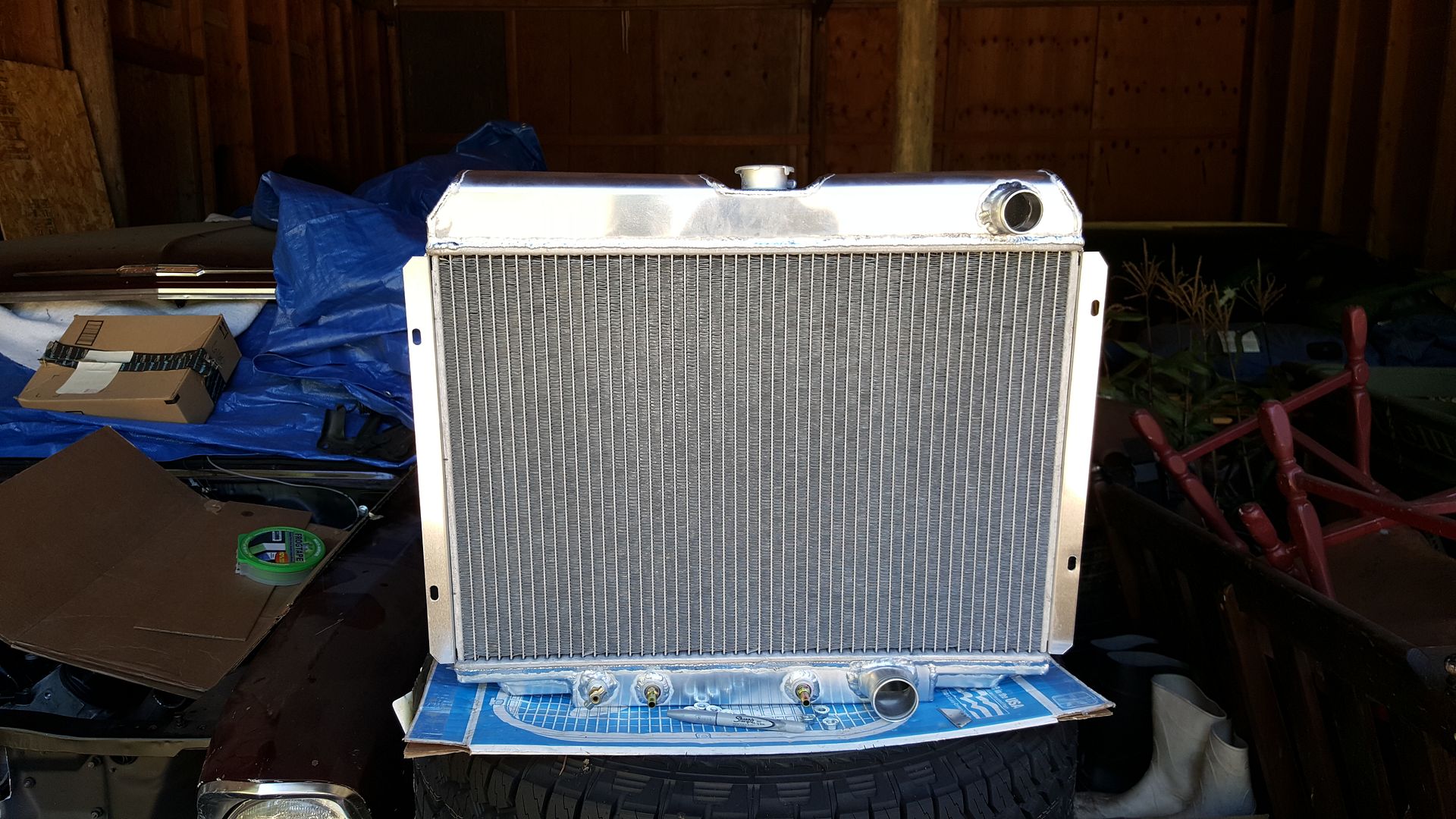

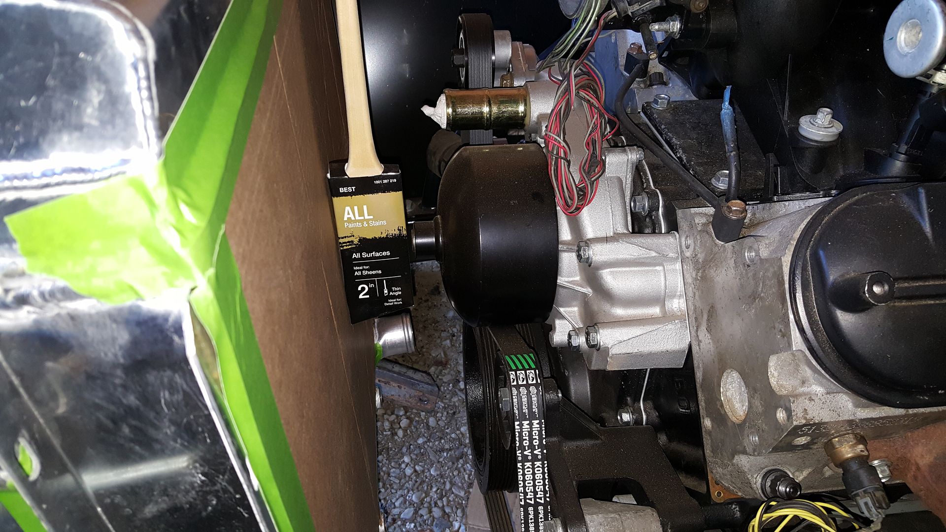

Now mock up time. I picked up a (I belive this is what it was from) 69 cougar xr7 3 core radiator off of eBay last year sometime. Has the correct in and out placement for a ls and the correct hight and width for the nova. Fits well but I need to get a couple of pieces of aluminum to add onto the sides to I can bolt it in place.
And yes, I have a whopping 2.5" between radiator and the intercooler.

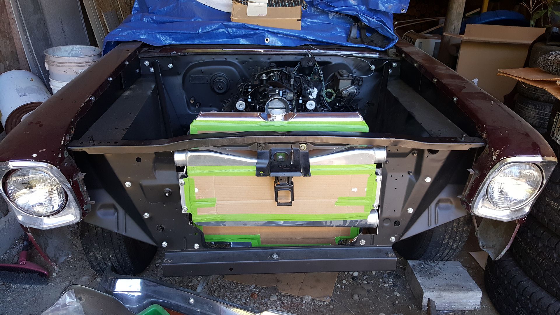

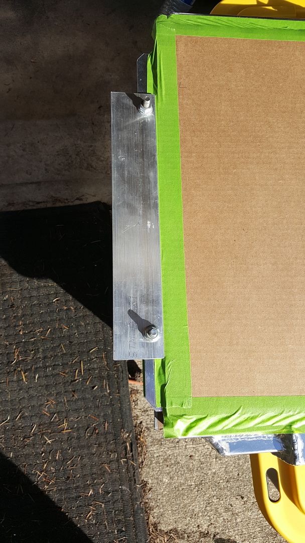

Well, radiator installed and I put a couple of balls of tinfoil on the radiator and set the hood on just to make sure it wasn't to high. Fits perfect with no issues.
