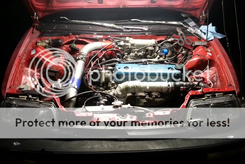

Its running!

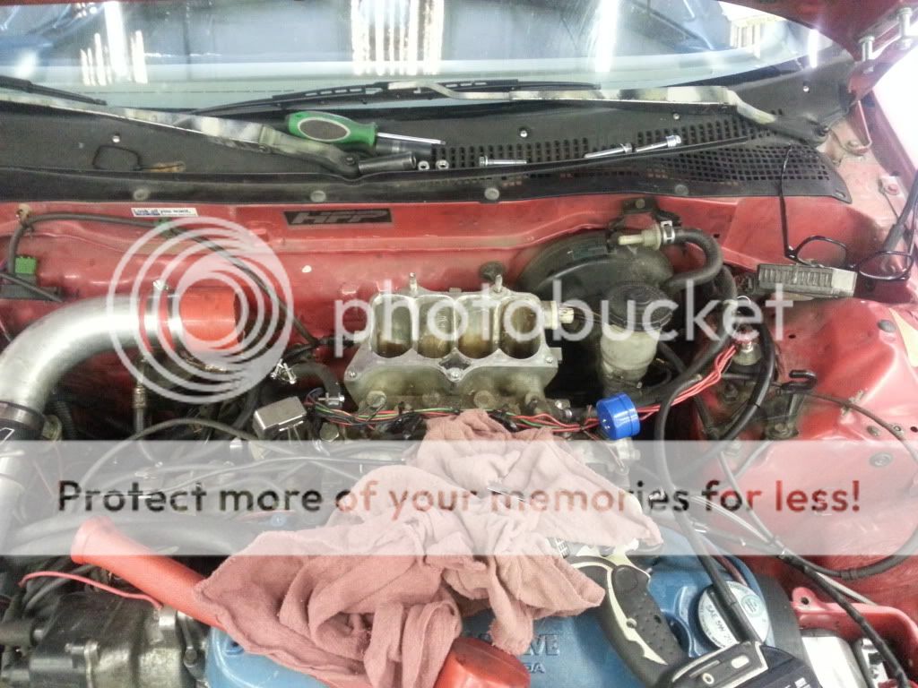

What a fucking pain. I had to trim the block a bit.
Originally how I was going to run the charge piping. Didn't work liked plan.

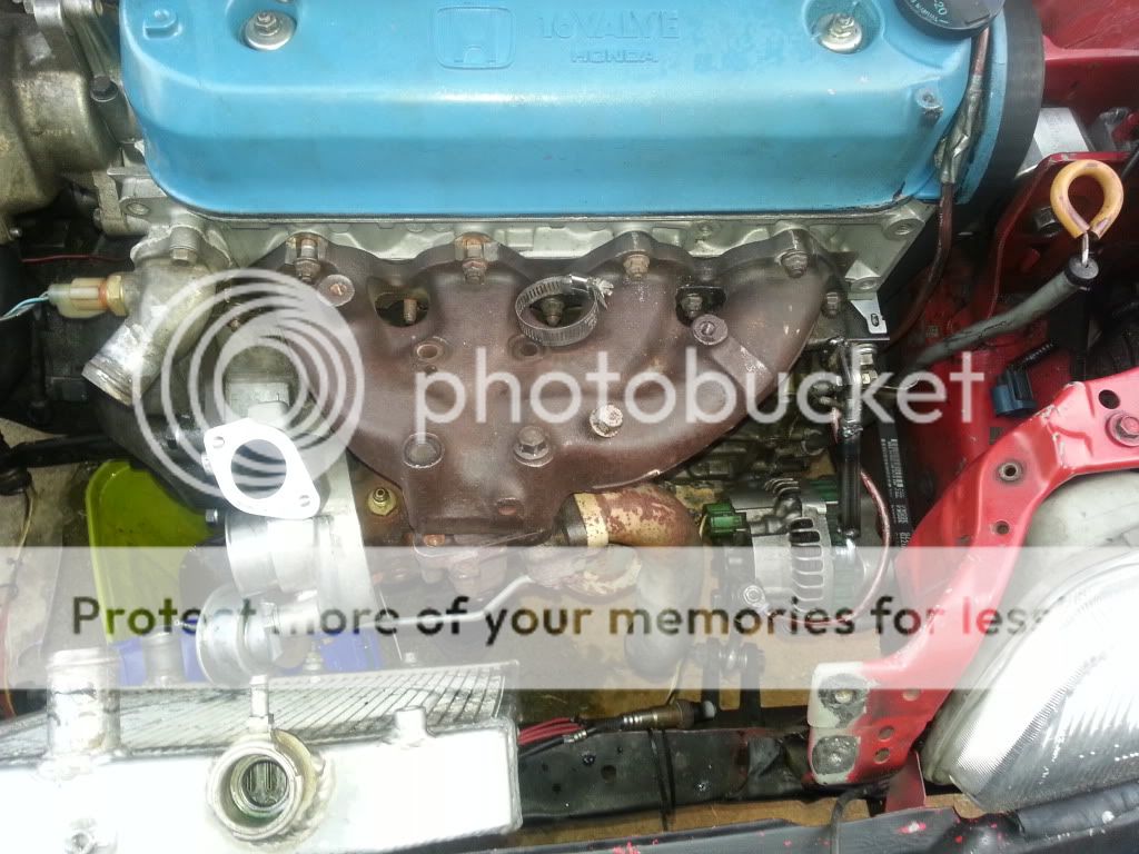

Here's my ported f22a6 manifold
And

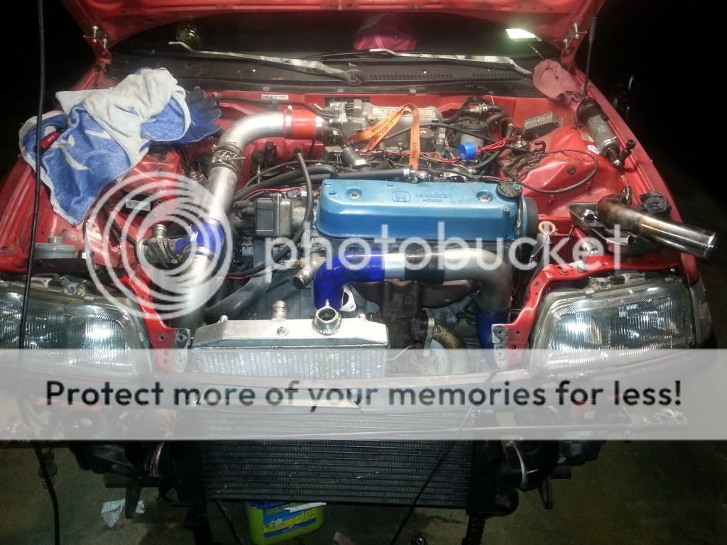

complete
Its been running for a week I had a shit ton of boost leaks but its good meow.
I traded a ported f23 manifold and cash for some HiProfile 800cc's Injectors and its running pretty quick. I'll post a video one day.

Yeah its pretty beastly. spools 7 then creeps to 16. I think I have a boost leak  :'(

Factory one isn't hooked up. I have a guage in its place.

Got a New job at the local toyota stealership in teh parts department. November.
Head is off. I'm going to slap some rings in a f22b1 and swap this hoe out. Present day.
Hows the hood clearnace?  Nice build.
Ummm pretty good. I had to switch to a newer oil cap and shave it down. I have about a 1.5" risers on it. I also trimmed some of the ribbing out from underneath the hood.

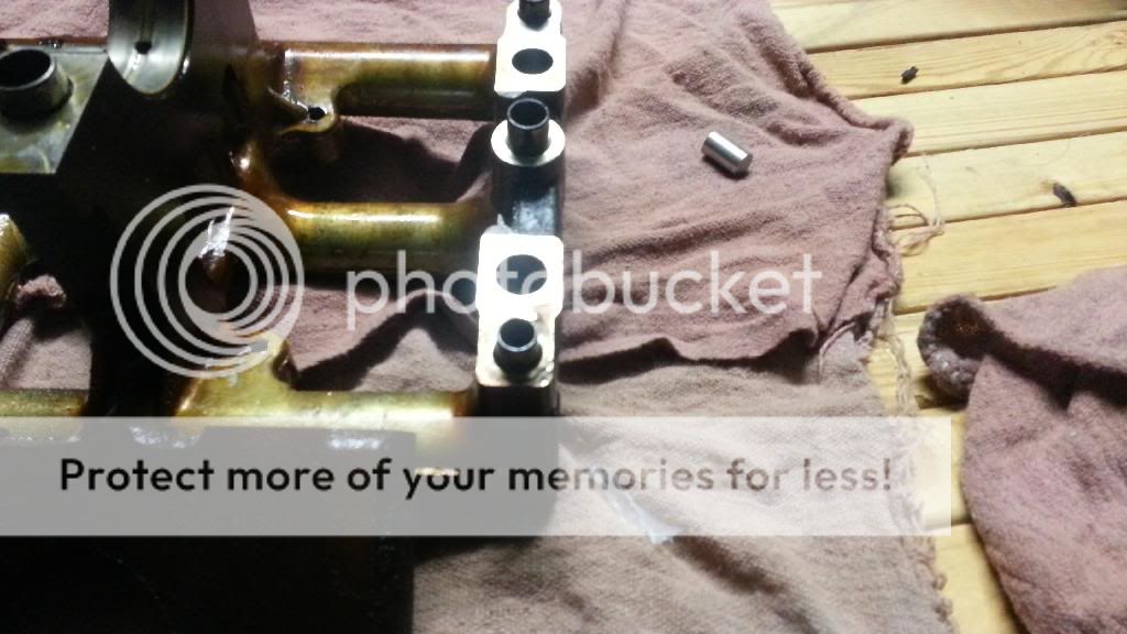

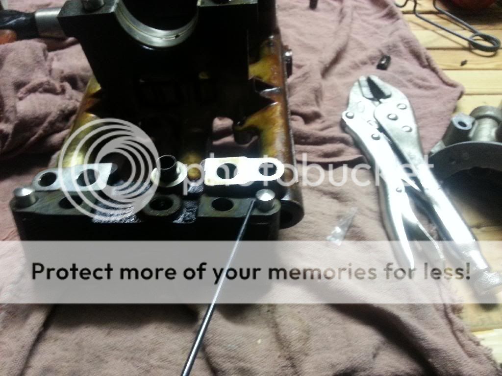

Ordered some bearings from Honda they won't come in till this weekend maybe :< in the mean time I installed some solid dowels to block off the oil ports to the balance shaft bearings.
