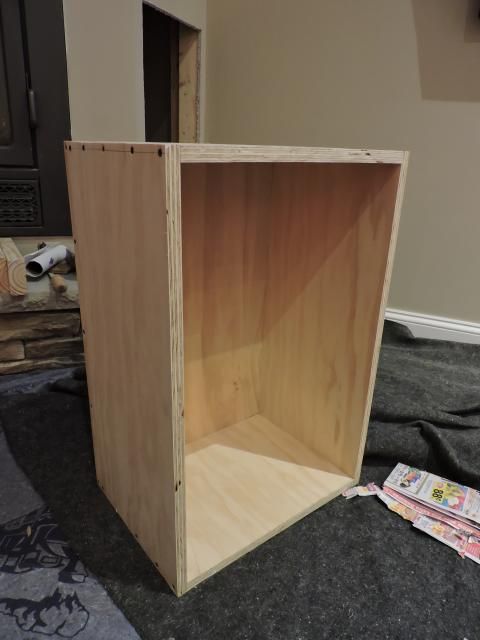

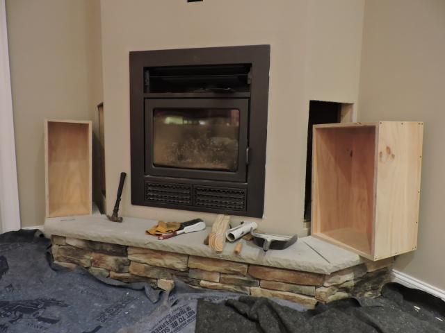

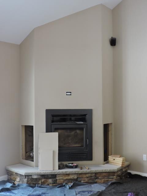

Decided to put some cabinets in before I put stone on the fireplace.  If I do this right everything will be hidden and you won't be able to tell something is there,  Cut the drywall so there's no turning back:
Built 2 boxes out of 3/4" cabinet grade plywood:
In place.  I ordered drawer slides so I can't make anymore progress till they get here:
Once I mount the slides on the boxes I can put up cement board over everything and start on the stonework.  Stay tuned

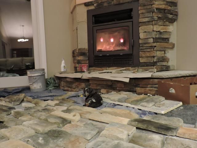

« Reply #305 on: February 25, 2015, 08:39:44 PM »

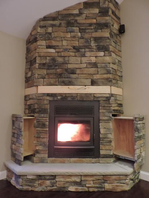

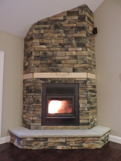

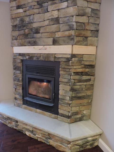

What a pain in the ass but finally done.  House looked like a warzone for a while:
Finished product:
For guns, drugs, and money:
Next I've got to build 2 mantles.  I've got electric ran to this one cause I want to put lights in the mantle.  That's the next project.

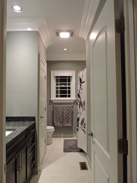

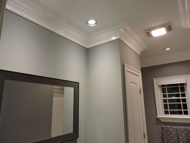

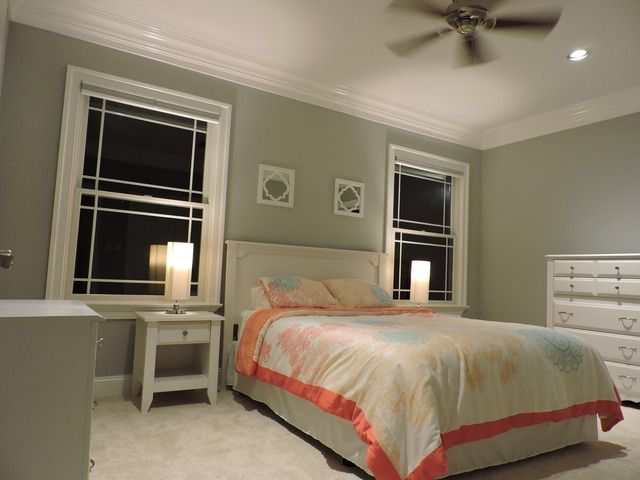

Put up some stacked crown molding in the guest bathroom and bedroom.  It's a 7 1/4" crown with 3inch base underneath.
Before:
After:
Painting it was the worst part

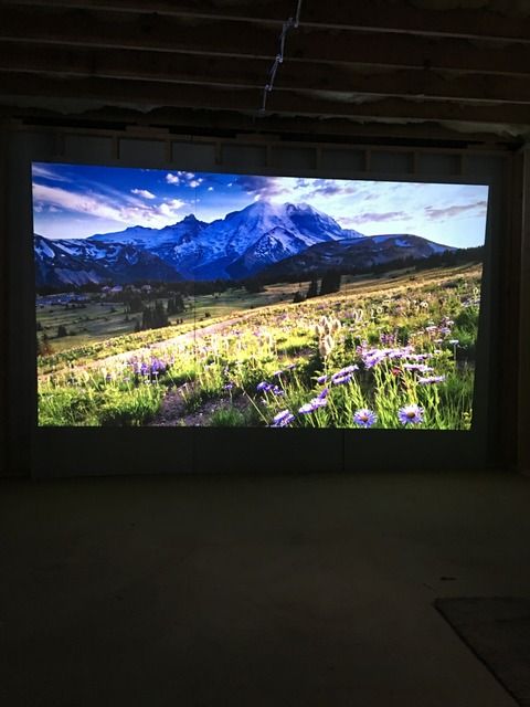

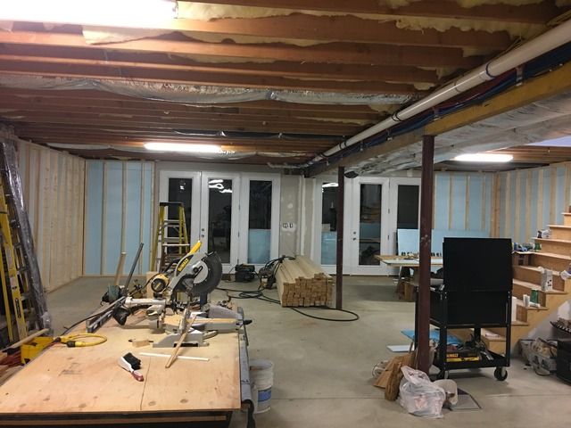

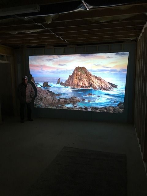

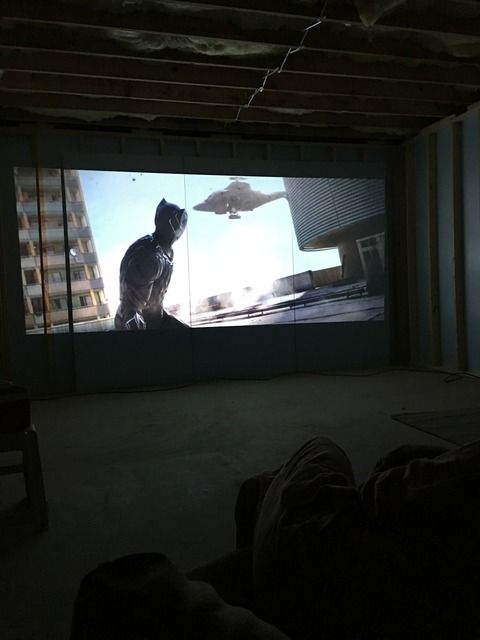

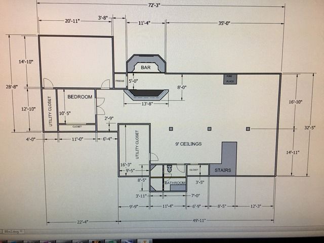

anyone still here?  I'm still alive and starting on finishing my basement.  Here's the plan:
Got the rough framing done:

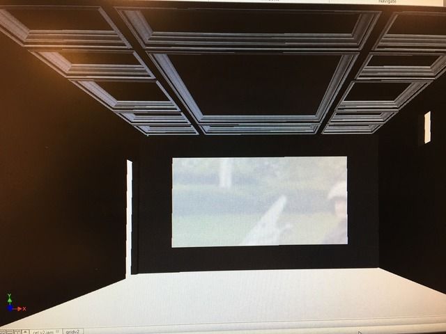

Starting on my home theater.  I just got the projector to help with the layout.  4K 175" 2.35:1 screen.  Right now its projected on blue foam insulation
Here's what the room will look like coffered ceiling with led lighting:

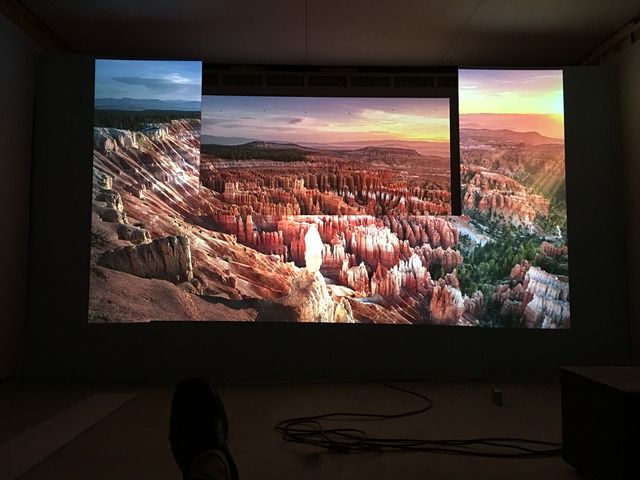

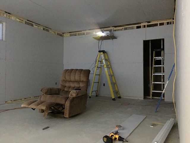

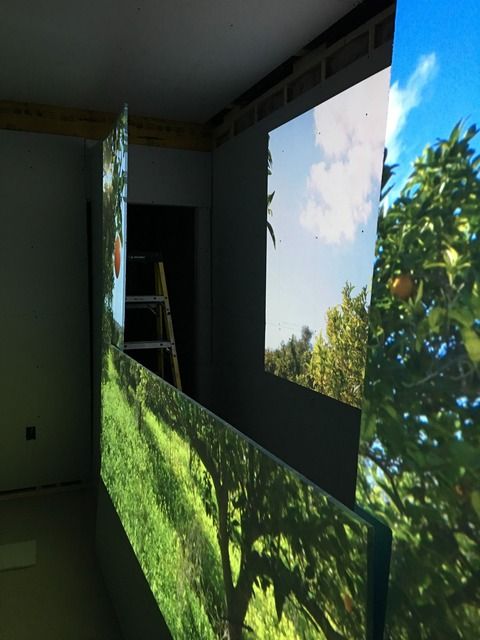

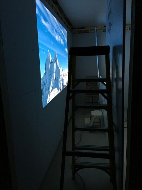

I insulated the whole room for soundproofing and hung the drywall.  Still need to tape.  Put up a temp shelf to check the projector height and seating.
With the screen size of 175" it doesn't leave much room for speakers.  I'm debating about doing an acoustically transparent screen, building a false wall and putting the speakers behind it like this:
I'd space the wall 3' from the existing wall like this:
the difference of moving the screen 3' closer:

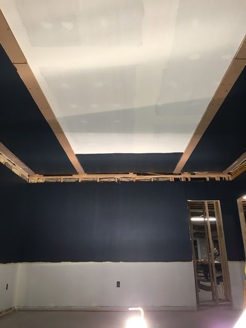

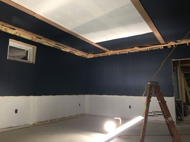

Started painting and hung nailers for the coffered ceiling.  The unpained center section is getting a fabric panel which I'm putting fiber optic lighting in:

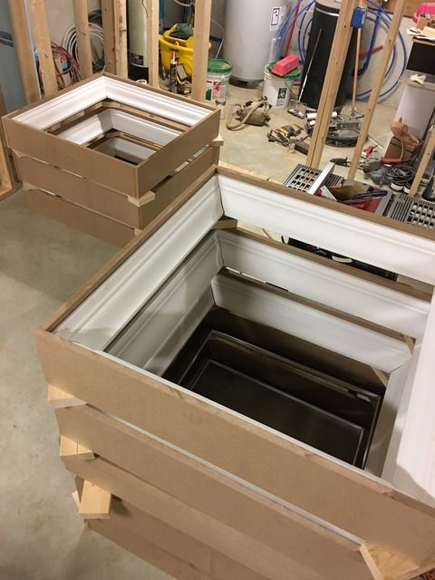

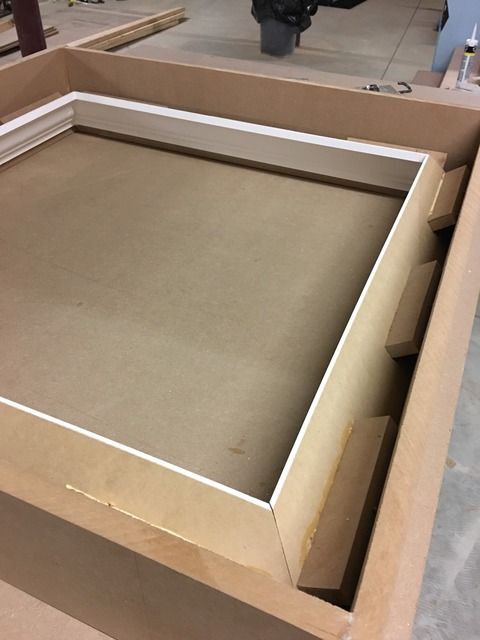

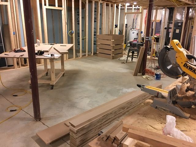

Have 9 sheets of MDF cut up.  Started gluing and screwing boxes together:

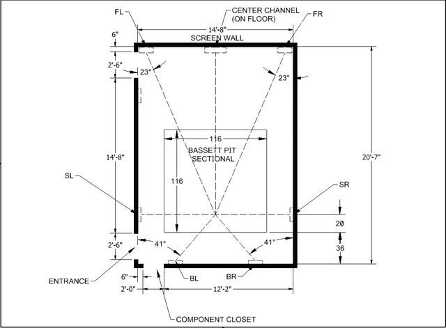

I decided against the acoustically transparent screen.  I'm doing 7.1 surround sound.  Here's what I'm thinking for speaker placement:

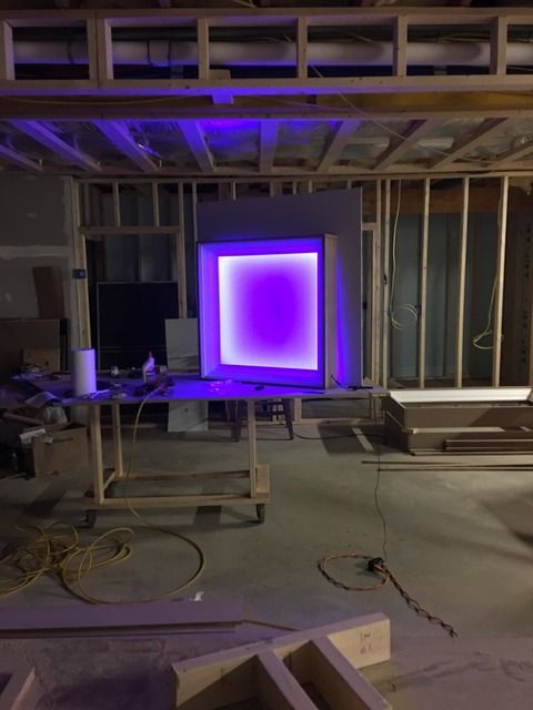

  • Posts: 90765
« Reply #329 on: April 21, 2017, 11:42:52 PM »

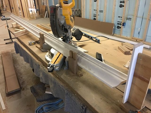

Setup a little jig for the chop saw and started cutting crown:
Results:
Here's the mounting from the back of the crown:

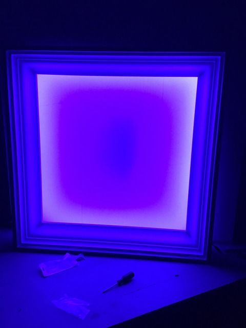

Testing out the LED lights mounted behind the crown.  The are RGB so you can pick any color.  Tough to take a picture of:
Hopefully I'll be mounting these to the ceiling soon
