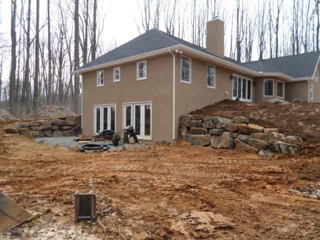

Day 3 progress.  Last wall is done, on to final grading:

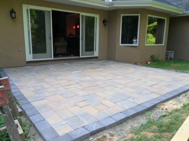

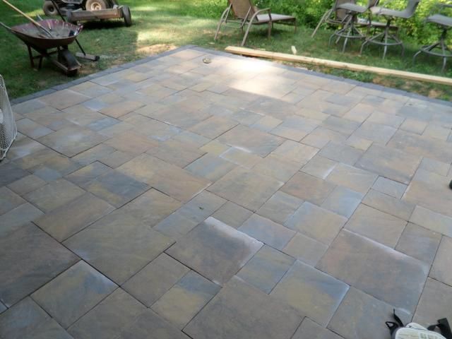

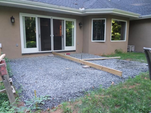

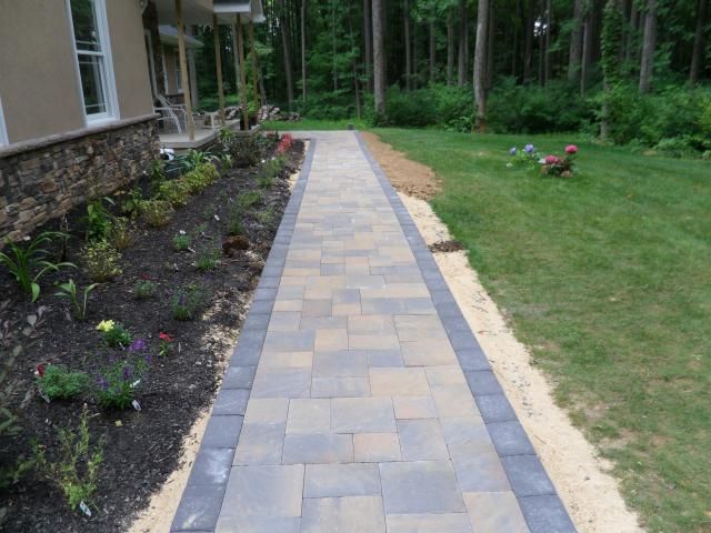

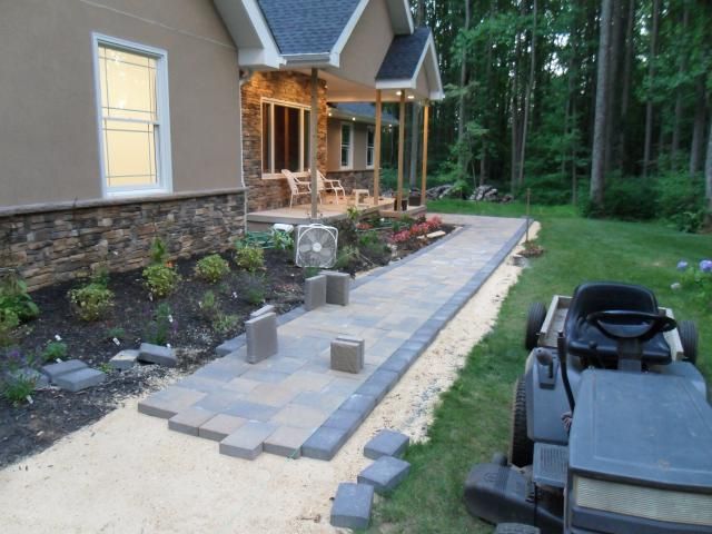

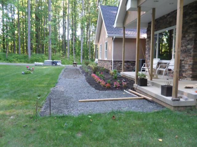

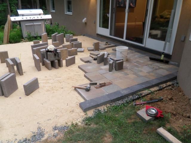

It's been a while so it's update time.  Started on a patio and walkway over the last week.  When I finish graded the place I had an area compacted and put in stone instead of topsoil.  This made it easy cause I pretty much already had a base.  Back patio 16'x17':
Used concrete sand and rented a tamper for everything.  Pavers are EP Henry, 6 different sizes in a random pattern with a 6x9 cobblestone boarder:
All pavers laid.  I still need to fill in the cracks with sand and backfill around the edges:

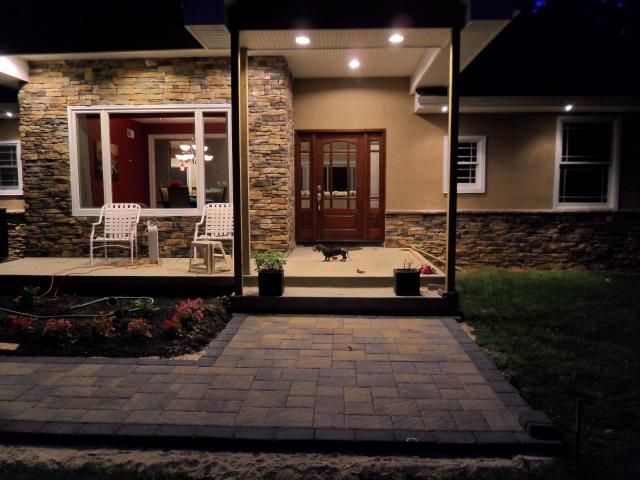

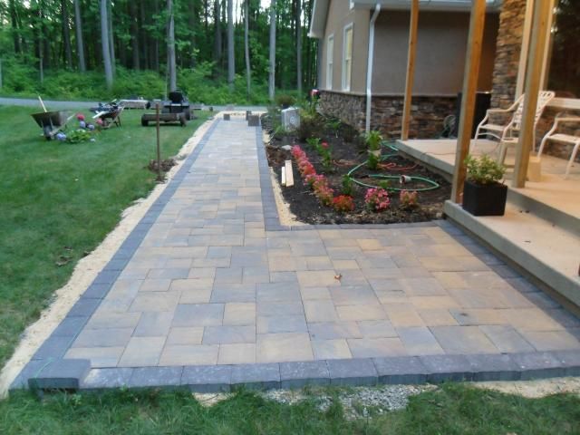

Front walkway:
56" wide, 65' long with only 3 different sizes in a random pattern:
9' x 10' landing:
I kept it simple and didn't do any crazy cuts or anything.  It's nice with pavers if you ever want to change anything you just need to pull them up and move them around.  That's all for now

Thanks.  Without doing a bunch of crazy curves that saved a ton of work.  I was able to get the whole back patio done in 1 day.  the walkway was spaced out over a Sunday and a couple nights after work.  The actual laying of the pavers goes pretty easy

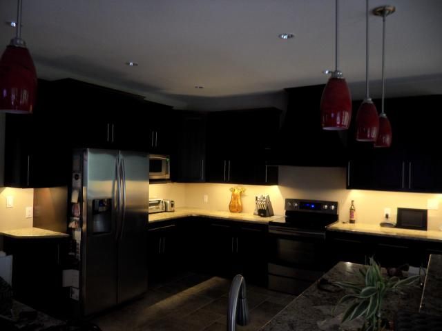

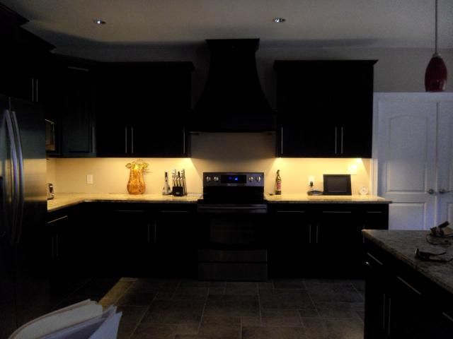

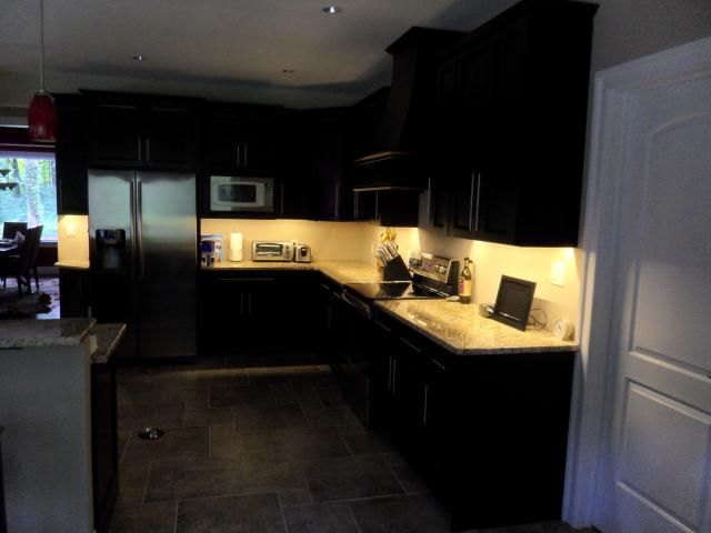

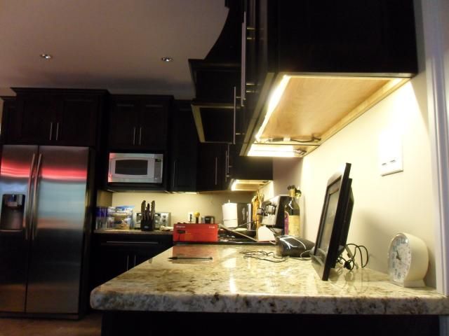

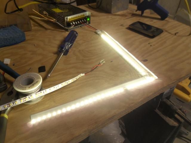

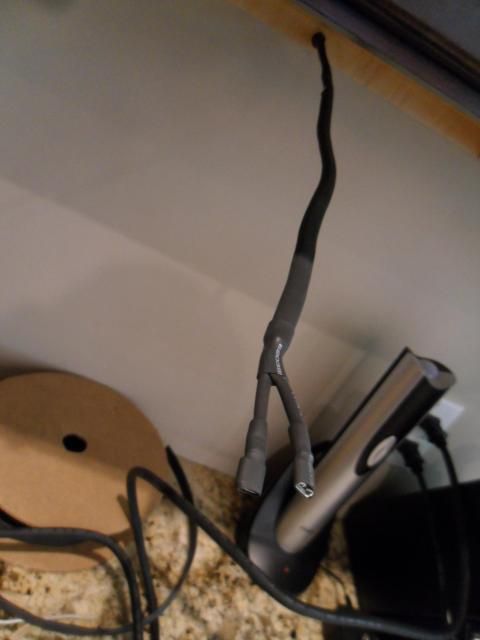

Update: installed under counter lights.  I was looking at SeaGull Lighting but they came out to almost $1,000 for what I wanted so instead I tried making something myself homemade style.  I bought some 12V LED strips of SMD3825's in warm white.  Cut some aluminum to mount it on and soldered the cuts together:
Tested with 120W power supply:

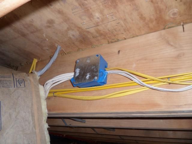

Before drywall I ran 14/2 wire to a box in the basement so I wouldn't have to mount power supplies in the cabinets:

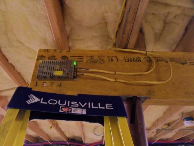

Mounted power supply on a beam in the basement:
Shrink wrapped and added connectors to the wires coming thru the wall under the cabinets:
Mounted everything:
Results:
With the power supply I can add another row of lights and double the output. I may add some more here and there but I think it turned out good for now.  I have a total of $33.00  in everything.  These LED strips are great, I'm thinking of putting some above the cabinets.  Not sure if it would look stupid
« Reply #293 on: September 14, 2014, 07:33:08 PM »

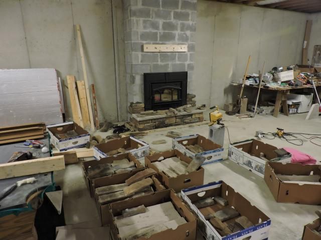

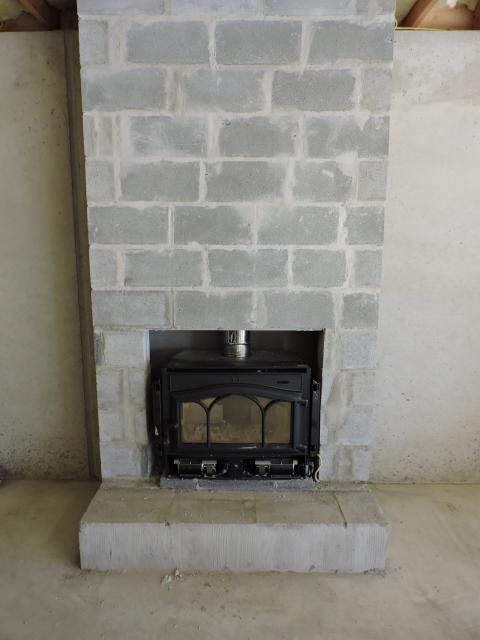

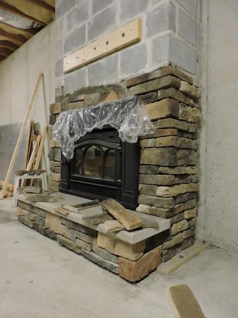

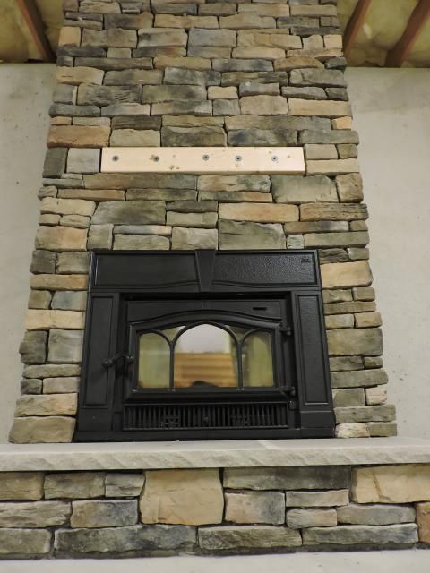

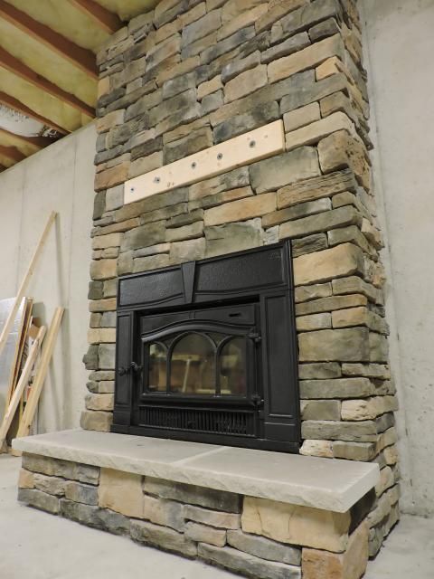

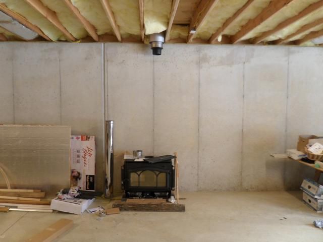

Latest project is putting a fireplace in the basement.  It's a woodburning stove connected to doublewall chimney pipe.  The start:
Built a platform that would become the hearth and the stove would sit on.  Built a surround out of block.  Used 6" block and 4" block above the lintel.  Connected everything to the chimney pipe:
Starting on the stone to finish it:
Current progress.  Put a 2x6 on as a nailer for an eventual mantle.  Still not sure what style I should make:
That's all for now.  Still have a bunch of stonework to do.  Hopefully will be done in a week.   More from This Homemade House coming soon.  :mexi:

Done...
