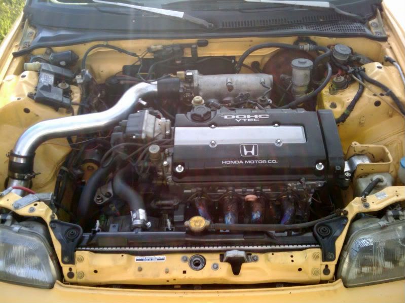

Took it around the 'hood.  Seems to bog at lower RPMs, but seems to run great at WOT...is this because I have the O2 sensor disabled and am driving open header?  Also think it might be running a bit rich, my friend said he could see a lot of black smoke while I was driving (which could be because of the new rings), but there was a lot of popping when I'd let off the gas from upper RPMs.
Re: I've never had a build thread (Update Apr 26th)
« Reply #116 on: April 26, 2010, 11:32:41 PM »
I would enable the o2 and check your plugs.

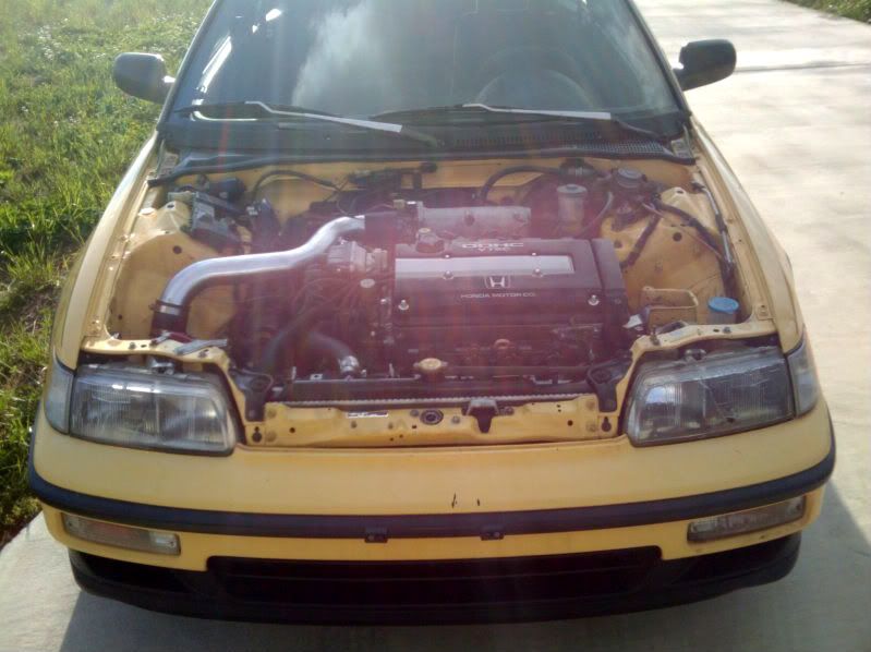

Since everyone likes pics:
Now just for boost...
« Reply #118 on: April 28, 2010, 09:06:16 PM »
If the car is still running a little rough and ignition timing is cool no cel's a new set of plugs does wonders.
If you are running a stock bin file the car should run pretty solid
« Reply #119 on: April 28, 2010, 09:34:12 PM »
Yeah, it still seems a little rough.  No CELs, leaks, overheating, anything...but when accelerating it feels like it's surging.  I will try a new set of plugs, maybe when I was running it for a while with the ignition timing/map not right it messed the plugs up.  Was thinking maybe the fact that I am running open header and no O2 might have something to do with it too, but new plugs are cheap and won't hurt.
