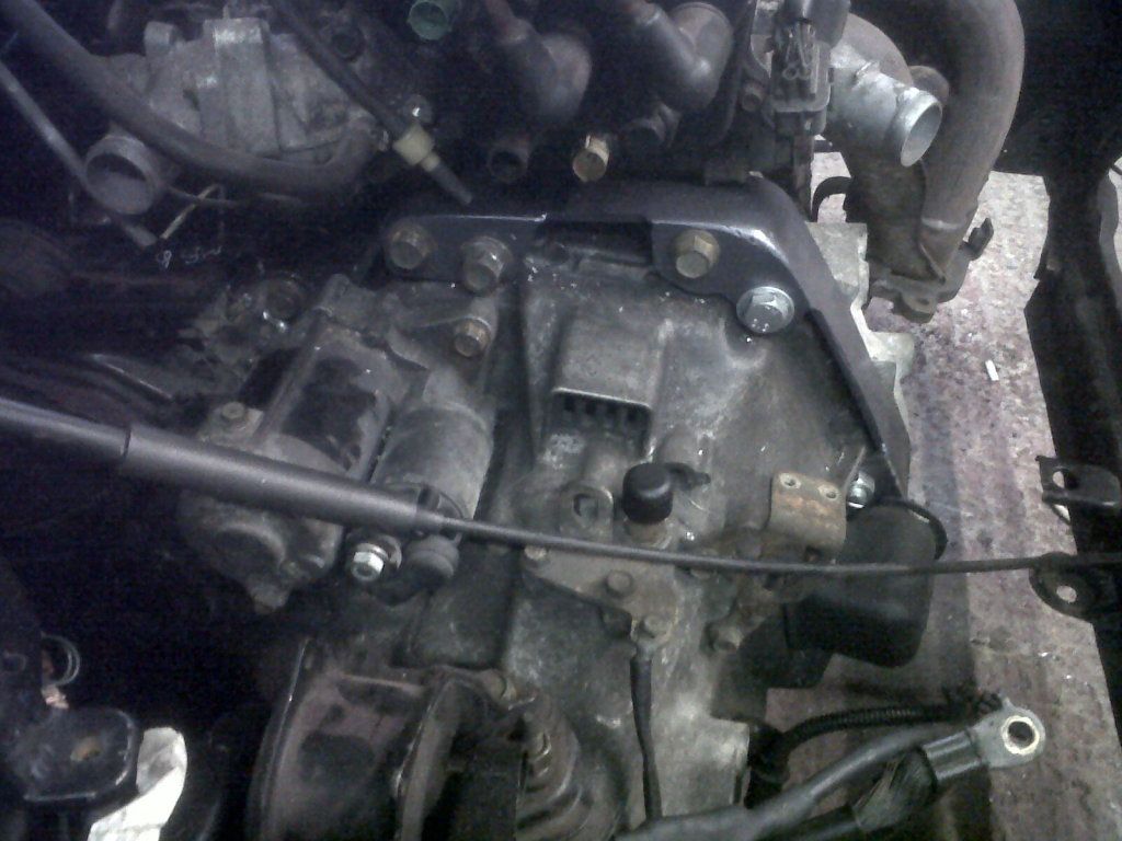

Alignment of block to tranny. The B-series angles forwards, while the F/H-series angle backwards. The engine is almost sitting at the stock angle, offering much better clearance and header alignment than an EVO or QSD kit.
This is the bracket I plan to make, except with angle iron and machined tubes/spacers below the engine block's bolts. I'll also have one more bracket below the slave cylinder that uses the original block & tranny's 12mm bolt holes. I'll also be making an angled bracket to space out the slave cylinder similar to how QSD does with a slotted aluminum bracket. NOT MY PICTURE/ENGINE:
