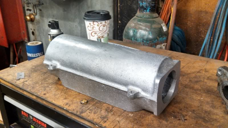

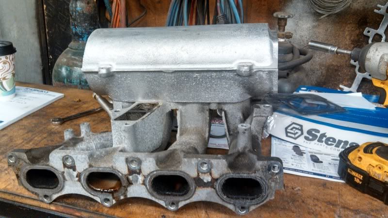

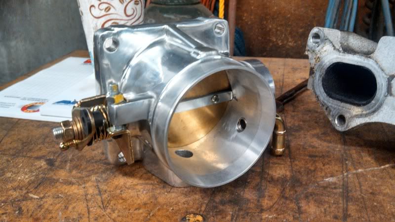

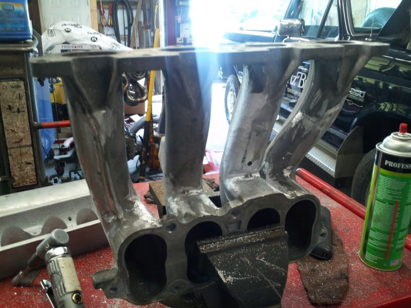

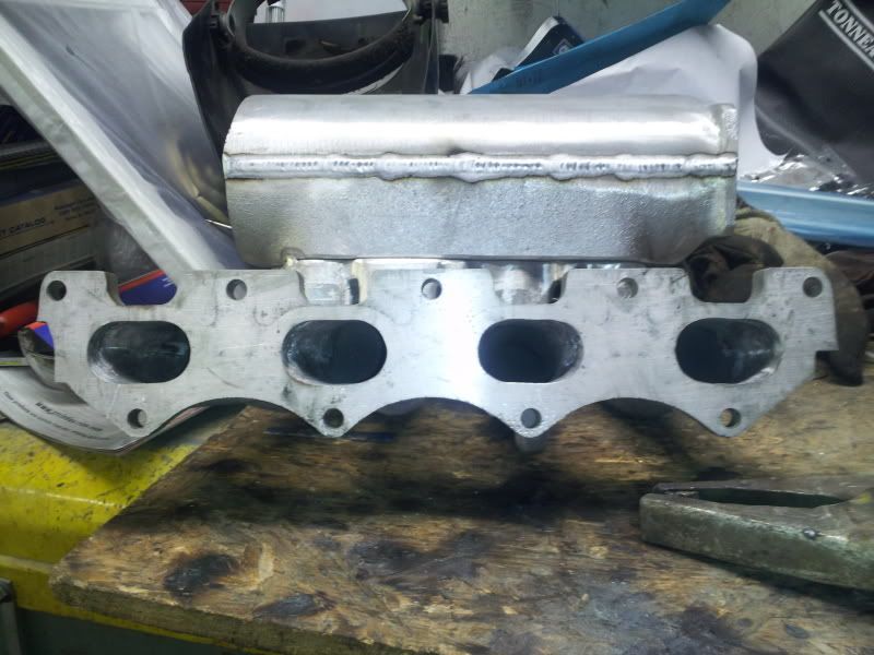

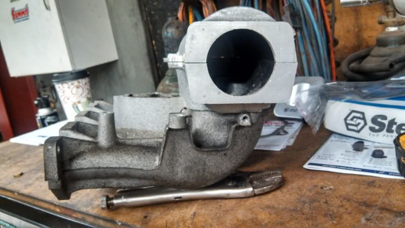

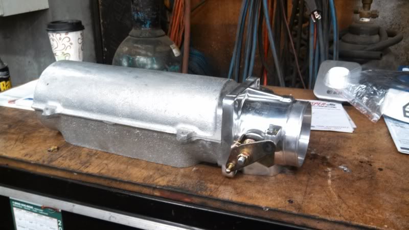

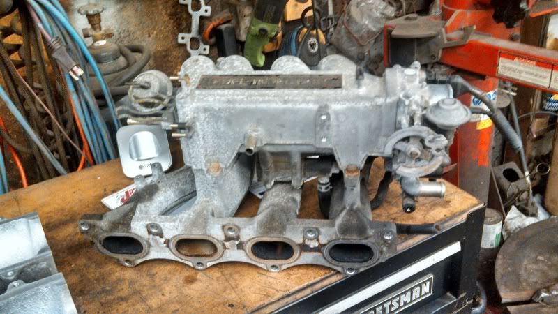

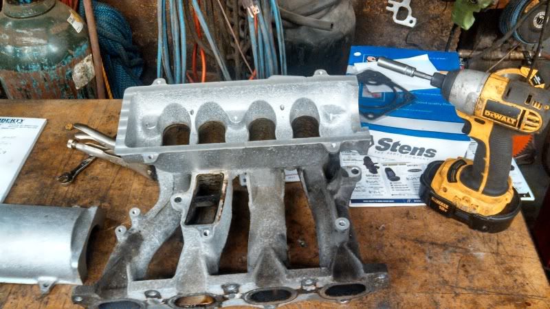

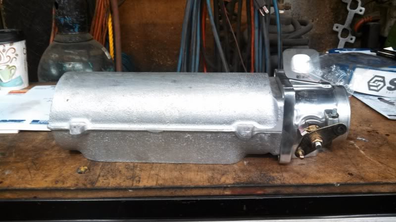

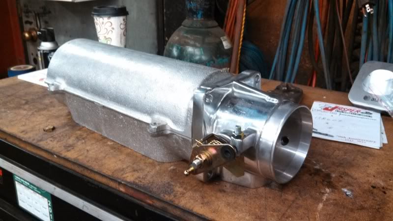

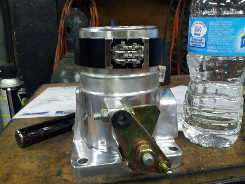

Went to the JY and got a stock GT manifold.
Upper Plenum.

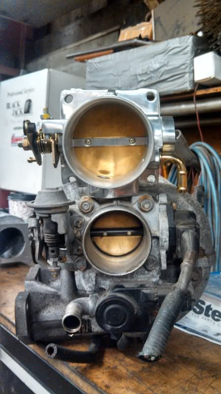

Picked up a 75mm TB
Probably gonna shorten the runners up.

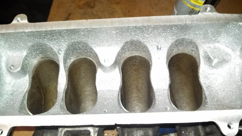

« Reply #68 on: July 10, 2013, 12:39:29 AM »

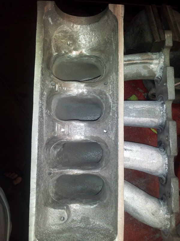

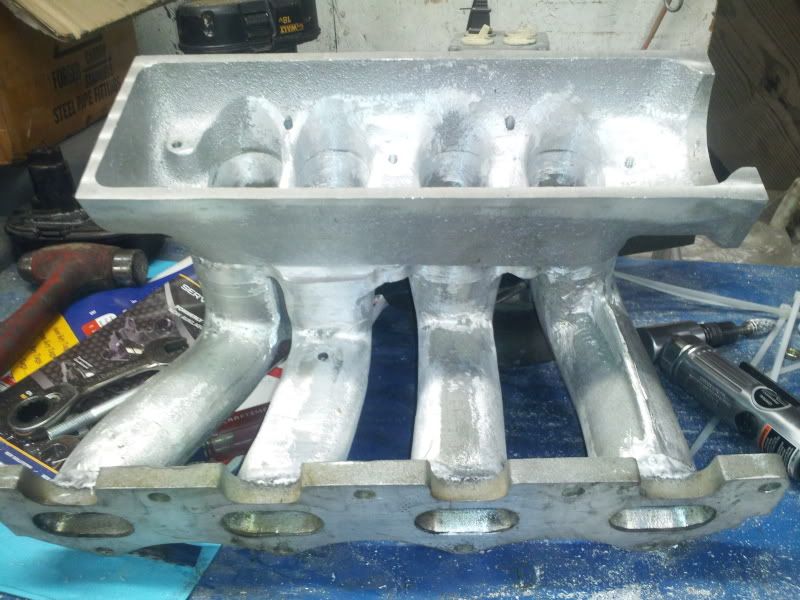

The runners are probably the only restriction at this point. I'm sure you could just chop the runners off and use the rest.

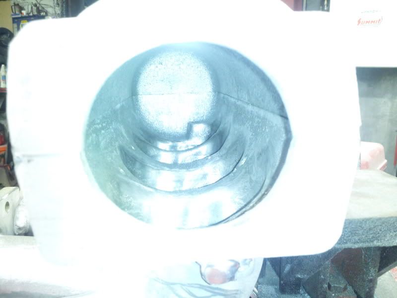

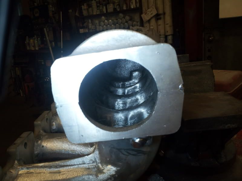

« Reply #69 on: July 10, 2013, 10:54:54 PM »
The casting for runners is thick as hell. I got lots of room to hog em out.

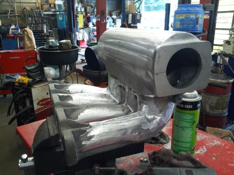

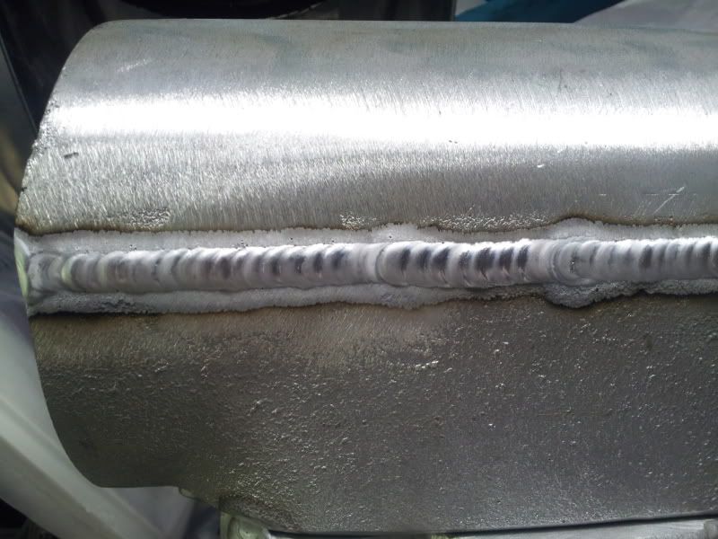

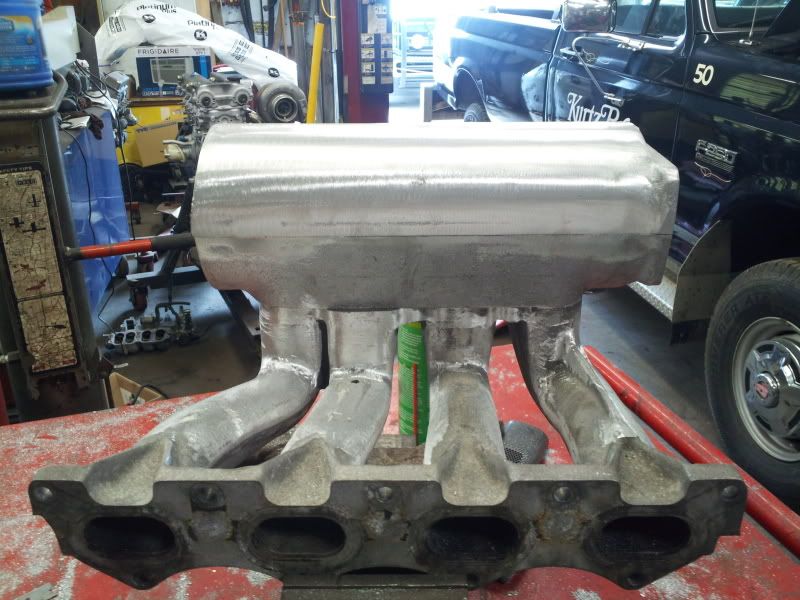

« Reply #70 on: July 14, 2013, 12:00:24 AM »

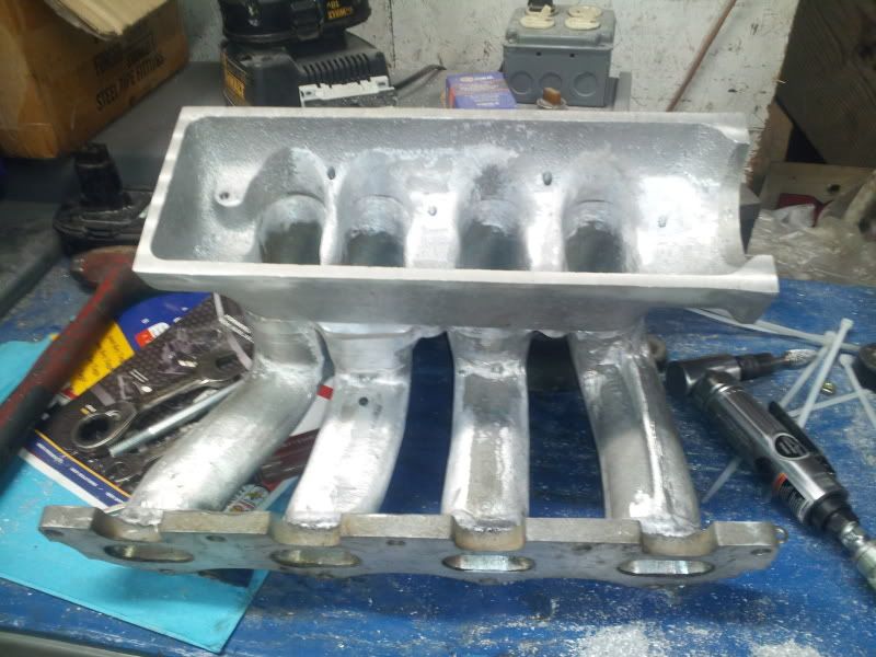

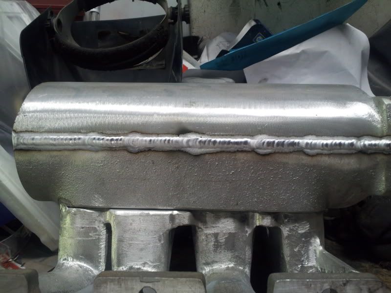

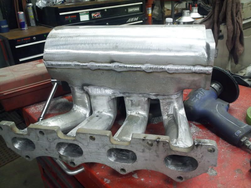

Intake is coming along
Got the runners cut down and welded back on. Looks alot better.
Ebay wiggins clamp. Pretty nice quality actually.

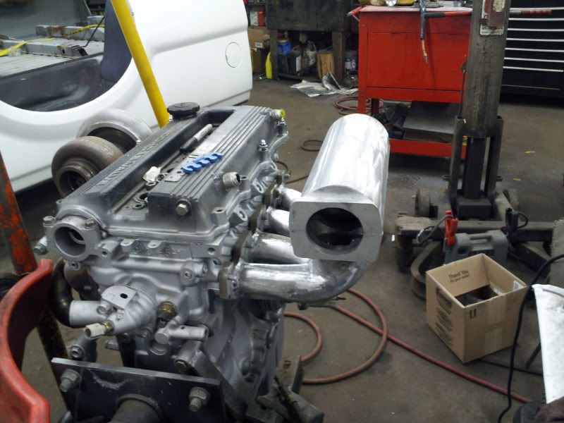

I started pricing it out on summit but its going to be way more expensive than the kit I posted. I'll just need to get that kit and 3 more zex fogger nozzles.

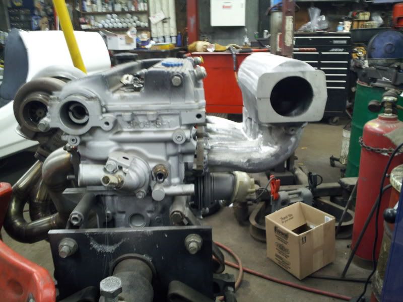

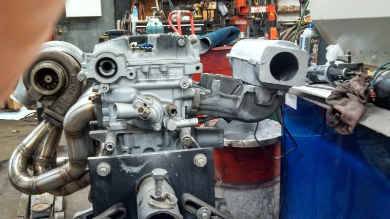

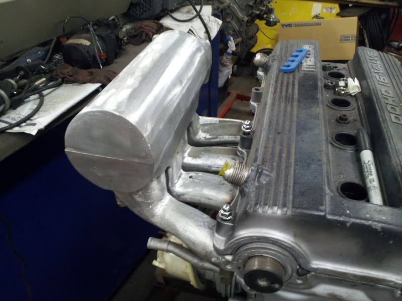

I found another issue while I was working on it the other day. The manifold I'm working on is going to send the charge pipe right through my master cylinder/brake booster. So, the question comes now, do i abandon the manifold or rip out the master cylinder and brake booster?
The brakes on these suck ass so I was going to play with them anyways. Could do a pedal assembly like this.
It would give me alot of needed room in the engine bay but not sure how I feel about going to manual brakes.

The simple thing to do would be to weld a 45 bend on the manifold then the tb. Simple easy and best of all cheap if you can get away with it.
K.I.S.S.
BTW I still need to come down one of these weekends and maybe give you a hand or a kick in the ass to get you moving hahaha :noel:
carkrazed
  • Posts: 3422
Re: AWD Escort GT Build
« Reply #82 on: July 23, 2013, 12:31:23 PM »
K.I.S.S.
Ya, i've already considered that and ruled it out as a possible solution. I think it'll look like shit. I'm kinda ocd about things looking the way I want them to...lol.

Flip the plenum or cut/flip/weld the ends to put the TB on the other side?
carkrazed
  • Posts: 3422
« Reply #84 on: July 23, 2013, 06:42:09 PM »
No room to run charge pipe on passenger side unfortunatly.

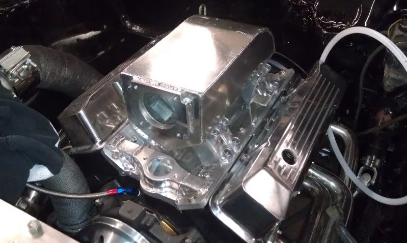

« Reply #88 on: August 07, 2013, 10:36:01 PM »

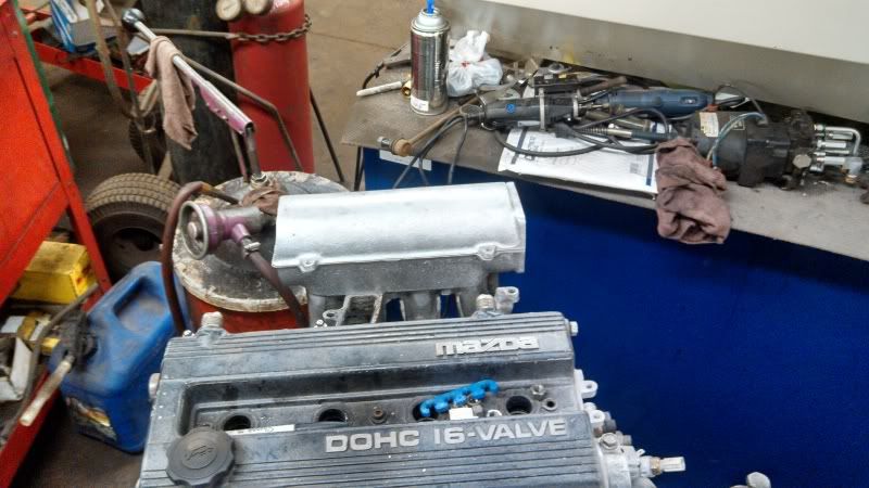

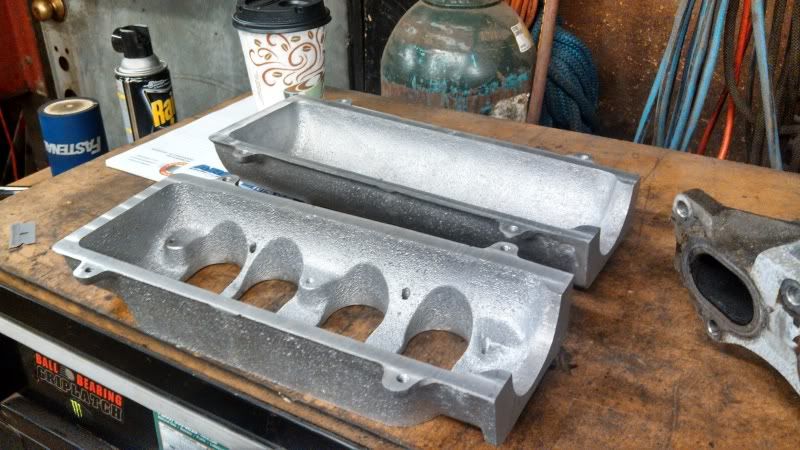

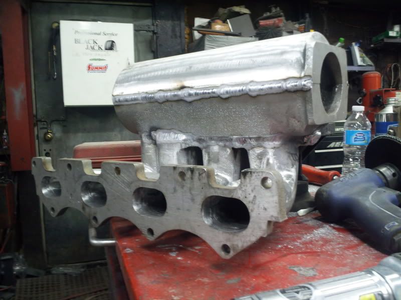

Decided to keep rollin with this manifold
flat_black
  • Posts: 315
« Reply #89 on: August 07, 2013, 11:17:20 PM »
manifold is pretty neat i like... what kinda machine are you welding with?
