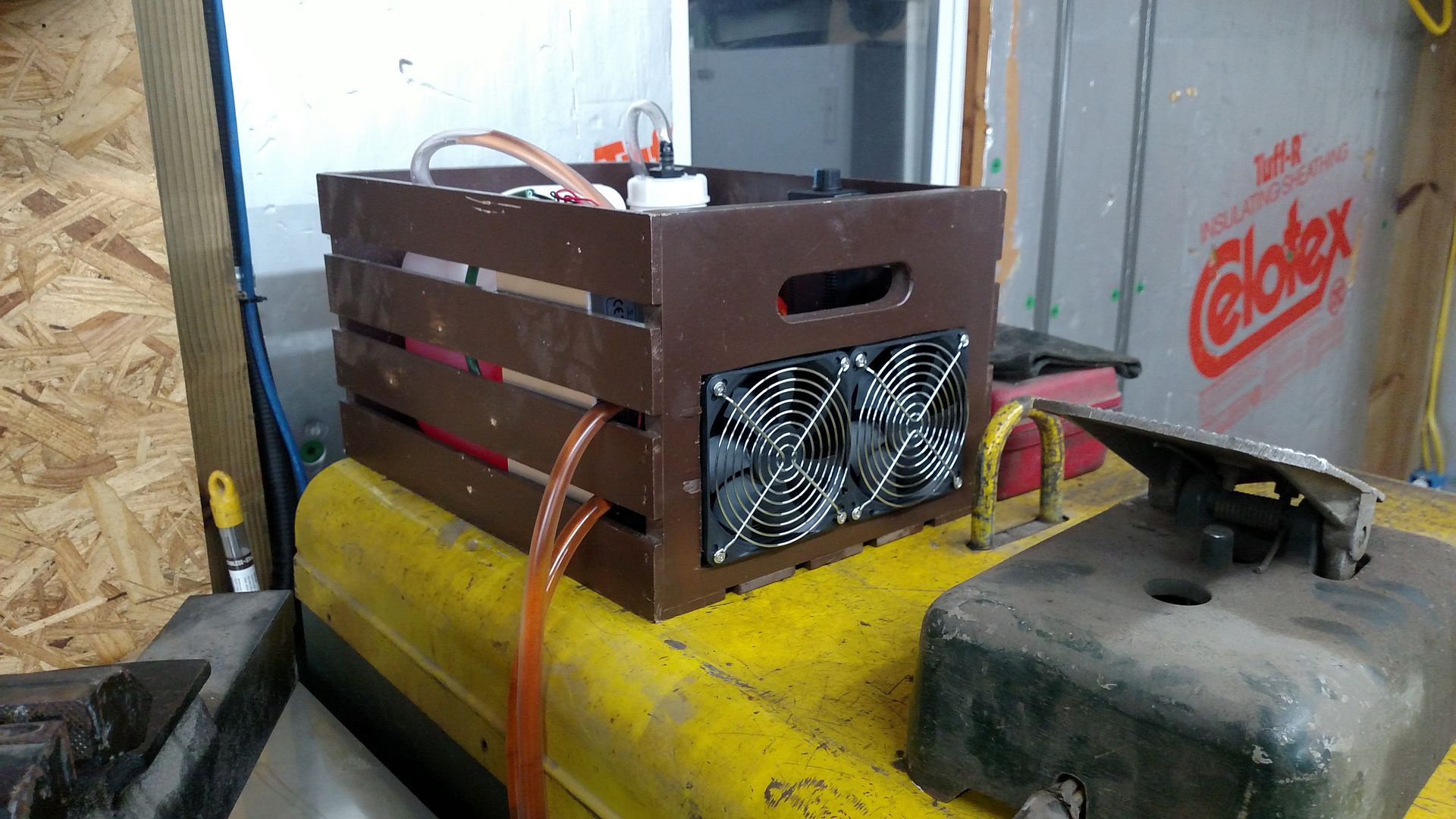

It's a tig torch cooler. Not a tig welder that he built. It circulates cool water through your tig torch to keep it cool so your hand doesn't get as hot when welding.

Ya, its just a cooler. I don't have water in my new garage yet so I needed a cooler. Coolers from places like Miller or Lincoln can be up to $800. Fuck that shit. I'll have like 99 dollars in this.

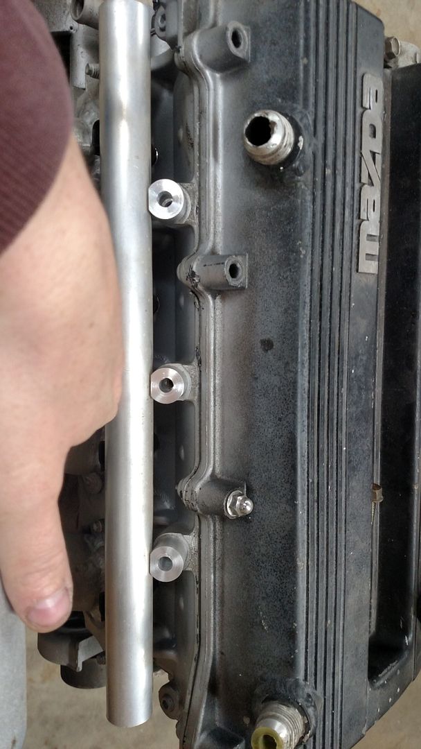

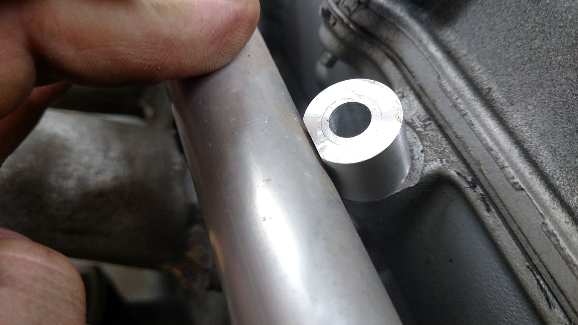

Got the cooler done. Works like a  :mexi:

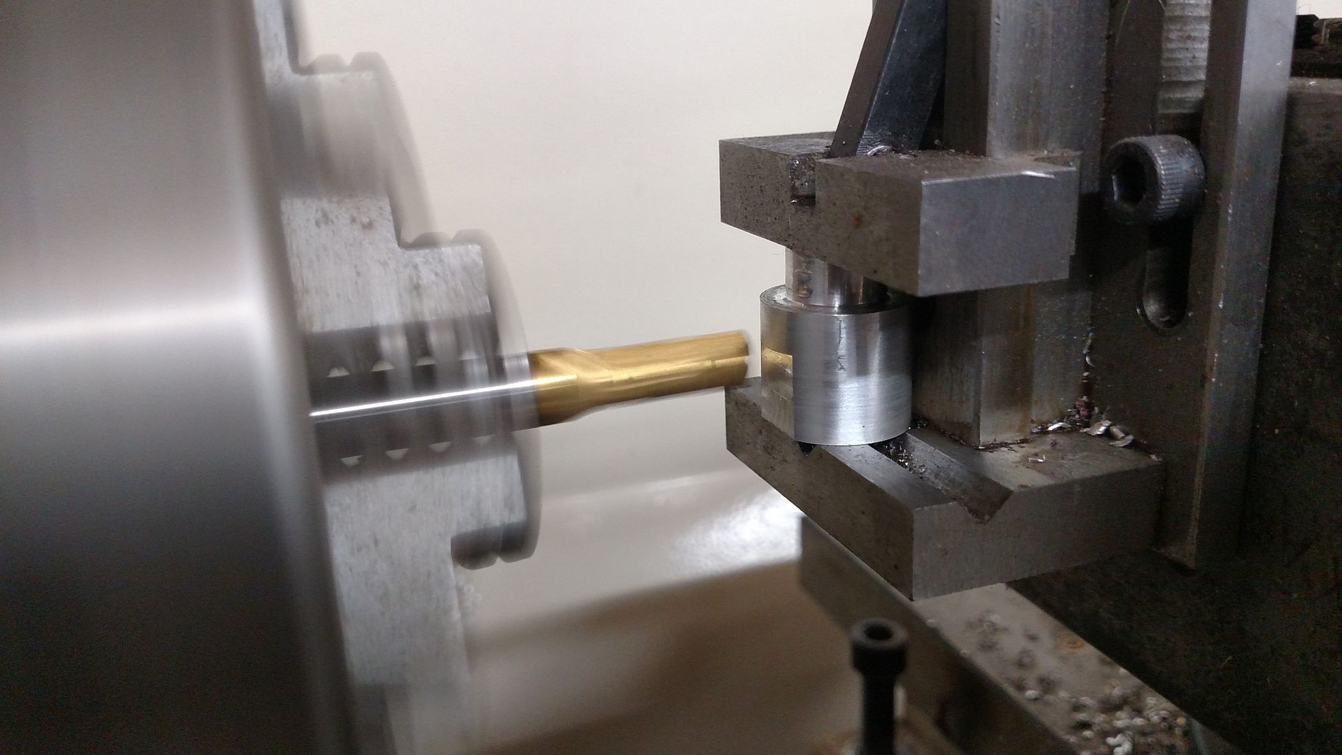

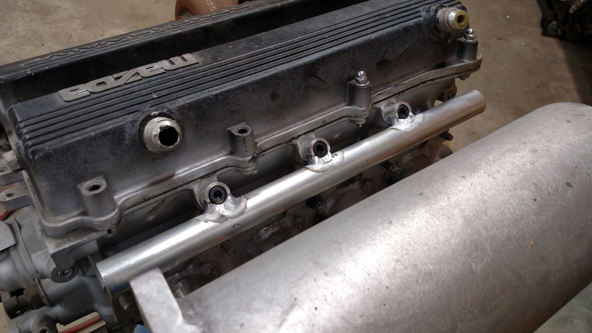

Actually started working on the car too. Figured i'd start by finishing the fuel rail I started on 2 years ago.
Turned some mounts in the lathe and got to try out the milling attachment I just got. Works pretty good.
Decided to countersink em for some socket head bolts and got em welded on. Don't know if i'm just rusty or what but they were a bitch to weld on.
Gonna start fitting the tranny to the engine this week. Once thats done, it should be pretty smooth sailing.

nice touch with the counter sunk allens. solid work.

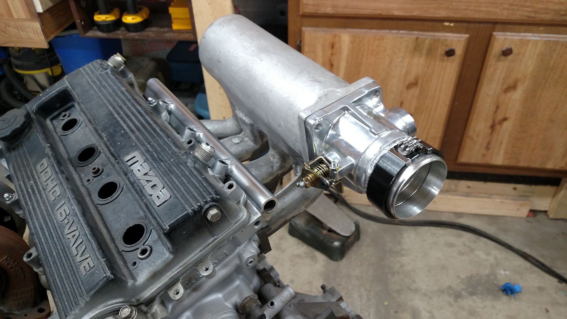

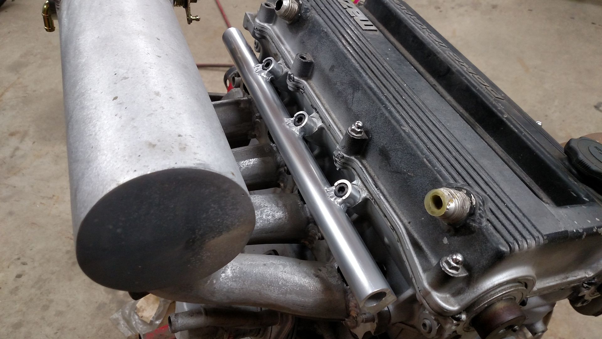

Cleaned the rail. Doesn't look too bad.
Pulled the throttle body apart and welded on the chiggins clamp.
