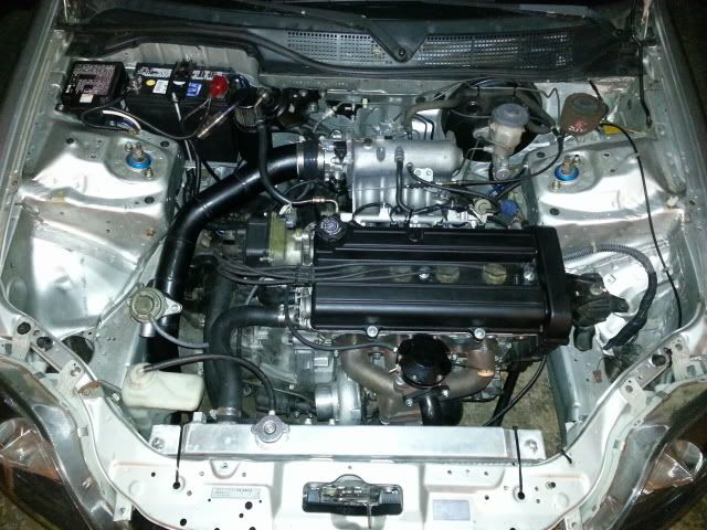

ok so i sprayed everything down with break clean to remove loose oil/cabon/shit. and i threw most of it back together. im gonna probably fire it up with no downpipe connected tomorrow and see if it smokes/spits oil/whatever. then go from there.
plan is to slowly hook shit up till i find what is causing the smoke? should work. unless its the motor or turbo then it smokes all the time anyway.
on another, maybe related note? the fuckin catch can is full, again. which is a 1pint can i think. minus a little for fittings and such. kinda wonder if that fucker is overfilling and leaking...maybe getting on the exhaust and smoking? it deff looks oilly on the crossmemeber.
if that fucker has filled 2 times, that would explain probably 80% or more of my actual oil use? think i have put 1.5-2qt in it... and the valve cover gasket was leaking pretty good when i was first ripping on it.... mmm...
oh yeah so my thoughts are that oil is getting onto the exhaust and/or shit is built up in the muffler and slowly burning off? im ok with this bucket smoking a little, and for a while longer for breakin time. but its smoking wait too much for that shit right now. this is like forest fire smoke, not a single small camp fire.
tomorrow i guess...... working towards a hardcore rhmt breakin ripper session. once catch can/oil/most smoke is close to figured out...or i just blow the fucker up and start again with fresh B20...
oh, still dont like CROME Pro.... think im going to buy Neptune RTP/Demon setup (and sell all my shit). if i dont spend shitton on above chaos.

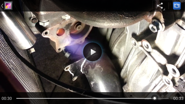

did some shit tonight. got a cool video (needs uploaded). might have figured it out?!?!
went for a quick ripper. didnt notice smoke, but its late. did notice that my quick 2-3 ripper put a decent amount of shit into my breather can... :-\ :-\ :-\

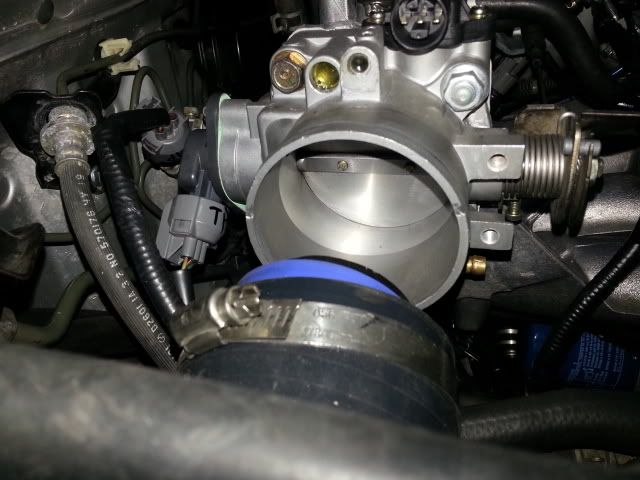

pulled the coupler off the throttle body for the first time...
so yeah. that bitch is clean. oil isnt coming from the compressor side.

screenshot??  lets see the vid!
  • Posts: 3026
Re: turbohf presents: i hate this fuckin motor!
« Reply #169 on: October 19, 2013, 11:27:04 AM »
« Reply #170 on: October 19, 2013, 02:59:49 PM »
i posted the video above... it not work? photobucket is gay.
http://i276.photobucket.com/albums/kk32/efssuck2/rhmtek/VID_20131015_183015.mp4
on my phone this looks mint and clear. looks like shit on bucket...
so it doesnt seem to be smoking much at all anymore. maybe a puff or 2, still less than 500miles on it...

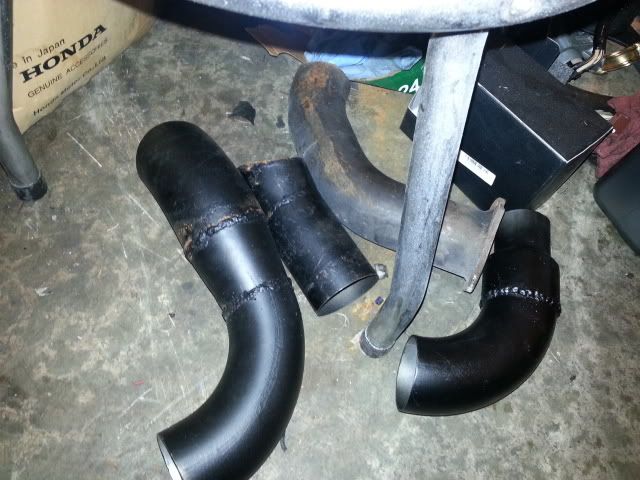

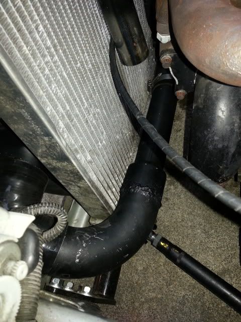

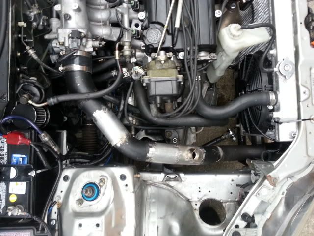

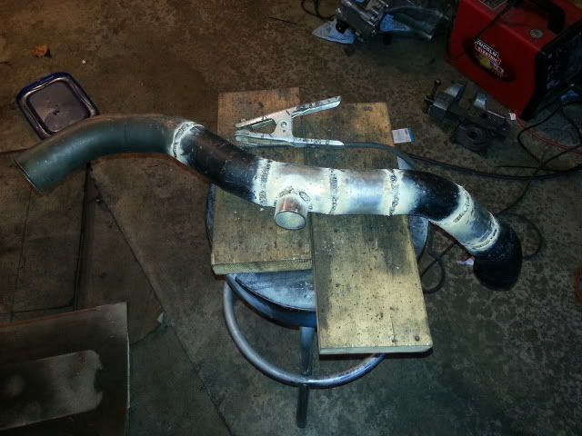

ok. so i hate this chinaRS bov like i said. also dont care for the long ass pipes.... ones i built are really probably just a hair shorter, heavier, but i like them better lol. also dont care for the blue couplers, and dont like the T-bolt clamps... SOO...

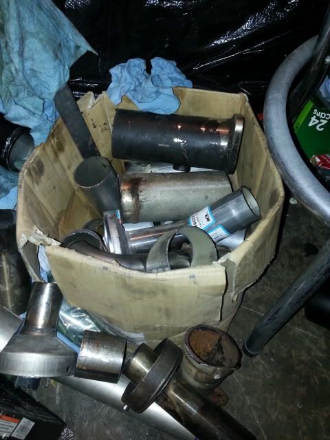

somewhere in this pile of shit scraps is my new chargepipes  O0
thanks to hiprofile for giving me shit about buying a flange i found this in the scrap pile also, began drilling.
had a gasket i acquired at some point.
some test fit
this side was a pain in the ass...
just took like 10" out of it and.....well i was done. no welds. just clean and repaint.   :noel:
mad flux core skills going on   :mexi:
big thanks to Russ/92cxyd for letting me jew him on this  :-*

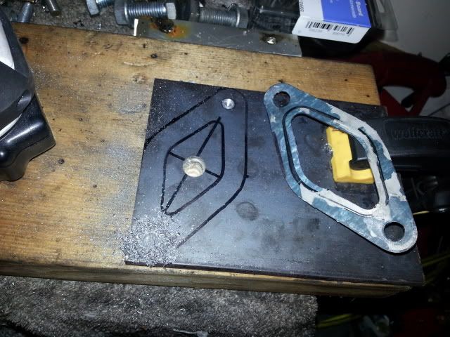

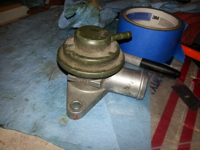

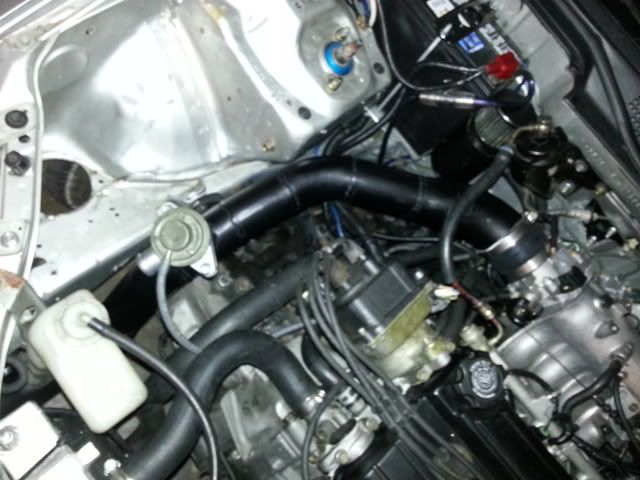

OEM/DSM 1g valve, for those that are stupid/new... showed up right at the last second, where i probably would have gave up for the day. had checked the mail box a couple times. mail lady just railed the box in there.

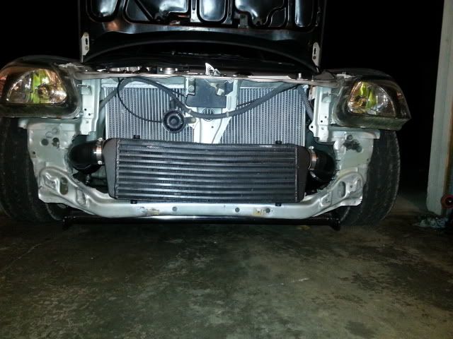

so you can kinda see what im doing here. instead of just buying a backdoor intercooler. i just bought 2 90* couplers. i did the same on the CRX.
i will pull this back off at some point to paint it with some texture paint i used on the valvecover....i ran out i guess. didnt feel like a break to go to the store. was on a roll.
i havent decided on weather or not im going to paint the BOV texture/black?? this is actually a nice looking valve. dont think any of my other ones looked this good.

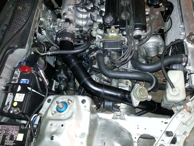

went and did a ripper around the block... ehh. at least it works. i really do like my TiAL BOV better. this one just goes SHHHHHHHHH. just did a couple small pulls tho. see how some full 10psi+ WOT 3-4th does. then ill crush the fucker if it still does it. i would like a little sharper release.
WAY better than the chinaRS tho, this is a OEM part, so it actually WORKS.
2 90* couplers = $26
some clamps = $8
bov flange = free
bends/transition/pipe = free
3" coupler = free
bov = $20
gasket = free
looks like i did pretty well on the budget lol.... btw, old shit is forsale. give me a couple bucks more than i spent above lol. they are aluminum 2.5", blue couplers, T-bolts, etc...
