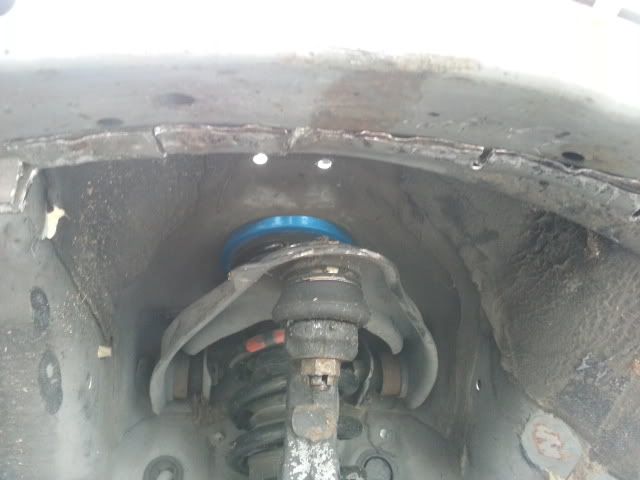

btw, not sure i mentioned it (probably assumed lol) that i was rubbing/cutting my left front tire a little. i raised it up a little on that corner (to level the car out) and then...
i made some more clearance LOL... i remember seeing someone else do this forever ago. also if you have junk2 upper arms they probably hit that lip too. you can see on the left how much was cut. then i hammered that shit flat. and threw some paint on it for giggles. also hammered (deadblow mallet) the rest of the fender lip. cant wait to get to do that to a brand new Honda fender  :-X
also fixed some of that fuckin wire tuck shit in the right fender. now its secure and out of the way.

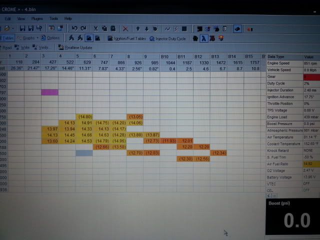

crome...
seems to be working ok. NOT doing the same shit the CRX was doing, which is awesome. actually getting hits in the boost cells. only 4psi there cuz its still wet as fuck out, and spins in 4th....maybe 5th, but im on backroads, dont need to end up in a ditch at 60mph...

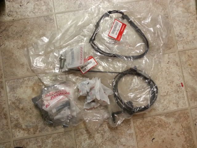

GENUINE HONDA PARTS...

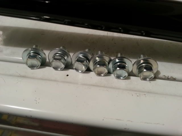

ordered a bunch of hardware/bolts. new valvecover gasket (china one leaking like the exxon valdez), and of course a new hood release cable. cuz i think every EK needs a couple in its life.
love working with new hardware.... these are tow hook bolts. to mount up my traction bar. my tow hooks where missing of course to begin with along with hardware.
other stack has bunch of 10mm headed bolts with washers. for fenders and shit. mine seem to be random colors, no color, rusted, stripped, missing, etc... and a LCA bolt that has been missing since i swapped crossmembers (giant fucker on the back side. 3 back there), of course found the missing one when i went to get the jack to put this fucker in the air lol.

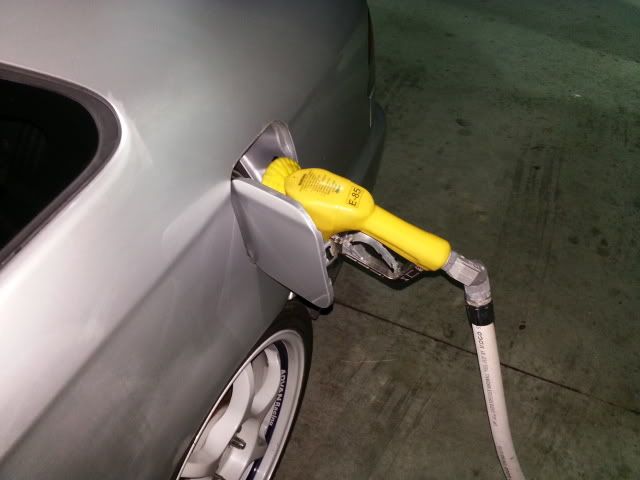

E85 straight into the tank.... should have brought my fuckin gas cans to fill up also. BUT. still $3.80 a fuckin gallon...so not sure how many more times im gonna fill it with E85. probably get my map fairly dialed. then pump gas till summer? idk.

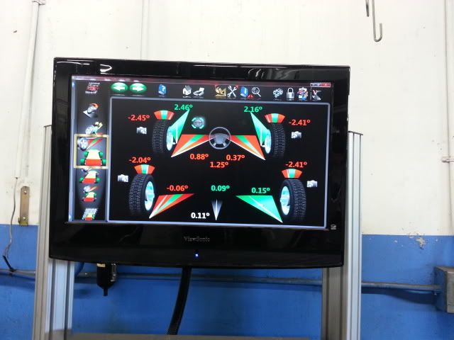

oh yeah the reason i wanted to bring it to work was so i could get guy at work to align it for me.
think thats right about where i started. told him my shit would be easy. no camber adjust, just toe. then he noted the caster was off a little...wait traction bars = caster. lol.
looked like it barely made it on the rack, then the wheel attachments hit my fenders lol. guess this will be a permanent alignment. dont need that shit hitting some new painted OEM fenders. fuck these junk ones.

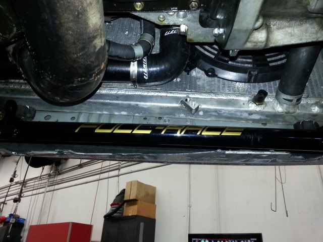

oh and since i was under the car.
traction bar mounted up.

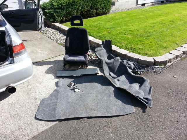

TODAY!...

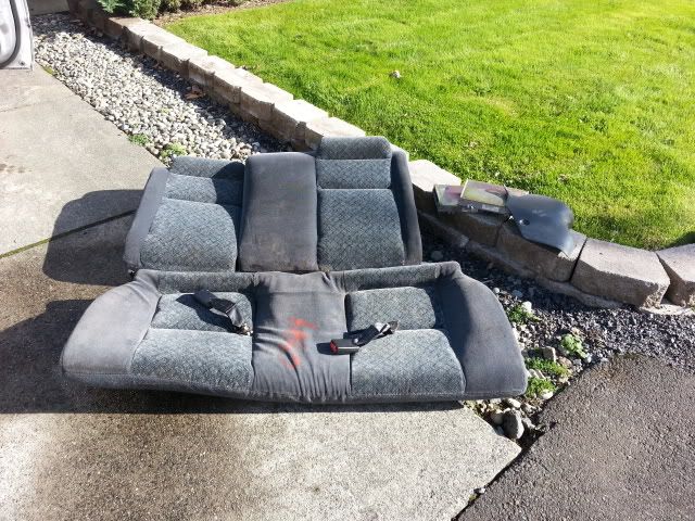

went to wrecking yard to pick some shit up. got most of it...
thats a DC4 passenger seat (i had a drivers i got for free already), center trunk plastic, both right/left carpet 1/4 panel liners, driver door hinges (mine rocks a little right before the striker)
sounds like a good days score?....
there is more.

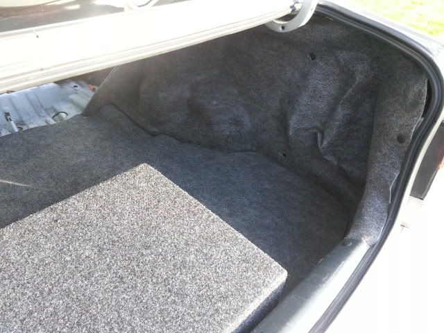

dark gray coupe rear seats, 2 rear seat buckles (fuck the centers, no lifesize person fits anyway), ECU cover, and 2 ECUs P06-A01/P06-A02
not all from the same place. but 2 stacks of shit i got... total looks like $114.15 for the day...

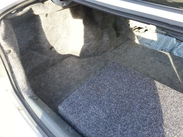

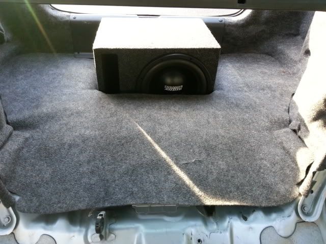

got all the rear shit cleaned, fitted, and cut the shit out of the floor carpet to clear around the sub box. fits all pretty nice. and the color for the sub box its damn close.
gonna take the seats to work to steam clean them all.
pretty fuckin excited.  ;DDD

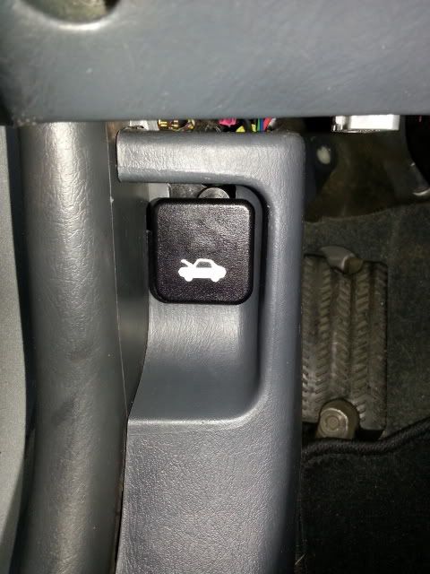

put my hood cable in on sunday night i think? routed it inside for greater theft protection.
so nice having the cover trim thing around it back on and not having to pull the cord end.

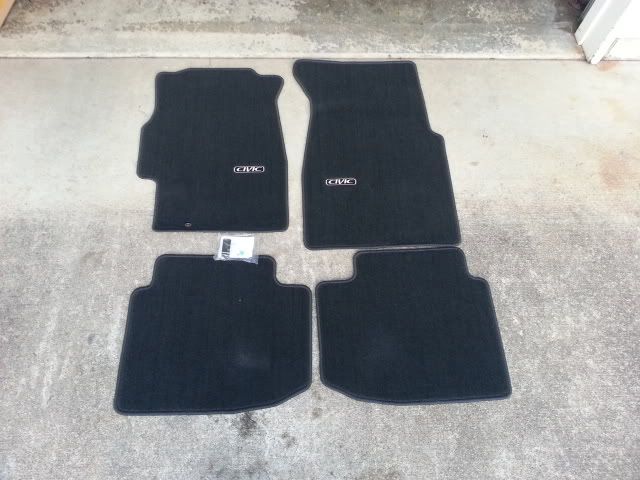

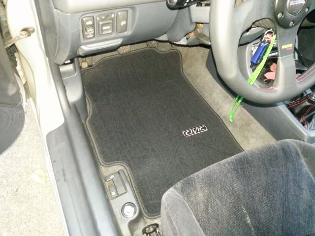

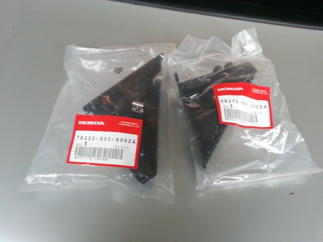

i ordered these stupid things...
both mine are broken. and one is a EX tweeter, the other an non-tweeter HX...wtf? so i ordered 2 new HX non-tweeter style.
then i had a thought before leaving work, and ordered these cuz they havent been 100% discontinued. all the numbers are just superseded to this:

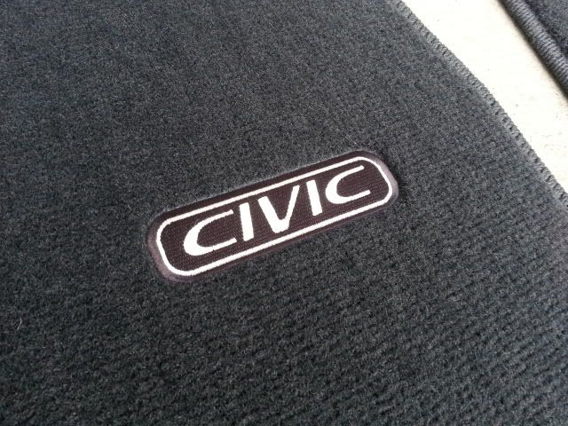

mad tyte jdm Honda Access accessories yo!
anyway. they look pretty good. i had mats in there, but the drivers was haggard (non-oem) with an 'ehh good enough fit' to them. with no rears.

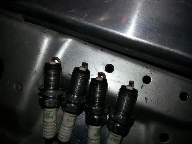

i pulled the plugs out. they all look pretty clean. no sign of oil on top of the pistons. did a compression check a week or so ago? was about 180psi across. which is what i expected on my gauge. its only got 200 or so miles on it, so it might even come up some more later.
so oil has got to be coming from the turbo. but..damn it doesnt seem to be using any oil now?....mmm...

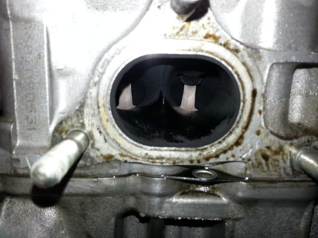

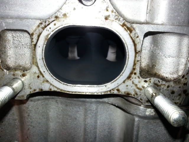

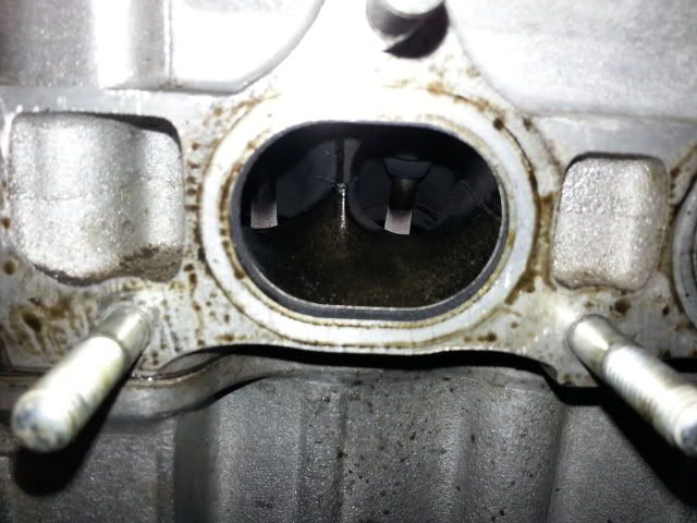

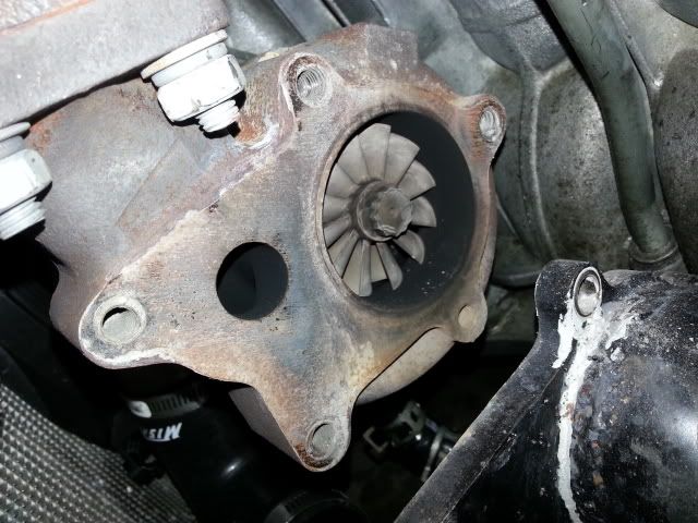

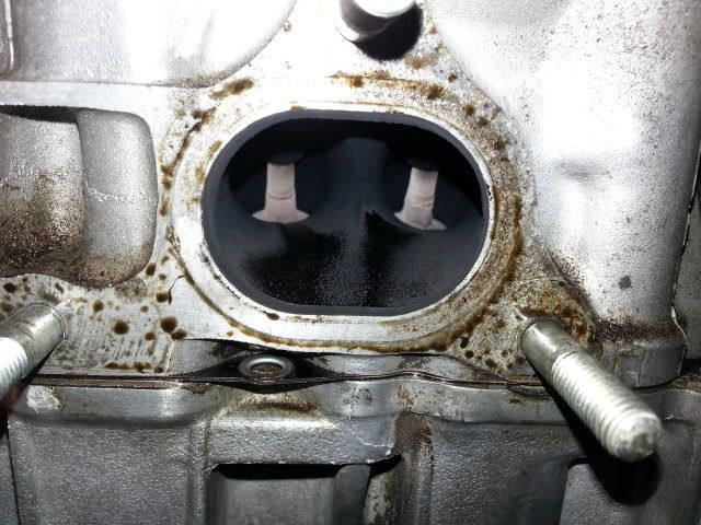

OK...wtf? i got some hate. i want to drive this fuckin pile.
plugs...
fine.
turbo?
fine. actually, looks kinda oilly in the pic? its try carbon in person?
ports
WTF? its got new valve seals in this fucker.
this pile of shit motor ran fine in the last car, didnt fuckin smoke...
hate.

oh there was a small oil trail down the hot intercooler pipe off the compressor housing around into the intercooler. intercooler has been on end for 10+ mins with just a couple drops out of it...
compressor outlet seemed dry...but its been sitting for 20hrs or so.

If the valve guides are fucked new seals won't help, how wiggly we're they?

Guides.............

fuck. I don't want to pull this head again. I don't want to buy new gaskets. and I don't want to spend 300bucks on a non-vtec head (or any really).
