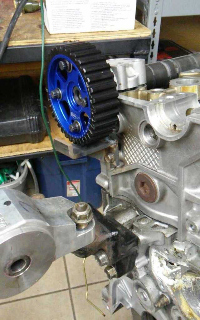

after being a garage shelf for two years I've been tinkering on this pos
Fancy new gears that I scored for basically what I sold my old ones for.
Drilled and glued in a magnet. Only needed one, but did both for whatever reason.

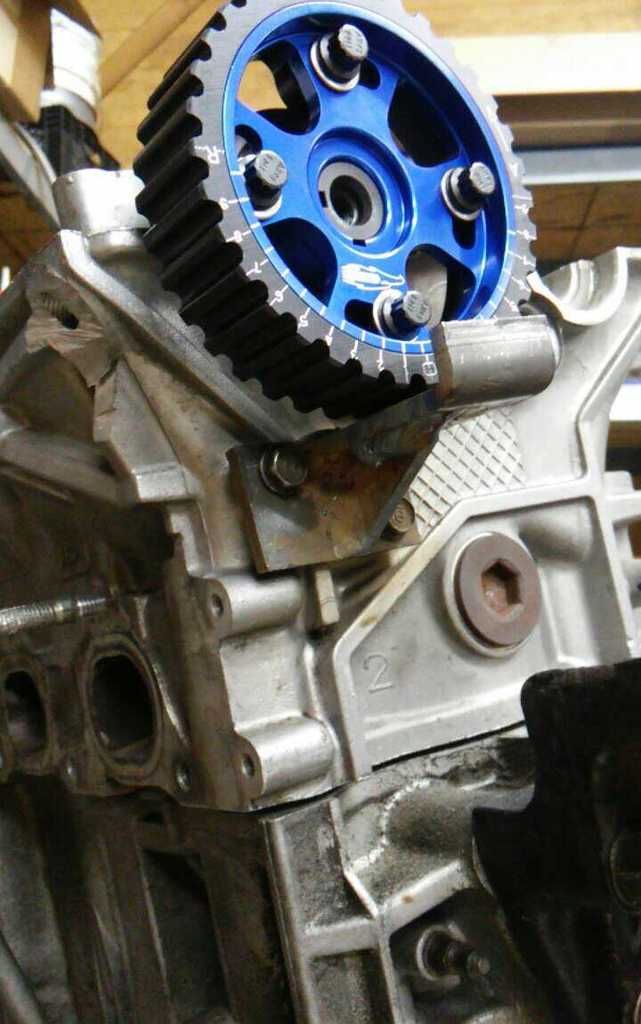

Welded a little bracket to mount the sensor, just need to drill and tap for the sensor itself.
LS coils that will complete the package for coil near plug.

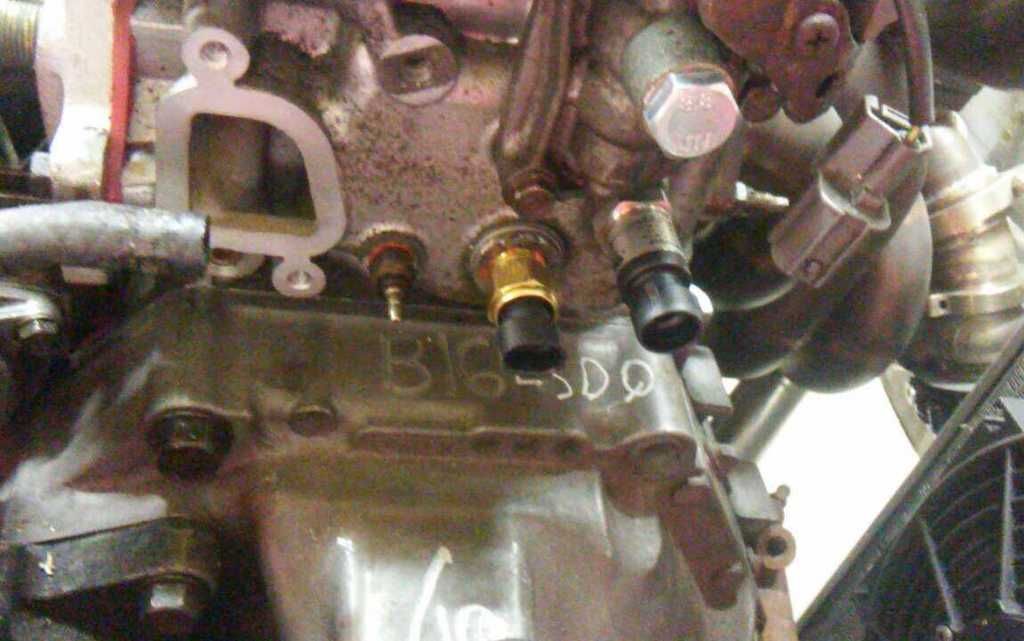

Mounted a gm ect sensor in my heater tube plug, and pressure sensor in place of factory ect.

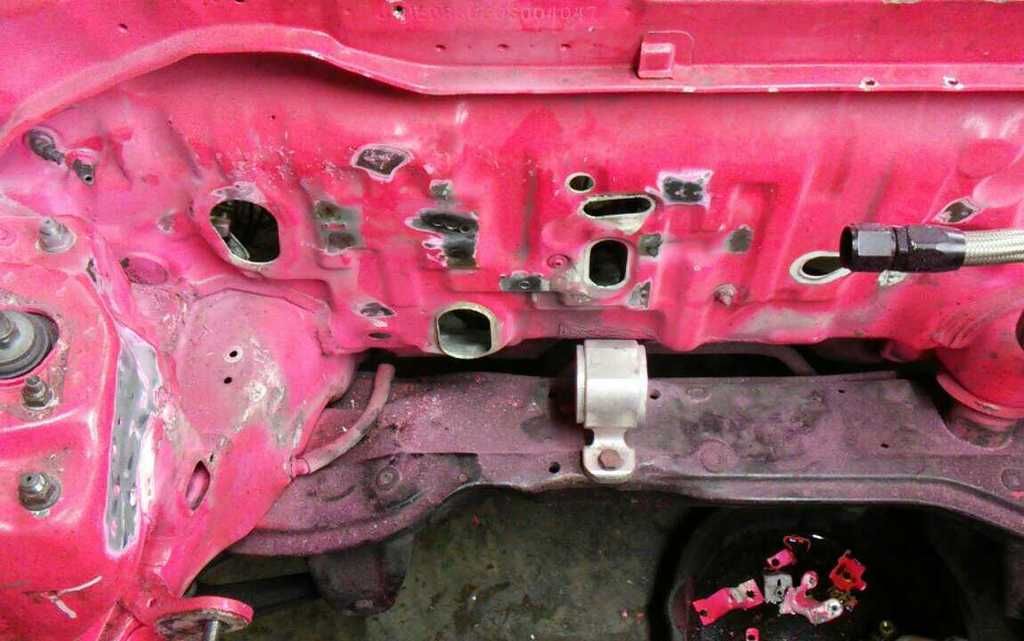

took off all the knuckle busting brackets on the firewall, as well as brake lines for a ghetto tuck. the brake lines and prop valve were all fucked up and hit the charge piping anyway.
Couldn't stand trying to work on this thing with no room anywhere so i'm 'shaving' it.  not for looks, probably won't even get painted.
Also deleted the brake booster since it just about hit the intake mani.  tons of room, unsure of stopping power, will cross that bridge later.

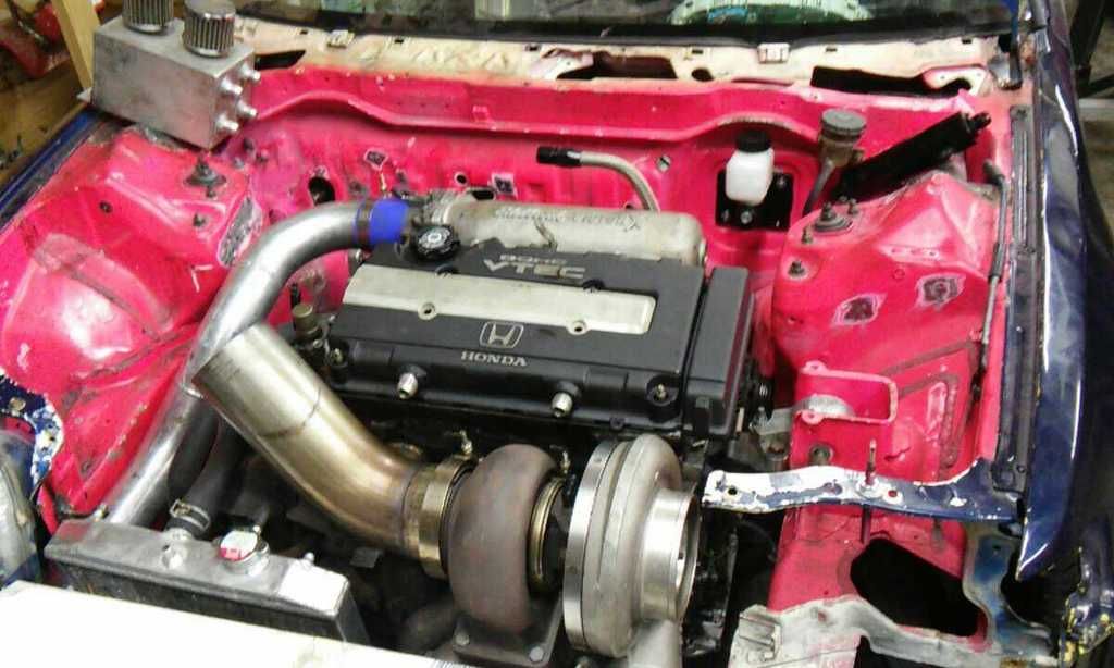

Can't find a good place to mount the catch can, so I decided to build one and mount it behind the firewall.
Valve cover ports and filters tucked into the corner next to the fuel filter.
plan to put a baffle in the tank so the engine ports will be in the front chamber, then the filters will connect to the back chamber.
going to run two more ports that shoot off to the left and poke out the firewall at the back of the block for drain back.
Ordered an ebay radiator for an Austin Rover Mini because the civic half rad is too tall to fit with the traction bar without hitting the mani and up pipe.
Figured this will give me a little room to fit it nicely, hopefully it will handle the job.
Need to weld proper size hose nipples on, might flip direction to keep the rad cap away from the mani as well.

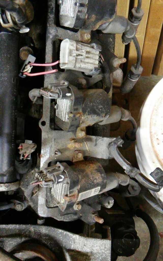

had a little more motivation last night, mounted the coils to the trans.
Just about wraps up all the ghetto fab.  just need to rebuild this engine and wire everything.

Loving the catch can, definitely frees up some space considering how small these bays are. Looks like that radiator fits perfect after flipping it and moving the ports. Do you have a time or power goal in mind?
