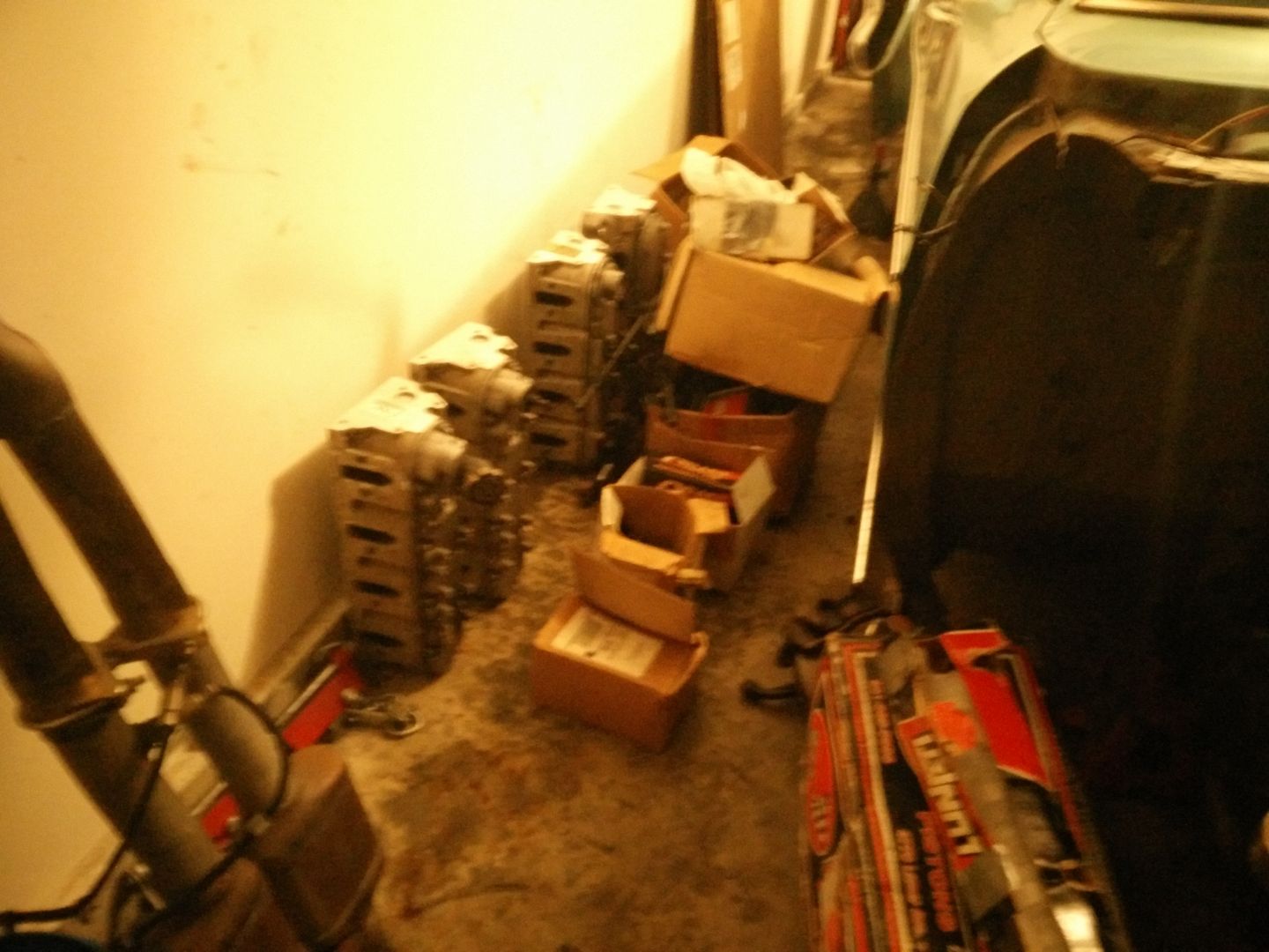

so... inventory:
LS1 short block. looks like fbody pan on it. no cam in it.
LS6 bare block
LS6 crank/rods/pistons
LS1 cam
LS6 cam
LS1 806 heads
LS1 853 heads
Comp 3714R cam
BNIB rings
BNIB valley cover gasket
BNIB headbolts
i see 3 sets of lifters, one is probably Comp set
couple sets of push rods
timing chains/gears
crank pulley
accessory bracket?
car water pump
DBW throttle body
2 valley covers

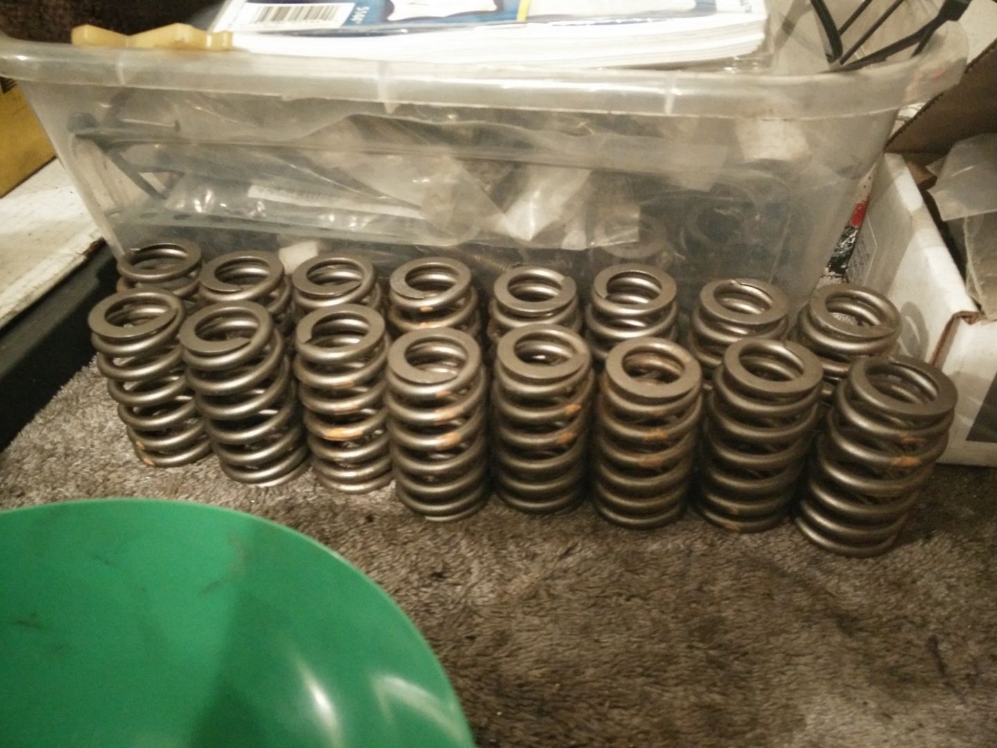

set of valve springs
both return and returnless car fuel rails w/regs
2.5" X-pipe with cats?
MAF sensor 3" it looks like
2 sets of stock injectors?
set of Delphi fat ass 50lbs
LS6 exhaust manifolds
didnt dig deep into all the boxes as its late and im hungry/tired. but yeah. 1/2 that shit is for sale/trade. the other half is going in the nova.

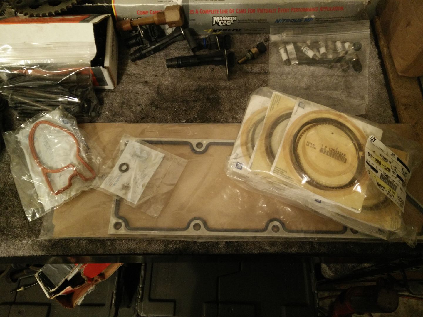

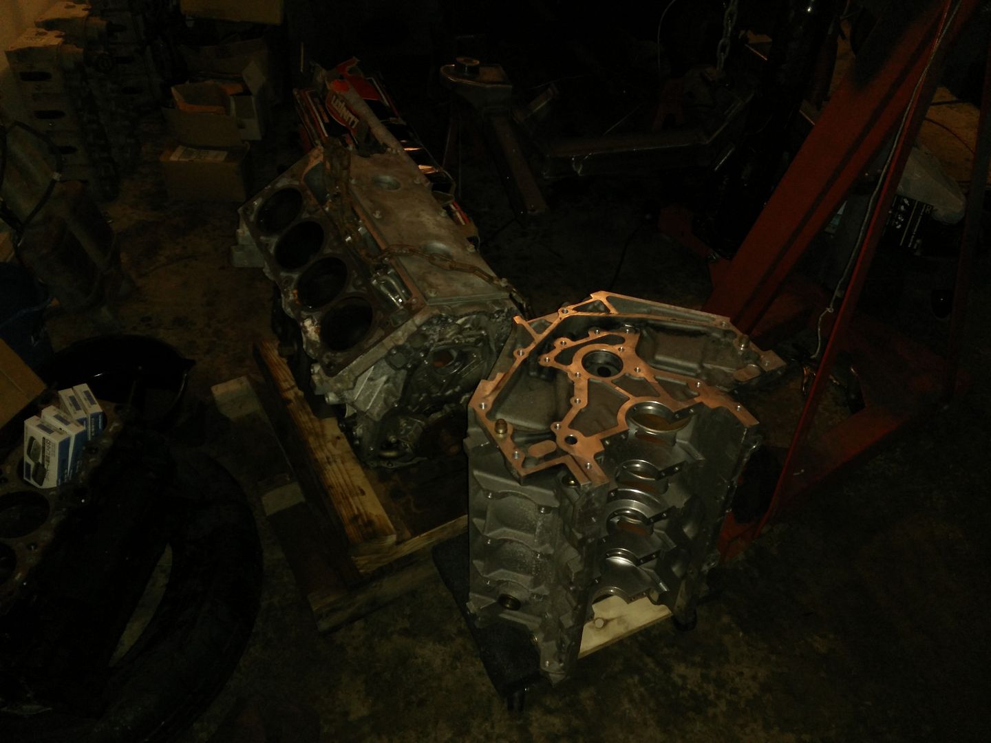

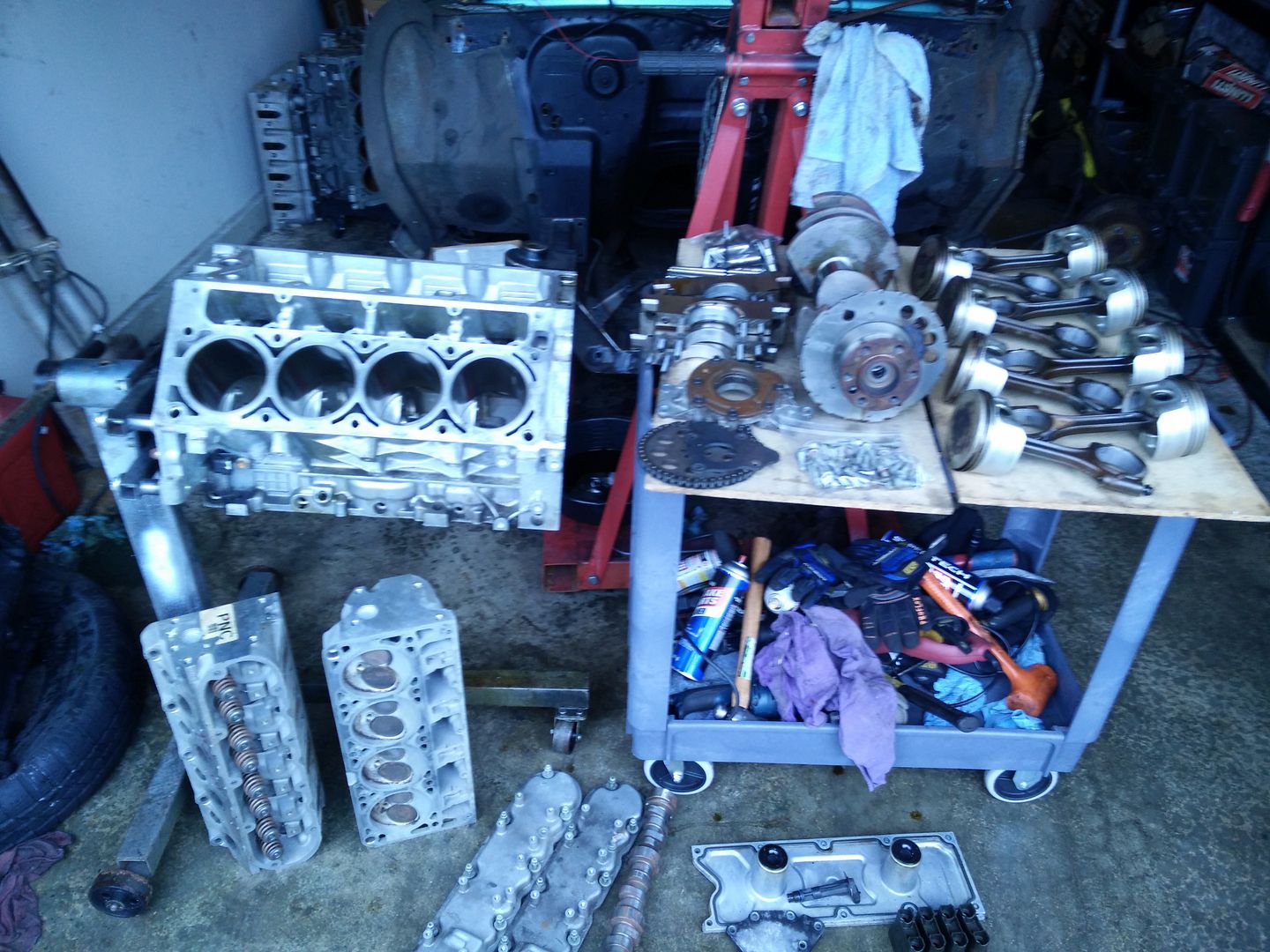

so i verified that the LS1 turns. but didnt get any further than that... i need to tear into that before i make any solid decisions on what im doing. but i think im going to build the LS6 for my car.
idk, you guys want pics of all this shit?

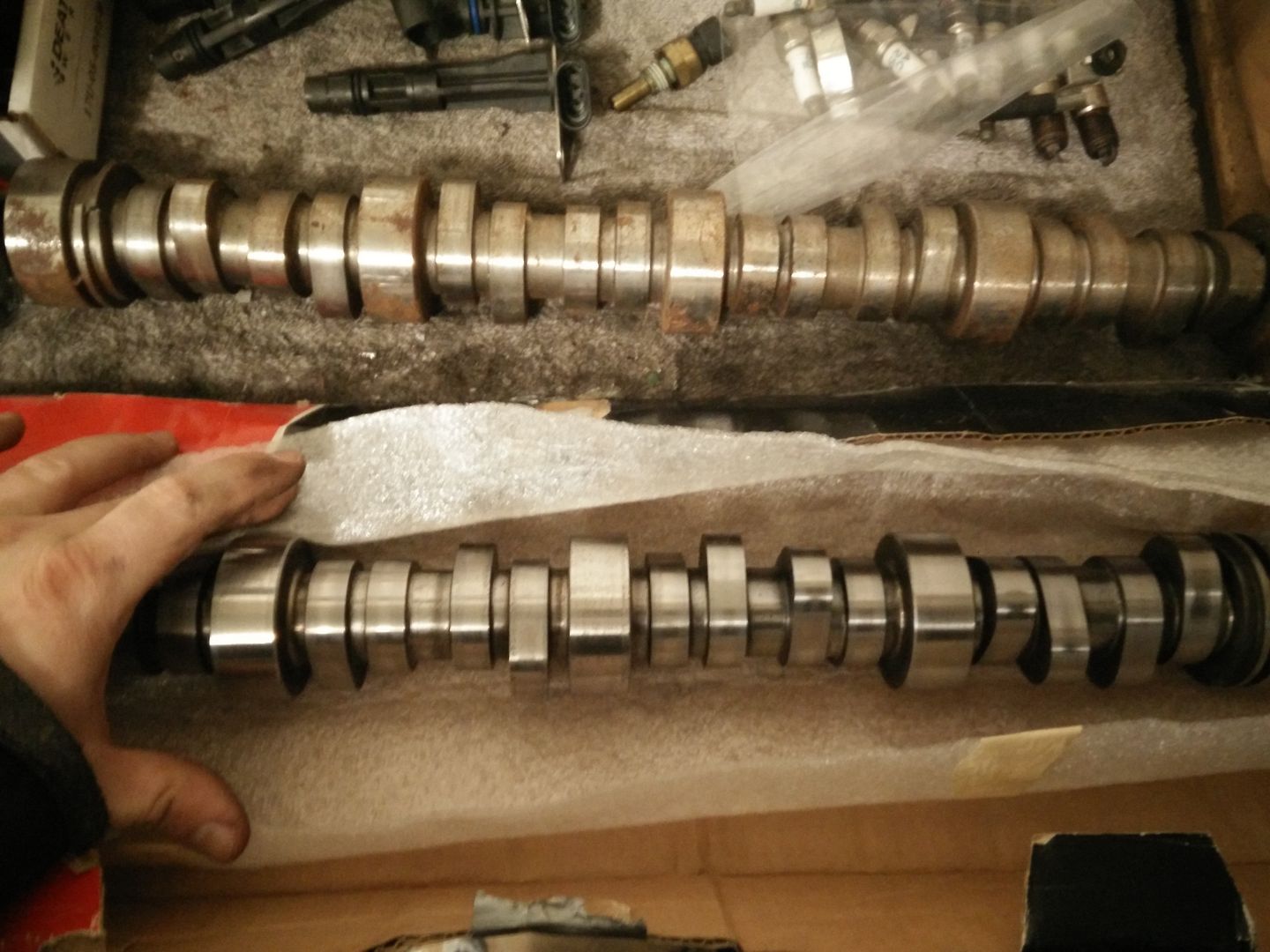

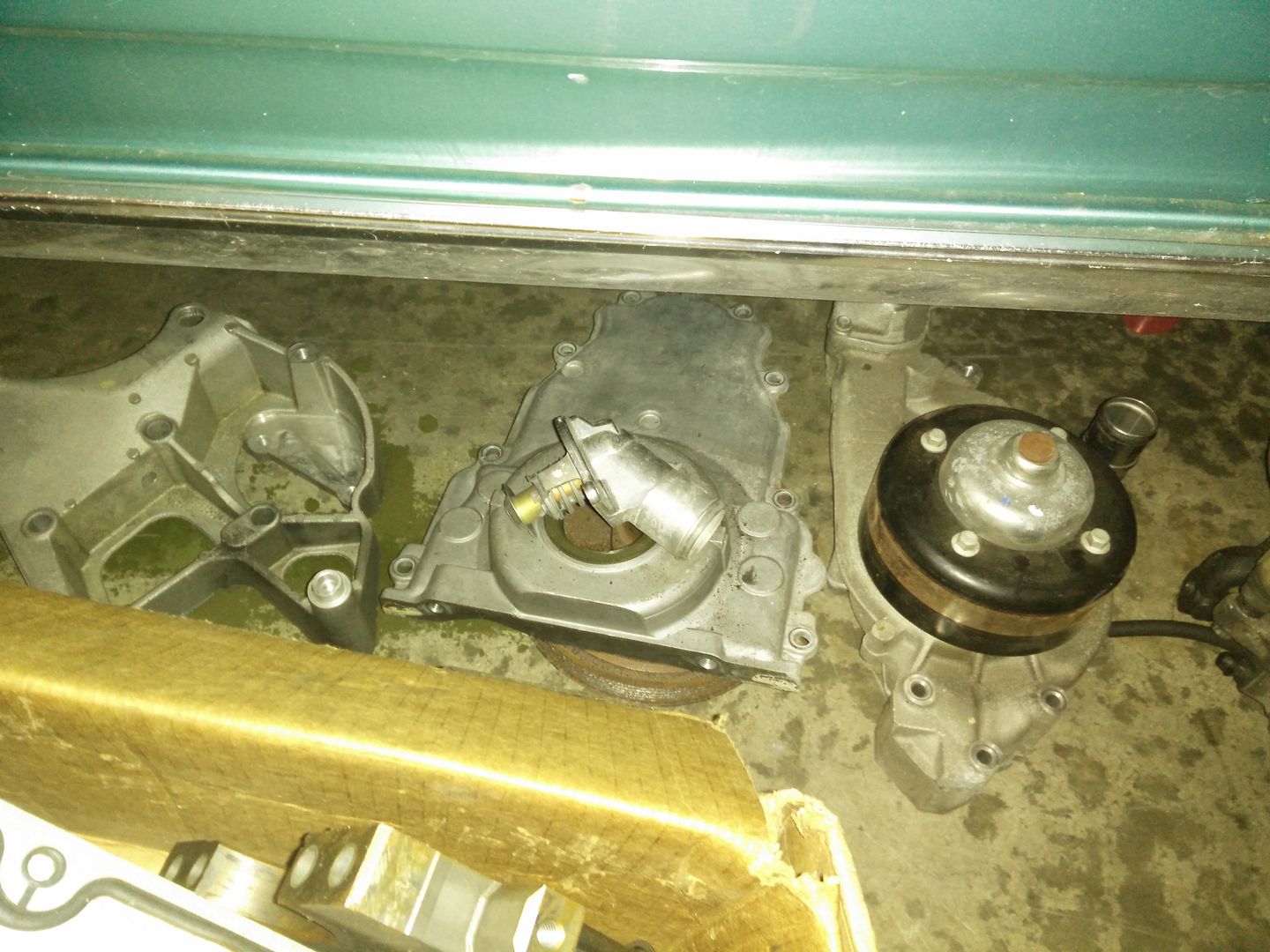

AJ. that should be LS1 cam up top, LS6 Comp 3714R on bottom.. LS6 was in another box. they where all swapped... thoughts on LS1 cam there? shit pic im sure. but got light spotting of rust. probably junk? $20? $50?

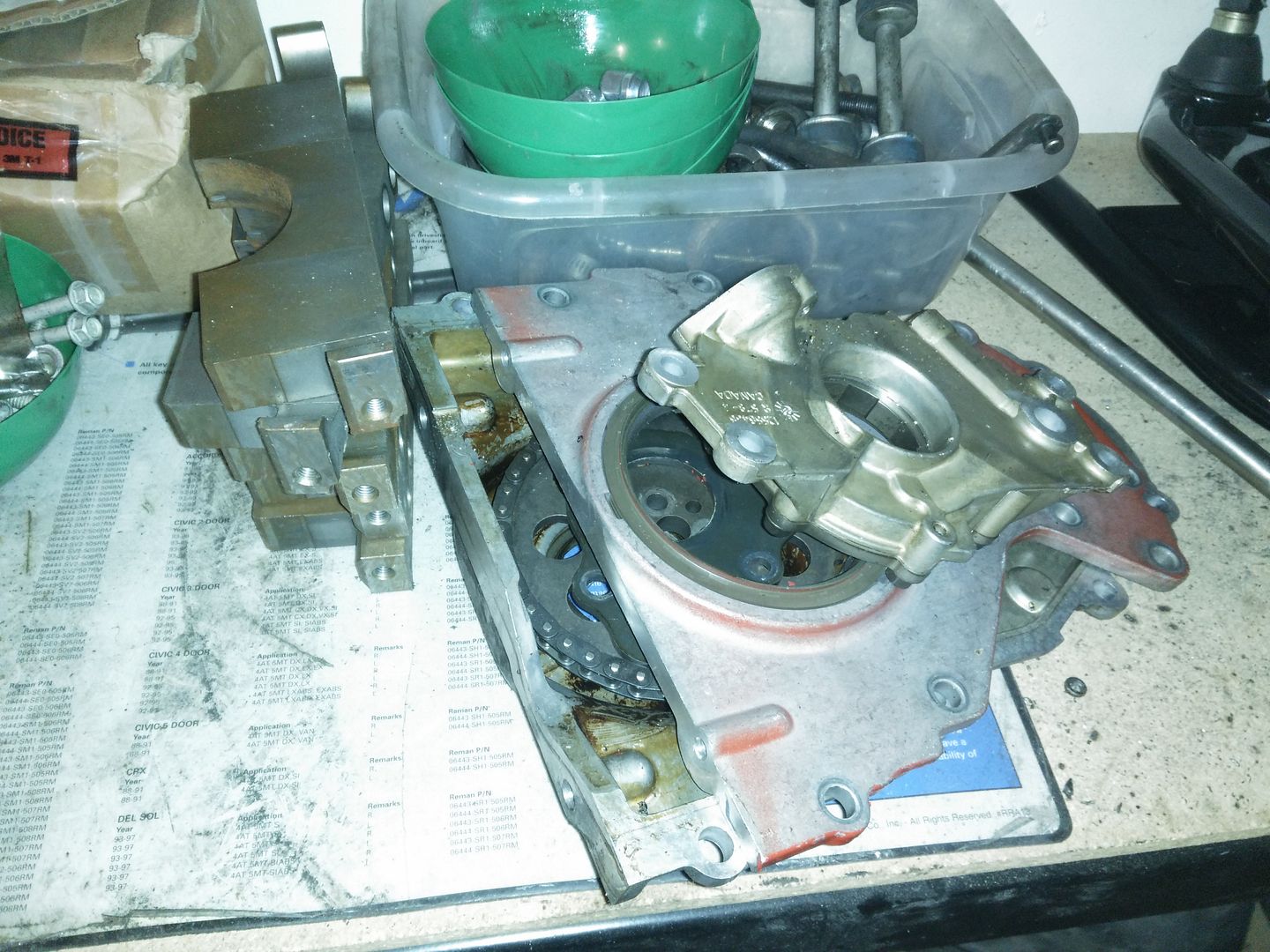

should be LS6 oil pump and covers. mint. im going to clean that shit and reuse it.  :Jew:

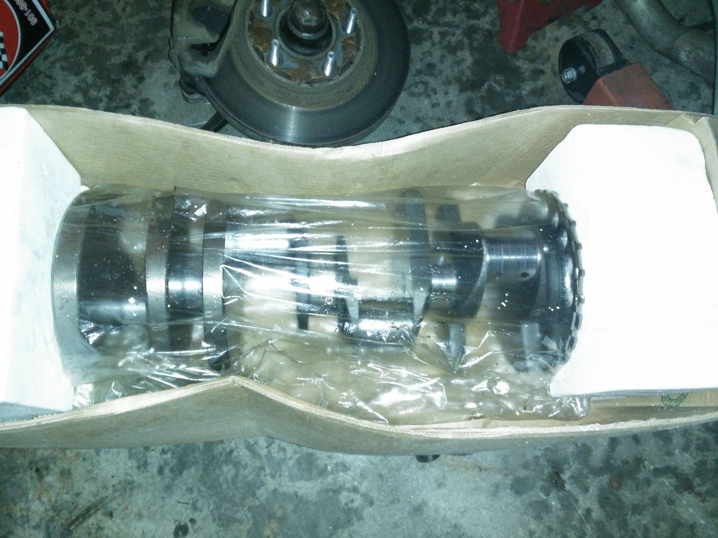

LS6 crank in its condom.

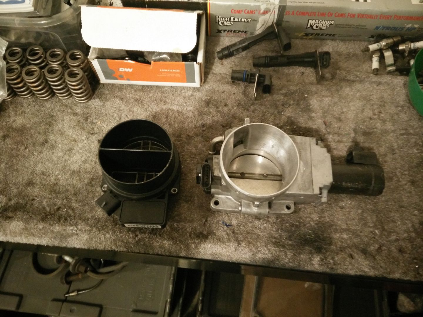

noticed that this LS6 TB is ported? but also looks like the butterfly is open slightly? good/bad?

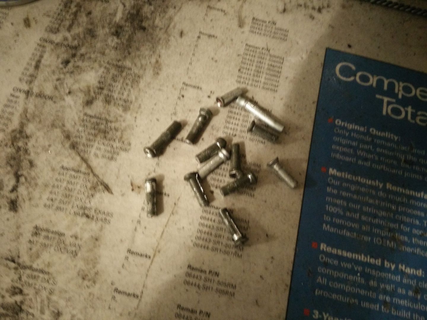

also have bunch of headbolts. not a complete set though. missing 2 small fucks, and 2 big fuckers.
guessing these are stock? took a quick look at the other ones in the other head, seem to have same paint color. looks like i have seats, but no retainers or locks.

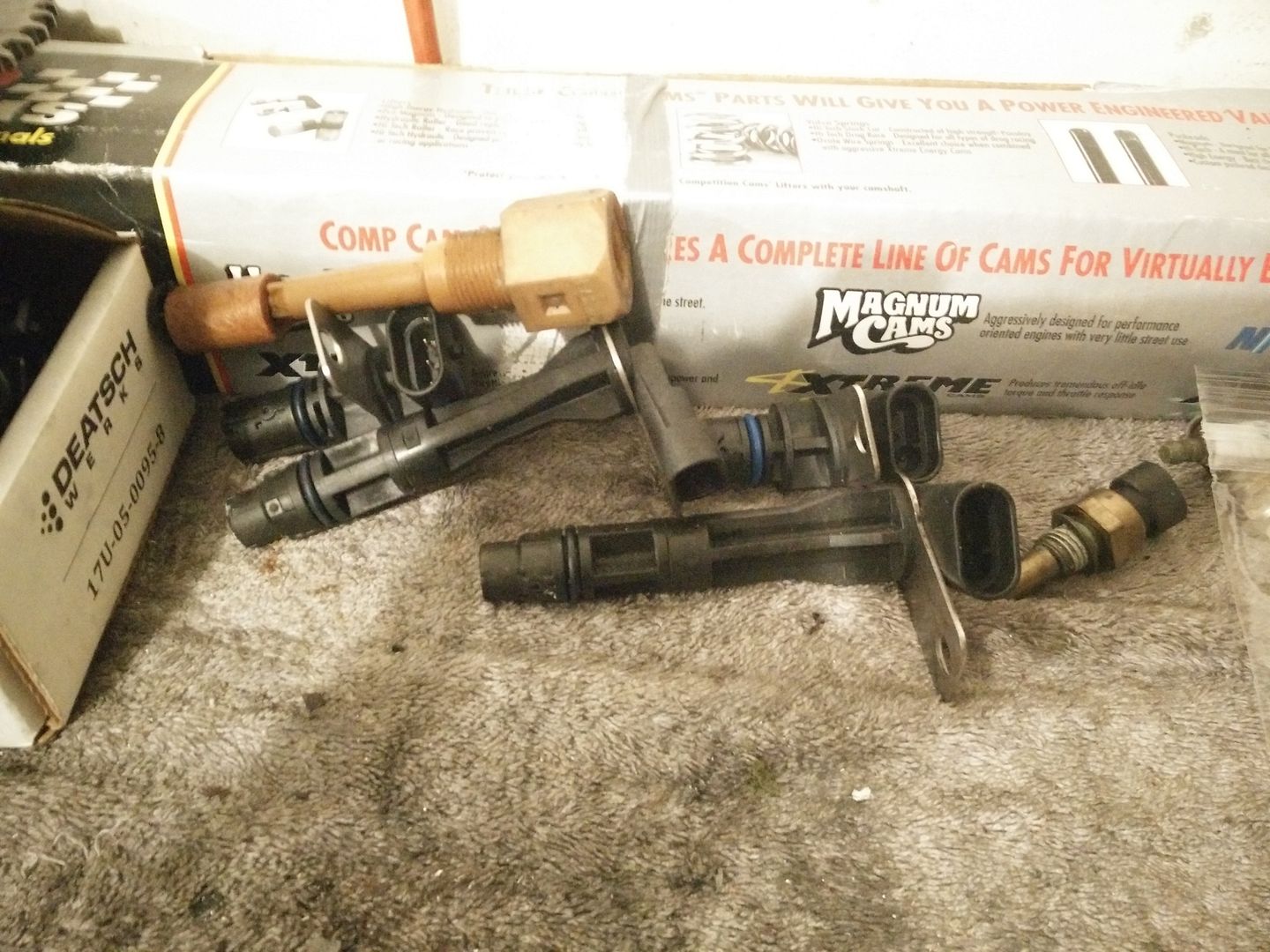

bunch of sensors. plus i think the LS1 has both of its sensors installed still.
MINT. this is the LS1... think im going to sell this one. and the early heads if someone will buy them?

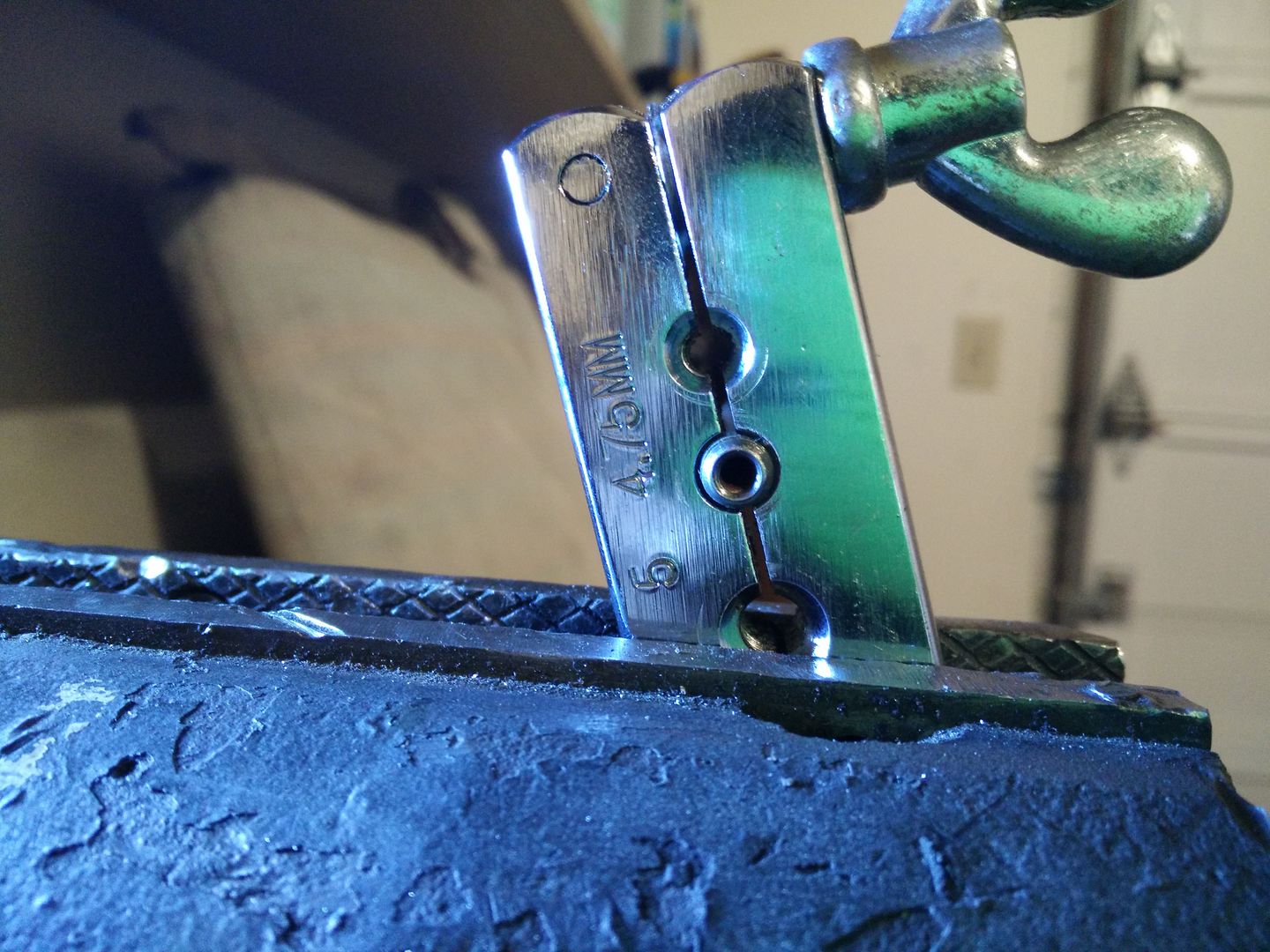

NOTE:  order 3.898"/99mm ring compressor and ball hone. and probably main bearings.
going to try to take a look into the LS1 tomorrow night.

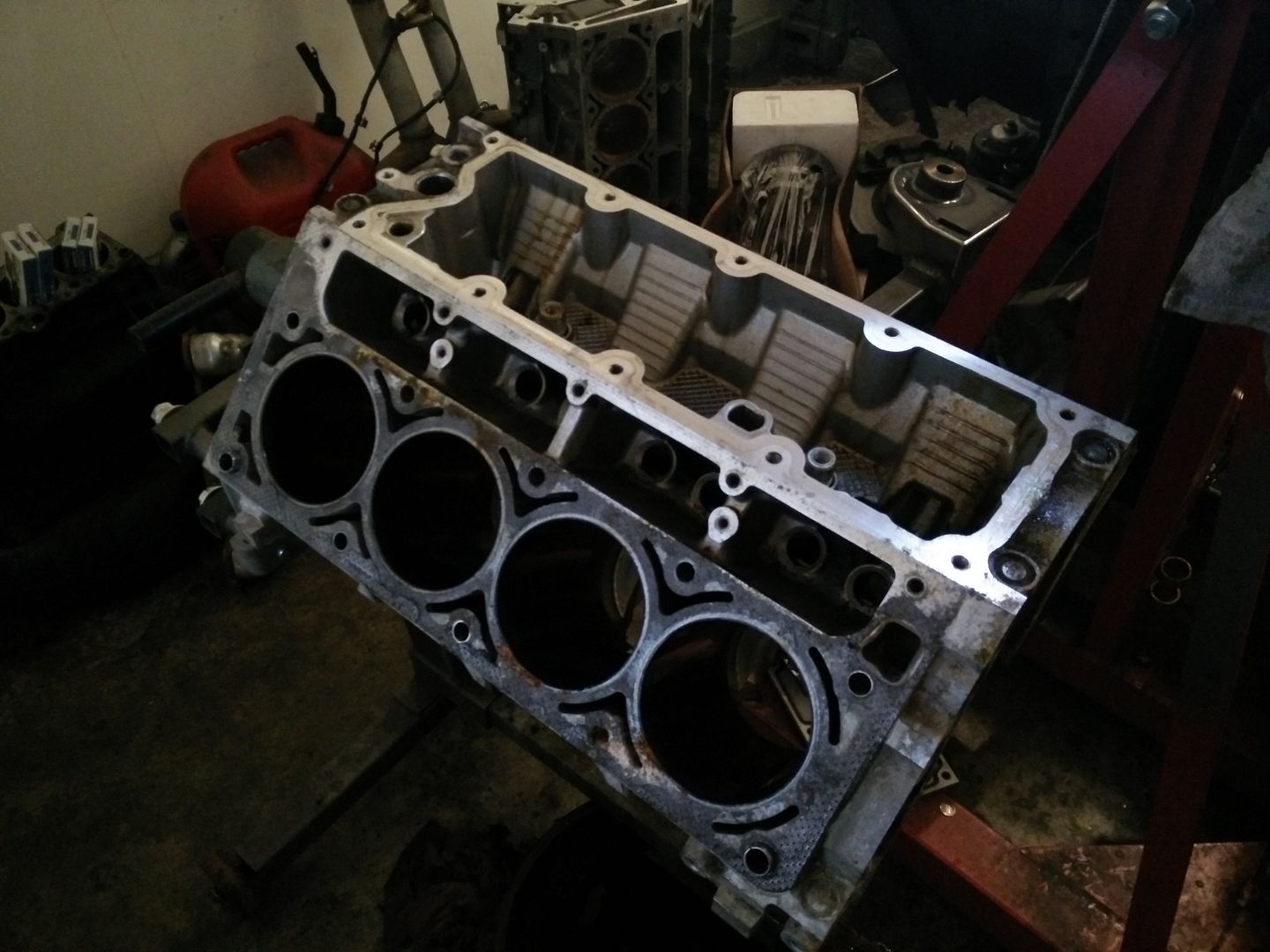

ok, so loose plan just looking at the pile i have.
LS6 block thrown together. like reuse the rings and shit im sure.
buy couple missing headbolts or just china stud it?
throw on the 853 heads with a surface.
run stock springs i have?
run the Comp 3714R cam
run DBW return fuel setup. HPTuners.
stock Z06 manifolds, cut, vbanded, to junk exhaust i have.
i need lots of shit still:
03 truck harness? or vette auto harness.
accessory shit: vette PS pump, alternator, tensoners
knock sensors, o2 sensors, coilsetup
TRUCK INTAKE. cuz im jew like that.
flex plate.
i know i must be missing more. my ADD is all over teh place lol.

Iirc those throttle body's are slightly open at rest just like that.

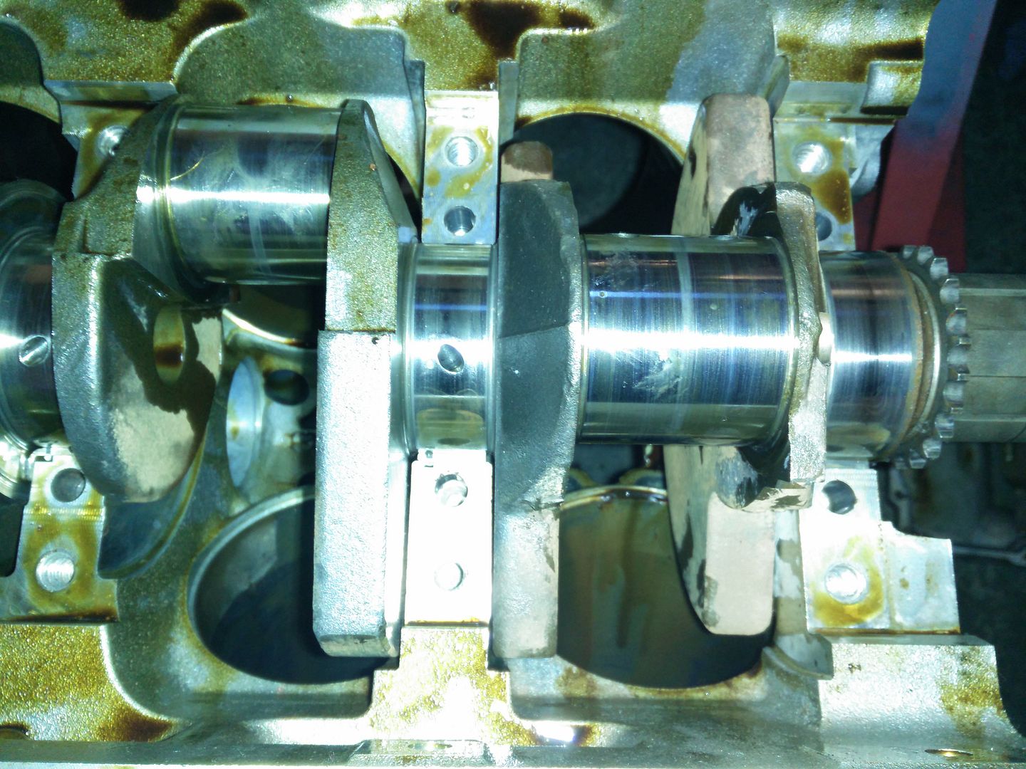

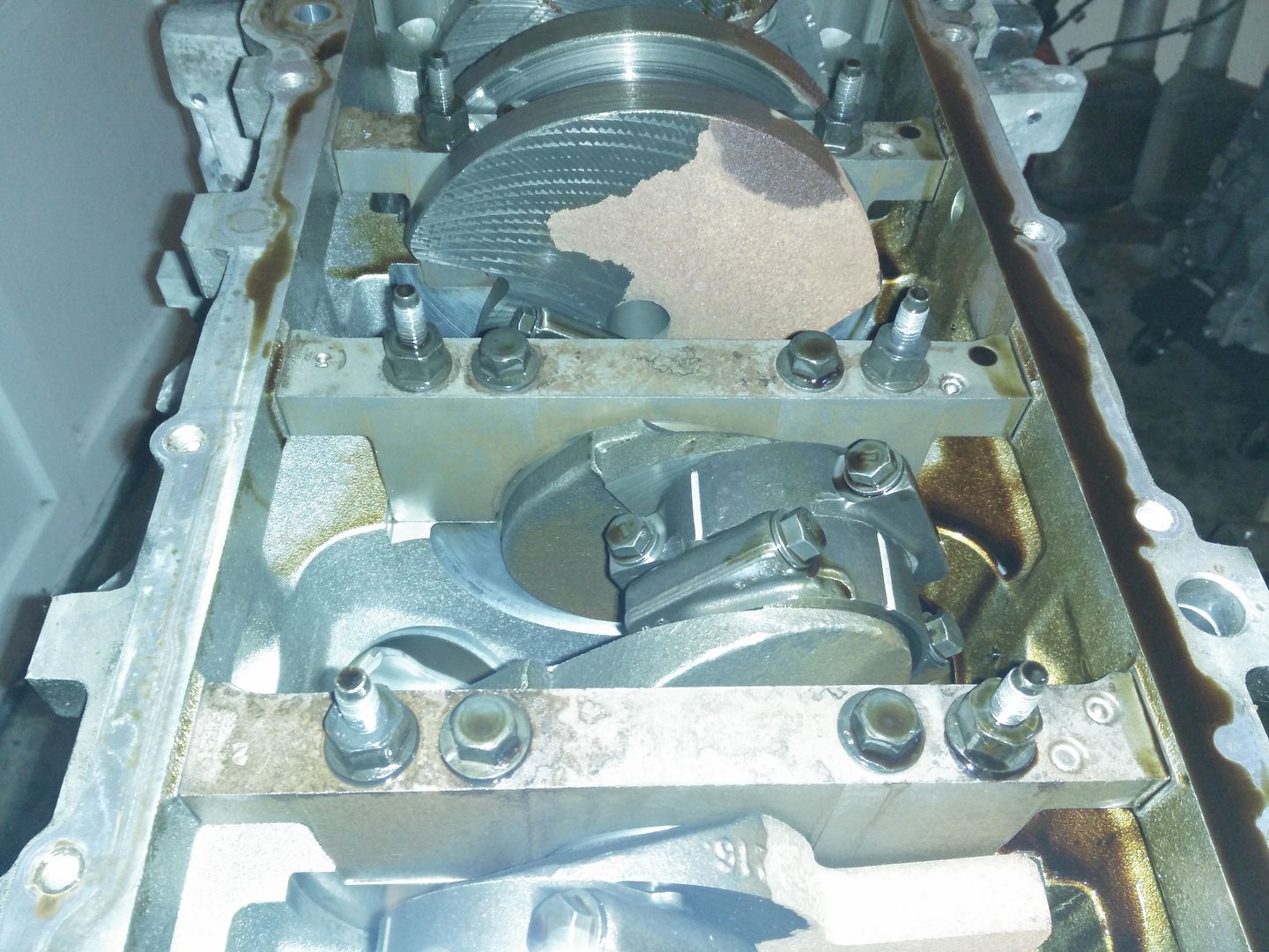

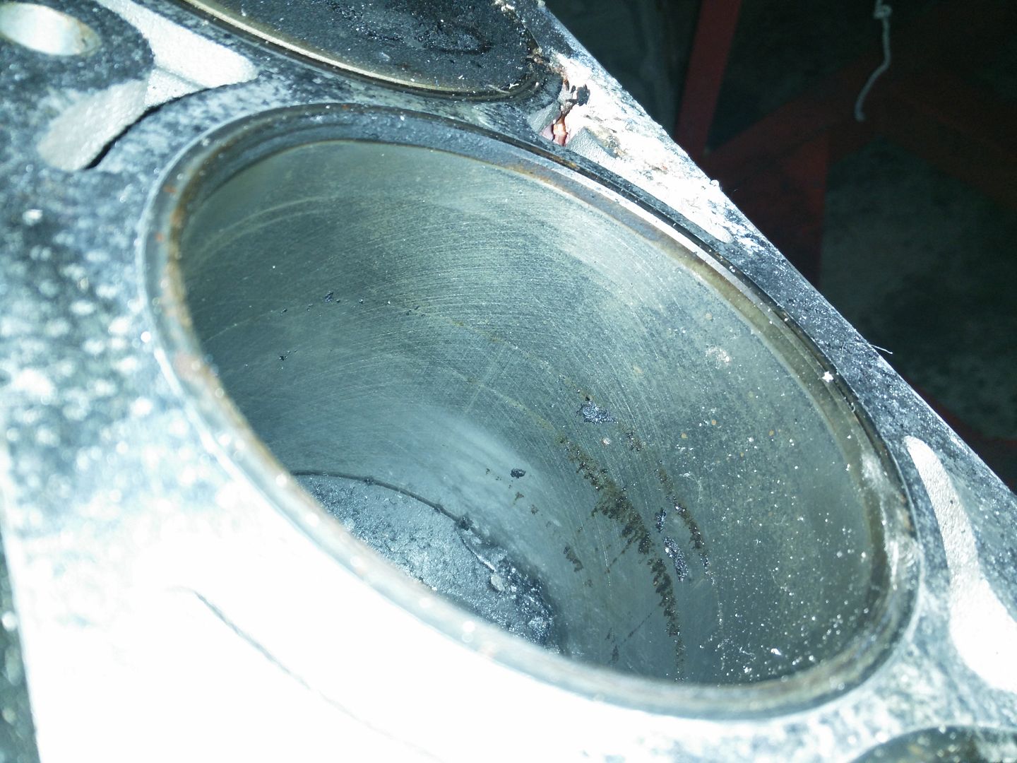

the LS1 is fine. just a little cosmetic surface rust on couple of the counter weights.
i brushed off lot of the rust with a red 3m pad. blew it off with brake cleaner. probably hose it all down tomorrow then post it for sale. lol.

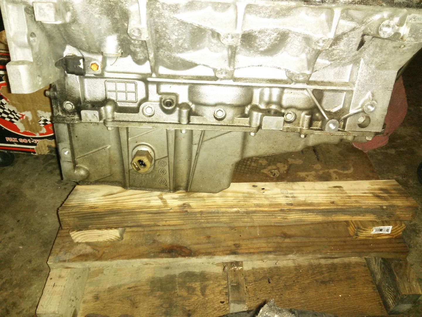

oh, and nothing funny in the oil pan, pickup or windage tray. all of which i will be keeping as its an Fbody pan i need for my car.

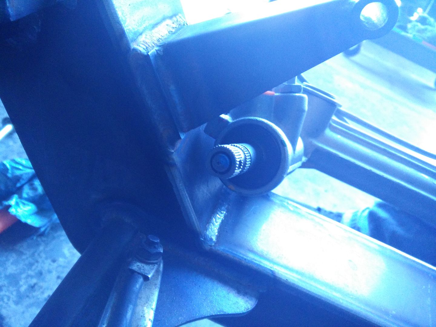

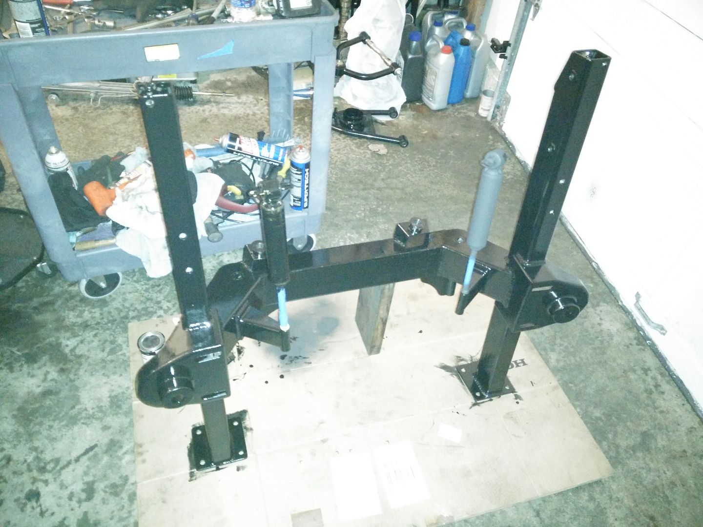

update... my hands hurt.
oh and:

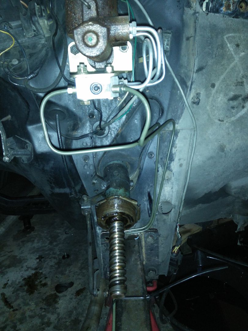

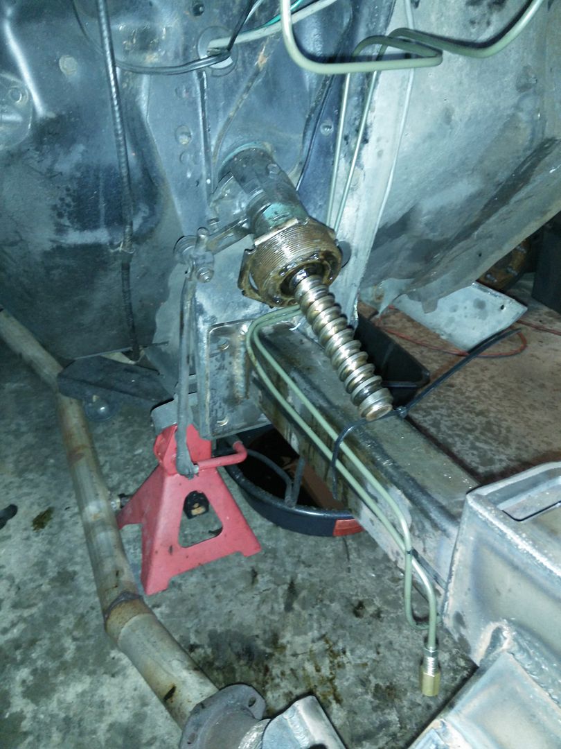

i know how you all love the zip ties, but thats just for test fit. i got some rubber insulator and nylon clamps to hold everything thing in place once im done painting.
oh how much i hate you now... we did finally see eye to eye and got along.
not failures... just a long learning curve.
also test fit the suspension. had to trim lower mounts to fit LCA's. no big deal. also measured for brake line fitment (cheap/lazy dont want to order/find new hoses, so found best spot for them with wheel movement). also took some rough measurements for brake caliper fitment.
not pic on the car, so this is what you get. 2" drops, and standard length tubular arms.
think thats it. tomorrow going to try and get the rack where want it. then paint... i didnt drill hole for brake line mount clamps, guess i will do that once its painted. no big deal.

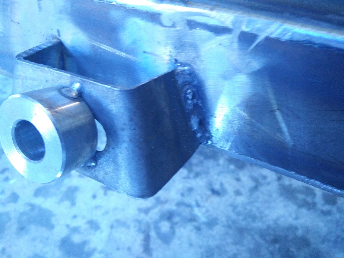

some flux core shots. plus i welded that stupid spacer to the crossmember, only did a handful of test fits and they where pissing me off. didnt fully weld just in case i change racks ever.
first coat of paint on the crossmember. think i will be doing a second in some areas. kinda looks like shit. i canned one shock and brushed the other. dont like either.
