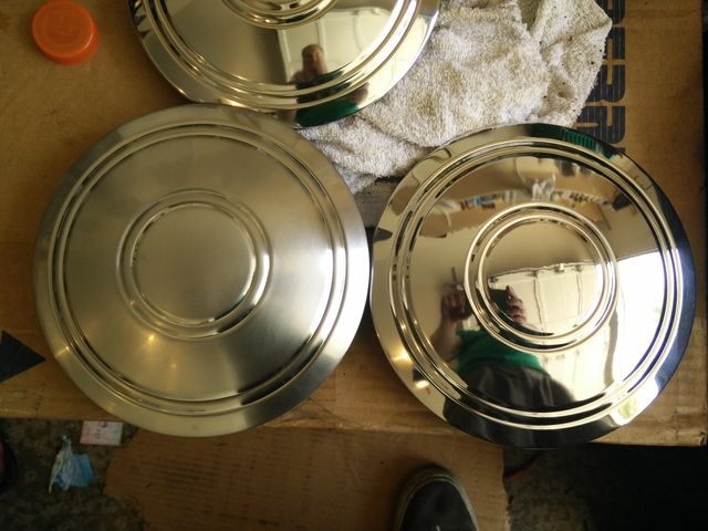

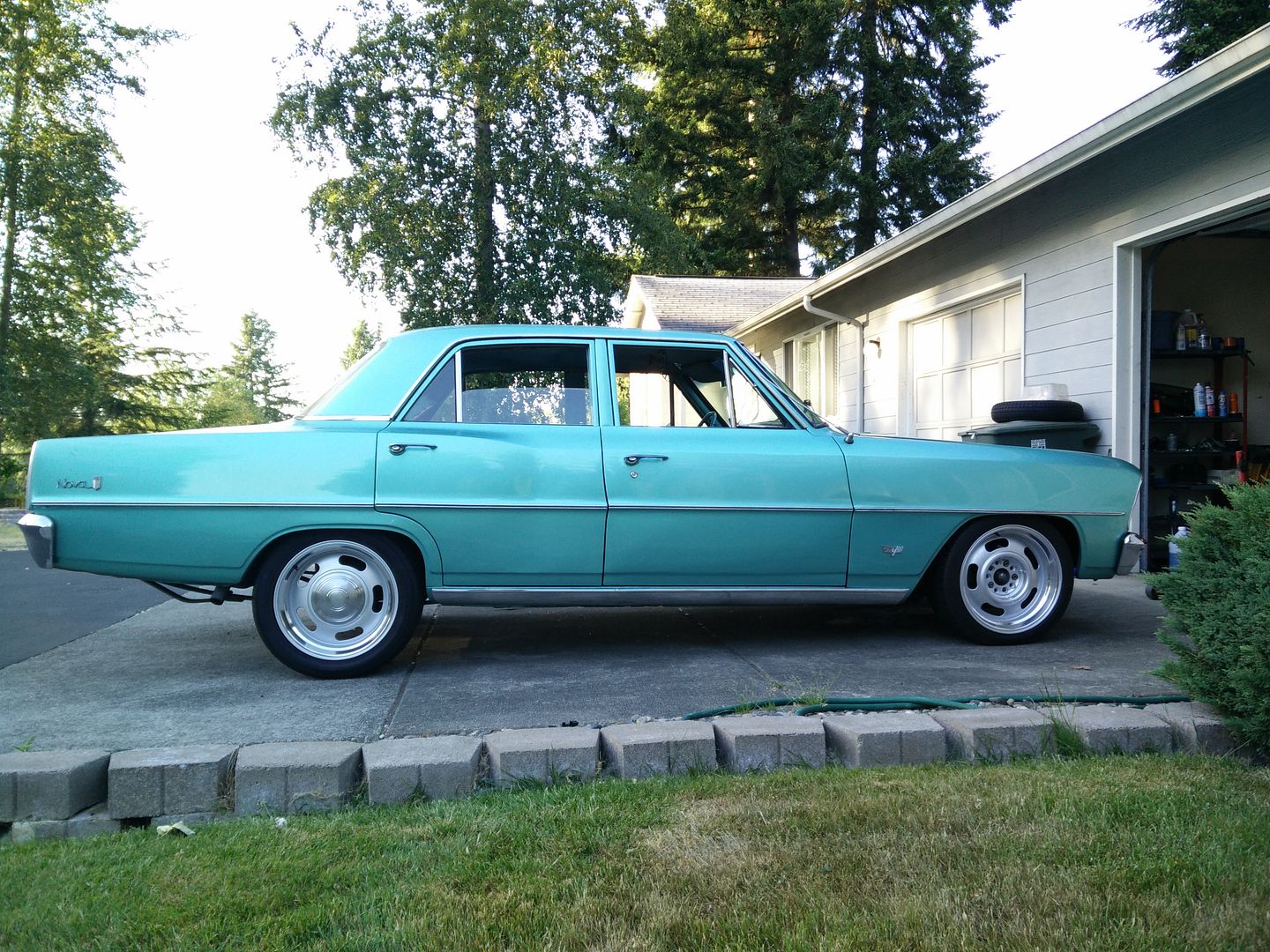

ok, so i have clammed down a bit. still annoyed (simple task, just bolt some wheels on). hope these studs im gonna run all over town for are going to fit my future brake setup.
think im going to cut the front springs... see how far i get with the studs. its hot, and im not going to get far, i hate the sun...
Those actually look pretty good on there. I've always seen your hub caps called "poverty caps"
thanks. yeah i have heard that too. buddy laughed when i said that, he knew what i meant but said he never heard it before?
i like them because they are plain and simple.

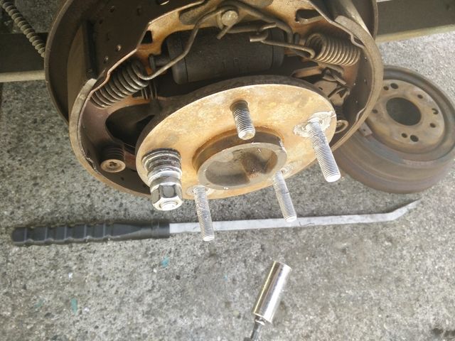

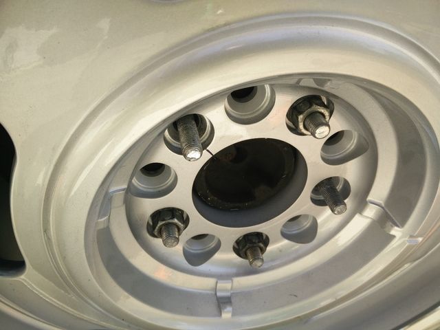

i only got 1 corner done. and only enough studs to do one end of the car. still need 10more. and to figure out how im doing the front. my guess is i have to pull the brakes all apart.
oh and several of the ones i pulled from the left rear where bent. getting the drum off was a bit of a bitch.

You should turn the lug nut around when your tightning it down to pull the new longer studs through. Also should put the oil between the washers when pulling the new stud through. Will help ease everything in a little easyier.
Lube is always a good thing when your trying to put a long shank through a tight hole!!

cant swap the lug nut around. there is a small shoulder on it. maybe ill get a hardened nut at the hardware store tho. also there is antisieze everywhere. i put it on the threads in good amount, and on the knurled part that pulls into the hub. but ill throw some between the washers. actually i might try to find a spacer at the hardware store also.

I pull those in just like that. No "never-see" (inside joke) on the knerles though, just the threads. Only thing you have to look out for is if you use too small of washers you will squeeze them right into the threads. I also use a scrap lug nut. A normal nut would be best but I never have the right one handy and you know flat rate.

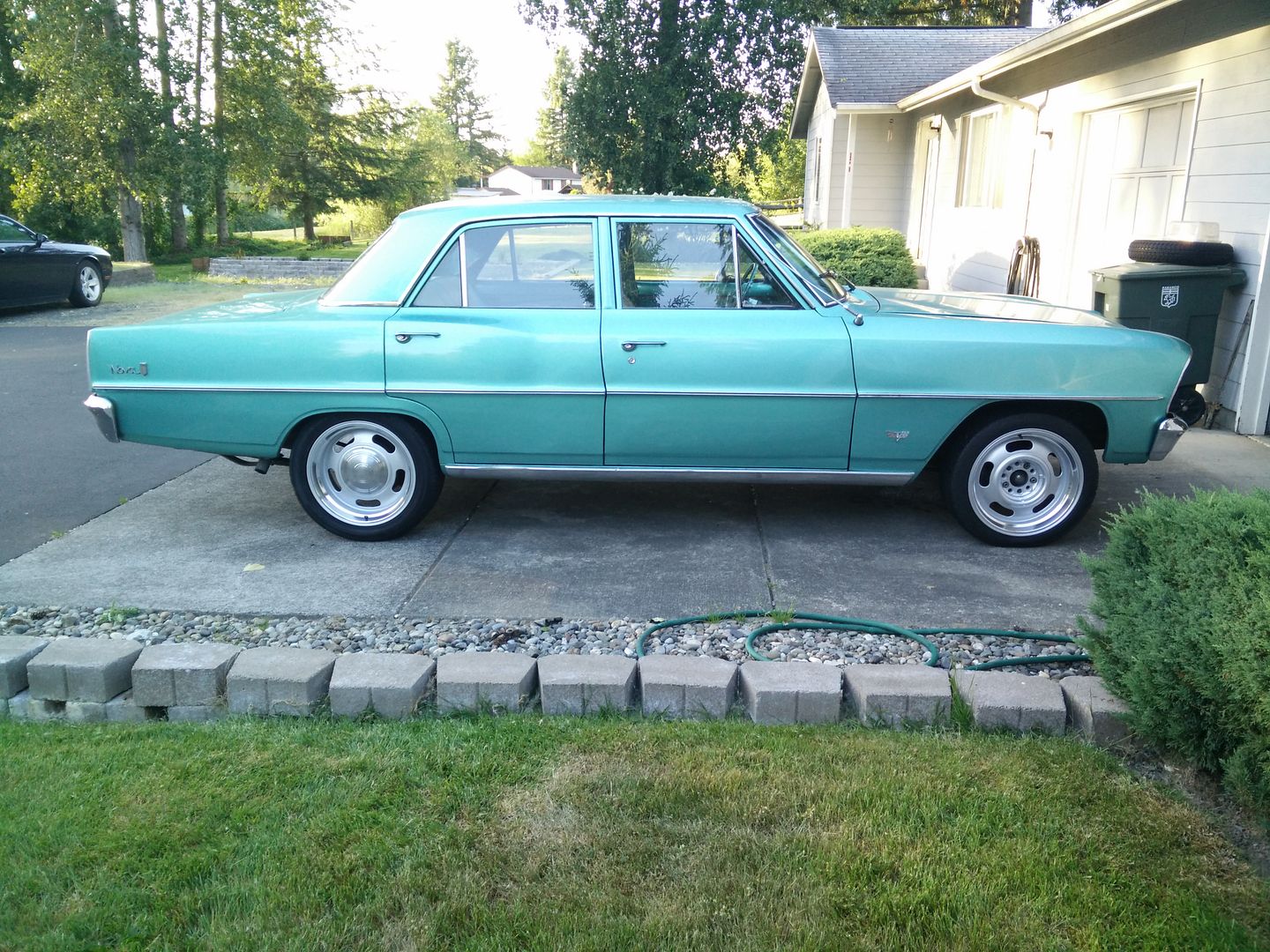

got another corner done.
shitton of room on this side! also did a quick measure of height, and the right rear is almost a half inch lower that the left rear?!?! fronts where close enough to each other.

Excited to see the car lowered.

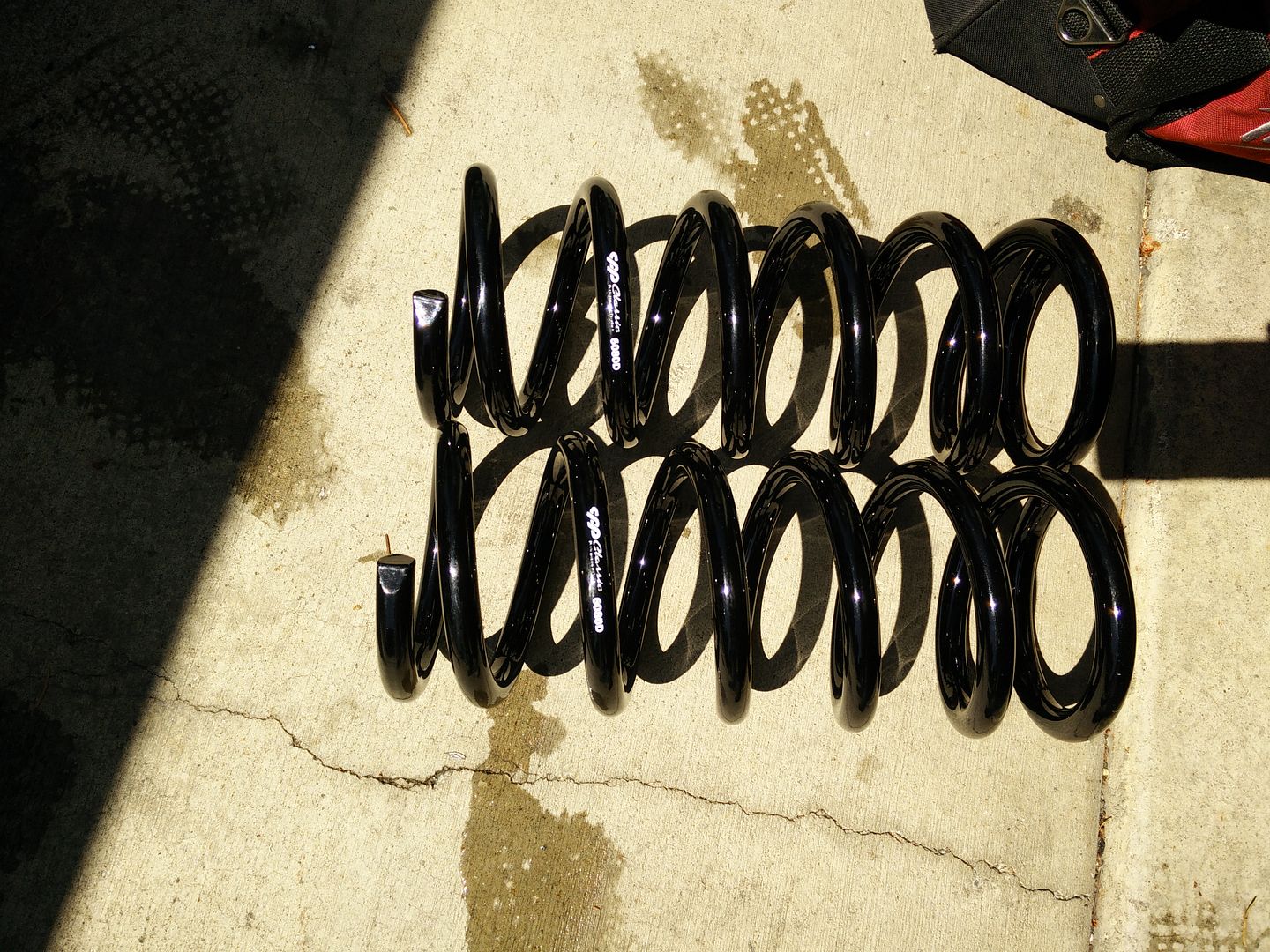

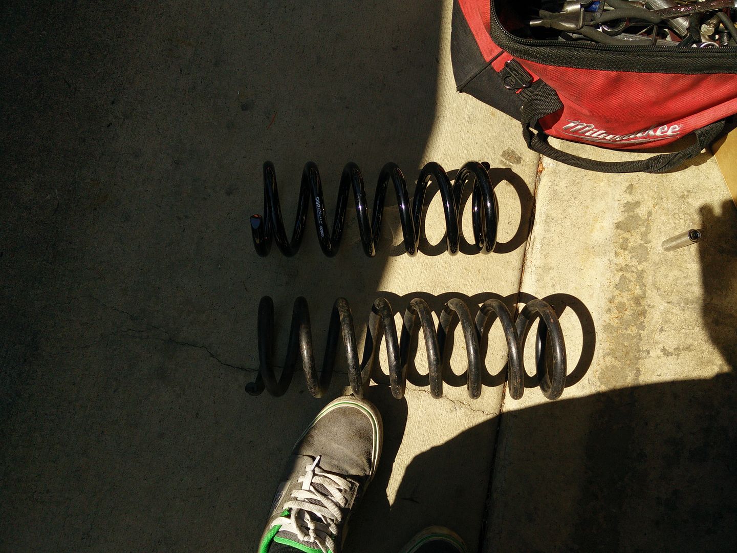

so i ordered 2" lowering springs from CPP. they look to be very nice. plus they are black and not some ugly ass chrome or stupid color.
compairo of the stock (i assume) and the CPP

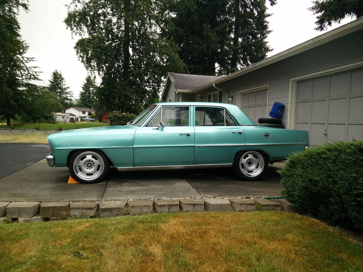

stance

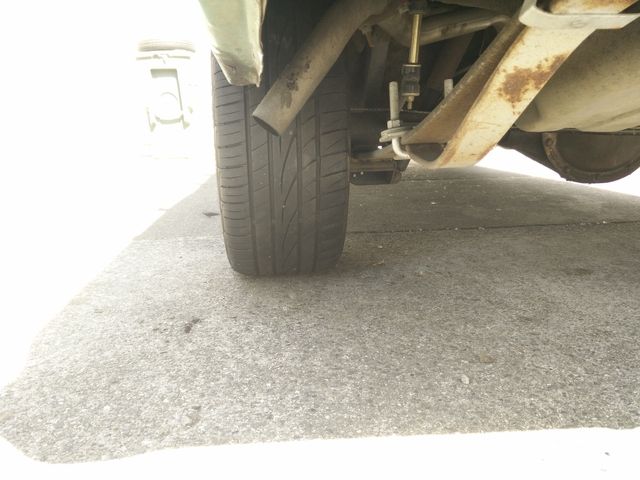

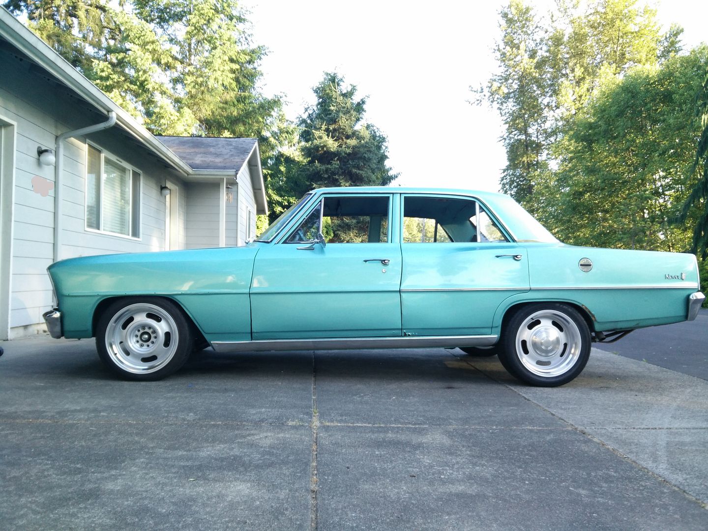

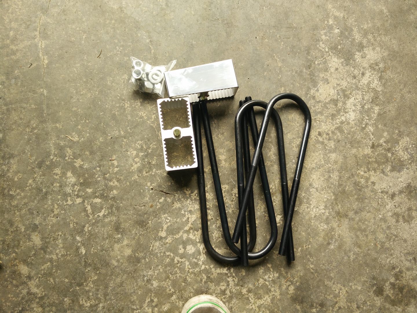

back needs lowered obviously. i ordered 2" block kit. but after seeing it the way it is, i was really thinking 1" blocks are needed.... now after thinking and looking at it more, measuring, thinking some more, i think it needs 2 or 3" blocks... idk.
oh and...
full clock to the left. so the same as the rest of my cars. it will make a horrible noise when i come off the road into my driveway at 20mph lol... im going to try to roll/hammer the lip down some when the wheel is off next time.
waiting for lugnuts (fucked up 4 doing rear studs), going to have to order some front wheel studs from Jegs. ones i have wont work, and dont exist otherwise. i didnt put the wheel caps on the front as they are a bitch to get on, only imagine a bitch to get off.
also, she needs an alignment bad! pretty sure she needed one to begin with. odd when it was in the air looked like toe in, and on the ground it looks like toe out? im 0/3 on driveway alignments i do believe... time for another lol
 :Jew:
Re: 1966 Chevy Nova mordor project...
« Reply #103 on: June 14, 2015, 10:08:12 AM »
Looking good!!!
Hard to tell which blocks you need on your driveway though. You need flat ground, imho you always need a little rake on the old cars.
« Reply #104 on: June 14, 2015, 10:33:52 AM »
I'm thinking a 1" block in the back. Front springs will settle a little bit too and it will continue to drop.

« Reply #112 on: June 19, 2015, 06:00:25 PM »
apparently I bought tapered 2" blocks for the rear. dong remember it showing or saying that. hell I didn't even notice till ivwas putting one in the car.
need to align the passenger side block better. got late last night fighting with it. then pull it to a flatter spot. still think it needs a little lower in the back. but its a good stance now. I can deal with it.

Looks so much better lowered.

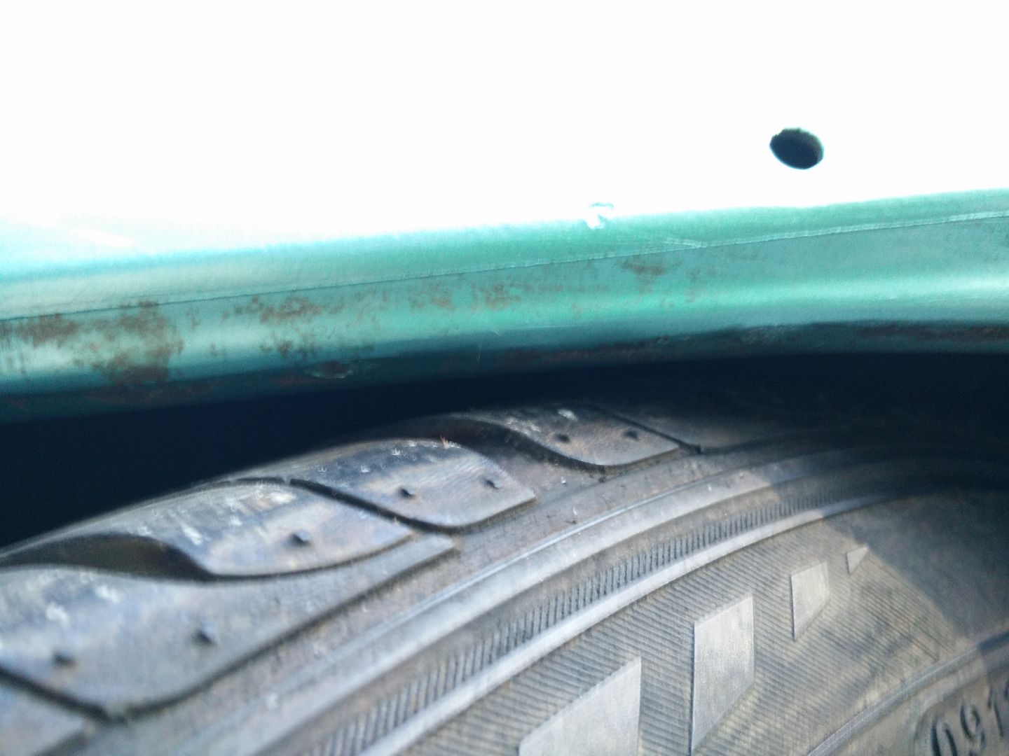

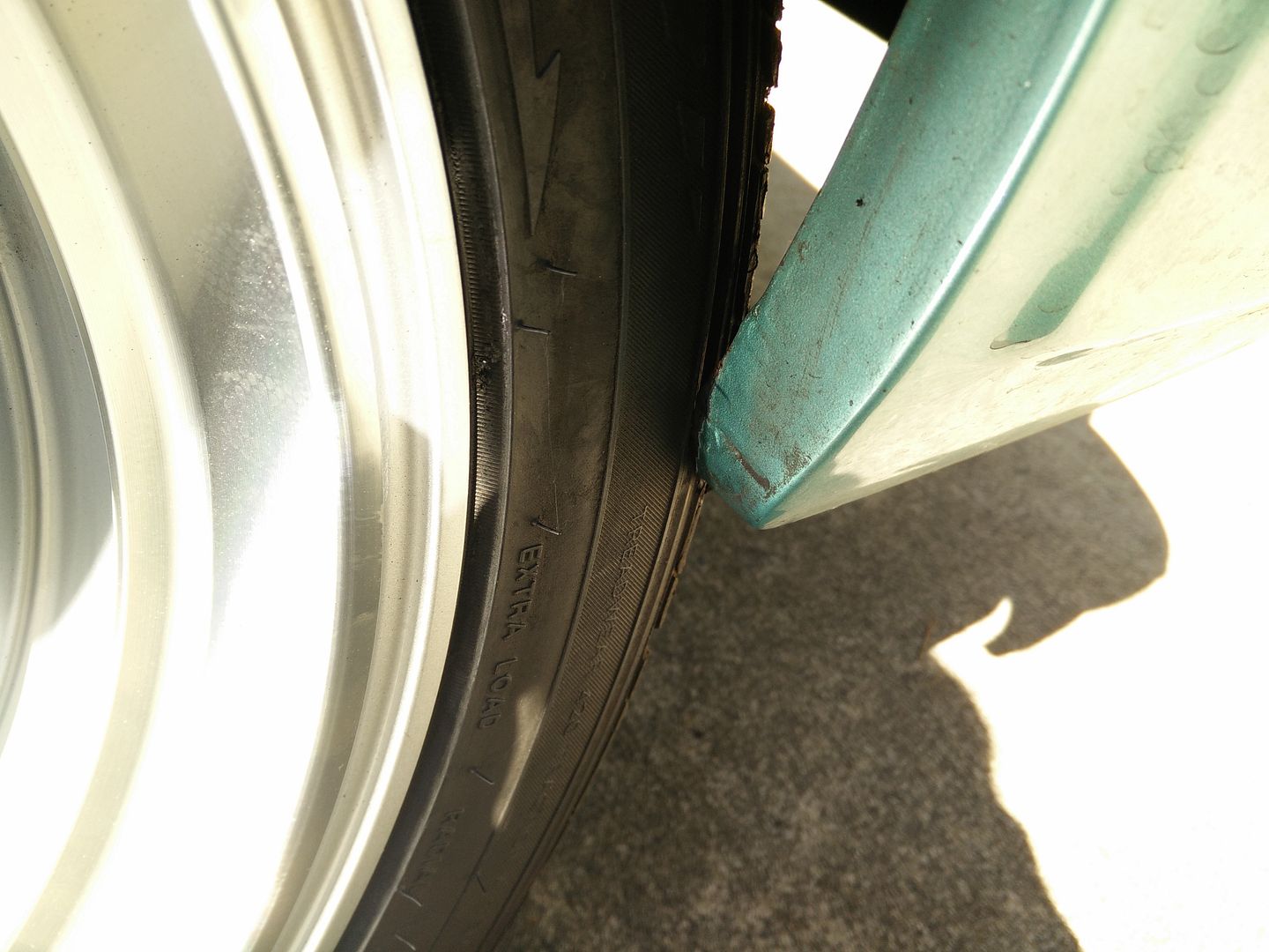

think I found out most if not all the noises I was hearing. adding PS fluid to the empty resevor seemed to help a lot. lol.
and...
that would be the rubbing/scraping and clunk I was hearing.
then I driveway aligned it. looked legit. on the ground. once it started to roll it pigeon toe'd and started to make noise.
haven't bothered to look at it sence. seemed like it was still rubbing also.

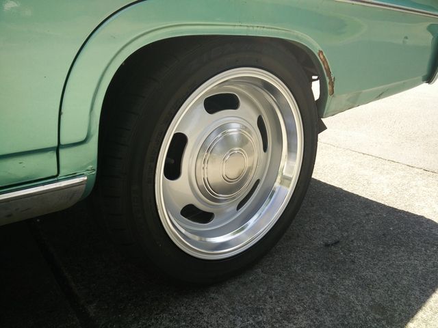

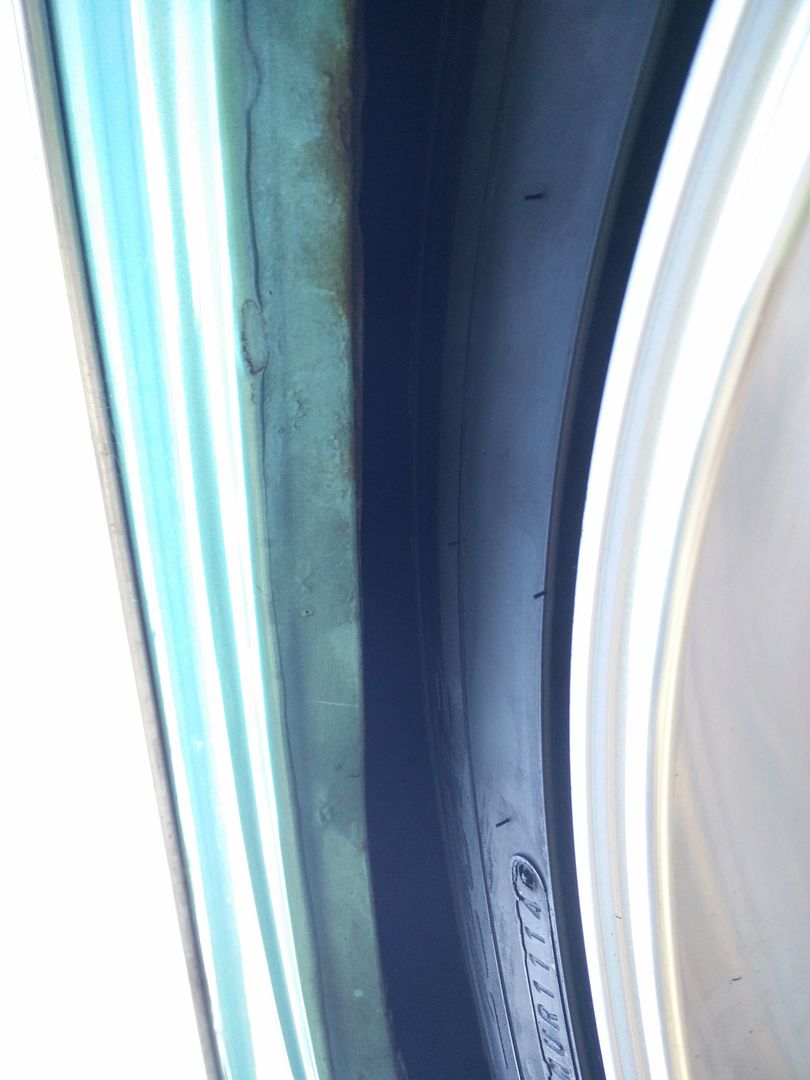

so I have been thinking. bad I know. but most these disc brake kits push the wheels out increasing the track width?? so if I swap back on some drum knuckles or use even the disc knuckles. and put the drum hubs and the 98+ Fbody dual piston calipers and 12" rotors... that should move my wheels in a little and provide more fender clearance? be worth the trouble?
« Reply #117 on: June 25, 2015, 09:51:51 PM »
Put a 1/2" spacer on the support rod that attaches your fender to your frame. Should push it out enough and still look fine. I put a stack of washers between my frame and the rod so I could have clearance for my wheels.
« Reply #118 on: June 25, 2015, 11:52:20 PM »
Some disc brake kits push out a little some push out allot. All depends on what you have. All of them push out more then a set of drums though, even the stock Chevy ii disc brake setup did. As Aj pointed out that is a very common mod.

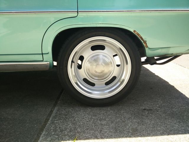

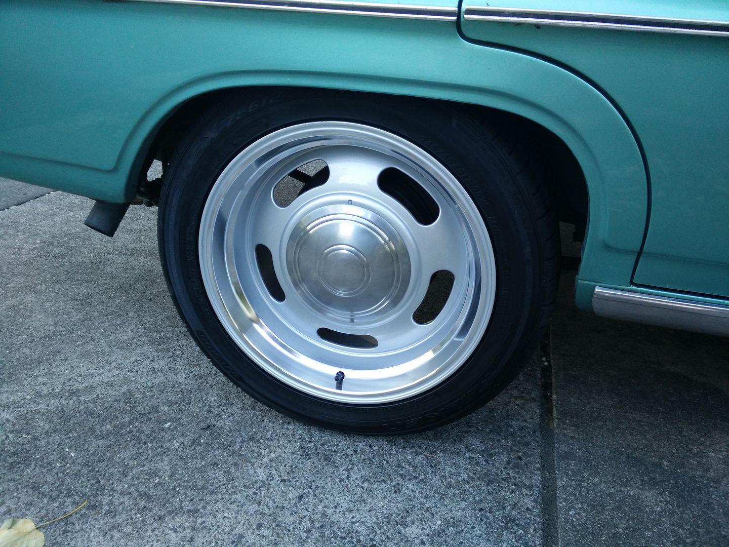

I like it better without the caps. With the caps on it looks a bit too faggy with that color.
