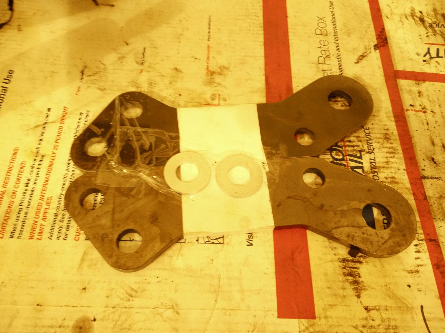

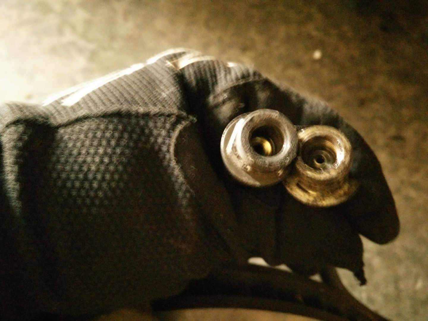

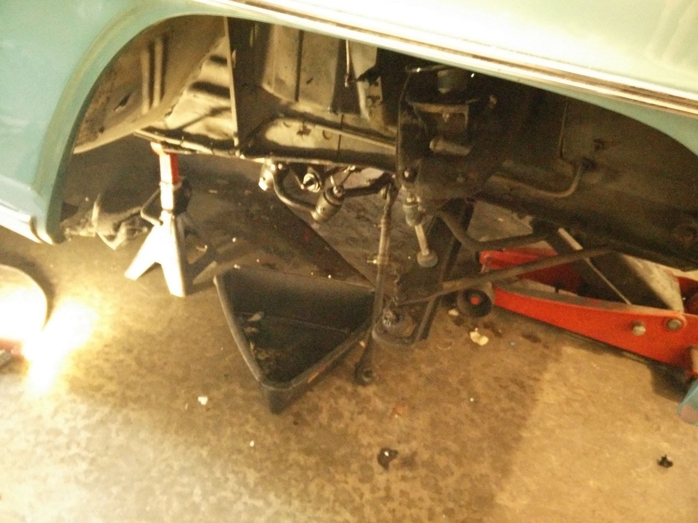

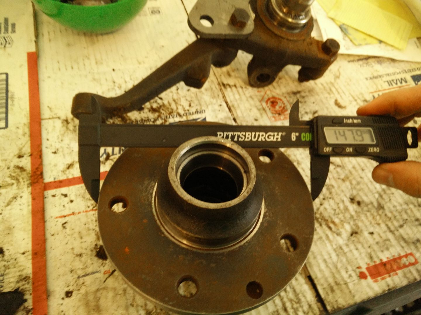

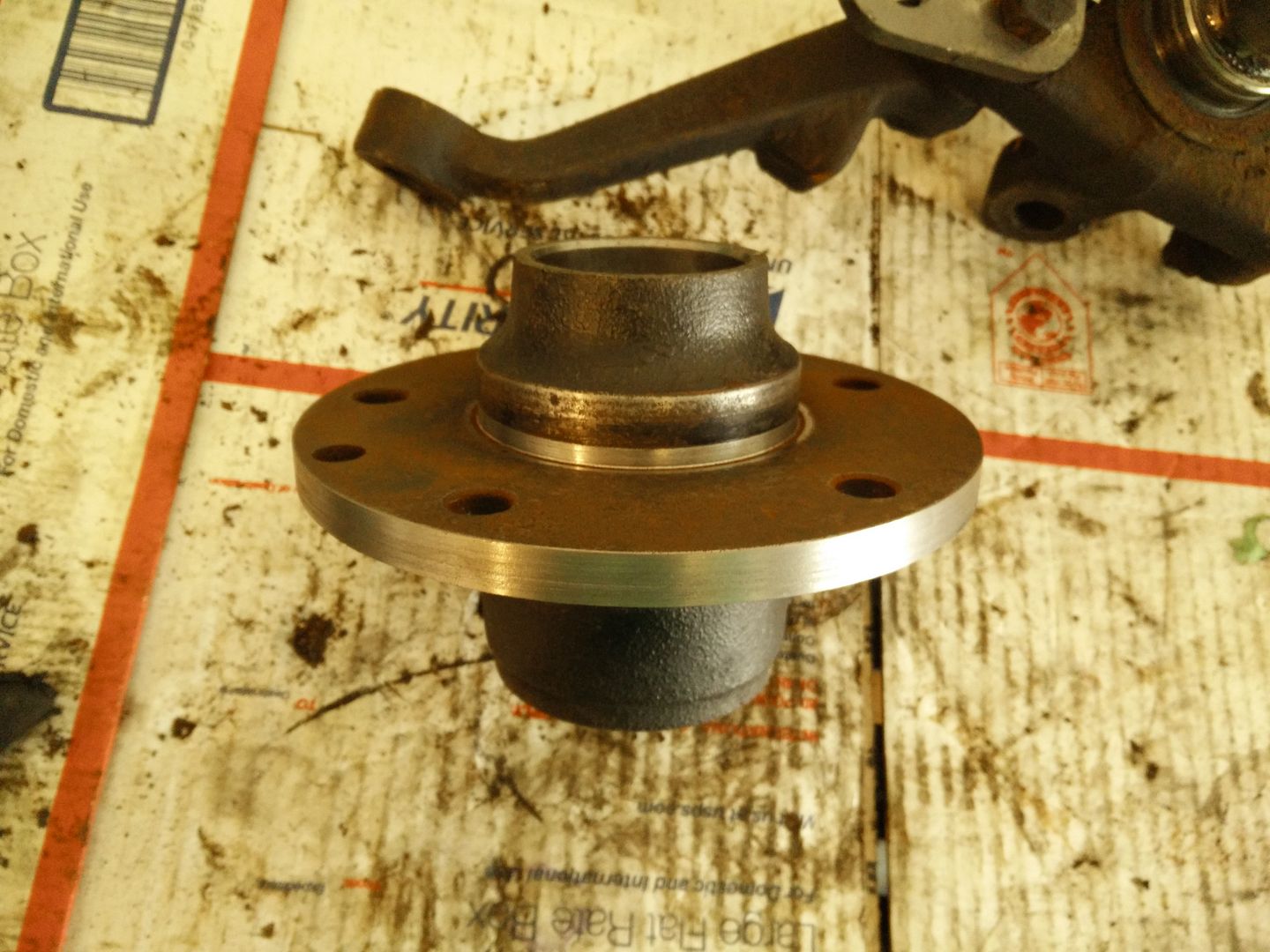

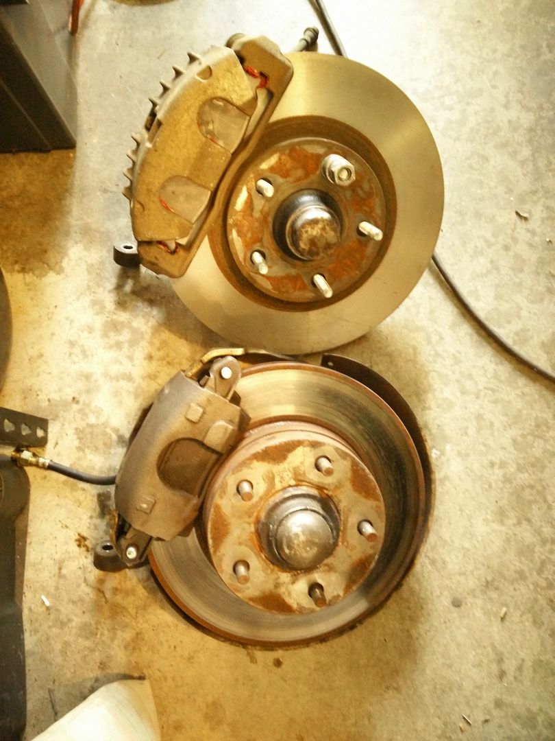

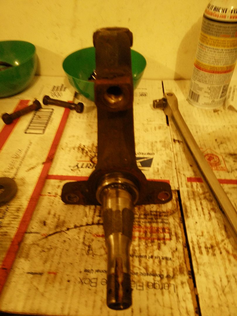

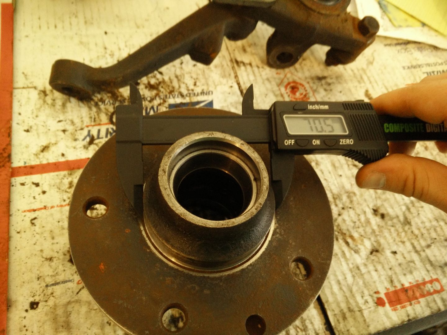

ok, so its not like i havent been working. i have been cleaning up around the house, the garage a lot, bought a truck and been getting that all daily status. plus im not sure if i have said this but i have gotten the garage enough to where i want it that i actually pulled the Nova inside to her spot. so she is all comfy.  :-*
anyway. the 2month brake swap...

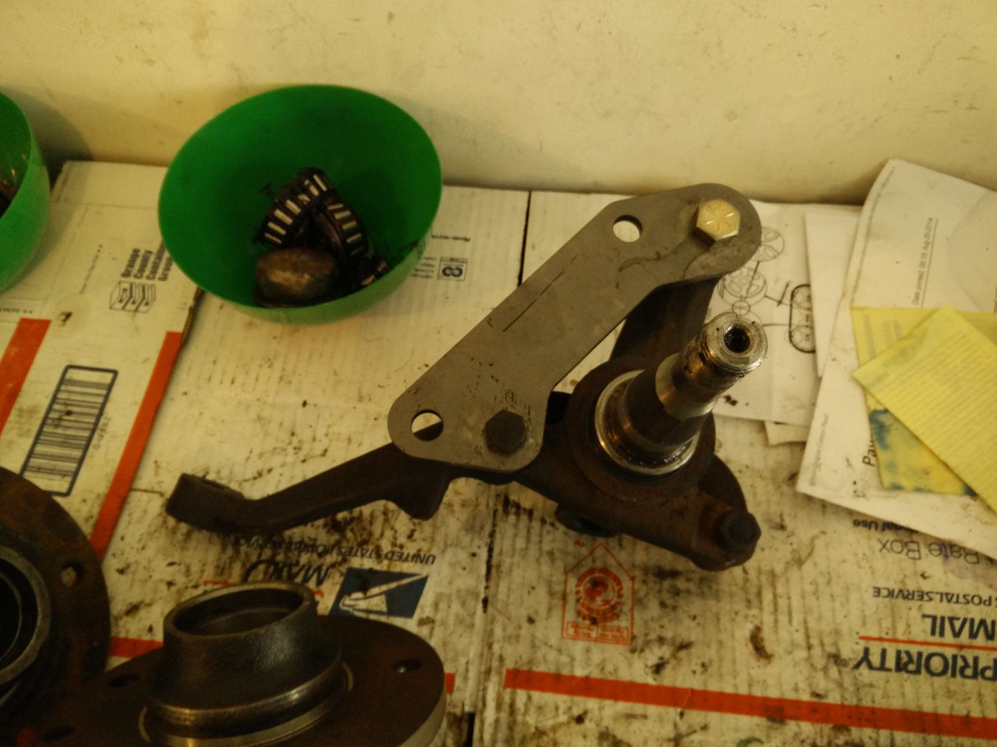

bare drum brake spindle. i got the whole drum brake setup off CL for 40bucks. good thing too, buddy said he was interested in the 10.5" setup. so ill have 2 complete brake setups when done.
turned down DRUM brake hubs. not exacting measurements. but you get the idea. machinist friend did these for me. he did note that the GM casting/machining wasnt very precise lol. so he trued it up off the bearing, or whatever.... so this was homie hookup favor later/FREE
brackets off ebay if i remember right. listed for a Camaro/Chevelle of course. all the same. the hubs are all the same too.... like $75?
Hawk HPS pads of course. think these where $82

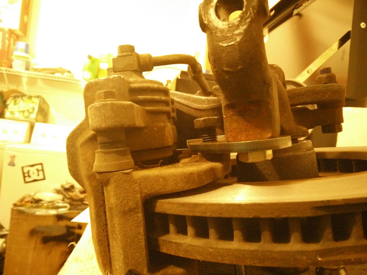

some test fitting
OEM junkyard Camaro bolts FAIL... then Ace bolts FAIL... then i got some new Ace baller allen head bolts that worked MINT...then i didnt take a pic  ::)  $15 with washers
proof of work taking place
the old school brakes are 2lbs HEAVIER than the new 12" dual pistons!!!
didnt bother to take a look at this pic before hand, so hopefully you can see that the 98+ Camaro brake hoses are different than the whatever the fuck was on my car.
note they are also shorter.

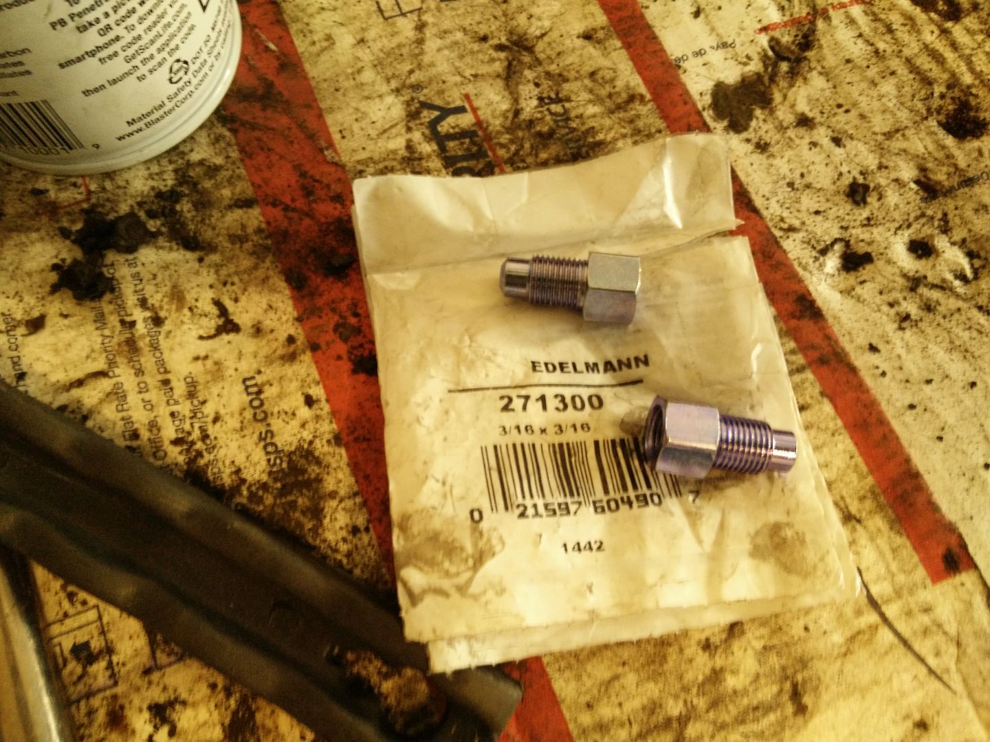

the internet told me to buy these. so im telling to buy these... i did look, and they are what i need. like $12 for the pair
thats about it for the pics, lots of doubles and shit i may have thought was important to show, but dont remember why i took them... so whatever.
