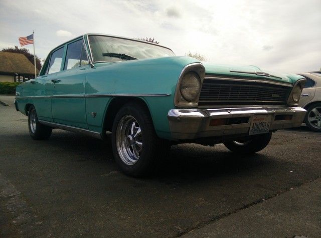

Author Topic: 1966 Chevy Nova mordor project... ***fresh 4.great.... dyno numbers/video***  (Read 458335 times)
BIG THANK YOU to AJ!... im now part of the NOVA crew :D
buddy i owe you a beer/lunch or something man. this guy has been harassing me sending links to LS engines and Nova's...
2 days ago i get this...
before he could even say TEXT HIM, i had already sent it lol.

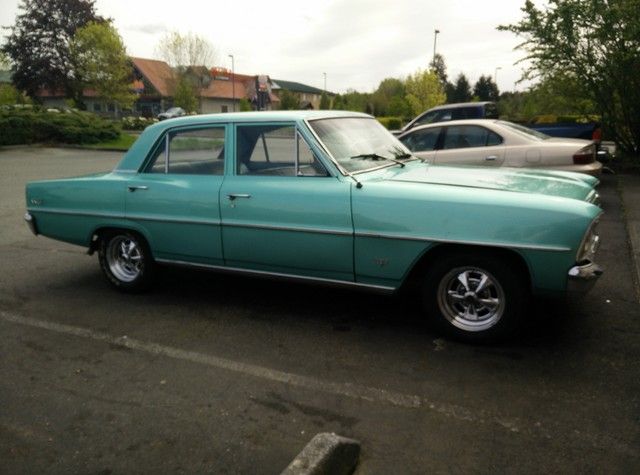

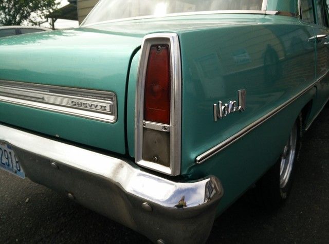

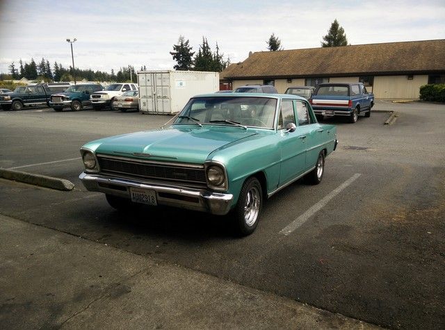

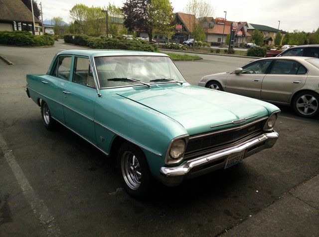

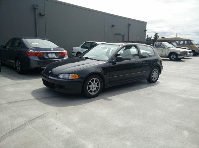

says trades. bad thing for a seller on CL. cuz you get all kinds of stupid ass offers... today was no different. i offered up the Civic. as luck would have it the owner was a kid. in school, shit job, had a car but would get rides from friends cuz he couldnt pay for gas let alone resto.... no im not making this up, perfect match.
yes i traded a 1992 Civic CX for a 1966 Chevy Nova  :Jew: :Jew: :Jew:
Civic:

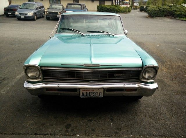

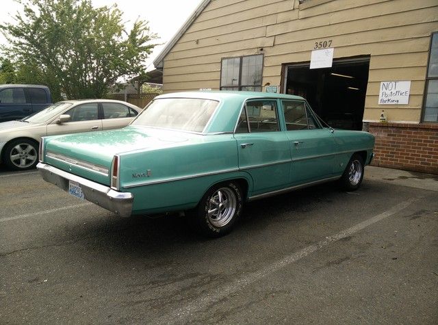

Nova:
little intro walk around video:
My 1966 Chevy Nova
VIN decode:
1966 Chevrolet Nova/ChevyII 400 4dr Sedan V8  (283 has been swapped to a 350 from 72 Chevy truck it looks like, TXC engine code)
produced: 4th week May in Norwood, OH
exterior: KK- Artesian Turquoise
interior: 779 Med. Turquoise Rosemere Cloth Med. Turquoise Imitation Leather
only accessory was a tinted windshield

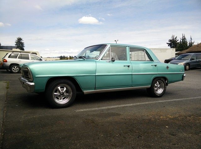

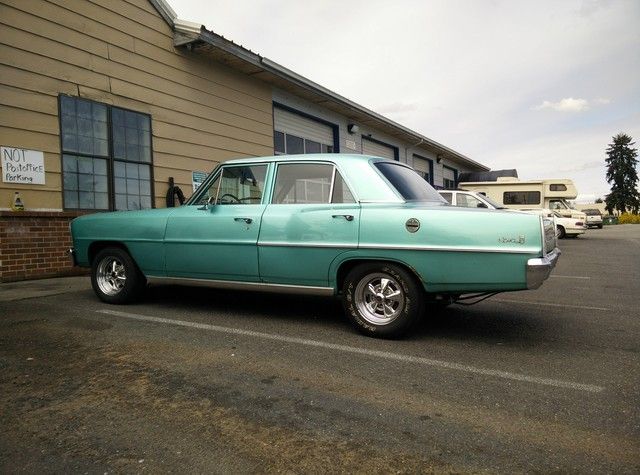

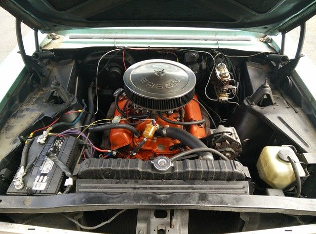

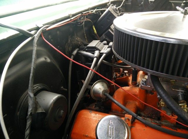

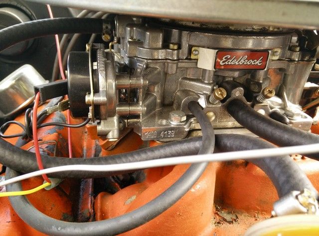

took a shitton of pics... looks like some came out dark... ehh...
Nova porn... :noel:
found an HEI distributor back there.

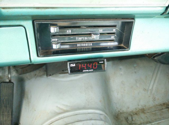

put the PLX in.
Edelbrock 1406 is tuned pretty nice. 13.5-14.7 idle depending on how she feels. and like solid 14.5 freeway. only did a couple quick pulls, afrs bounced around some but seemed like 11.7. might need some WOT tuning lol.
 :Jew:

Looks real solid. Now it's time to check the timing curve to make it really come alive.

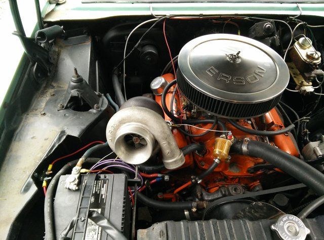

1) Move battery to trunk
2) Place $650 S475 where battery was
3) Profit

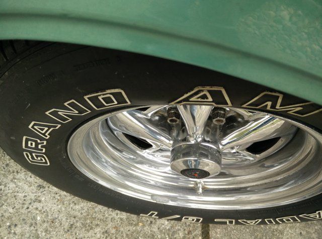

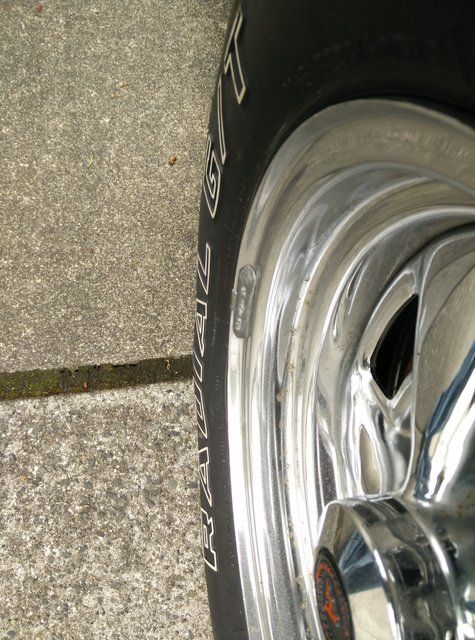

looks like a bulge on the A...
and this one by the driveway seam.
think that's my vibe/bounce? that safe? seems this is odd tire size.
these wheels worth much? fronts littlerly have brand new tires. I might just buy new wheels. like 16" Corvette Rallye's

see i have been having a problem finding tires. seems to be only 1 that exists in this size, or close. for 14" wheels... but i need to be looking for 15" rallys or buy some new custom 16" rallys.

Fuck rally wheels, this isn't 1970!
It should have generic 5x4.75" (120.7mm), so almost any Caramo/Vette rim will fit. Go back on CL and hunt down a set of 16's or 17's, they actually look good on those old cars. They also make the car handle WAY better since you don't have 10" of sidewall to fold over.
Re: BIG THANK YOU to AJ!... im now part of the NOVA crew :D
« Reply #25 on: May 01, 2015, 09:47:10 AM »
got anything more specific? i go cross eyed afyer 10mins on CL anymore. i dont want anything flashy, i like a modest look to the car.
