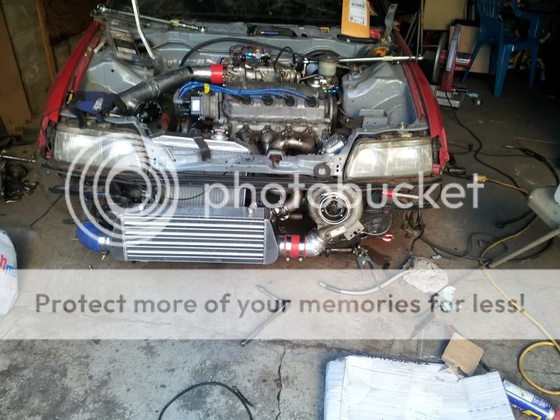

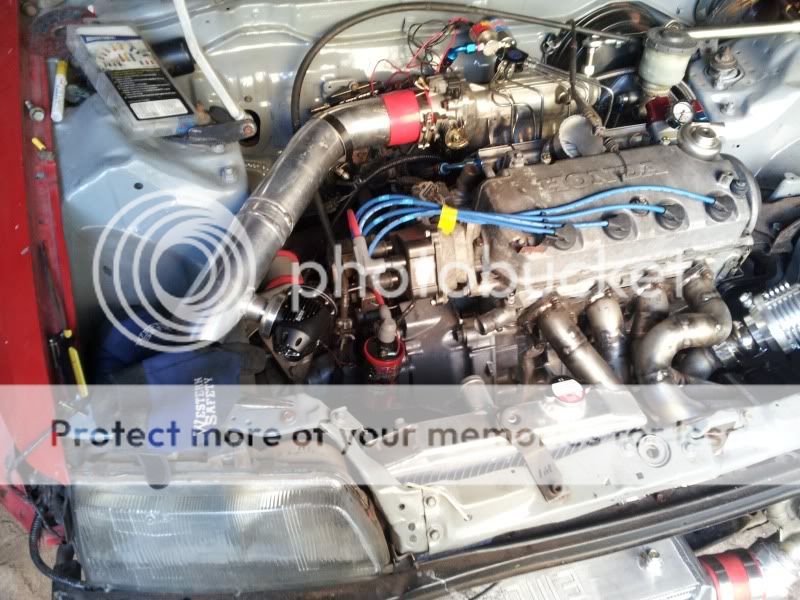

« Reply #181 on: June 15, 2012, 11:30:48 AM »

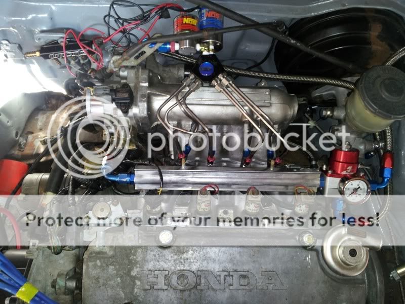

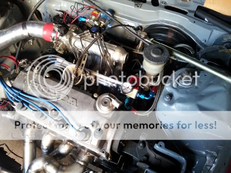

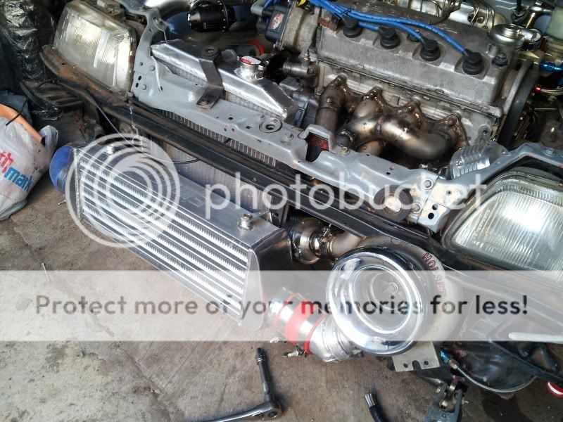

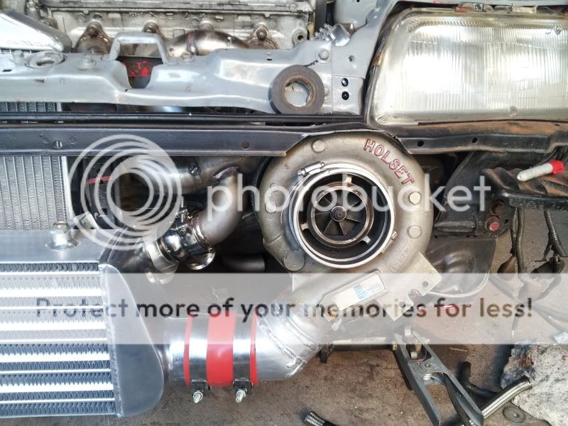

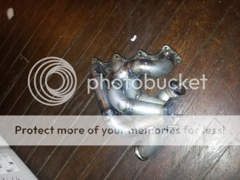

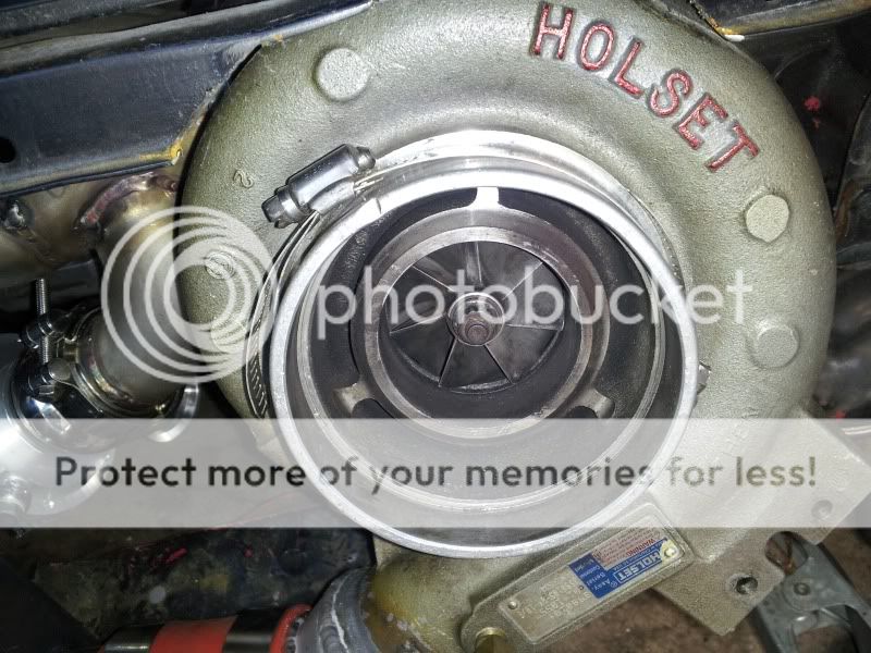

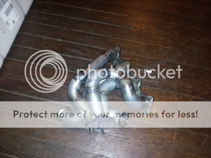

Oh yea work getting done!

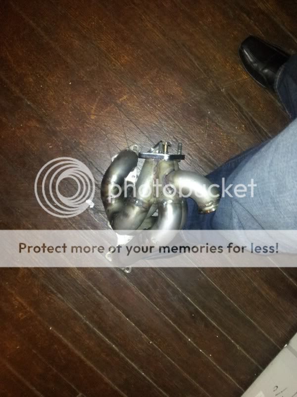

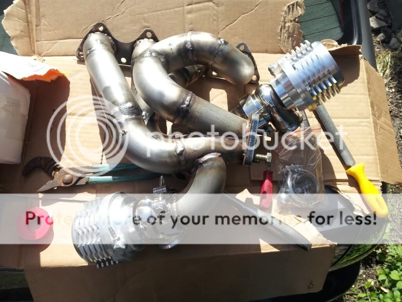

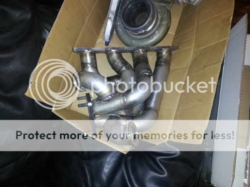

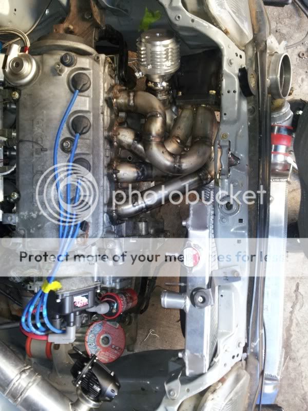

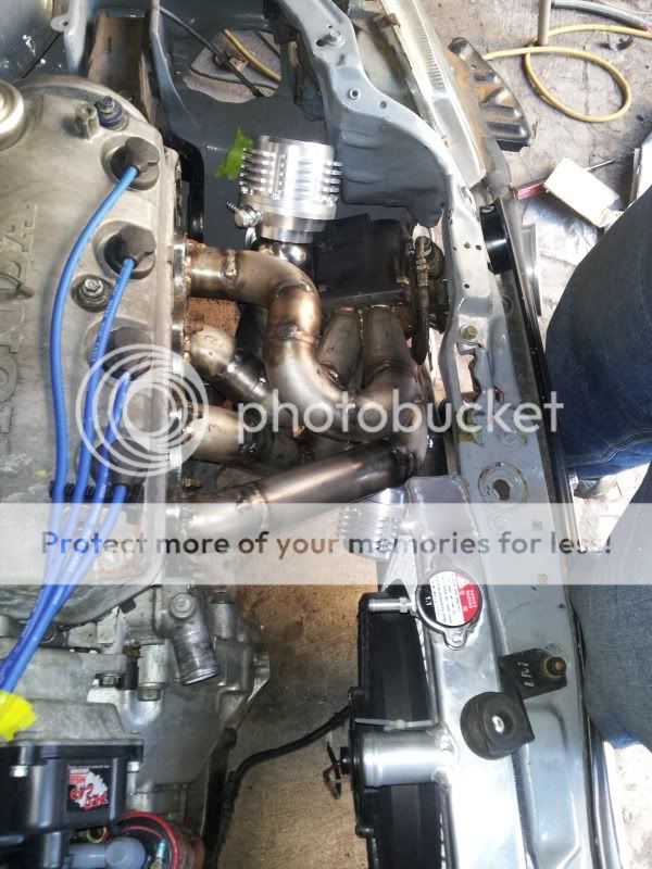

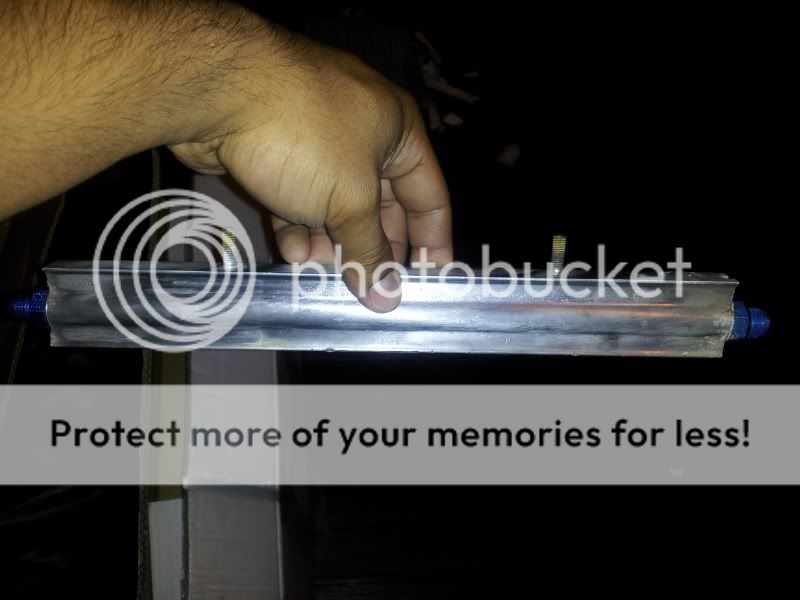

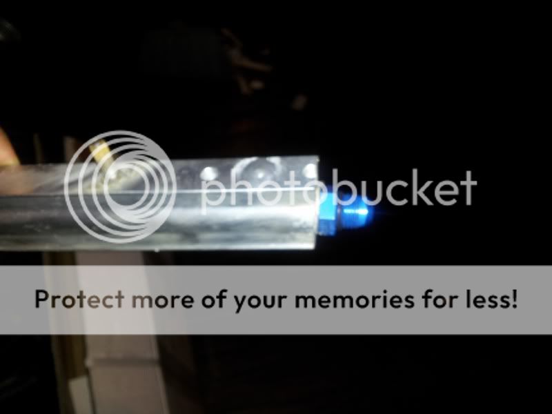

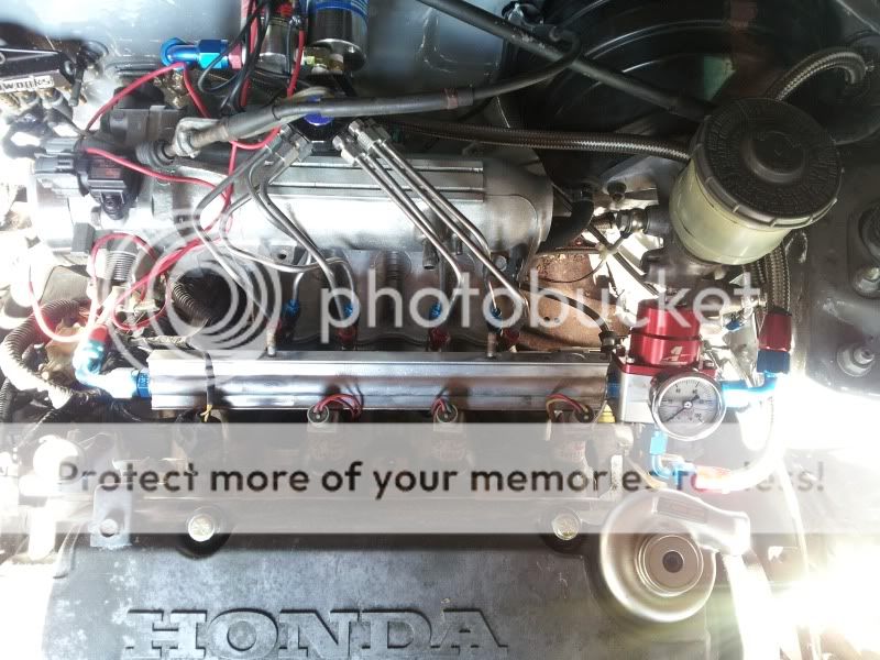

Friend was able to weld up the maifold almost almost night including some other misc parts.

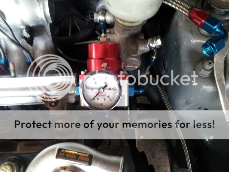

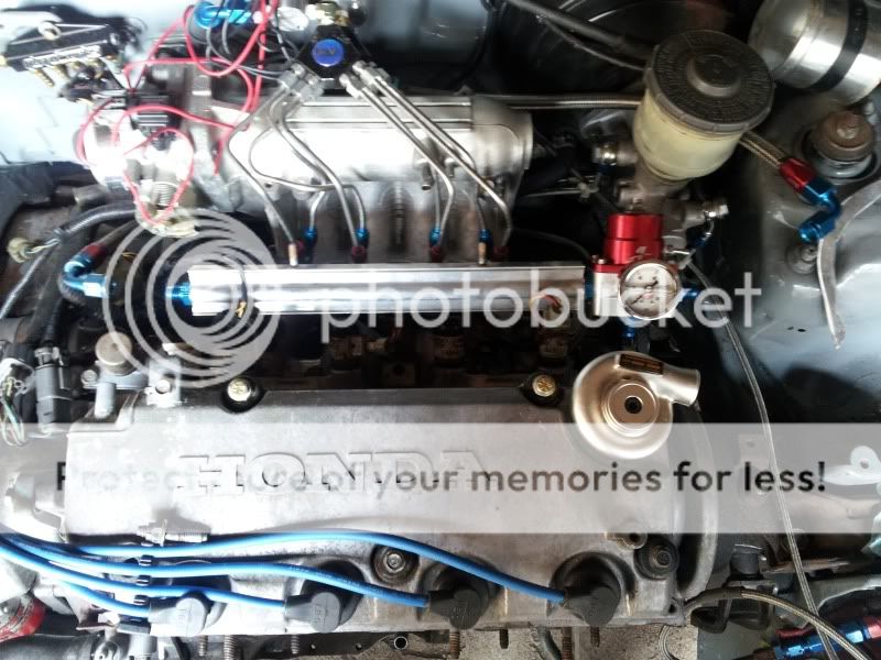

Stock fuel rail converted to -6 in and out also weld the stock fpr whole shut.

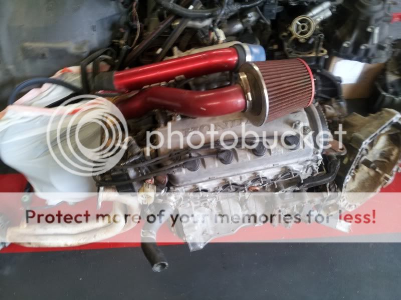

Housing Moded to fit setup
More fuel rail action.
Almost there!

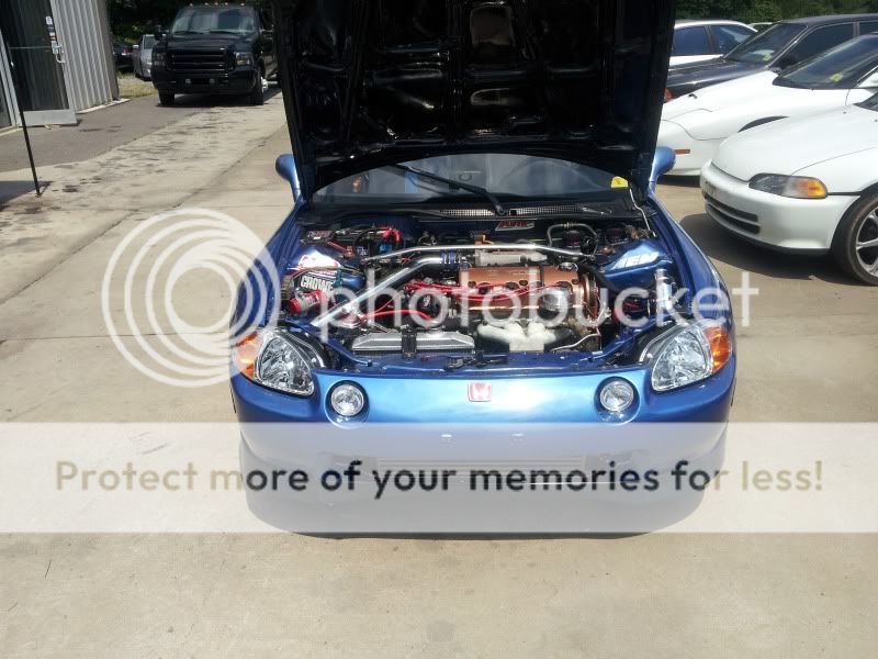

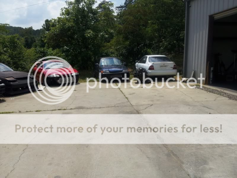

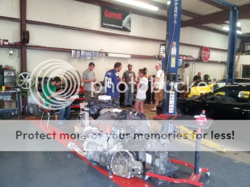

Well it was a long weekend. Big thanks to everyone that help! Well onto the pic's.
Some where in Va, being out of NJ this was strange to me.
Crx hanging on back there entering NC
NC looks so good!
Some goat action
Some random cars
Some drinks
RIBS!!!!!!!
Baller girl!

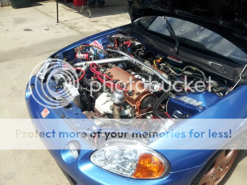

Pinks crx!
More cars

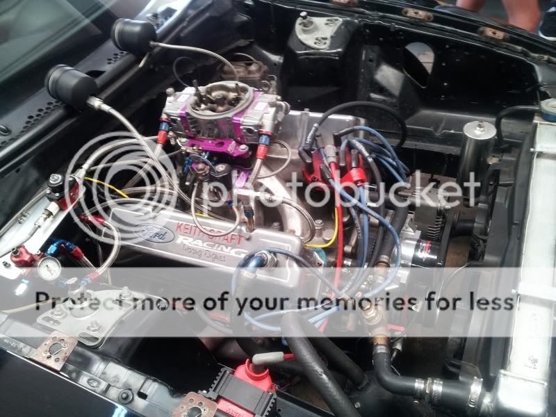

JD sohc type R motor
Simply badass!
Thats it for now!

« Reply #197 on: June 28, 2012, 07:42:36 PM »
Shit pop out so I used a few hose clamps lol

So did you just use the stock feed as the return?
Re: Project Phoenix update 5/15/2012
« Reply #199 on: July 03, 2012, 09:03:30 AM »
Part of the stock feed is still used as the feed.

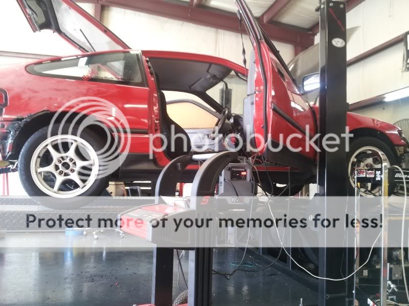

holy shit.. what did you use for tuning?
« Reply #201 on: July 05, 2012, 11:14:19 AM »
Ectune, but it was acting up. It did not want to spray the 120shot!

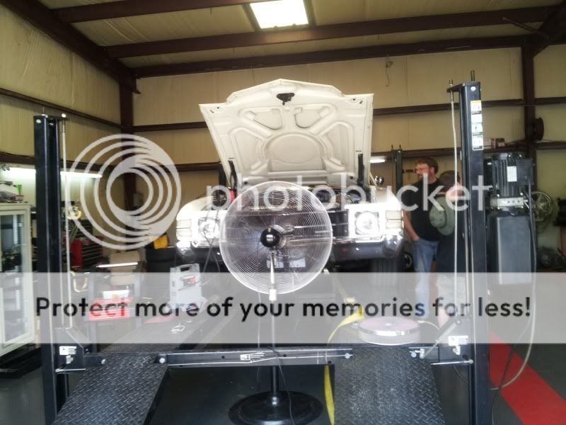

Its been a while, figure I would updates this.
Well after some time JD sent me the graph, I was going to post the correct dyno grapgh that showed the 500hp, but what's the fun in that.
I need to post up last years dyno graph, nothing changed but the car and the turbo manifold.
Edit: last years
Last year
This year
Last but not least full_tilt from DSO did a nice over lay that shows the difference.

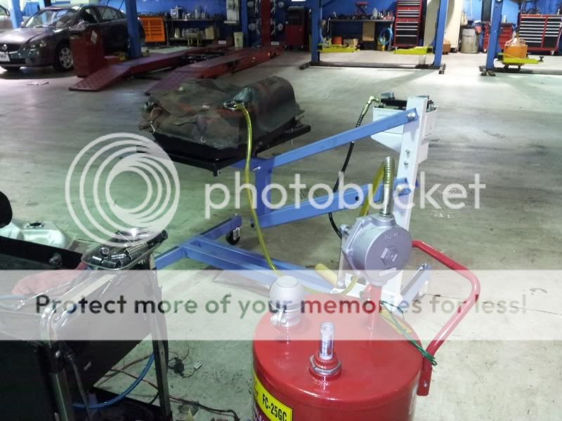

Well time to update!

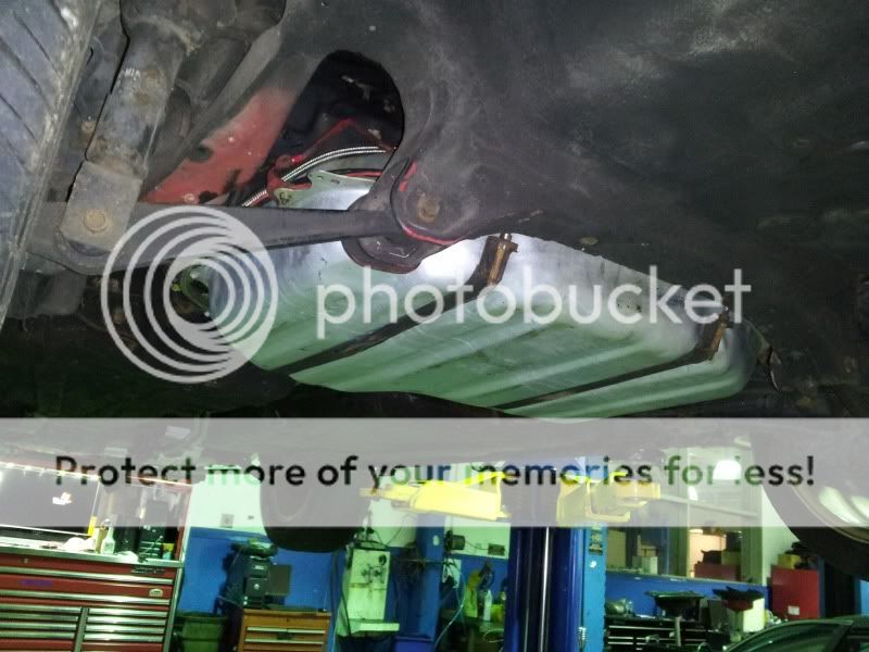

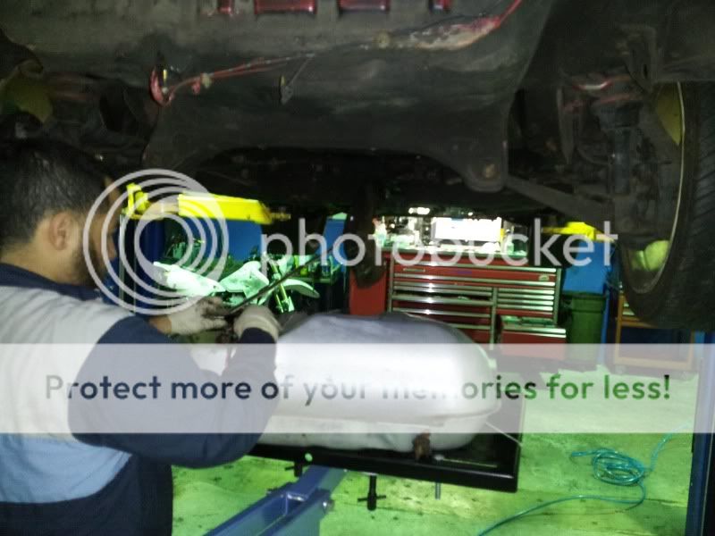

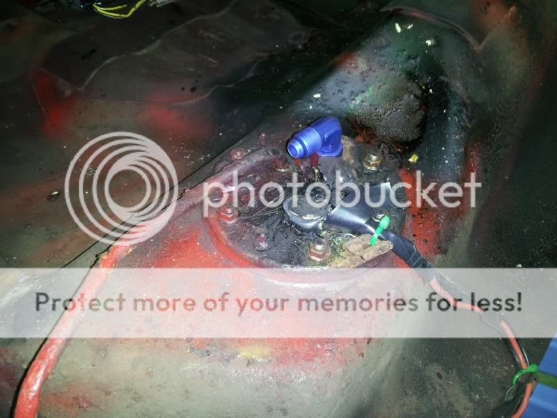

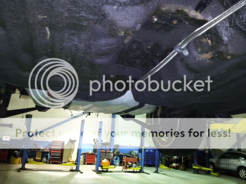

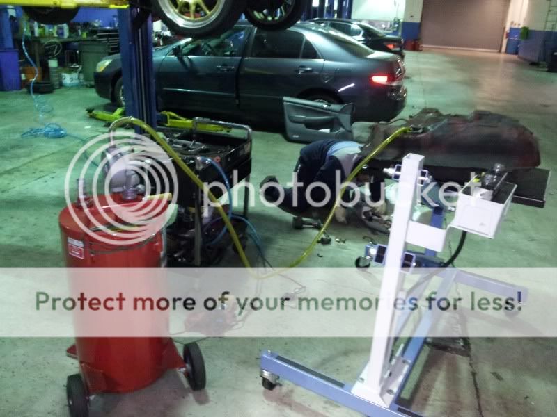

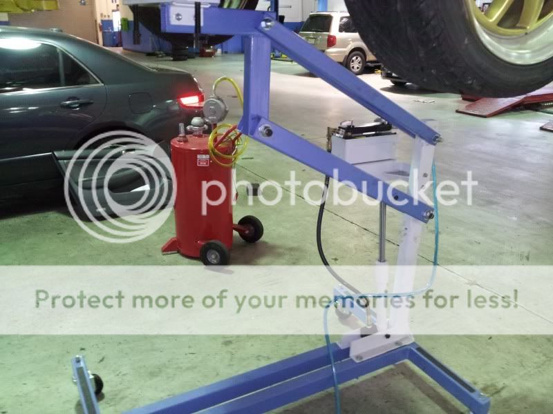

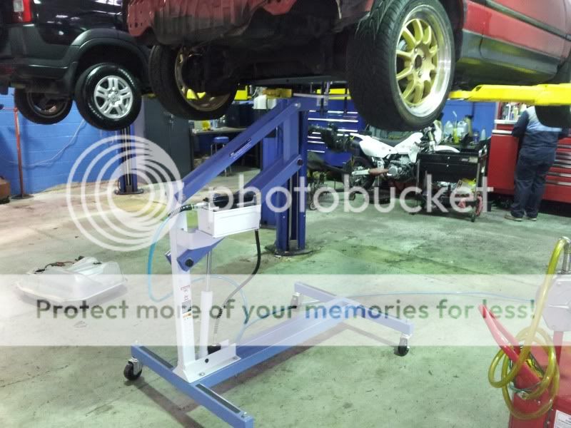

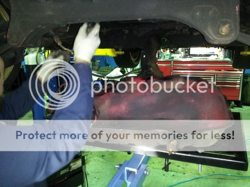

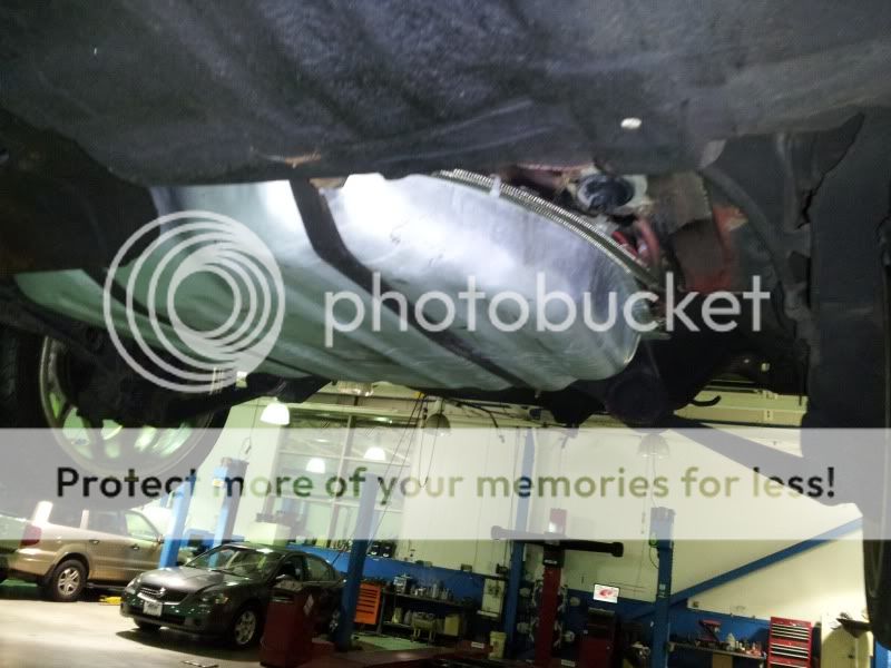

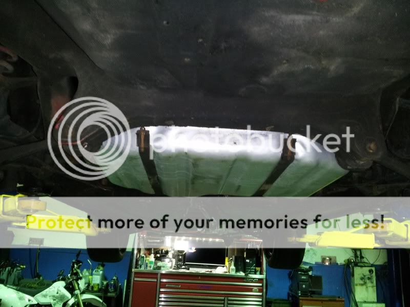

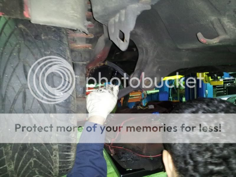

One thing that was clear to me back in June when I was on the dyno was I had to replace the gas tank as it was leaking from one corner. I really didnt want to drop the tank again on my back. A close friend of mine told me to being it down to where he work, HONDA! Need less to say I couldnt pass up on the offer.

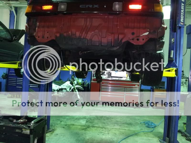

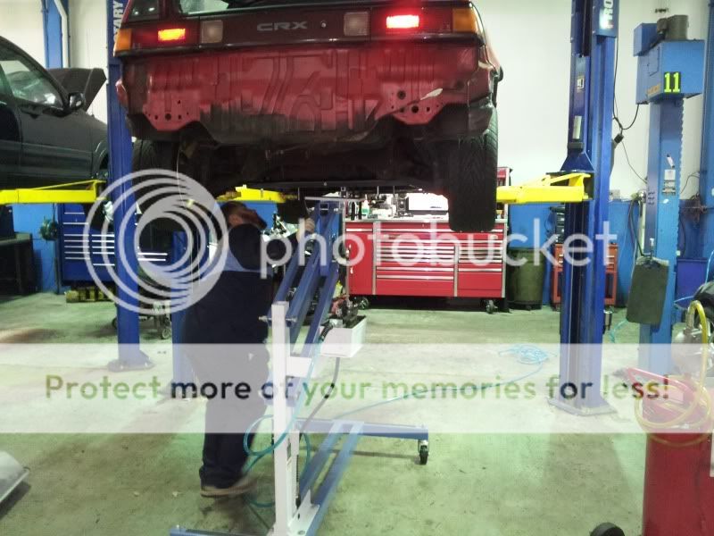

You got lo love having all the right tools to do this! Power lift for picking things up and dropping them off.
The man at work making it look easy!
I swear I closed my eyes for a sec and it was already out!
This tool was just badass! 1200lb max lift!

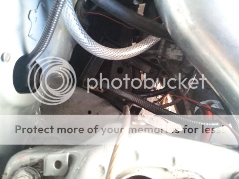

A closer look at the top fitting.

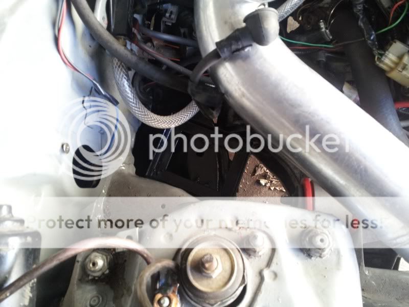

Rewire is clearly visible in this pic.
Another badass tool. Hand crank pump just for gas/e85!
Draining about 6gal or sweet e85

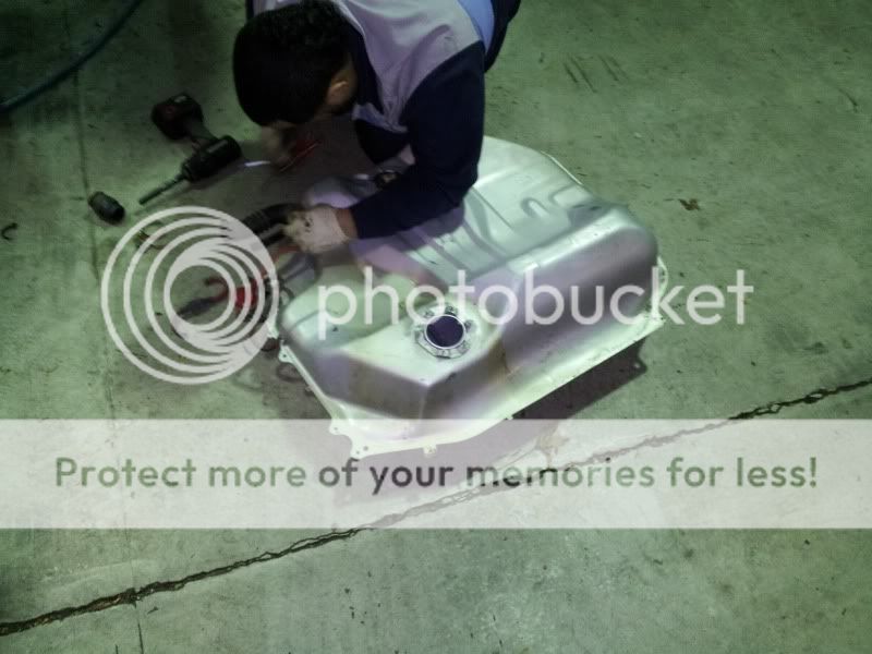

The man hard at work prepping the new tank.
Going it.
A closer look at the -6 line
Big thanks to my close friend for the help!
Hoping to make it to one of the last events of the year on the 11th, have some work ahead of me!

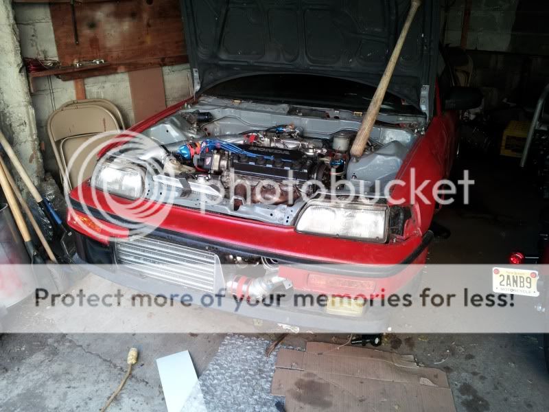

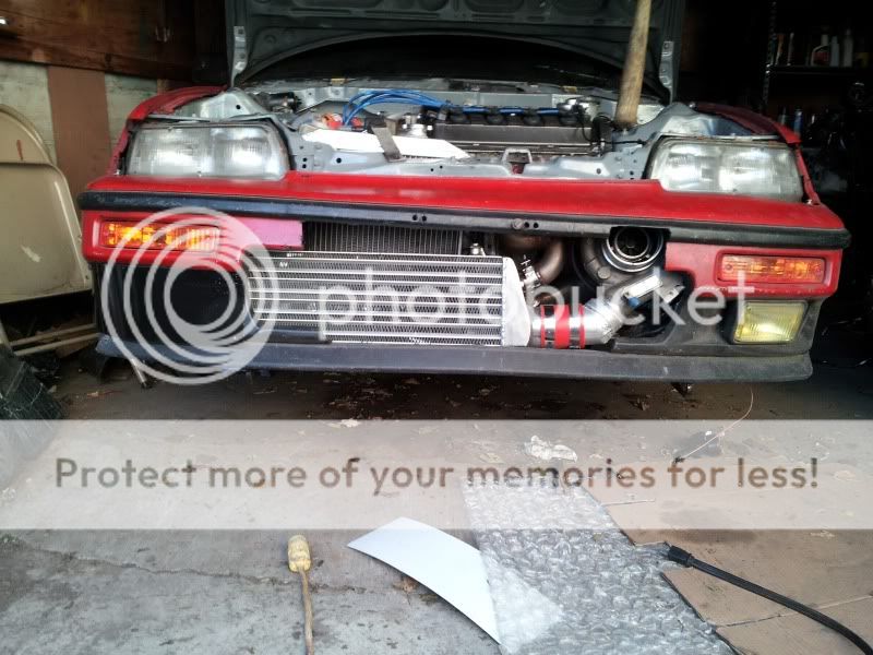

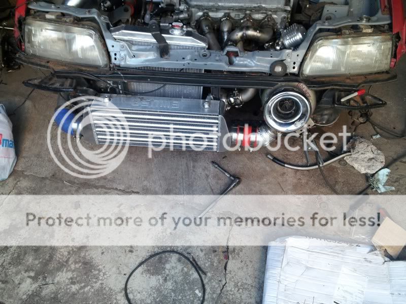

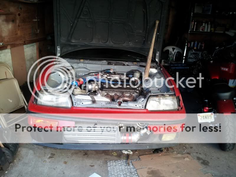

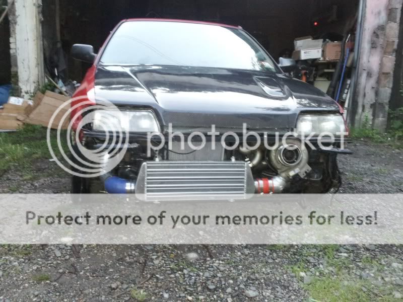

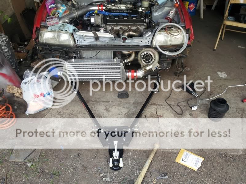

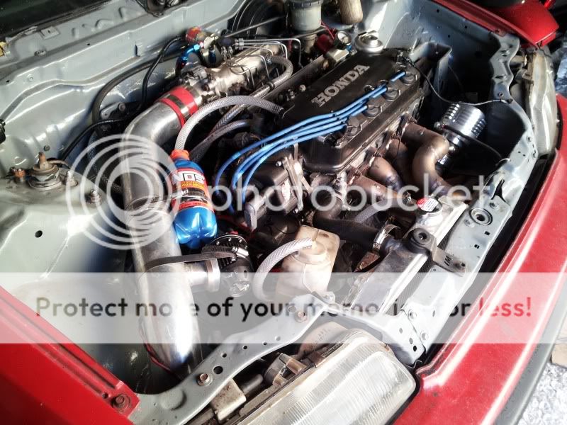

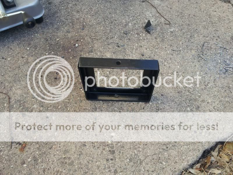

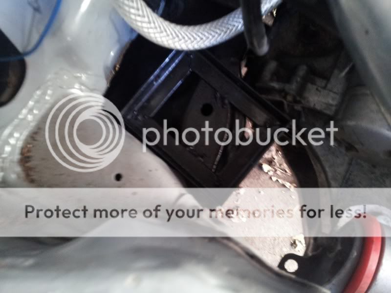

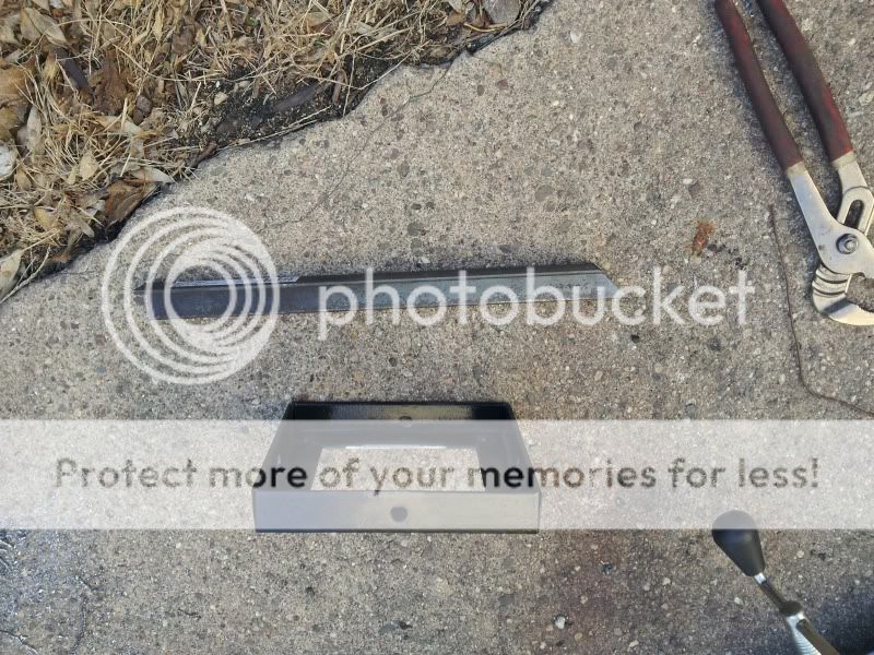

So since the last update the crx still needed a few small things and a new battery tray. Friday and some of sat working to get ready, I spent some time going over everything and making a new battery tray out of some angle iron I found laying around.
I really wanted to keep the battery in the engine bay but due to space the only place was on the back cross member.
Once that was out of the way It was time to fit the bumper, I ended cutting up the bumper a lot to get it to fit right.
Next up was a catch can, since I was all out of supply I resorted to a nos bottle I had laying around.

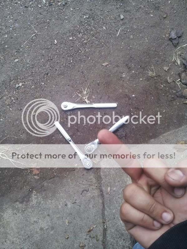

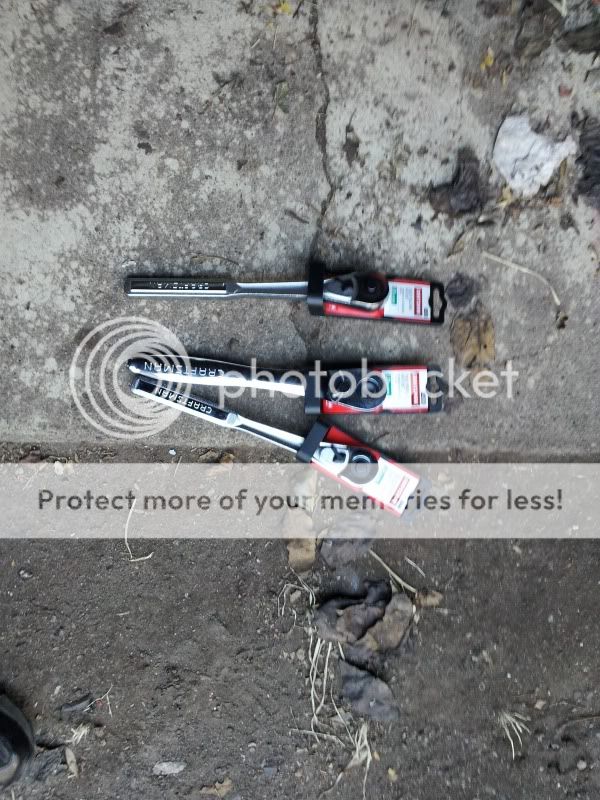

 At this point I had reserved a trailer to tow the crx down since I didnt feel like using the tow bar witch ment I could install the axles and get ready. Driver side was in under 10min, the passenger side took almost 5 hours.....
I broke 5 craftsman 1/2 ratchets, 1 1/2 snap-on breaker bar; lots of heat and a baller snap-on gun was what ended up getting the damn axle nut off....

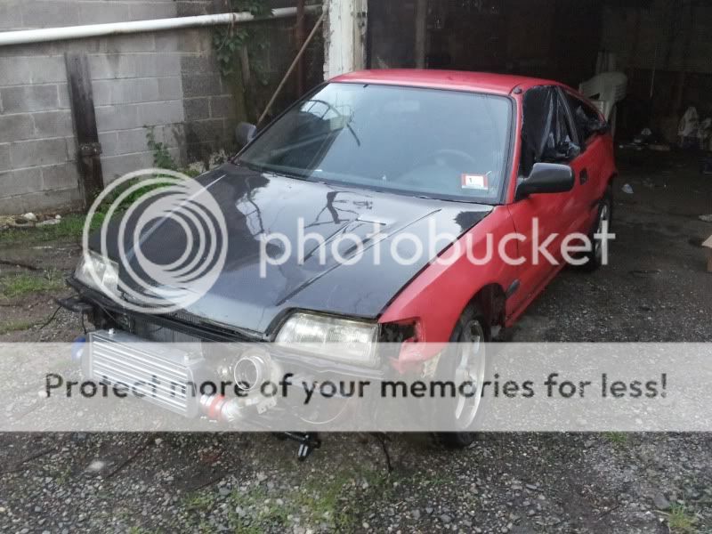

Sunday, fresh off the trailer and ready to go.

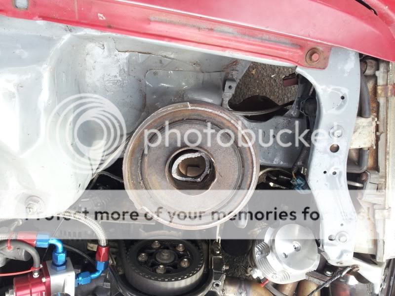

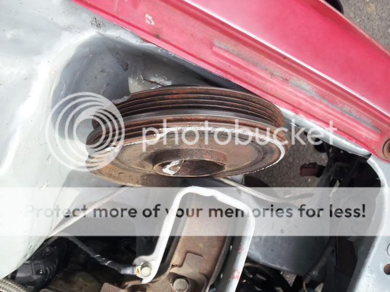

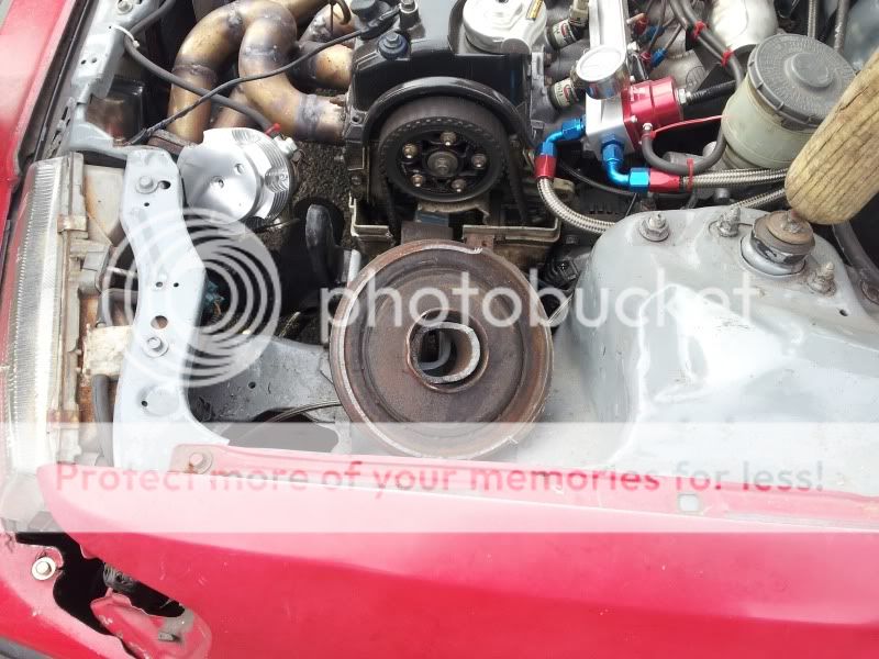

At this point I was pump, car sounded GREAT! I was letting the car warm up witch took forever to even start due to some e85 blues (super cold weather). Car warmed up, fan kick on, rev'ed it a bit, then.............. R.....I....P..... crank pulley.......................
Track day was over, I couldnt get a pulley in time to make a pass. I also got hit by some of the broken bits. Lucky no one got hurt and I believe the motor is still good.
I dont understand why it blew apart as this motor has been together for over 30,000 miles...
