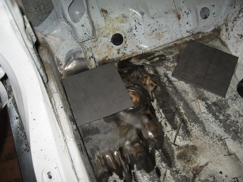

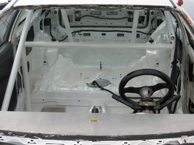

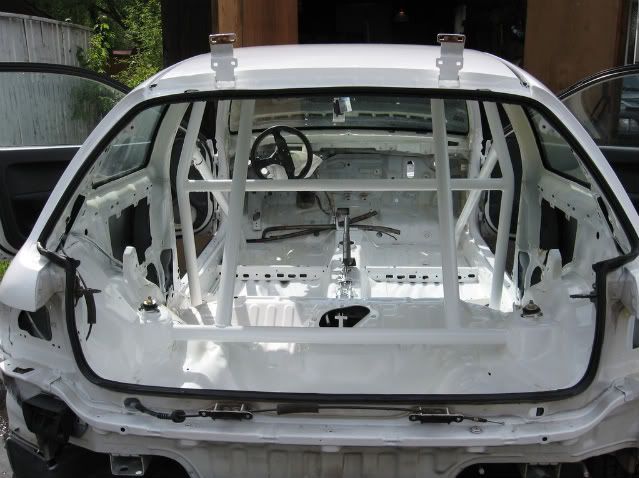

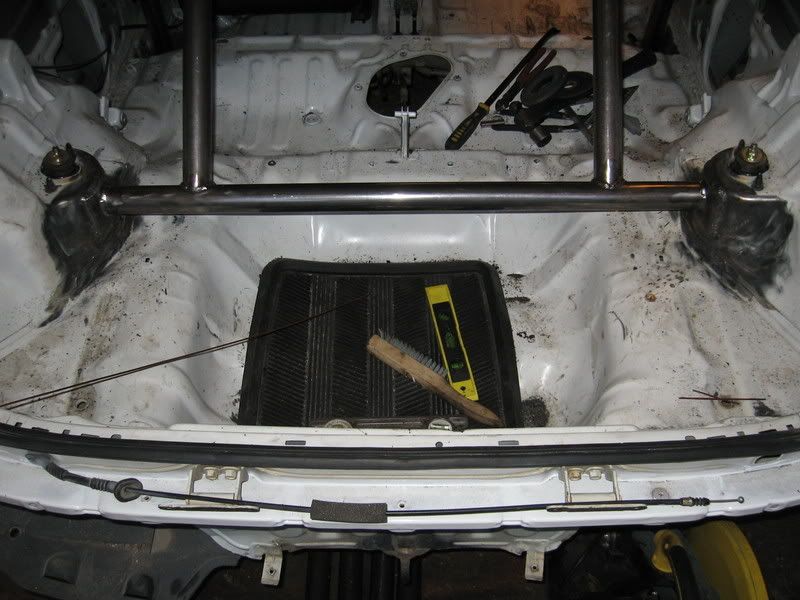

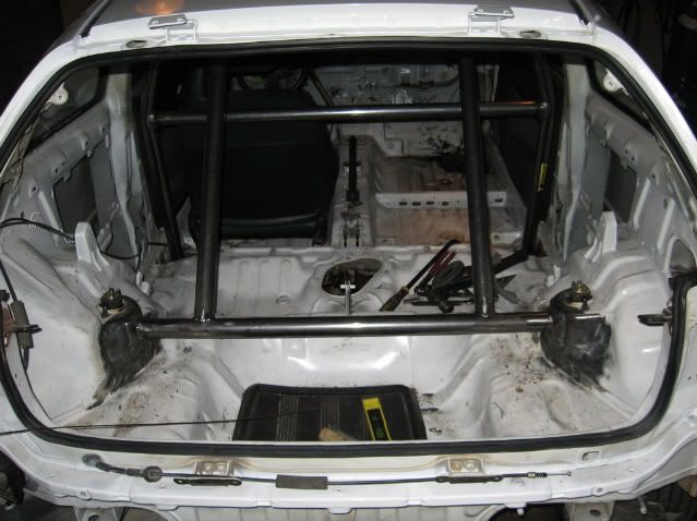

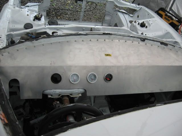

92 Civic VX Comp Eng roll bar kit me and Brett [dvst8r] welded in,painted by a old drunk guy in his barn/garage thing :D its stripped inside with a alum dash that cost $60 O0

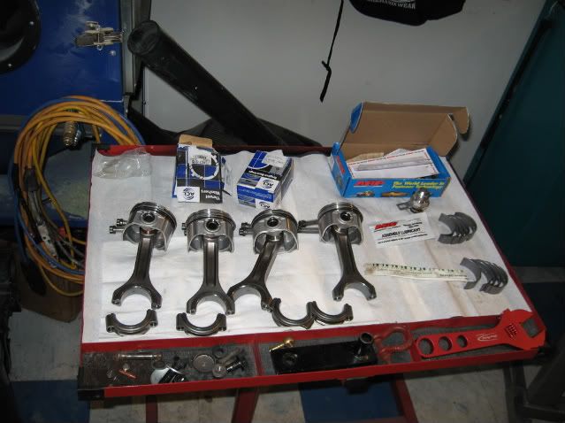

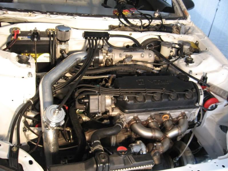

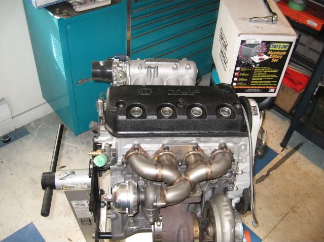

Motor- D15B vtec 75mm Vitara pistons,FJT rods,Crespo springs and retainers :l, Colt cams regrind,Skank int mani,edelbrock TB
Tranny- stock SI/EX tranny replaced a couple seals and a bearing as well added a OBX diff and a LSD 6puck sprug disc heavy duty pressure plate and 12 lb steel flywheel.

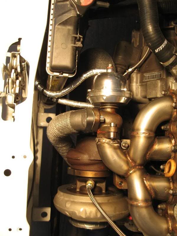

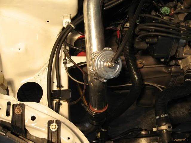

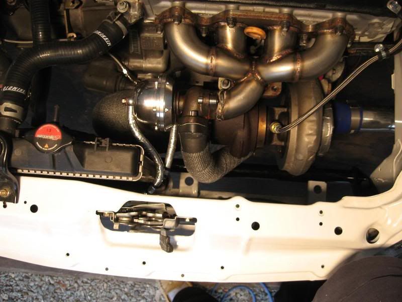

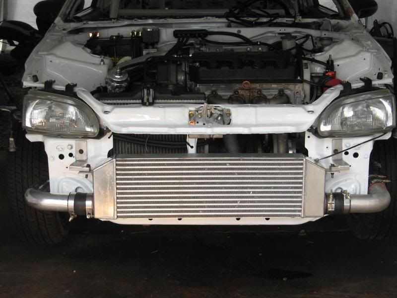

Turbo- Holset HE351CW,Eville140 manifold,CDM 38mm gate,CDM 50mm blow off valve,Peakboost front mount and charge pipes from Urban Indians kit and a white tent 4" mild steel downpipe to CDM SS 3" catback :P
Fuel/Management- ECtune,chipped P28,Hondata 4bar,Precsion 880's,Walbro 255,Aeromotive regulator,LC1 WB and fuel  lines half converted to -6

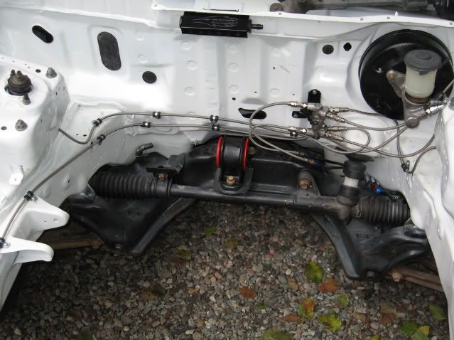

Pics so far.I cut most of the brake lines out when I stripped it down and was gonna do a tuck etc but then realized im way to lazy for all that bending so i bought a box of Russell Speedflex hose and made SSlines instead way easier way to make brake and clutch lines :6

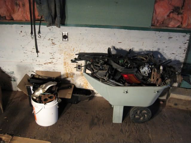

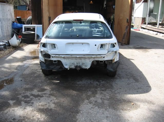

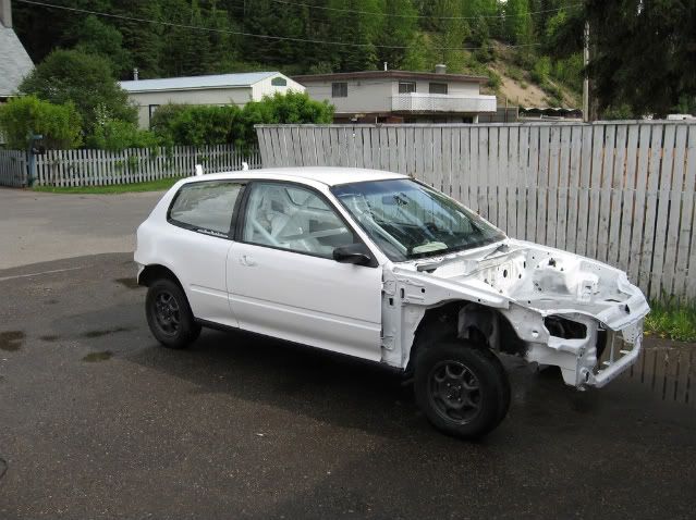

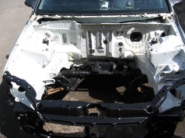

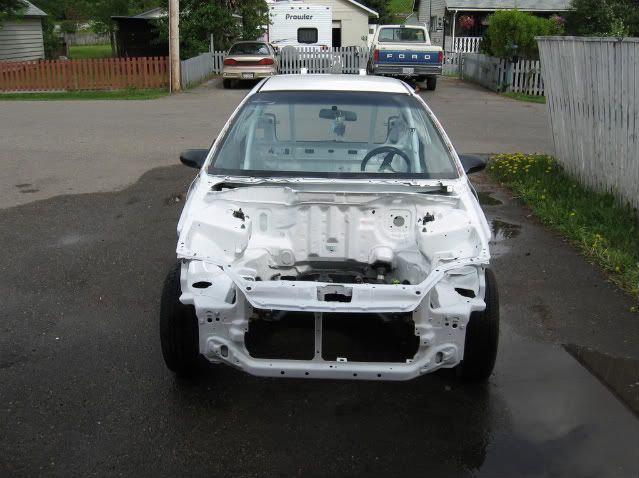

Strip down and new rad support

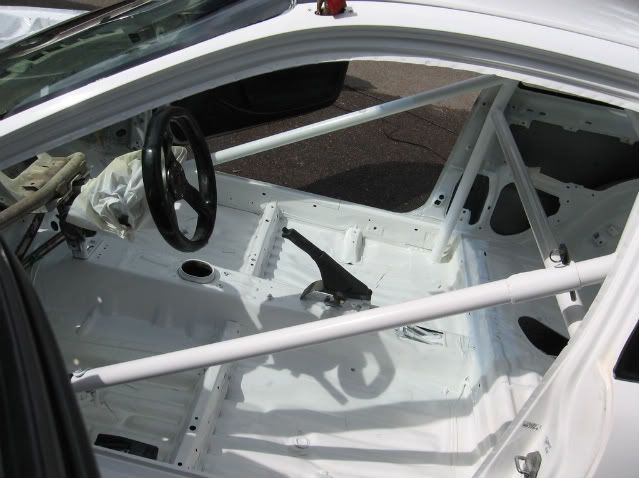

Roll bar install
Got the car back from the painter he did a great job for the price  he did the body work,painted the exterior,engine bay and the interior.Installed the alum dash need to cutout more holes for 2 1/16 gauges and cut it out for the SI cluster i got.

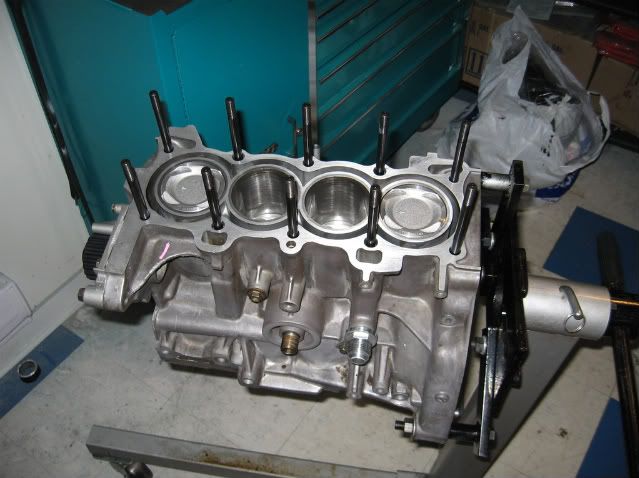

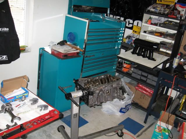

Assembled the motor and tranny the piston to wall clearance is .0fuckinghuge i can damm near drop a wrench through :-X

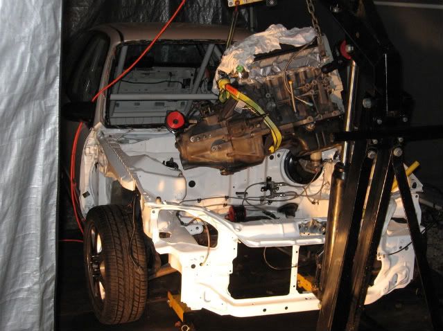

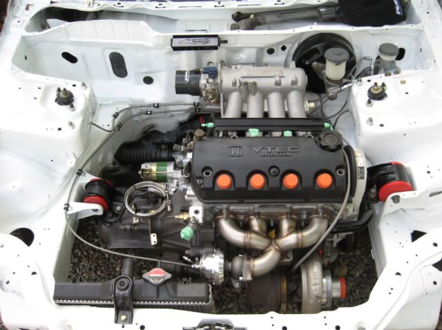

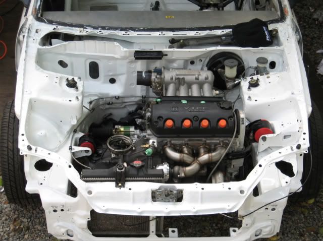

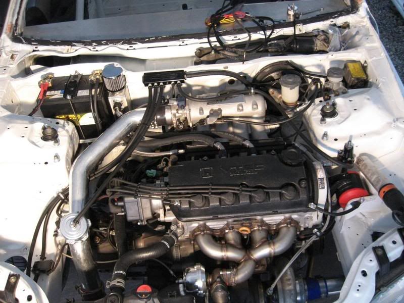

Got the engine bay ready with new brake lines and dropped the motor in

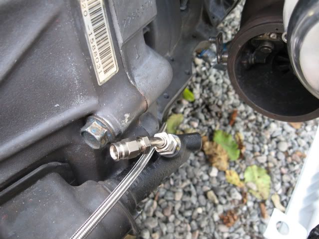

Downpipe is gonna be tight need to get creative to fit a 4" pipe between the clutch slave

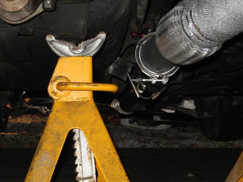

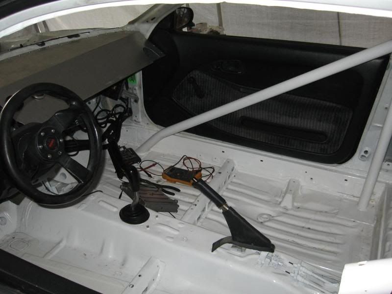

Okay some updates so the car is mechanically done just needs some finishing electrical inside the car i have a 3 3/8 " tach to go in beside the Tuner View as i prefer a standalone tach even though the Tuner View has one.As well i need to finish routing the interior harness make a mount for the ecu.Last the windshield needs to go in once i know all the gauges are working properly everything is routed cleanly etc. You cant take the dash out with the glass in :D
The downpipe is 4" adapter cut down then 3" looped around in a U coming back down under the pan then a flex into a vband.Its all flux core madness so i wrapped it after as its gonna cook the clutch slave its actually touching :?: The wastegate dump is 44mm stainless tube fluxcored to a 38mm mild steel flange :D Should fall off at some point but i will get some bends in to make a new pipe rerouted into the D.P later on.

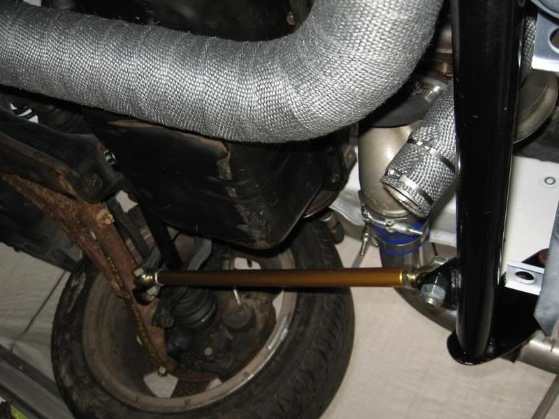

Got these traction bars from skinny boys fab shop via ebay they were $199 and really well made nice quality joints etc O0
The car is running a CDM $149 3" stainless catback the fitment is good but the muffler is brutal fart cannon :-X This will be changed out for a Vibrant flat black at a later date when i have some money.
