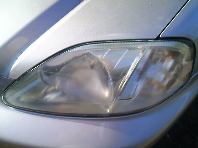

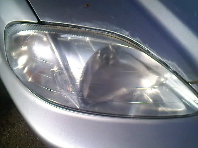

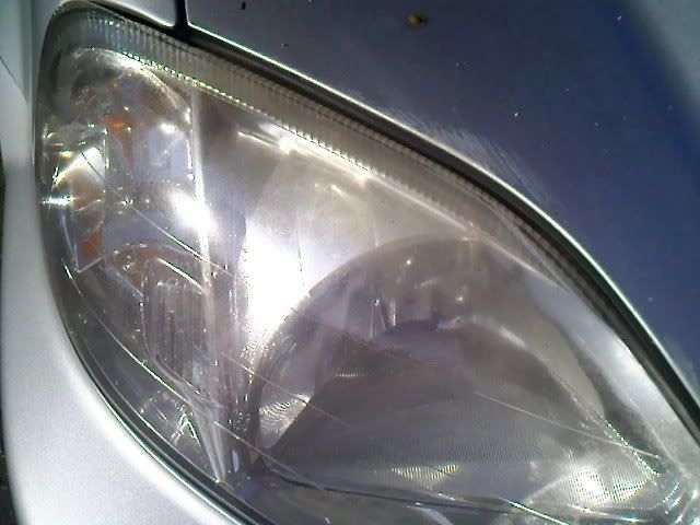

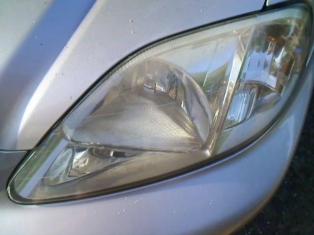

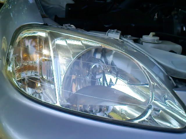

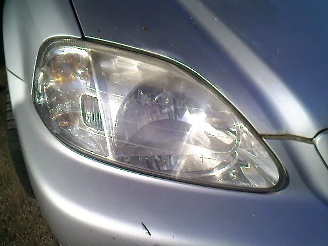

Ok so my headlights looked like this:

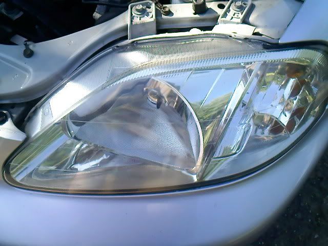

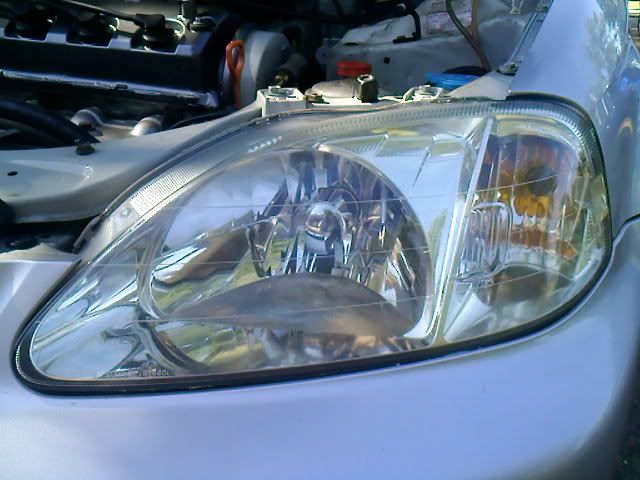

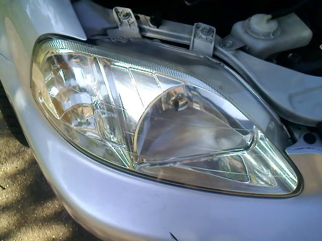

So first off wash your headlights off. A little Windex gets the job done. Then take your toothpaste and spread a nice bit out on your cloth. Begin massaging it into the headlight with a bit of pressure. Let it sit until dry.
Wipe off with a clean cloth. And walla, your done. I plan on adding a little wax later to polish them up better, but still happy with results.
