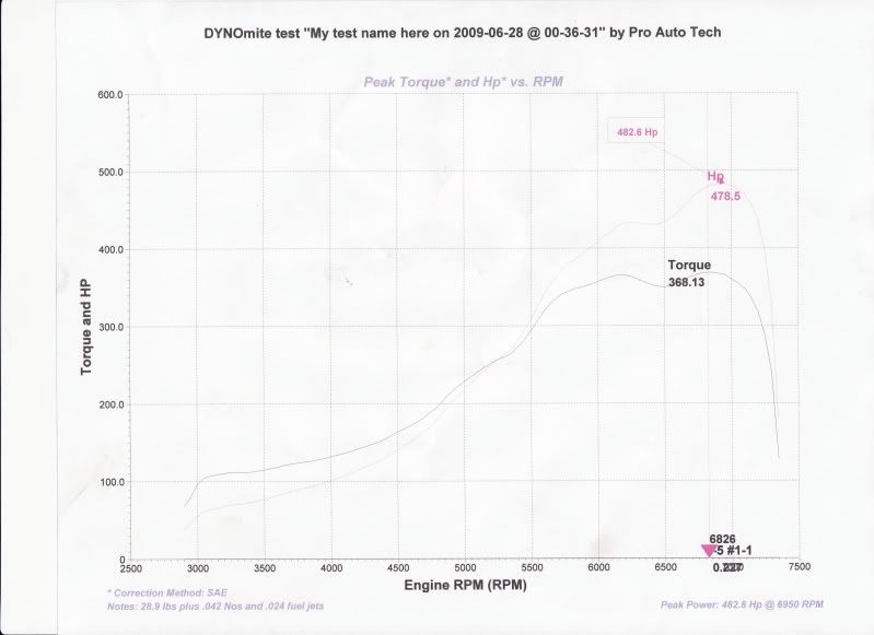

We were playing with Phil Stubs(Scott@Evans Performance from hmt) car today. Its a Vitara piston, TT rod, Evans Performance turbo kit, 65lb injectors, stock sleeves, stock intake, stock cam, tuned by me on eCtune, It made 310 on 15lbs on pump.  We decided to see how much we could make out of his ghetto cdm madness mobile.
       So we threw some 116 in it, and threw a kit on it, We took boost as high as 31lbs and even tried a nos jet as big as .062 trying to break 500hp but it just wasn't happening today :( We made 40 some pulls trying to do it, prolly a combination of a stock intake, stock cam, stock ign car with some clutch/tire slipage. The final plug gap ended up being at .012.
      We did break the current vitara record though :) We had a bunch of pulls in this range, but a best of 482.6hp 386Tq, that was at 28.9lbs of boost with a .042 nitrous jet and .024 fuel jet.  My dyno reads low compared to a Dynojet, 14% lower to be exact. For example a 91 crx si with interior with 238hp went 12.4 @114 on DR's.
   Gotta love a dirt cheap rhmt style build making power by just throwing some boost and chemicals w/o having all of the high dollar bling bling parts,(sorry for bad scan, i'm dyno printers low on ink, haha)

Damn nice numbers.  What head and turbo?
Re: 482.6hp 386Tq of Vitara D series goodness
« Reply #11 on: June 28, 2009, 11:06:17 AM »
Scott's manifold and turbo bolts were loose at the end of the tune.  Sewell's estimation was it needed cam, ignition and maybe more port work to go further.  I think he just needs to take a chisel to the exhaust ports and triple his jet size.  :P

How much of that horse was caused by the shot.....
     Scott realized it was loose when we were unstrapping the car, he goes look at this, and he wiggled the downpipe about 3 inches and i seen the turbo shimmy back and forth.   I'm not sure that it would have mattered, the thing was just choked up, I did some bowl work and a gasket match on the head, it was fowing real nice at lower boost levels(15LBS), but the power per lbs of boost really started to drop from there.     We did up the jet size, we threw a .062(roughly 150 shot) in there, you can only put so much shit in an overflowing toilet.
  I don't remember the exact numbers but it was maxed out on boost in the 375 range,
Oh and Im not taking anything away from you guys great#'s and glad to see people throwing the bottle on those Pistons.
       These damn things are tough as hell, It amazed me,  My machinest buddy that was hanging out about shits his pants when i told him they were a cast piston with all of that boost and spray.  Running 2 power adders with a polluted combustion camber is just asking for trouble, but they took it like a champ.

    I'm not to worried about the record, i really don't expect it to last long, I have another customer that i'm finishing his build that will probably break it in the next week or so,.    The fact that we did it with a basic build is really amazing, i'm guessing this is also the highest for a stock sohc vtec cam,  i think that it if it is, it will stand for awhile. Using the stock cam for this kinda power is stupid, and very counterproductive.
    Scotts got a ton of vids, when the button gets hit the run is basically over, hitting the kit at 5k, reving to 7200. I doubt they'll be very exciting.  I'm just glad to see the car made the 3hr drive home after it was all said and done.
