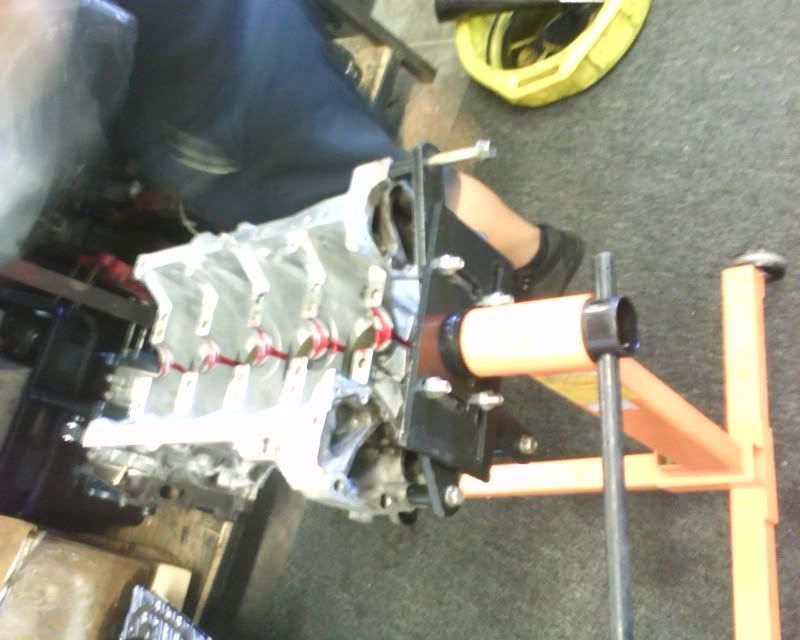

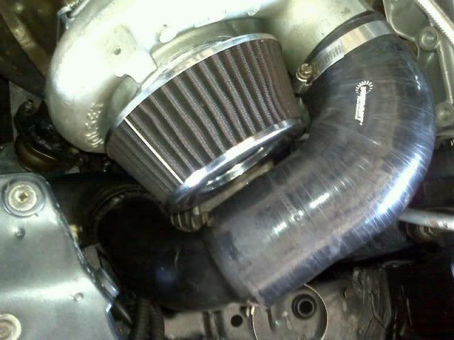

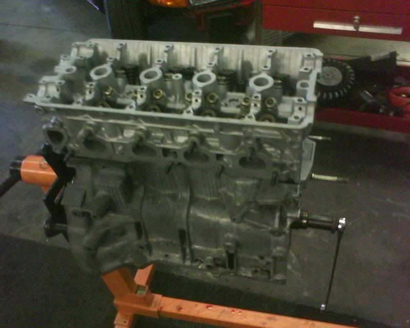

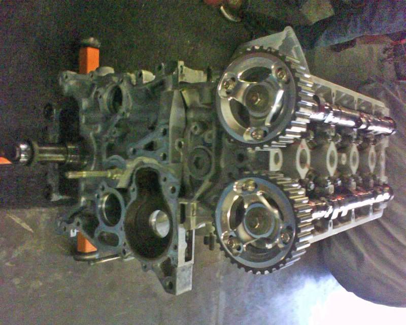

So.. with the recent consistancy of accords being posted i figured id continue the trend... heres a project me and my buddy are putting together..
F22A/H23A HYBRID
Block:
-H23a Pauter Rods

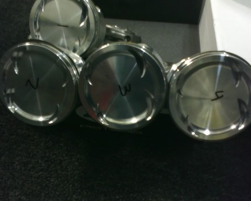

-CP Pistons .40 Over 9:1
-ARP Rod Bolts
-ARP Headbolts
-ACL Rod bearings
-micropolised Crank
-Blue Printed and Balanced
Head:
-Crower full valvetrain
-Stock OEM honda valves
-DELTA Regrinds 262/272

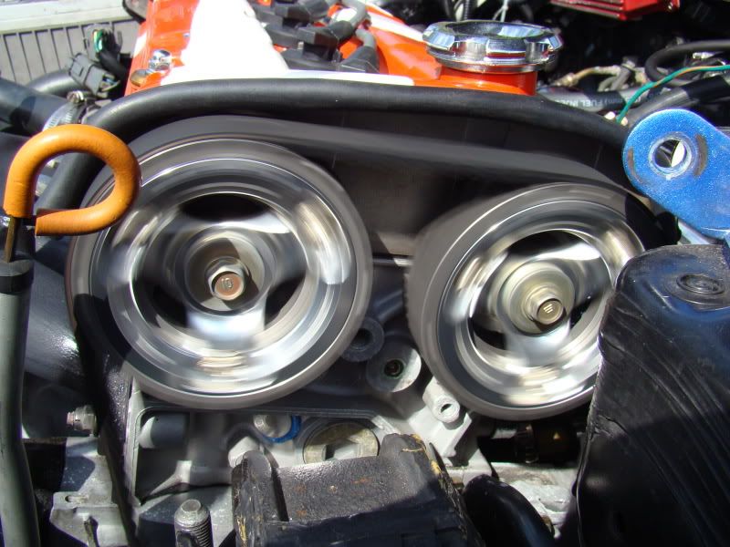

-Onsoku SAER style cam gears
-Honda OEM timing belt/balancer belt
Fuel Management/MISC
-Crome Pro/p06
-FIC 650cc
-FPR
-MSD 6AL
-MSD Blaster Coil
-Aeromotive A1000(not here yet)
-Oil Catch Can
-EG Mishimoto Rad with Slim Fan
-Greddy Turbo Timer
-turbosmart external WG
-SRT4 BIG FMIC 3.5" core size
-Greddy Type S bov
Mission:
-F22a trans
-ACT 4 puck Sprung clutch/Pressure plate
-Fidanza 8lb wheel
-Stock axles for now.

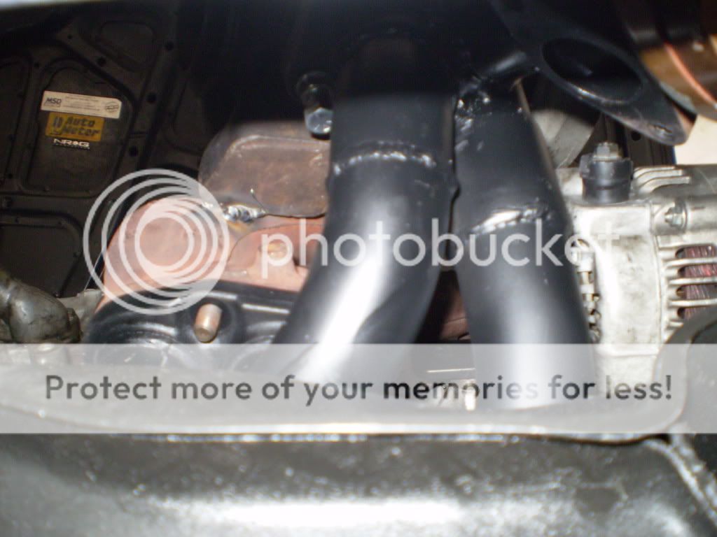

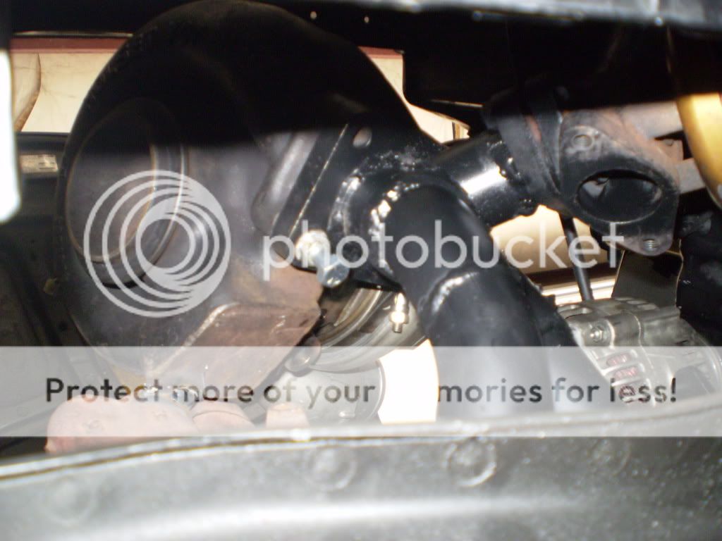

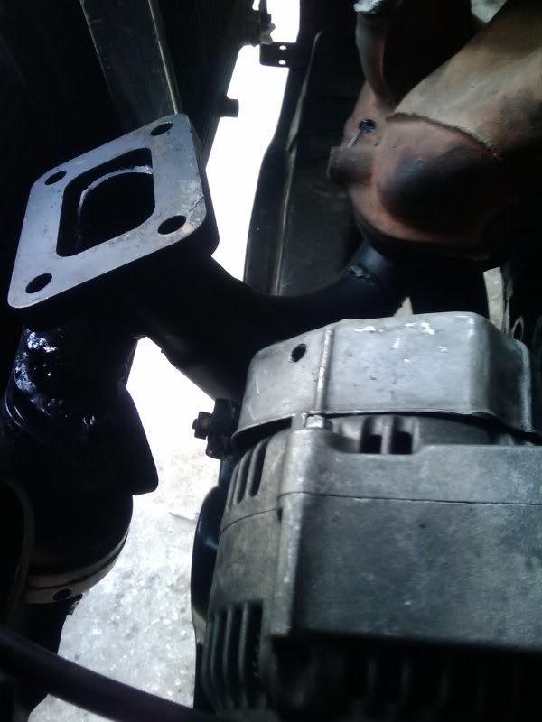

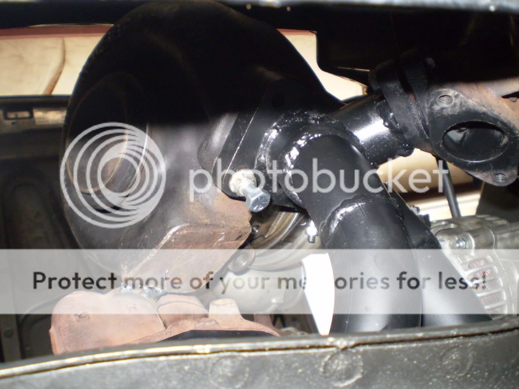

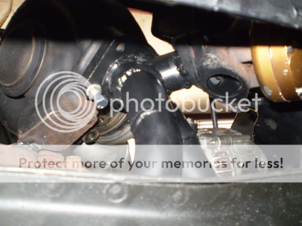

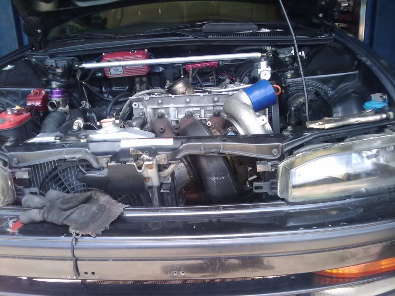

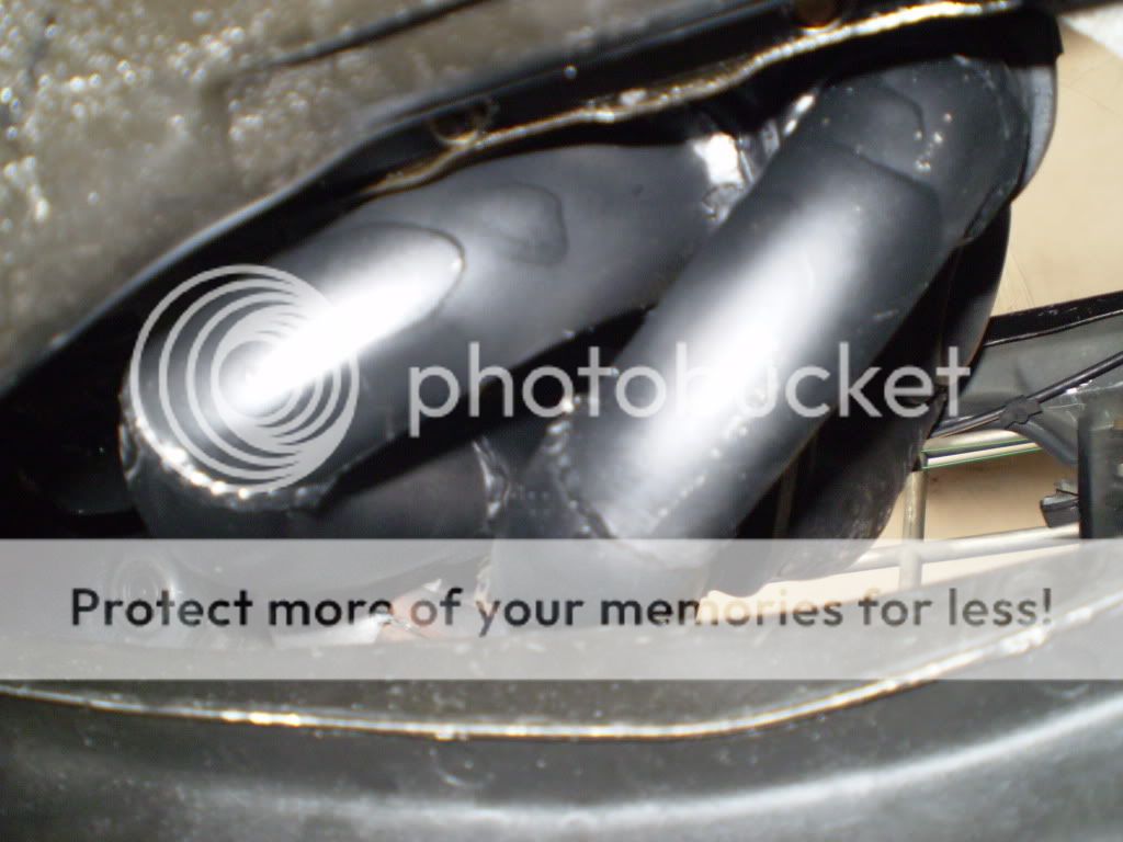

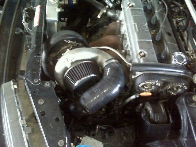

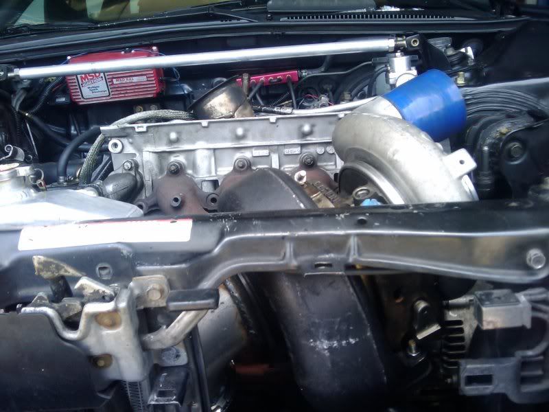

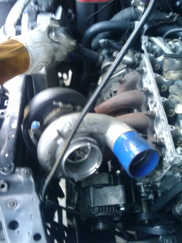

oh..ignore the tack weld from the turbine to the stock manifold.. we got tired of holding that 50lb baby O0

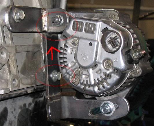

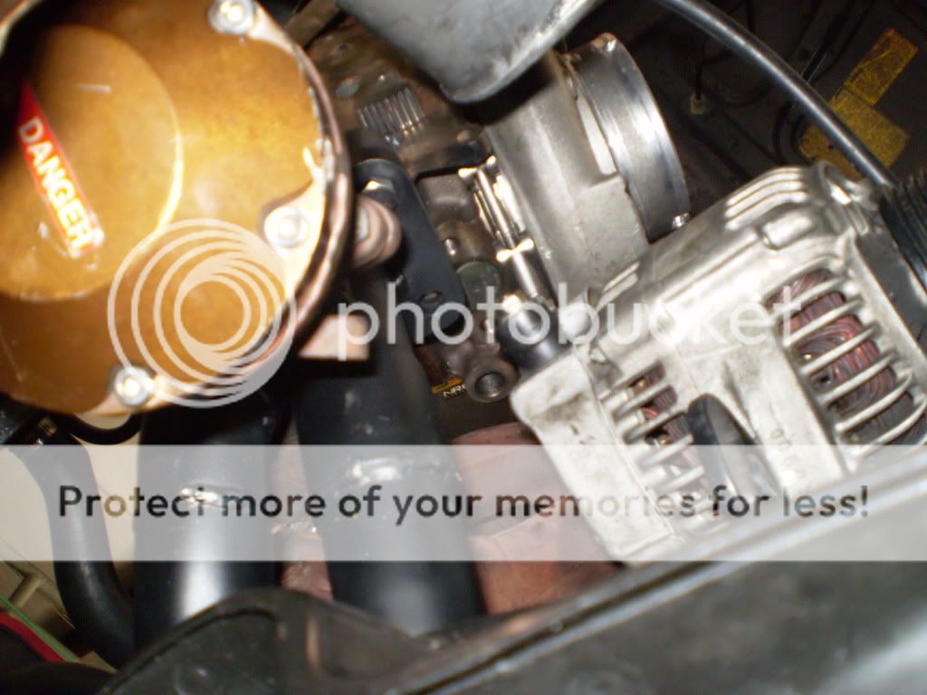

ignore the arrows.. showing someone how the esp.net needs to be modified

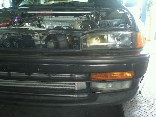

Thats pretty badass, I like the alt bracket.
Re: cb7/holset/f22/h23
« Reply #3 on: June 30, 2009, 01:45:07 PM »
pretty solid rHMT build right there.

I hate our alternator location. Good idea though to move it in place of the A/C. I hope that bracket holds it's weight.

Nice, simple, and clean can't beat that!

Ok so you are running an HE351VE, how are you controlling the vanes? Or are you just leaving them full open, and then just using the external gate to control boost?

ALT reloc kit looks to be ESP

« Reply #11 on: July 01, 2009, 07:57:11 PM »
Spikey ud be correct..the relocation kit is esp..and actually I fucked up and posted the wrong pic..that's esp default pic for the alternator relocator...
On cb7 chassis..it won't work unless you use different bolt holes..moving it up more..
If u try to use the location esp intended..it will hit the crossmember..(don't worry traction bars are already ordered..)
As for the vane control..I'm gonna use two ebc's one for the wastegate to control boost..and one for the t25 internal gate that were attaching to the vane rack.
Gonna have it go full open prob around 15psi..
Run 15psi on the street..should make for a fun lil ride... then if its something worthy..crank it up to 25...hehe

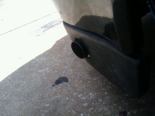

Is it still leaking oil from the head?
Hybrid_Theory
  • Posts: 41
« Reply #15 on: July 07, 2009, 01:16:01 PM »
no beaner.. we have a f22b dohc head.. at twister... being rebuilt.. then i will later port/polish it..
no hybridness this time around... jons a little pussy and thinks it will leak again..

« Reply #16 on: October 15, 2009, 11:30:22 PM »
Getting there...
she drives.. got a few bugs to take care of.. and clean up somethings.. but she drives..
the VGT on the holset is frankly IN-SANE.. close the vanes.. and you BARELY hear the exhaust...open them up.. and it sounds like its OPEN Downpipe.. even though its going through the exhaust..
a quick drive.. (without the vanes controlled) (1.05ar backside) produced 5psi by 4500rpm or so.. in 3rd.. i cant imagine what it will produce once we get the vanes controlled to be closed up until  12-15psi..
ripper vids to follow

« Reply #19 on: October 27, 2009, 04:57:10 PM »
so.. we locked the vgt using an internal wastegate with the vac port unhooked. (bringing them the vgt down to about .35ar)
20psi by about 4000rpm.. she rips.. and feels like it has the old 16g as far as spool/response but the topend is pretty insane till about 5500rpm and then it kinda drops off.. she pulls but not as hard
so then i hooked it up and put a mbc on the internal gate. and cranked it a few turns..
the vgts are opening up around 15psi..
cut the tires loose in 3rd around 5k..
ripper vids soon
crome 2step builds 10psi.. without retarding the timing and dumping fuel.. this thing spools...
