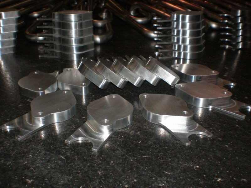

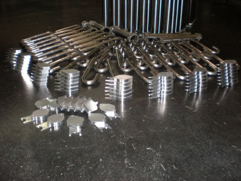

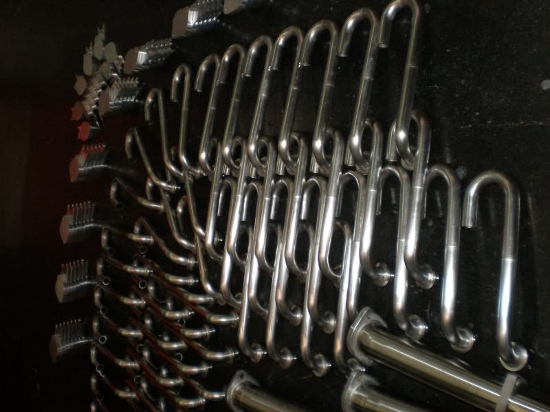

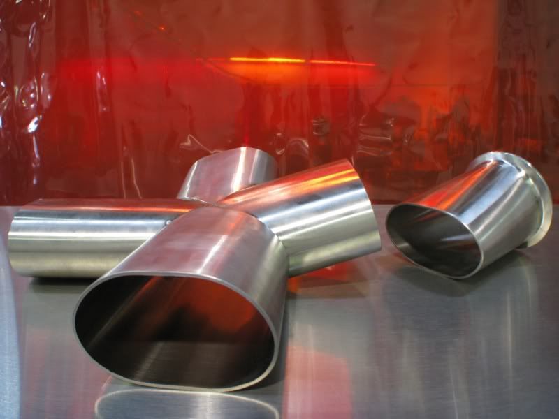

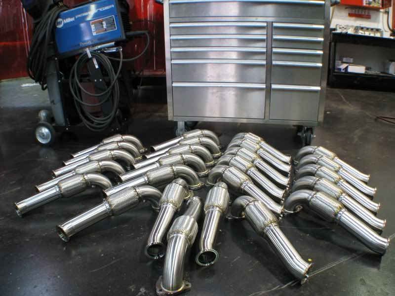

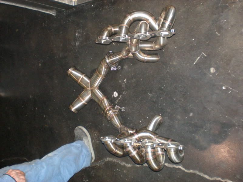

Things I fabbed/machined this week. I don't care if it doesn't match the usual RHMT fab, I made it myself.

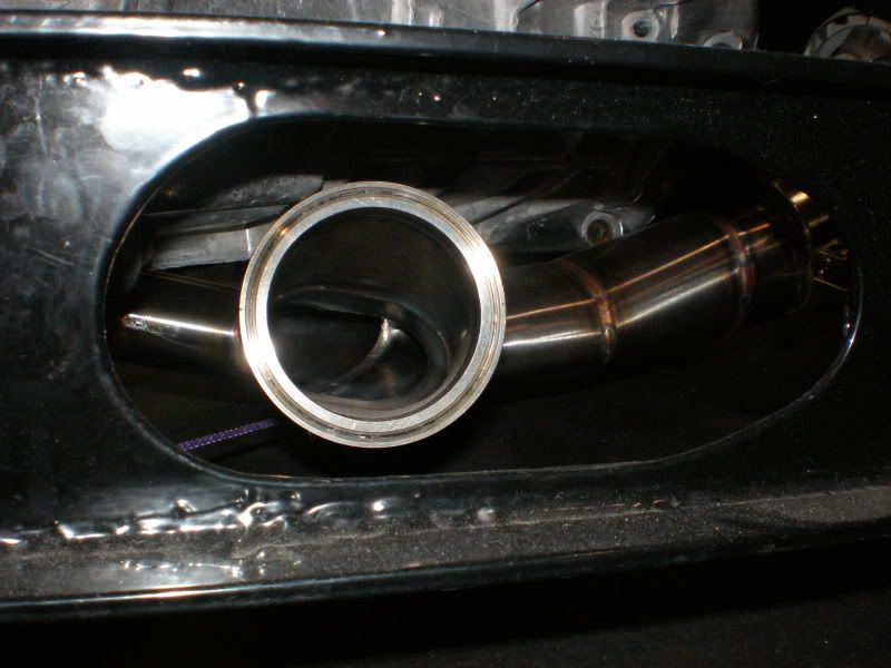

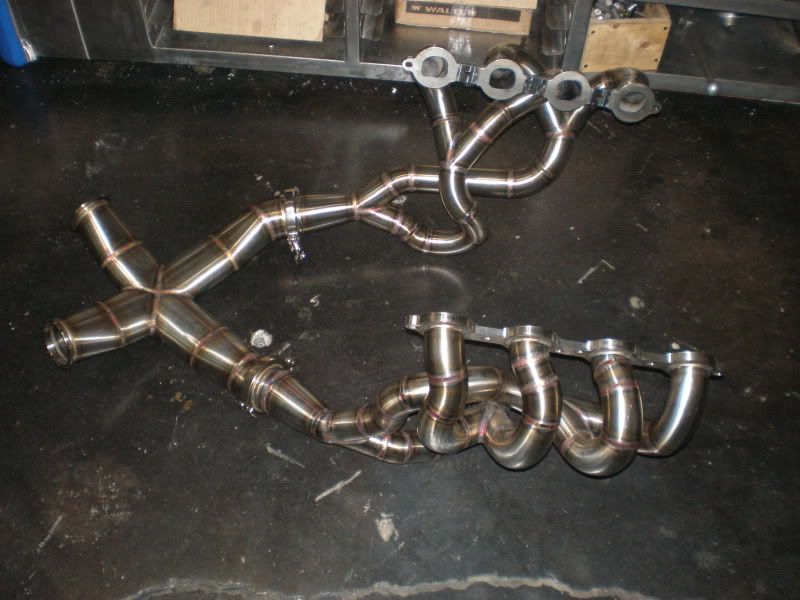

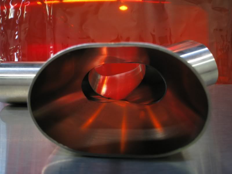

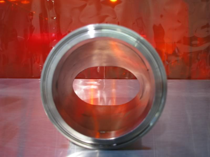

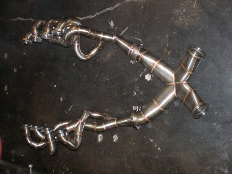

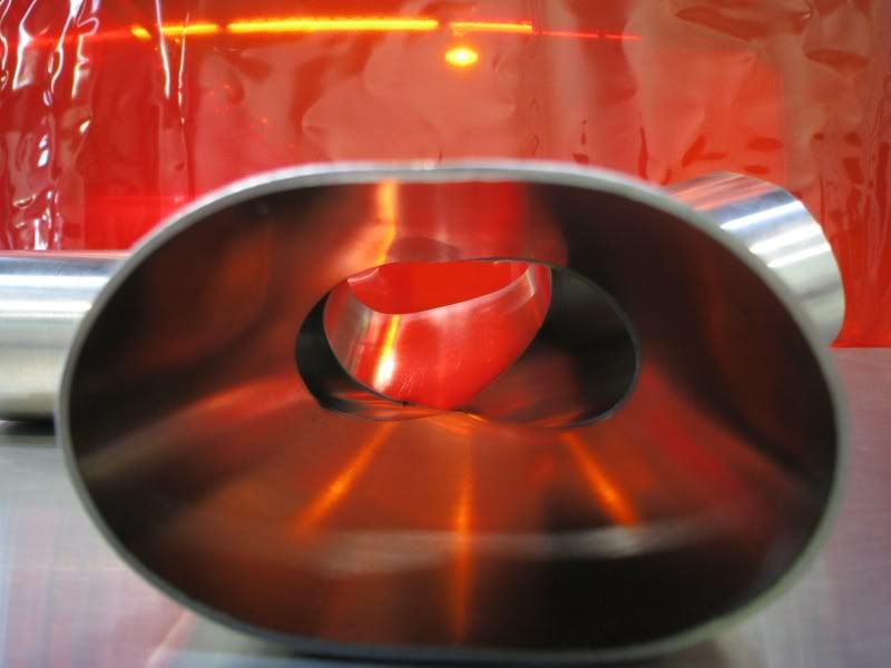

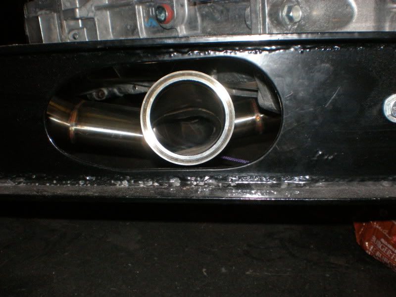

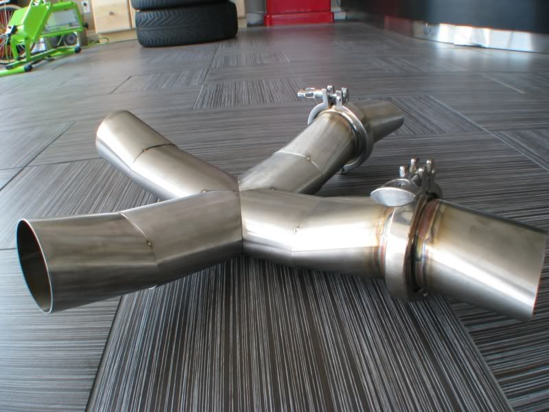

Corvette exhaust, 2" primaries, 3" header back, made the flanges, oval tubing, collectors and eccentric oval to circle transitions. *edit, header pics tomorrow*

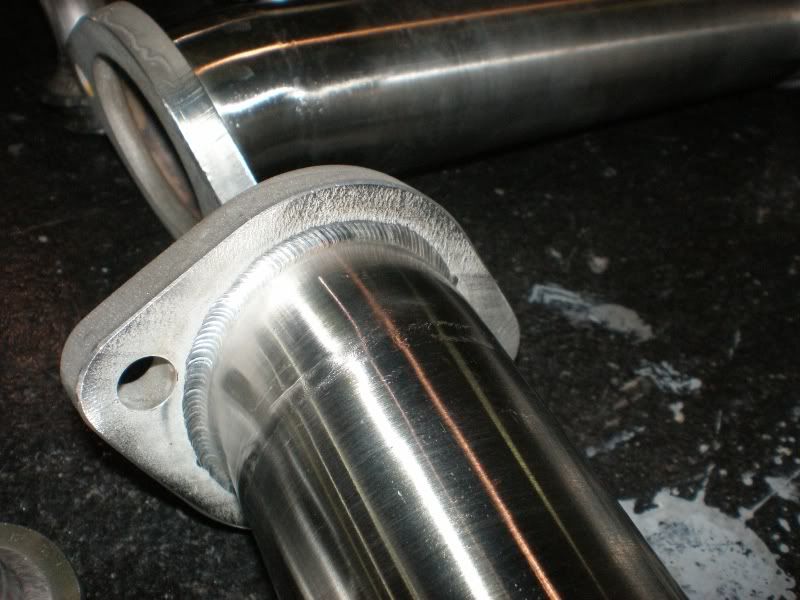

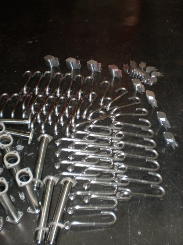

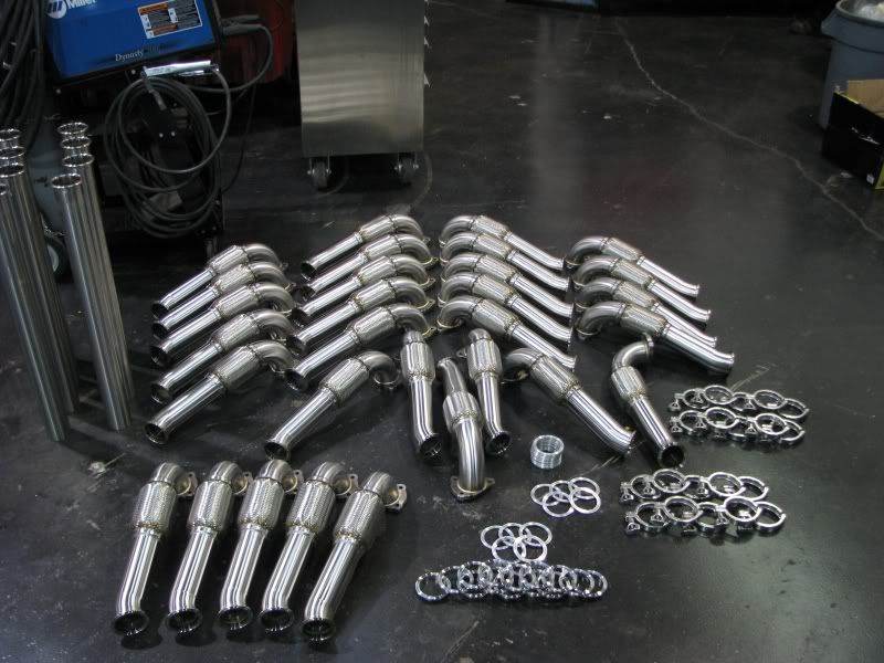

Downpipes for vw mk4 tdi's

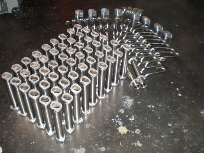

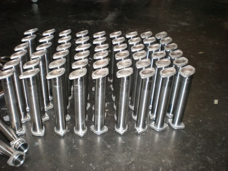

6.0l diesel ford EGR delete kits

Looks great Dave. Can you keep updating the Vette set up. The shop I work for does mainly Corvettes. Is this something you jigged and can make more of?

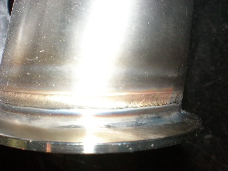

Turbob16hatch, what kind of info do you want on welding the thin tube? It would be easier for me to answer a few questions than do a write up on it, because I could go on for hours with all sorts of dynamics of welding tube.

Chad, I made 60 kits, they all went to BD, so I have none in stock, they do not have exclusive rights to the product at the time however so more cna be made but I can only get them done in larger orders.
Brett, only 60 of the 3/4" tube joints were cnc plasma welded, everything else was done by hand due to the plasma torch taking a dump, fighting with thermal arc about right now.

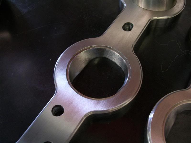

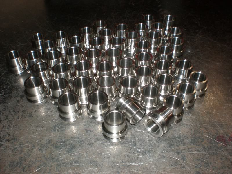

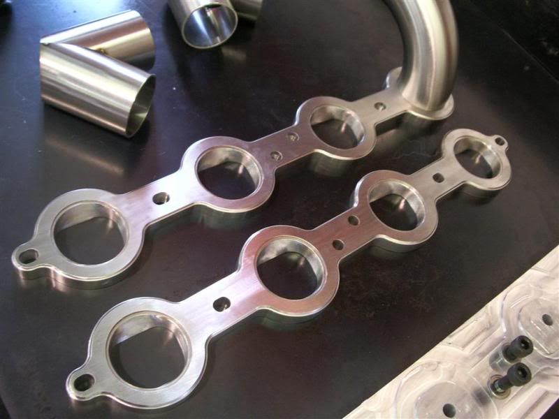

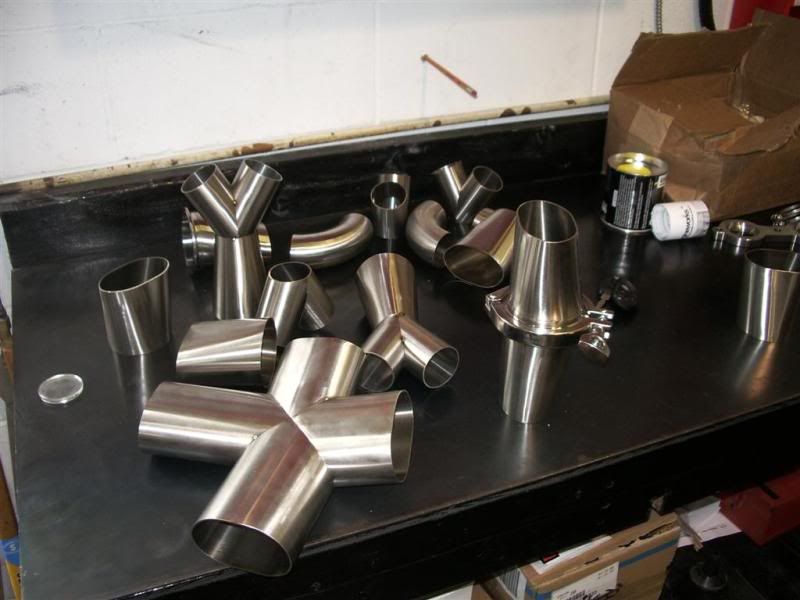

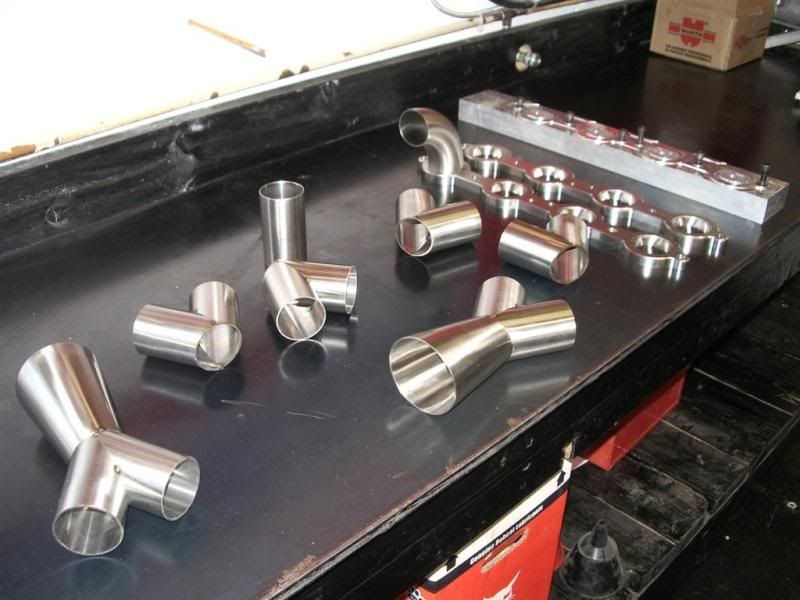

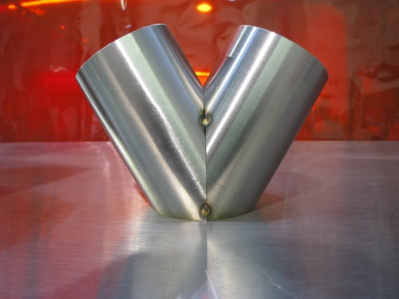

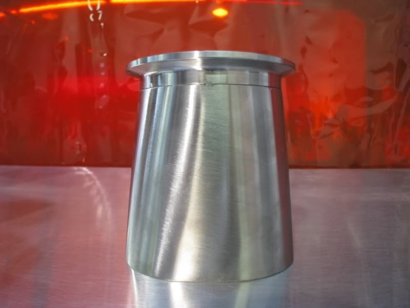

Here are pics of the flanges, and all the fittings we made prior to starting the headers:

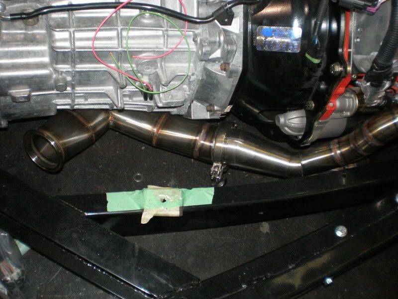

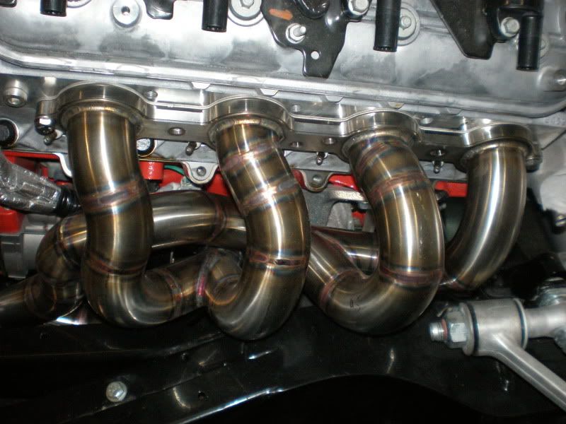

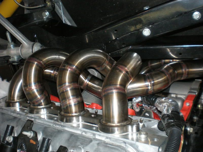

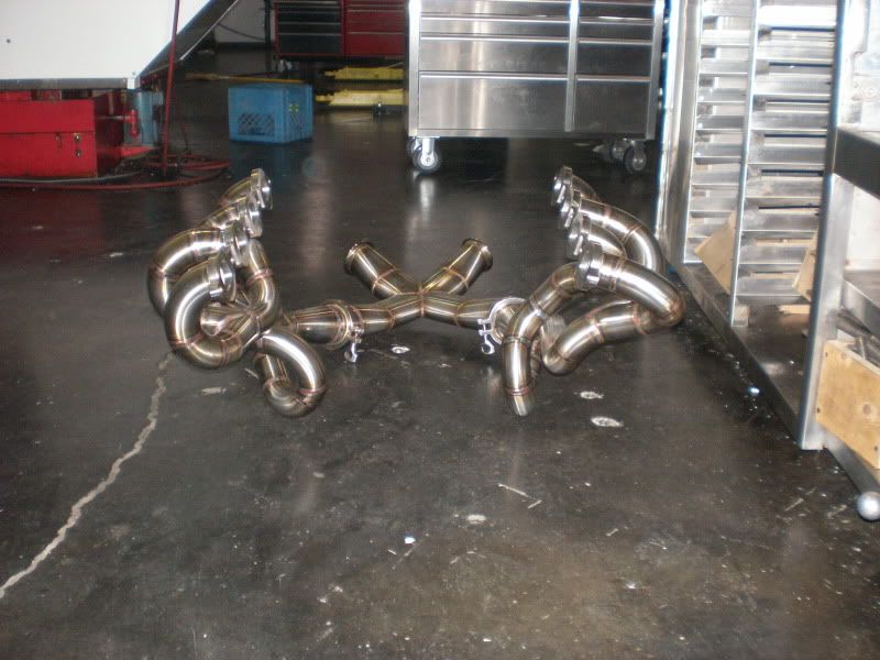

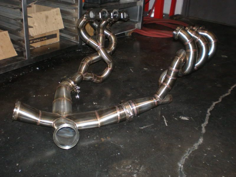

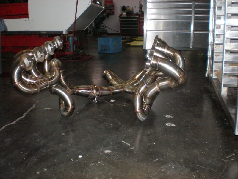

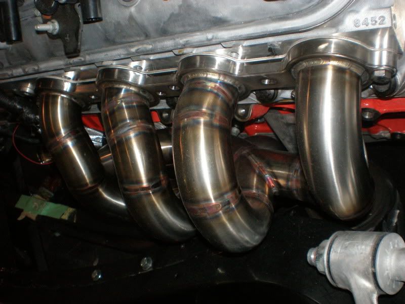

Here are the header pics, mostly done, can't wait to have them cleaned up and out of the car with the x pipe attached, will look very cool.

Yeah the plasma welder was working great, I am on hold now waiting to here what they are going to do about it, there was only about 5 hours of welding left to do, but turned into 16 hours doing manual tig and me working straight through the night into the next morning to get it done in time for delivery. Not cool, I want a new torch and a bunch of spare parts at minimum. Keep in mind plasma torches are like $2k.

what's it going to cost me to get a mkiv 1.8t 2.5" downpipe shipped to seattle? that work is BEAUTIFUL.
Re: Bunch of pics of stuff from this week.
« Reply #12 on: July 03, 2009, 05:03:33 PM »
I don't make one of those, it would have to be custom.

Is that a C4 chassis?

« Reply #14 on: July 03, 2009, 05:45:34 PM »
who do you make the tdi pipes for?
« Reply #15 on: July 03, 2009, 06:34:10 PM »
people with vw's (retards)  :P
« Reply #16 on: July 03, 2009, 06:36:55 PM »
guess i kinda left myself wide open for that.
« Reply #17 on: July 03, 2009, 06:55:32 PM »

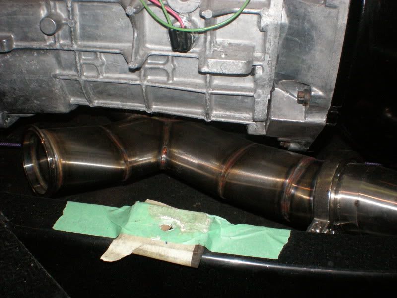

I don't know the full details on the chasis, I don't know anything about corvettes, but from what I understand its a mix of years customized to fit the '62 body. I will take some pics of the chassis, it has some sweet Aluminum shafts wrapped in cf for the driveline.
The downpipes I make for kermatdi, emt-tuning and dieselinside.

Looks awesome Dave. Any closeups of your plasma welds?
« Reply #20 on: July 07, 2009, 01:31:46 AM »
I am going to ask around and see if anyone took any pics, I don't have any. On the EGR delete kits, only 90 of the welds were automated, out of 300 welds. Plasma torch crapped out mid production which left me working through the night welding manually to get the job done on schedule. It seems I may have worked something out with Thermal Arc this afternoon and they may be covering a new torch now, so hopefully be back making automated plasma welds in the next week, which I need as I have a job that requires the plasma precision coming in this week, its some Titanium and hastelloy work with small screens.

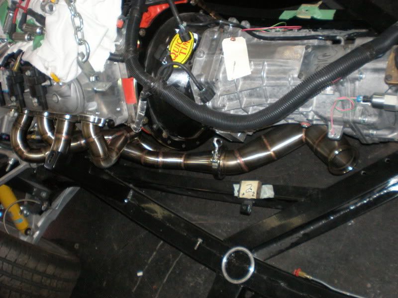

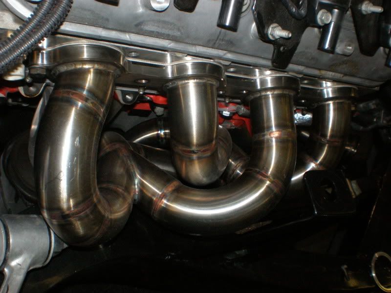

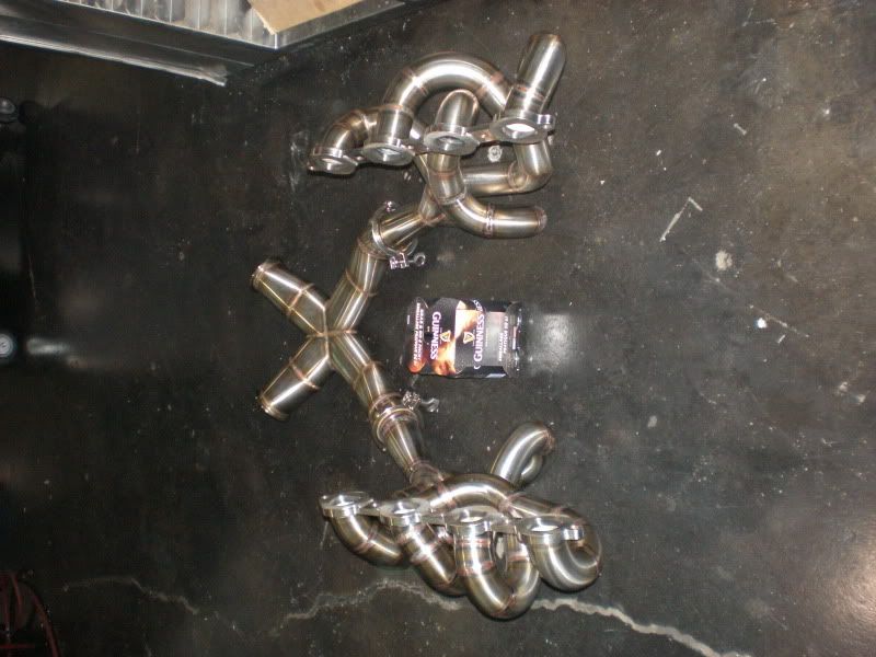

Here are some pics from the final welding on the vette headers, gonna try and finish the exhaust this week, will grab some pics of the chassis too.

Wow full race better look out once you have your plasma all sorted out. Are the vette pieces getting your usual ceramic coating?
« Reply #22 on: July 07, 2009, 02:07:09 AM »
The welding will be better than full race, the plasma welding process is much more advanced than tig welding, especially for doing thicker materials like sch40 manifolds, you can do what is called "keyhole" welding. Which is when the arc shoots straight through the workpiece like a plasma cutting torch except the material closes up after the arc (you get a better weld if you add a bit of filler too). So you can make very narrow, very strong welds, much better than tig possibly can. It doesn't completely replace tig however, because the tungsten sits recessed in a copper orifice in plasma welding it doesn't work well for tight areas, and the torches are bulkier as well.
We are hoping to make over 550whp with the vette, will dyno next year when the car is done. As for ceramic coating, we are planning on coating the inside of the headers only, as the owner wants the natural brushed stainless look on the outside.

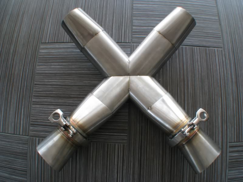

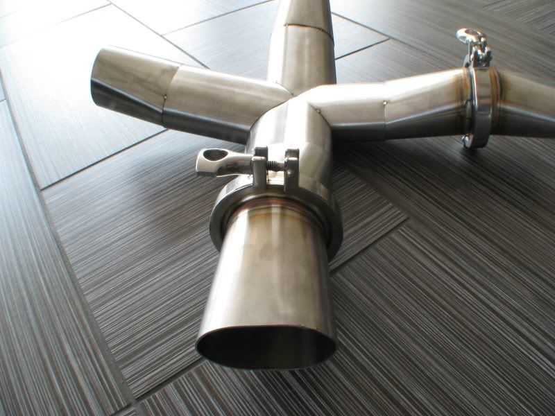

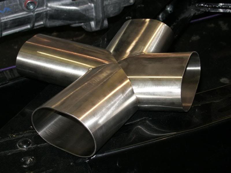

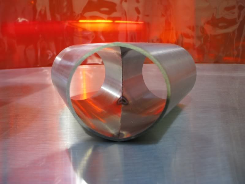

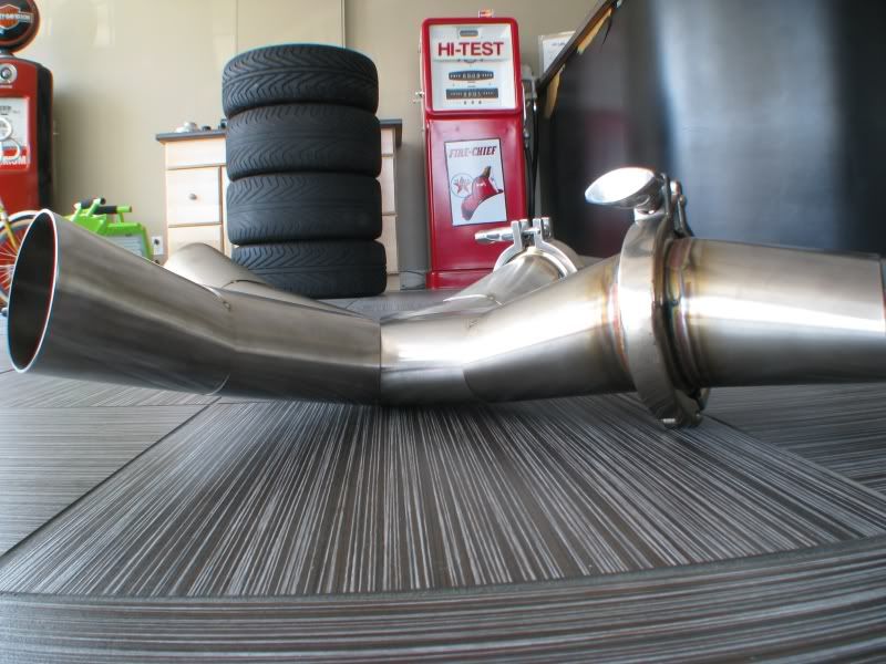

Gorgeous work as always... but what's the design consideration behind why the X is shaped like that?
« Reply #28 on: July 07, 2009, 01:51:36 PM »
Ground clearance, placing 3" tube under the transmission was not so great, so now it is only 2" tall.

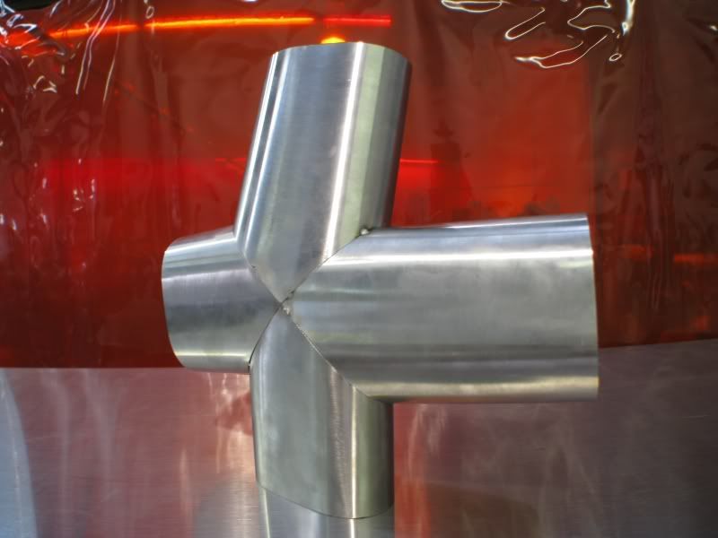

i meant why its a direct cross that is square 90* separation between each pipe.  how big (or long) is the equalizing hole in the middle? just looks like the pulses will run head on into each other rather than flow past each other teasing the other side along the way...
