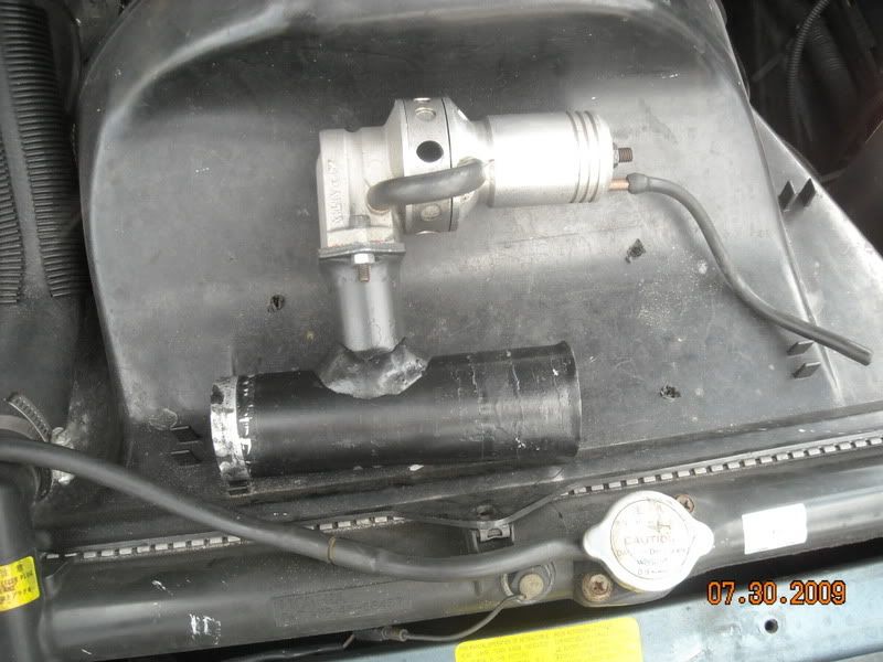

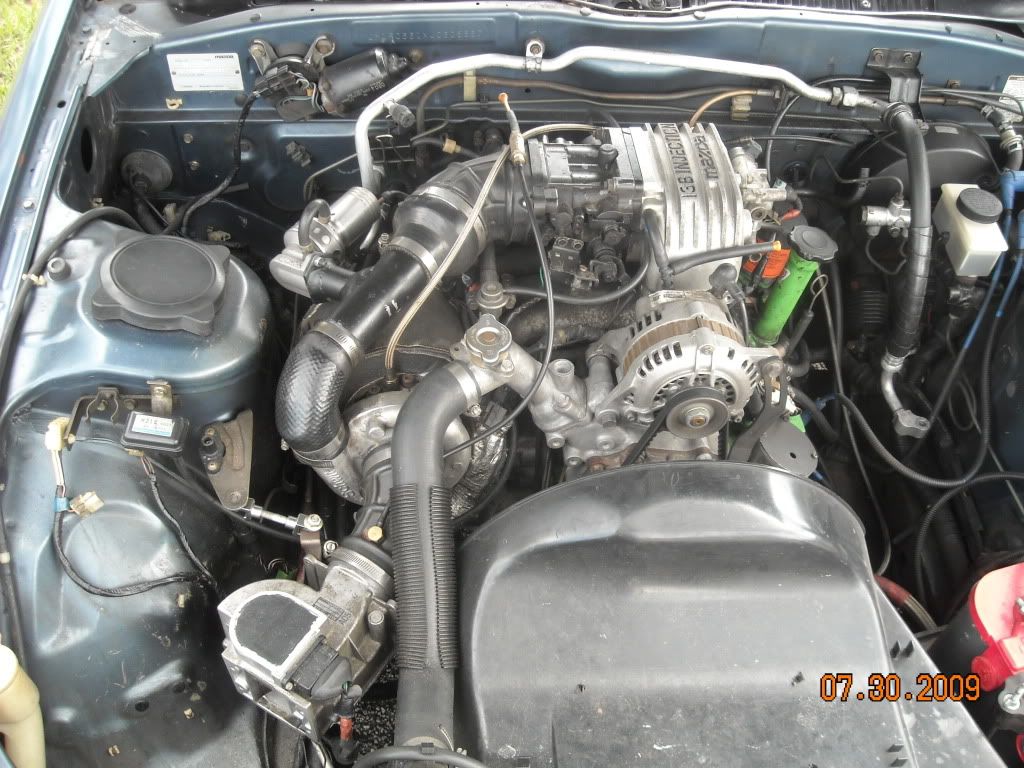

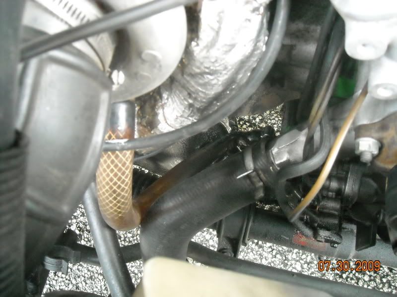

Basic Homemade turbo setup.
Random Schwitzer turbo that is one of the biggest t3s i have ever seen. Ebay manifold and wastegate, Home Depot oil return line and front lip(not fully bolted on in pic.) JB weld putty on the charge pipe with crescent wrench flared ends. Down pipe is  flex pipe welded to the hat of a civic brake rotor, which is the same bolt pattern as a 4 bolt down pipe  :-*.  And insted of an intercooler I am running a cooling mist setup with an m3 preturbo and m5 after. I dont feel like proof reading this so fuck off.

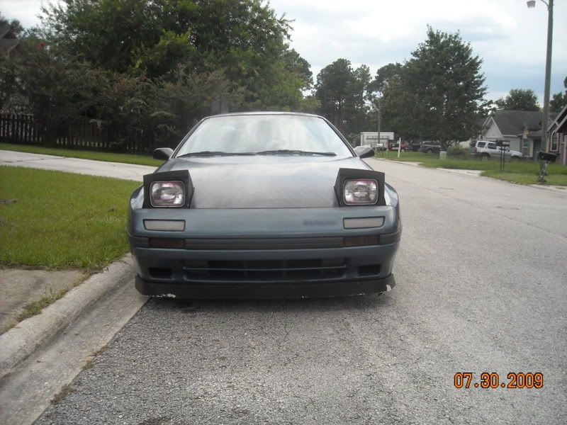

My car, depot lip not bolted on.
and another
lip chillin
engine bay

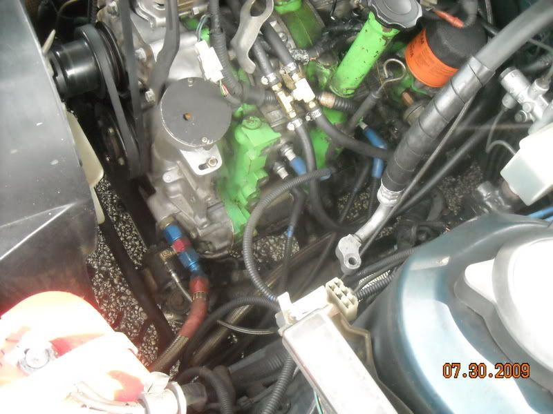

oil retun and bov/charge pipe

I like the wagon. Please boost it. What are you using for tuning on the rx

Looks good.  How does it run?  Any problems with the MAF sensor?  Good thinking with the rotor... ;)
oinesra
Re: My car: Insert funny here.
« Reply #6 on: August 05, 2009, 07:46:08 PM »
The fact that they use a fucking flapper door maf is a problem, but other than that it had no issues but I fucked something up. I decided to up the boost. so i put a reuseable paperclip on the wastegate line and upped the boost to 15psi. It ran like a bat out of hell, but I belive I broke a side or corner seal.
not a bad run on this motor thow. its been 5 yearsof beating  and 3 chassies to finally let loose. Even thow it runs like shit, i still daily the bitch

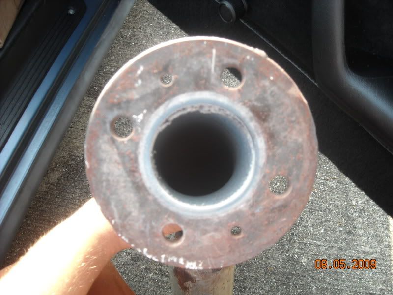

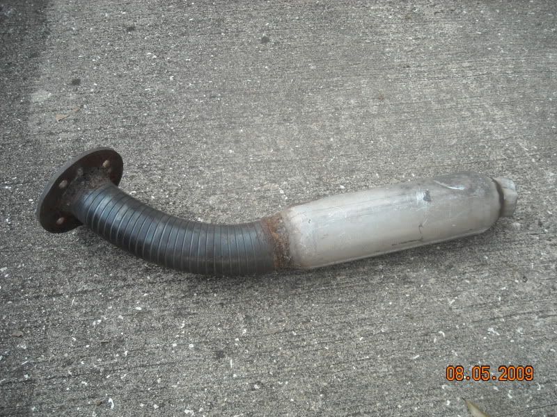

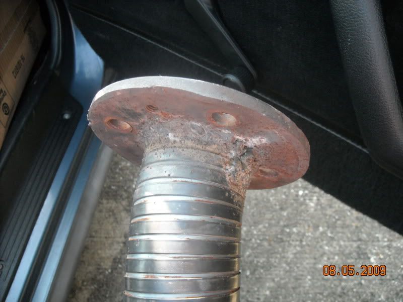

lol I want to see this. I never put 1+1 together, but sure as shit, the t3 turbine is a 4x100 bolt pattern. Too bad the cheap ones are cast iron, work-hardened, and heat-cycled a billion times.
« Reply #8 on: August 07, 2009, 02:54:42 AM »
that is the most gangster thing ever

Not trying to call you out or anything here but what injectors are you using and how the hell did you not blow that thing up over 4 psi?
I've heard of people running tII motors on their n/a ecu's and vice versa but damn.
Ah, anyway that's cool.
I spy a 10ae next to the wagon?
caged
  • Posts: 364
« Reply #10 on: August 08, 2009, 03:27:33 AM »
He has a cooling mist set up ;) . Nice rhmt set up, its good to see a rotor here for a change.
holy shit you're right

pics of down pipe?
i am all about doing shit myself, saving money, and most of the time i actually enjoy working on the car as much as driving it.
I can't believe that's it.
Didn't touch the fuel at all........
Is this running off an n/a ecu or a TII ecu and afm with TII boost sensor?
Timing retarded via clocking the cas?
Any problems at the 3800rpm secondary crossover?  When are you hitting full boost?  Probably just off idle!?
Your setup blows my mind.  Like, just the fact it works and has been holding up.

more pics of the wagon pls  ;D
for the longest time i was using  stock n/a ecu/AFM/pressure sensor/injectors and injecting 90% rubbing alcohol.
now im using all Tii stuff and injection 20% nitromethane rc fuel.
Timing is full advance at the CAS because the motor is bridgeported and wont idle on stock ecu correctly with stock timing
no problem with staged injection, cross over is fine. And full boost is at 3500, but the turbo hotside is huge.
The only problem with useing N/A stuff to boos is the pressure sensor. It will flip out when you hit more than 1psi, so i just unplugged it.

Wow.  The civic rotor/downpipe is fucking awesome. Now, unbolt that turbo setup and chassis from that engine, and replace the driveline with something that doesnt suck donkey cock.
98redcavz24
  • Posts: 3418
  • NE Crew
Re: My car: rx7.
« Reply #19 on: August 11, 2009, 11:14:09 AM »
that downpipe is cockshot worthy. just awesome
Impossible. Everyone knows (or eats it up) that rotaries accellerate turbine shafts at 13.4x the normal rate of a piston engine. :mexi:
BTW I'm curious about the nitromethane fuel. You need a richer mixture due to nitro, get hotter burn temps, and 10-20% of the fuel is usually castor oil. Is it actually working well for you?
