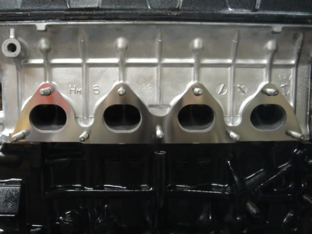

Here is a picture of the OEM gasket on a D16A1 head (same as DOHC ZC)
This is a SOHC D16 gasket on the same head
You will have the reverse of this problem and your ports will not line up exactly. This can probably be remedied with a die grinder and work just fine, but they will not line up exactly.

« Reply #28 on: August 26, 2009, 06:11:51 PM »
thx for pics but i know differences, i have here D16 SOHC mild steel flange and D16A6 SOHC flange in mild steel too, i will not have any problem installing DOHC ZC log mani i made in A6 head..
like i said. thx  ;)

Re: D16A6
« Reply #29 on: August 26, 2009, 06:20:02 PM »
I don't think you need to put a new flange on your log. You can probably slot the holes and slide the log manifold down a bit.
