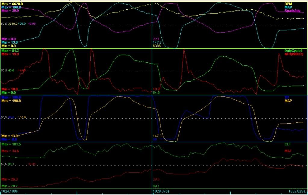

Ok it's never done this before. Usually just goes to whatever the boost is set for and holds SOLID. Now it's hitting peak boost and the tapers down the longer I'm in boost. Like dropping from 15 PSI to 6-7..  :( And I could feel it of course I was like WTF it would step out in second  then fall flat and hook up again.
It wasn't doing this yesterday. Today I removed the old hacked  O0 rigged VR sensor bracket I used to use and made a new one. The old one would vibrate at certain engine speeds and the engine would go "off" and then snap back on. It got to the point I couldn't go over 4500, so I fixed it today. Now it will works fine. But this all of a sudden? Only thing I can think is that the timing may be 4-5* more retarded than it was before. But wouldn't that make it overshoot? This is baffling, and 15 pounds was fucking RIPPING till it falls down.
Screenshot from a datalog, 1st, 2nd, 3rd.

Looking at your datalog, the first graphs, in second and third gear.  Notice the boost falls off as RPMs increase above a certain point.  That point appears to be roughly the same for both 2 and 3 gear.
Theory: boost leaks.  Turbo is maxed out pushing all the air it can.  at lower rpm the engine draws less air so even though some boost is leaking it still hits full psi and wg opens.  but when engine draws more air at higher rpm, turbo cant spin faster to push more air, so boost drops off.  Your exhaust backpressure would also be higher than norm, cuz the WG never opens at high rpm, thereby making car feel even slower.

yeah, I see what you're saying. And yes there is DEFINATELY a RPM/boost drop correlation. I brake boosted it for like 5-6 seconds at a steady RPM and boost statyed the same. When I let of the brake it took off and boost dropped....  Guess I'll be doing a boost leak check tomorrow.
