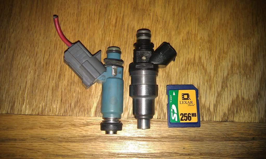

i thought i got ripped off at first, these things are tiny
suby 440 vs supra 440cc

Damn, the connector is bigger than the injector itself  :?:
