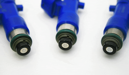

I almost got a set myself, but noticed something when I did research.
You'll either want to decap them, or run an extended top hats. They're a twin-cone spray, but they're designed to be clocked 90*. Mounted like a stock B-series injector (clip top/forward), you'll have one cone spraying towards the top of the divider and one towards the bottom of the divider. They'll only spray towards each valve if the connector is on the side of the injector.
Notice how they injector clip is pointing sideways:

« Reply #88 on: January 15, 2012, 12:20:01 PM »
Darn, I had seen those pics but hadn't noticed the 90-degree issue. :mexi:
Those injectors are pretty small to start with, and I was half thinking about running extended hats already - guess it's a must now.
Thanks.
