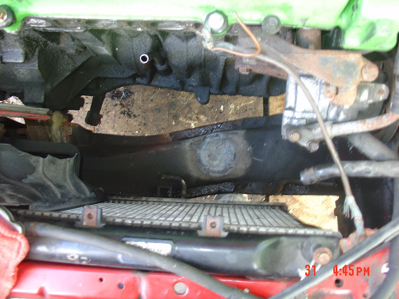

I'm not too happy with the manifold I have, so I decided to use the sinktrap idea to make the best out of it without spending anything. I had problems when I was installing my HX35; first off the wastegate flange hit the turbine housing, then the manifold put the turbo too low and the compressor housing was hitting my cross member, and lastly the drain flange sits too low and I don't want to risk a brand new HX35.
materials used: 3" stainless 180, 2x T3 flange
I had the same problem. The turbo was hitting the crossmember on my teg. I heat it with a torch and hit it with a 2lbs hammer. The oil drain still low tho, but it works well.

If you can make a sinktrap extension, you should be able to make a tubular x-member replacement like innovative mounts makes or box it out with steel plate. BTW I have the same shoes.
At least you won't be hiding such a badass turbo now. Are you making a 4" DP, or a 3" to fit with the stock rad fan??
4", the worst part is I just bought a ss thermal 3" exhaust for 90 bucks, so it's going to be the bottle neck for high boost pulls. oh well

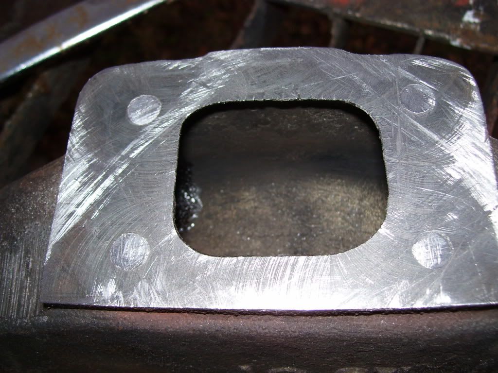

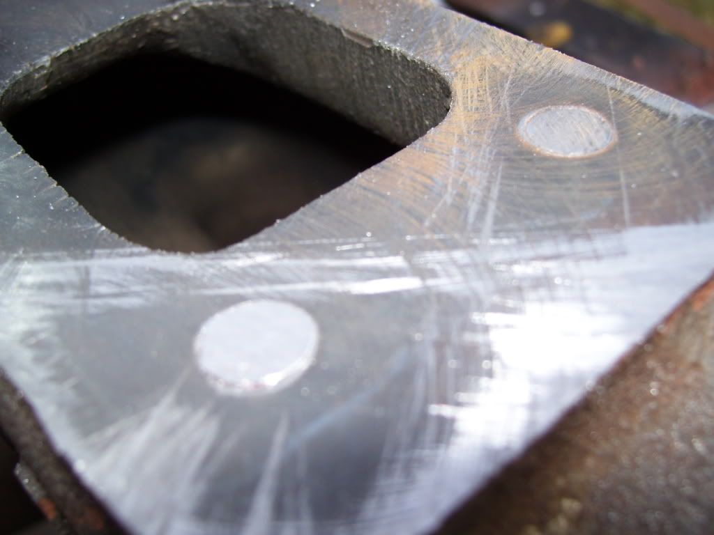

got a new toy today..  ;D
made some angle cuts so the ends match up right.. essentially you want to put the flange between #1 and #2. it's close enough for me. I'm waiting on my T3 flange to get here, and still need to level off the top

i planned on it.. what would you suggest the best place would be? I was thinking from the T3 flange at the collector straight out.. I know an X would be ideal
Re: my sinktrap manifold.. work in progress
« Reply #22 on: March 13, 2009, 02:45:40 AM »
I'd brace it down below to the AC/mount holes, then maybe have a tab that catches the top of the T3 flange on the manifold. Adding that tab would make removing it a bit tricky tho. A nice thick chunk of steel to the AC bracket would probably work fine, just make sure it's mostly on the 2nd half of he bend -- the elbow half that goes to the turbo. I'd actually shorten both legs on the whole extension, which would allow for a better angle for the brace.
