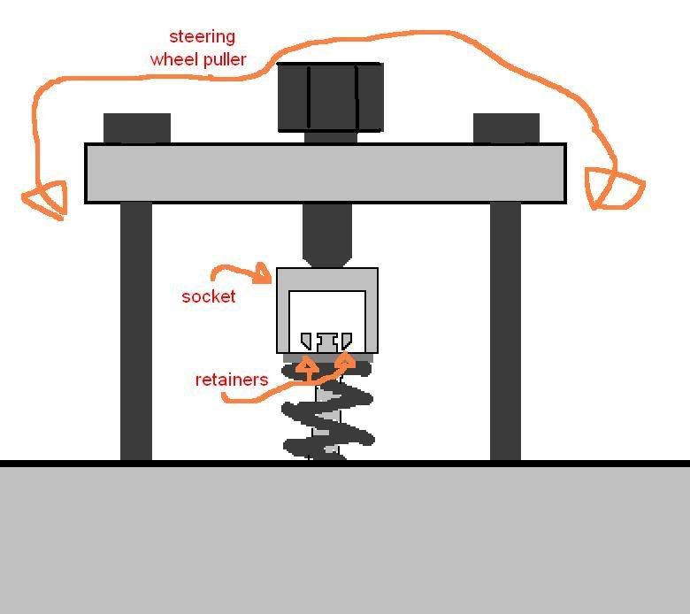

I use that one, while the heads on the car.

if i ever need one of those B series jobbers, im going to make one out of steel.
tap kit and drill for the win
Re: home depot B series valve spring compressor
« Reply #28 on: October 28, 2009, 09:10:26 PM »
There is no room for a steering wheel puller in the head  ???
« Reply #29 on: October 28, 2009, 09:40:47 PM »
Idon't think you have had your bear claws on a DOHC VTAK head before...
There really isn't much room to work let alone try to shove a tool in there.
