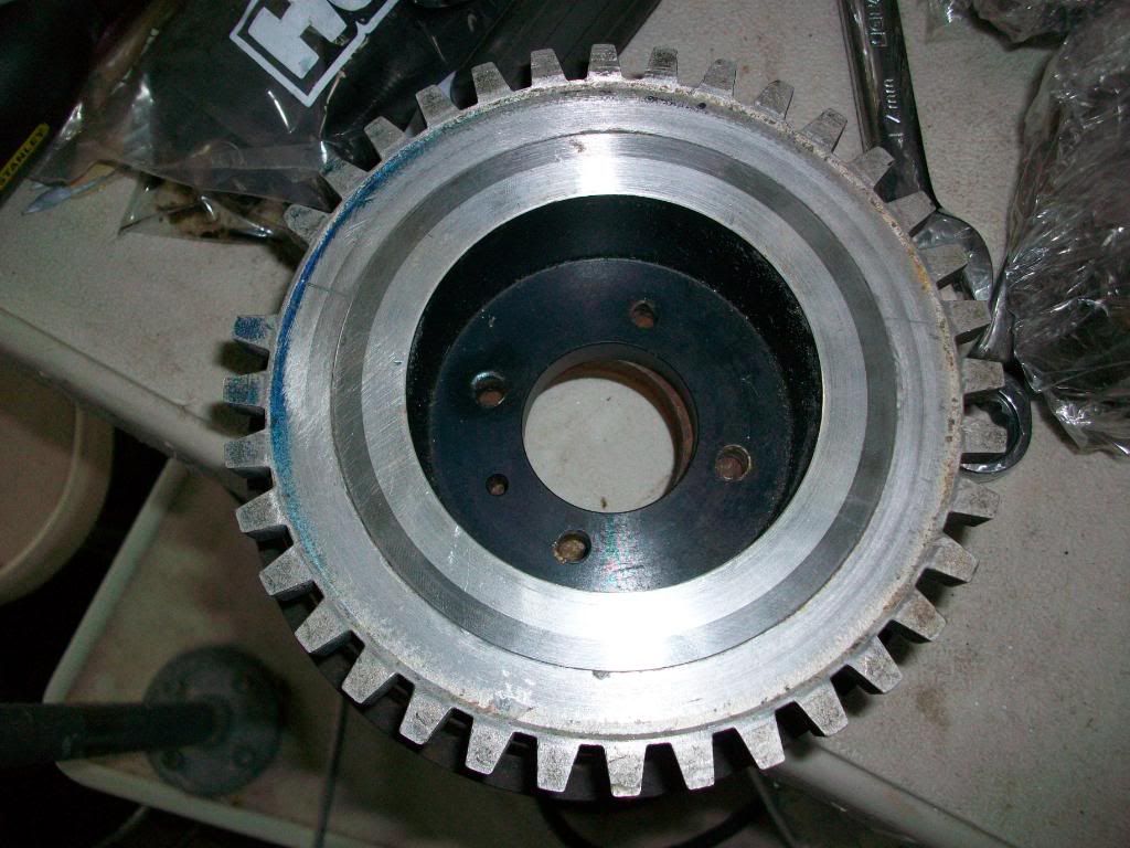

No, this was from my shitty trigger wheel setup. It was a couple thousandths out, and after 20K miles of wobbling, it vibrated the big bolt holding that assembly together and then it destroyed itself.

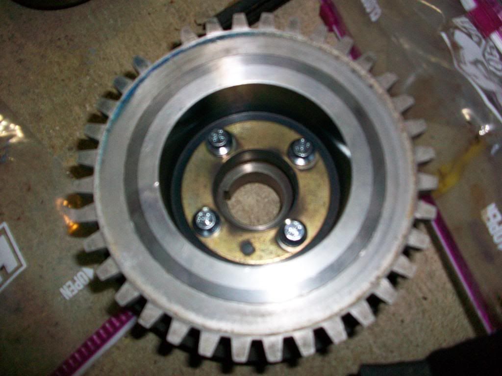

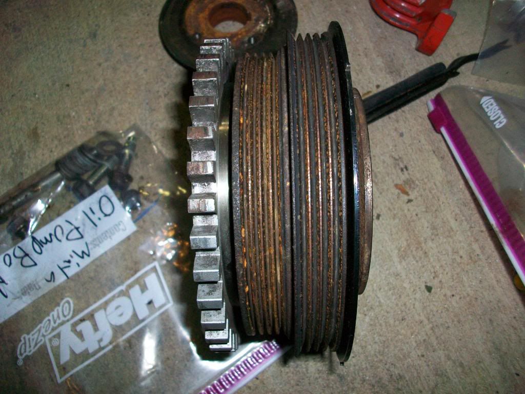

Well, it turns out I found a simple way to put a ford EDIS4 trigger wheel onto a pulley that I already had that bolted up to the crank in front of the balancer, so all the machinist has to do is turn down the pulley, press on a sleeve, then turn it down to the right diameter and press the trigger wheel on. And the guy doing it has been a machinist for probably 50 years, he's retired, but still does work on the side. So he usually hooks me up and does excellent work. Plus he's only 1 mile from my house.

Sir, in my eperience I have found that just because something is pressed on, doesn't mean it can't move. 911 triggerwheels are notorious for shifting on the flywheel and causing many different problems.I would at least do some tack welds to prevent this.

Drill at the interface in one or two spots, tap, secure with a set screw and blue loctite.

Yeah, the last one I did myself and pressed it on w/ cylinder sleeve locktite and a 1 thousandth press fit. It hasn't slipped in 20K miles. The machinist making it knows what he's doing and what this is going on, so I'm confident he'll do it right.
Or I may do the tap/drill/locktite thing, I'll ask the machinist what the press fit was and if he thinks anything further is needed to prevent it from slipping.

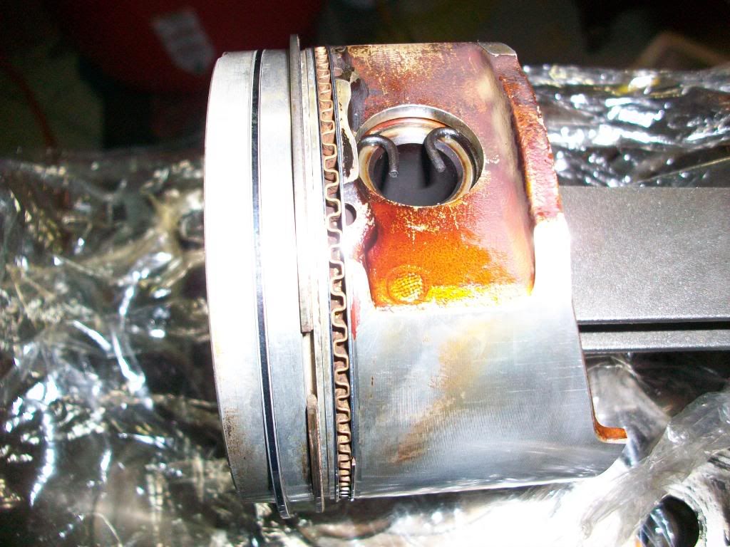

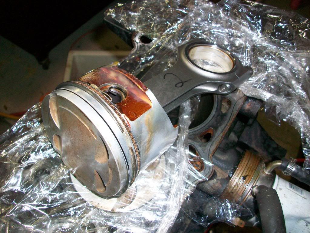

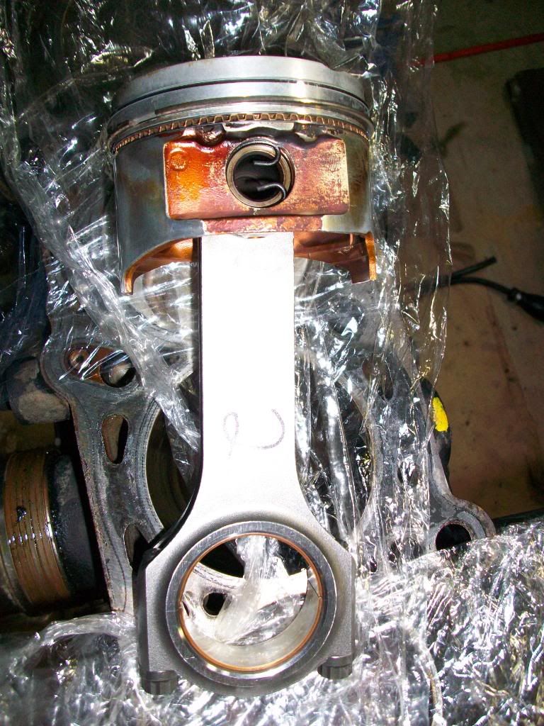

Tore the old engine down.
Low compression rod:
Funny, that's from cylinder 1, which had the highest compression  :P

« Reply #81 on: December 20, 2009, 12:41:58 AM »
Thats not to bad, just bed it back :P

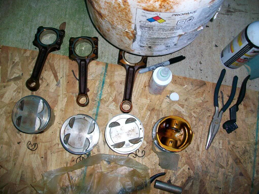

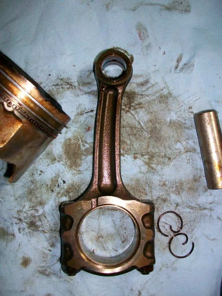

These pistons have full floating wrist pins. So when the new rods get here just slide the pin out, switch to a forged rod, and reassemble? Anything to check, other than that the new rods "floats" on the wrist pin? I've heard sometimes you have to hone the bushing of the small end to get the fit right. How do you know when it's right?

You just hone a little bit at a time. Pretty easy to do.

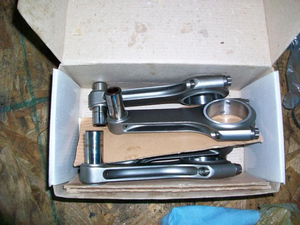

« Reply #84 on: December 21, 2009, 09:42:19 PM »
Got the rods. They're purrdy. They're 75 grams lighter than the stock rods according to the harbor freight digital scale. Get off work at 3:30 tomorrow, I'll start the engine assembly then. Can't wait. :)

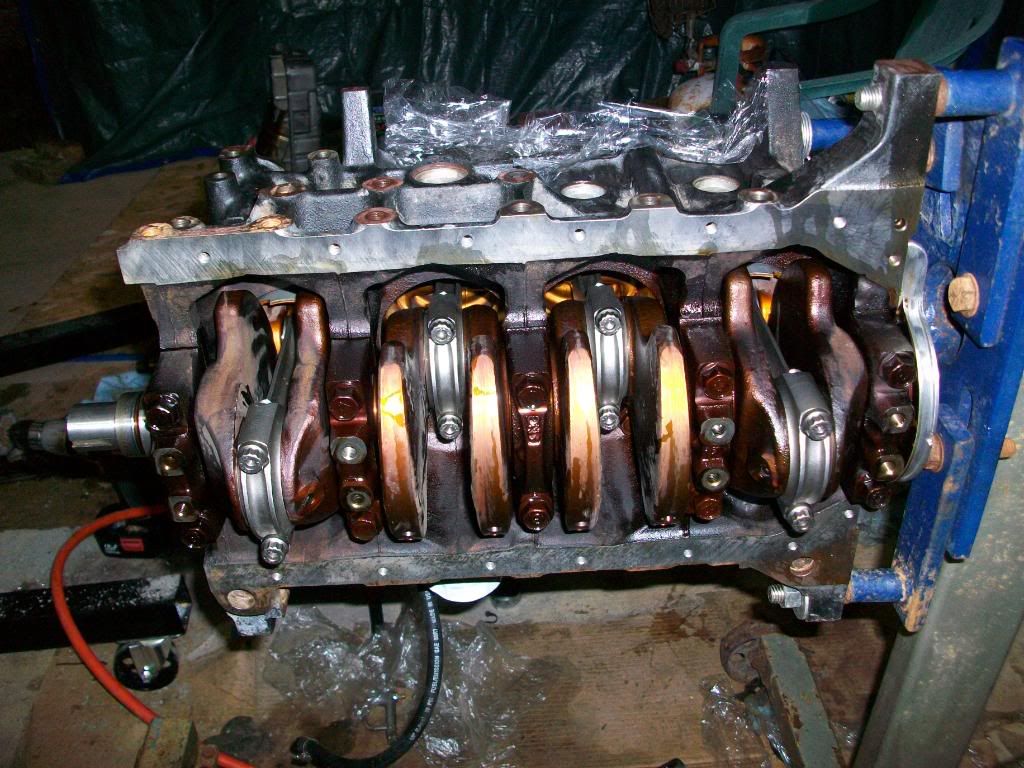

« Reply #85 on: December 24, 2009, 02:08:51 AM »

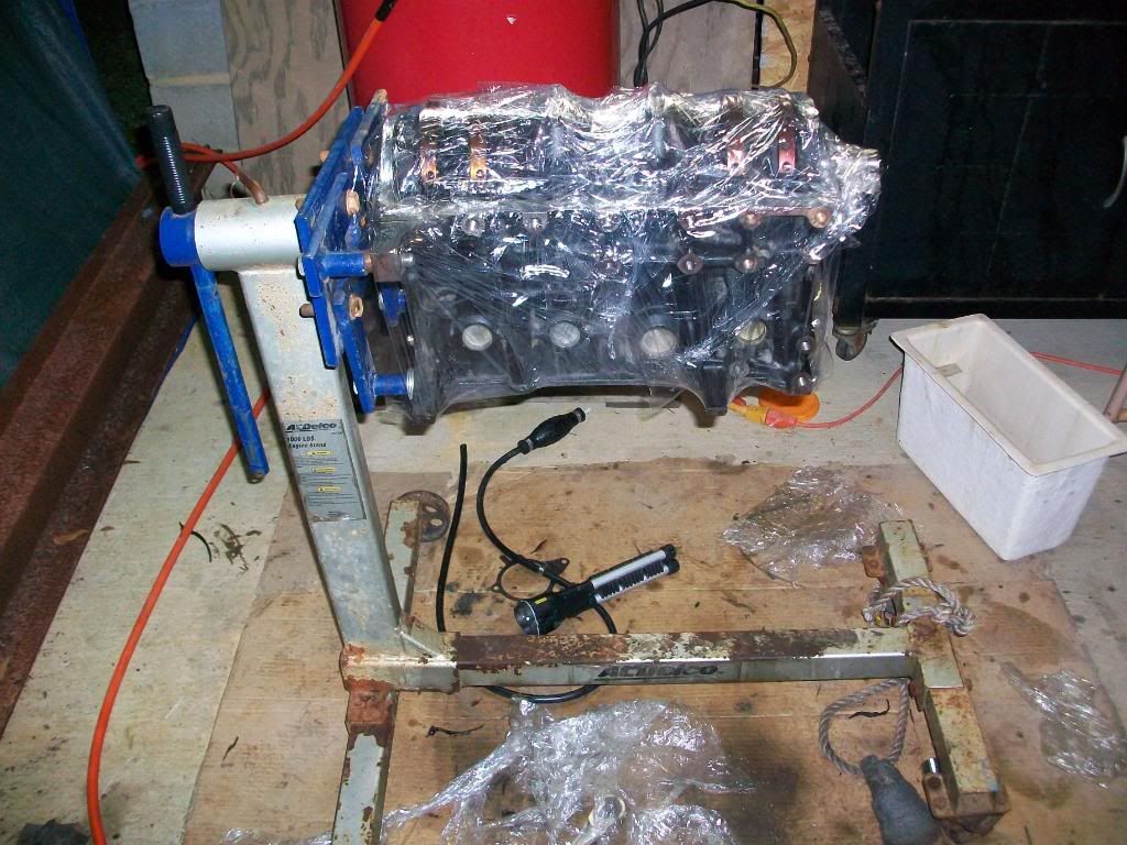

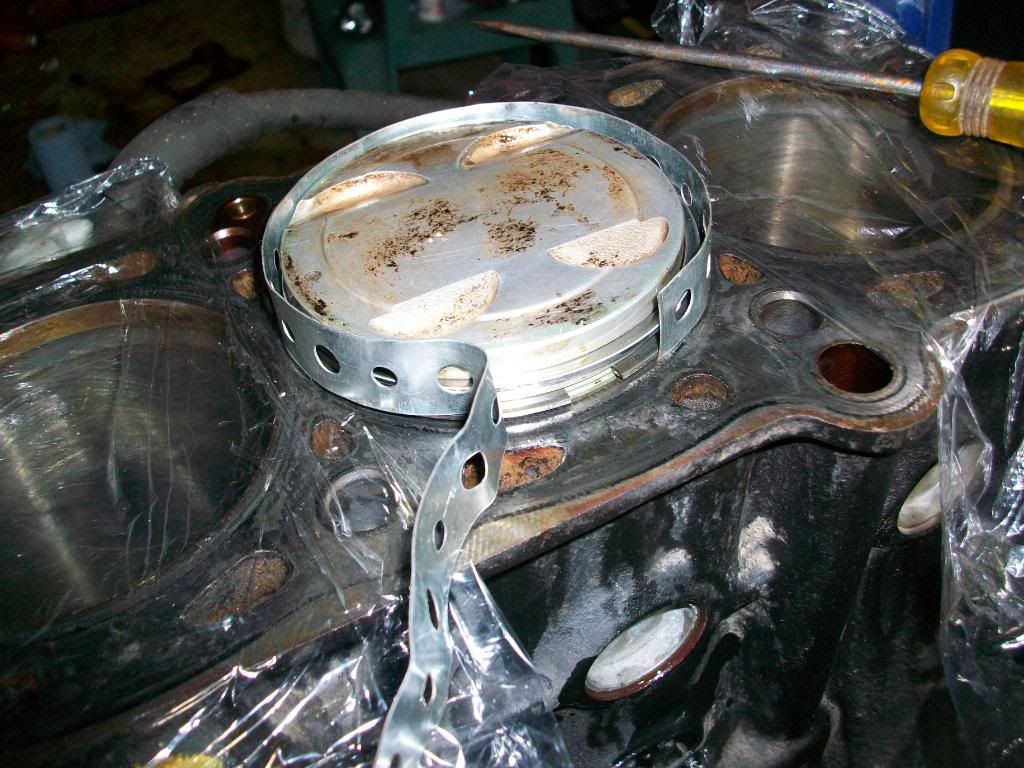

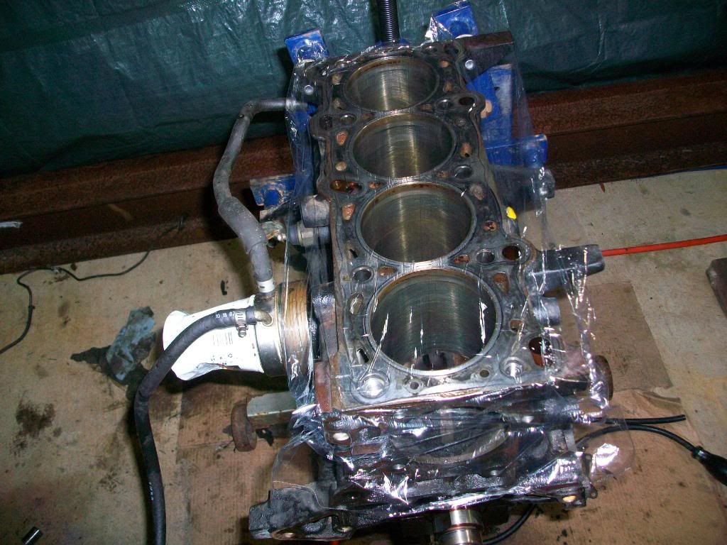

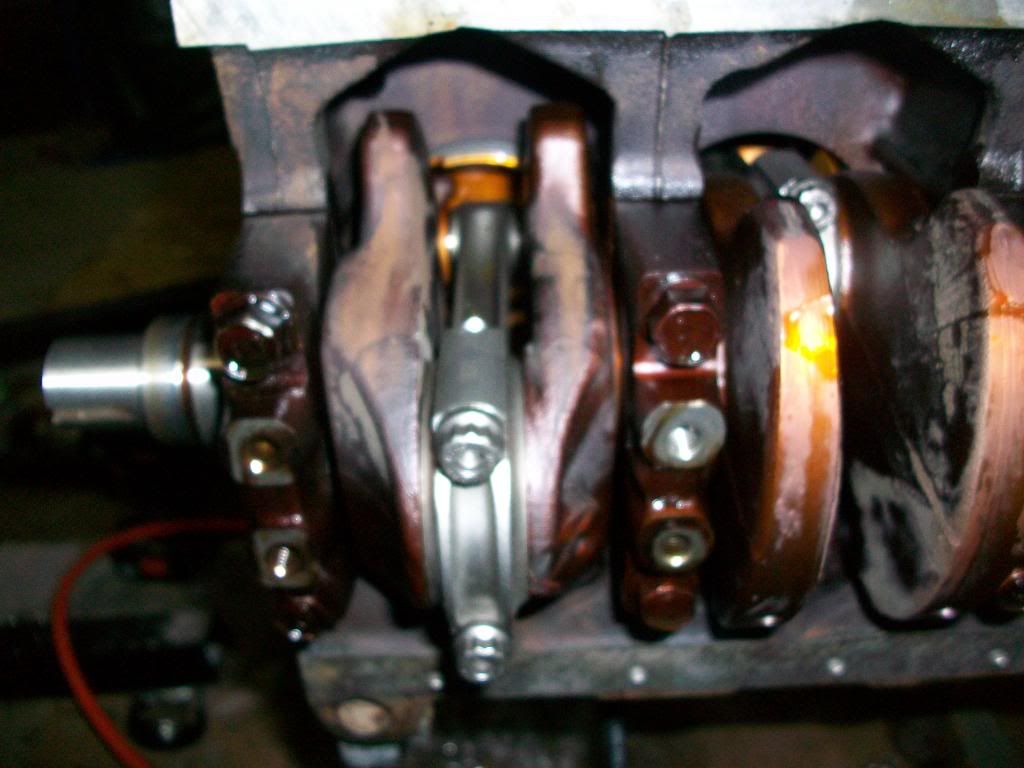

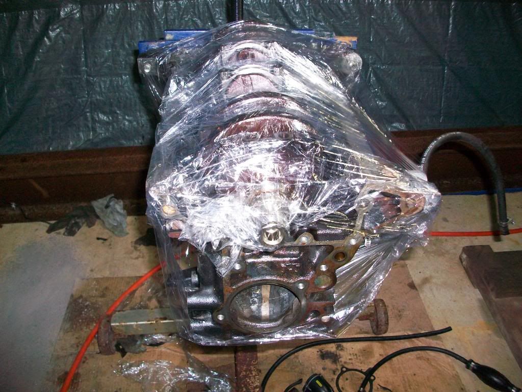

Well, been busy but got some work done today. Picked up the trigger wheel setup from the machine shop/ friend. Guy made it a .002" fit, and heated the trigger wheel then assembled and allowed them to cool, so the metal isn't damaged by pressing them together, but once they're the same temp it's a 2 thousands interference fit. And he did a baller job, got the assembly within 2 ten thousands he said.  :noel: For free.  :noel: :noel: :noel: Got a nice tour of his shop too. Dude has some awesome old machines. He also checked the small end of the rods where the wrist pin goes, all four were 0.0009" clearance, which is tight end of spec.
Pics

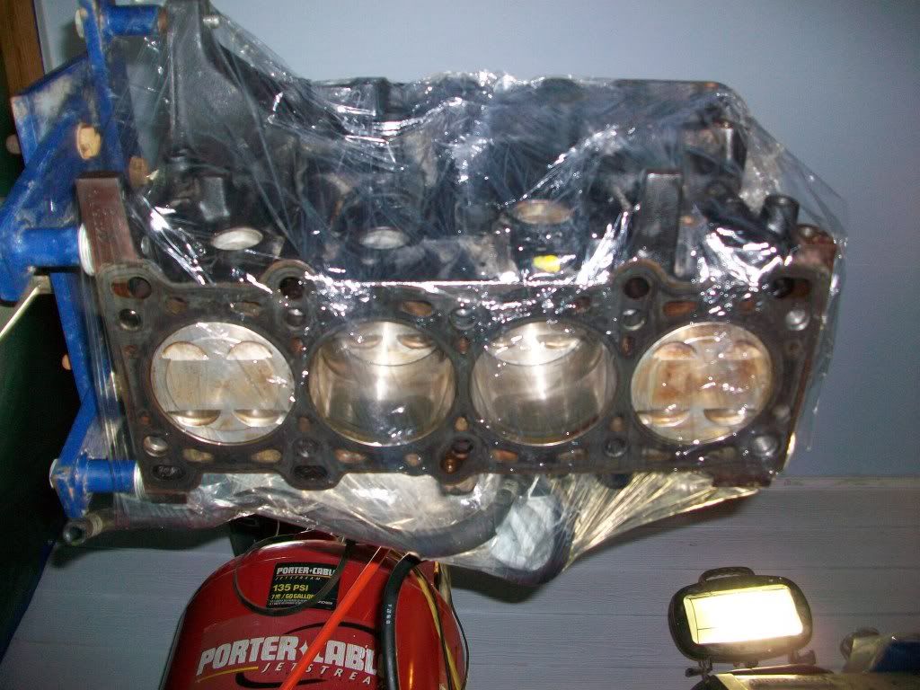

Block cleaned, ready for assembly
Only one problem. No ring compressor and it was 10 PM, all the stores were closed. RHMT ring compressor...
Rotating assembly is finished. Looking like I'll have a built motor assembled and running for <500 bucks.  :yes:

« Reply #86 on: December 26, 2009, 05:47:16 PM »
Looks good, but your picture taking sucks. Use a shop light and turn off the flash.
Those rods are almost as wide as the big ends  :-X

For a RHMT ring compressor I used a wide 3" worm gear camp. :yes:
Re: Shit
« Reply #88 on: December 26, 2009, 06:26:46 PM »
I just spoke to Pat on the phone, dude's geared up and ready to go.
Re: Shit
« Reply #89 on: December 27, 2009, 12:39:41 AM »
I thought about using a hose clamp to compress the rings, but couldn't find one the right size to work, then saw the pipe tape stuff and just used it to do the rings. Only took a few minutes to do all four so it wasn't bad. Camera sucks, so do my picture taking skilz.
