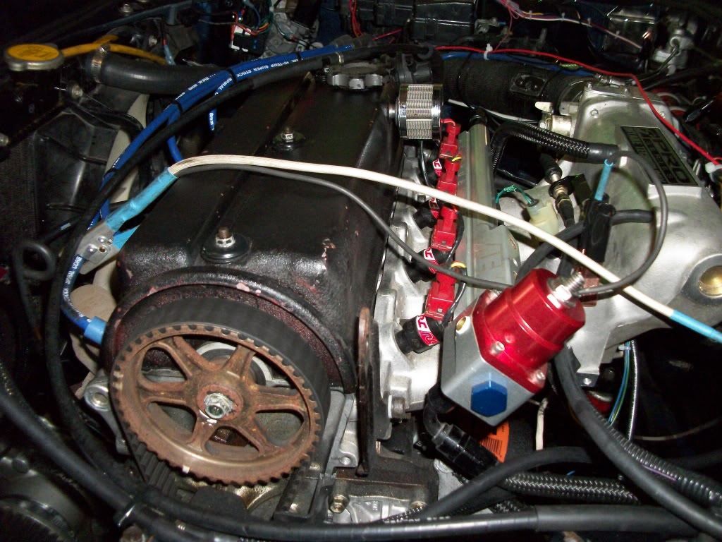

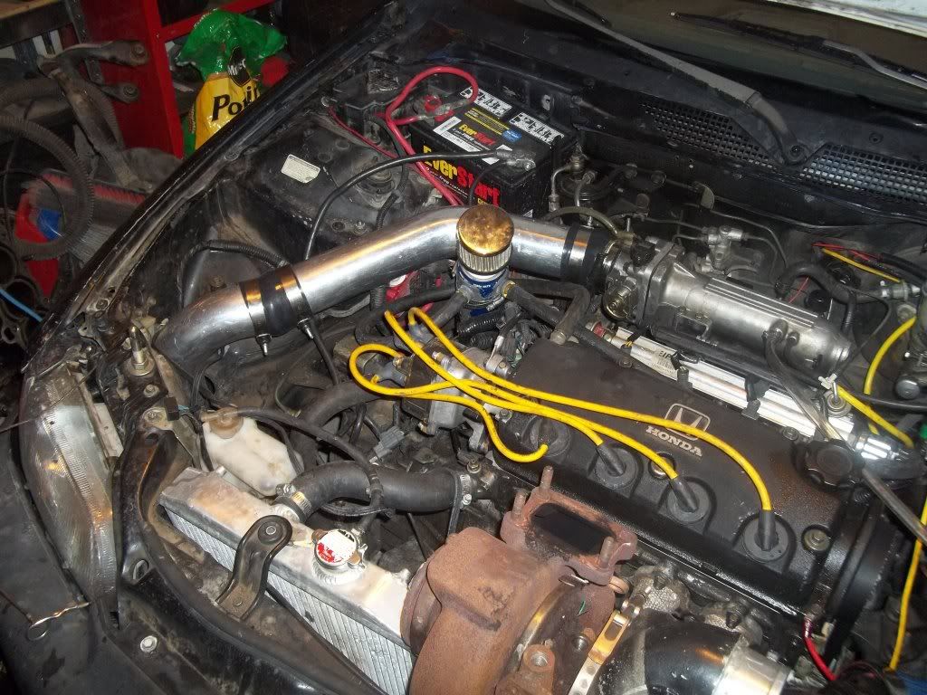

This one, although fuzzy, is the location where I put the adapter for the oil line for the oil pressure gauge.
Valve cover modified for a 1/2 nipple and 3/8" NPT. I just used a drill bit slightly larger than the original hole.
Then drill progressively larger holes until I reach the size I want.
Also if you look in the back ground, on the white-board,  you can see the original idea for placement of the s/c, turbo, intercooler(s), and piping.  Not a workable setup.
These are attempted shots of the catch can I made using a Foster's oil can.
This shot is of the top of the catch can where i just cut the opening on top just big enough to twist the breather filter on. ;D
I may just paint the can black except a small area to show off the brand of beer. ;D
And maybe even leave the chrome unpainted on top of the filter for Levi to have something shiny to stare at. ;D

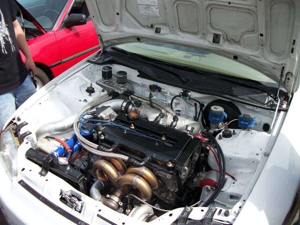

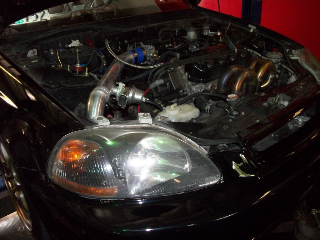

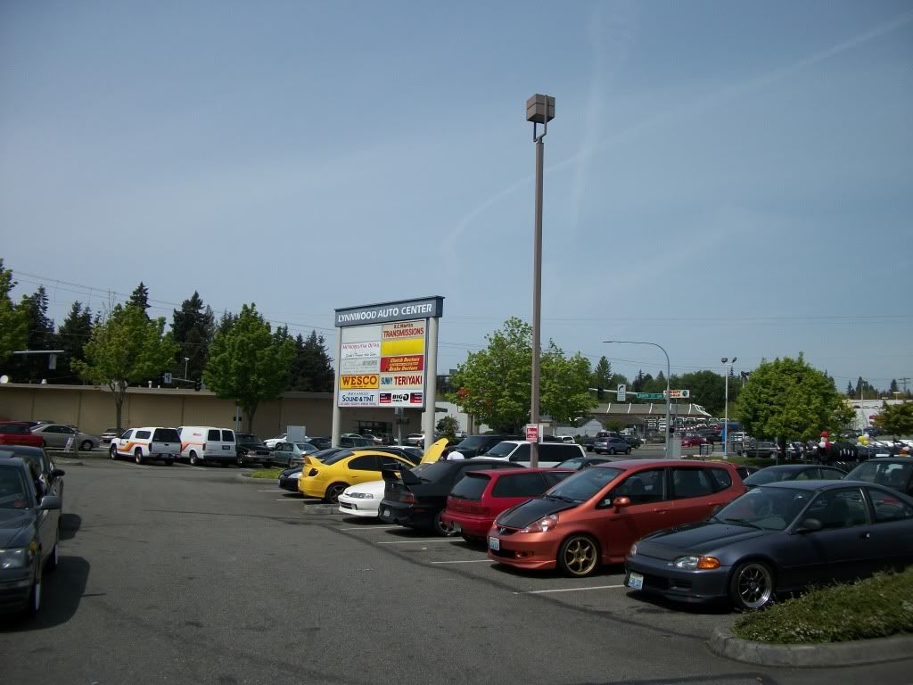

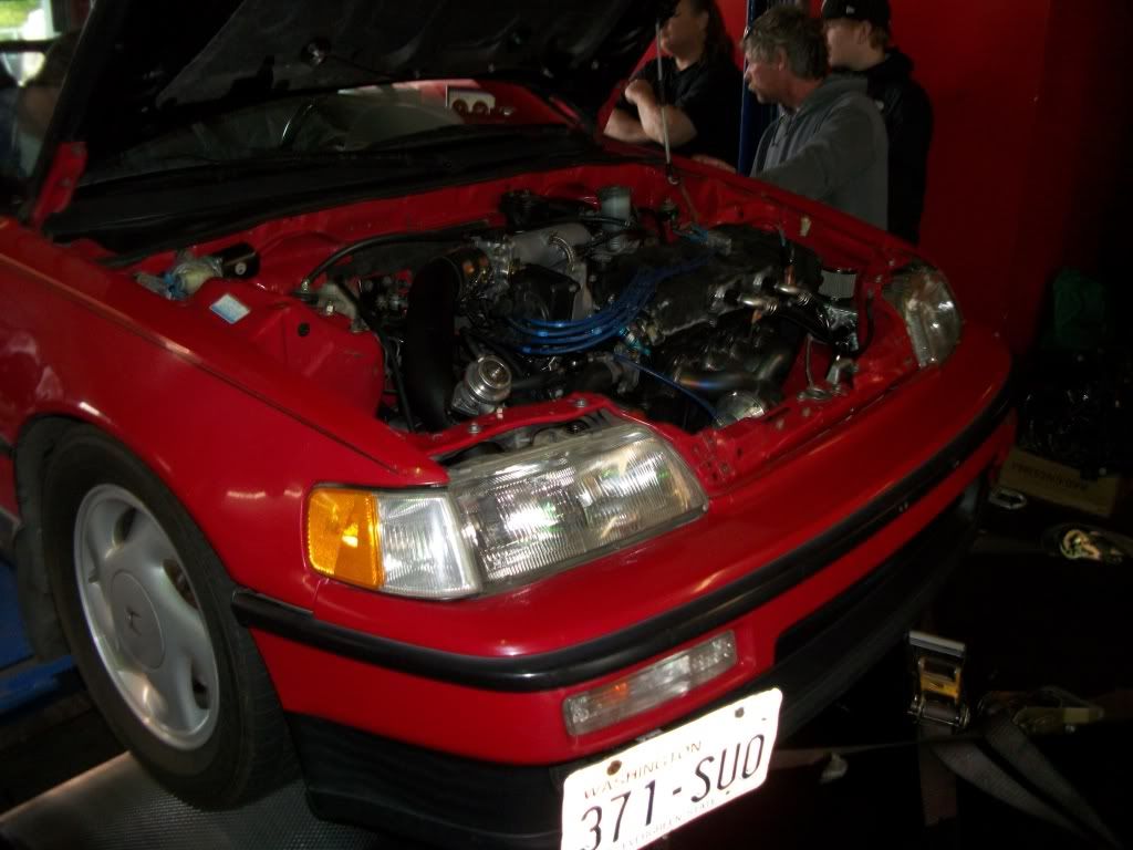

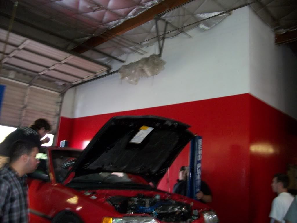

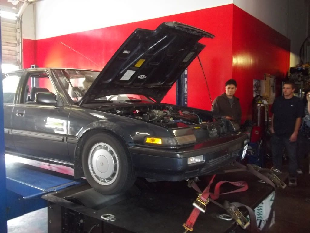

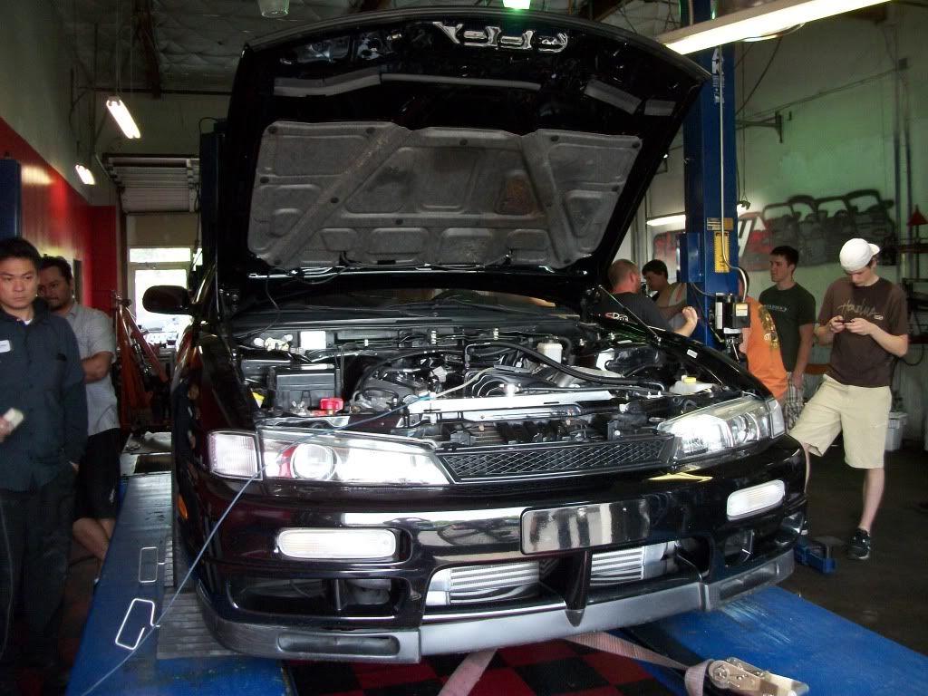

PNW Dyno Day Picts. '10 in no particular order.
[imghttp://i653.photobucket.com/albums/uu254/92CXyD/100_0140.jpg]http://[/img]

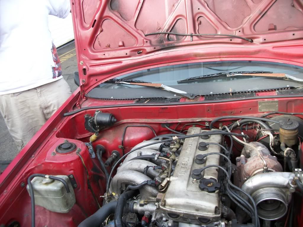

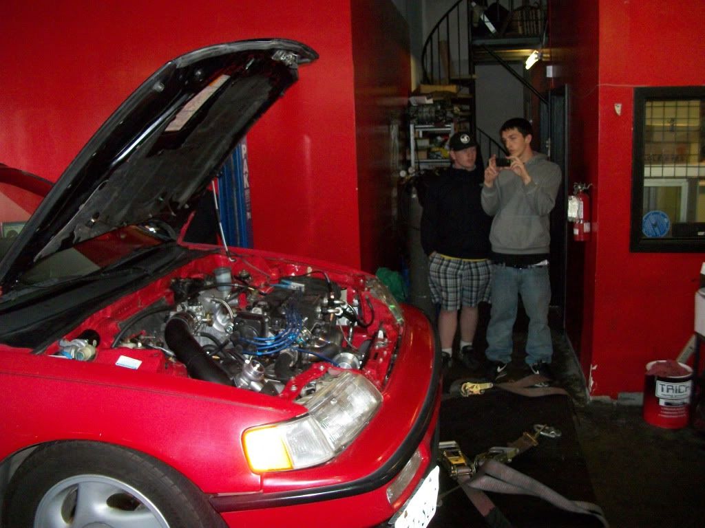

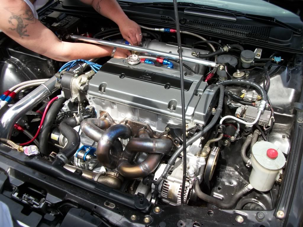

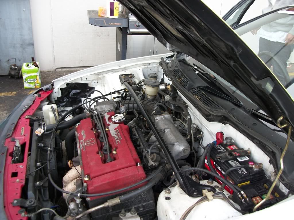

My favorite build car there at the '10 Dyno day, 86-89 Accord w/ A20a3, K-series pistons, B18 h-beams rods, Skunkworks CTR/ITR intake and MS2. The kid is 17yrs. old and he did all of it himself.
Spiker his old Fluffy size and the Blackest Man on the West Coast (Leed)

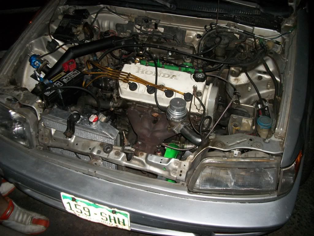

Ok after my failure at '10 Dyno day.
I originally was going to send my engine up to Random Hero and get a Pro built.
But I got encouraged by my local Hondaphile Twisted Image (Chad) to take my car to Bandimere in Aug. '10
So I worked on my car all week before at his shop.
Pulled the engine took the bottom end apart and put in a reman. crank.
The Fri.  night before Bandi. I had trouble getting the car started so I said screw it I'll go w/o.

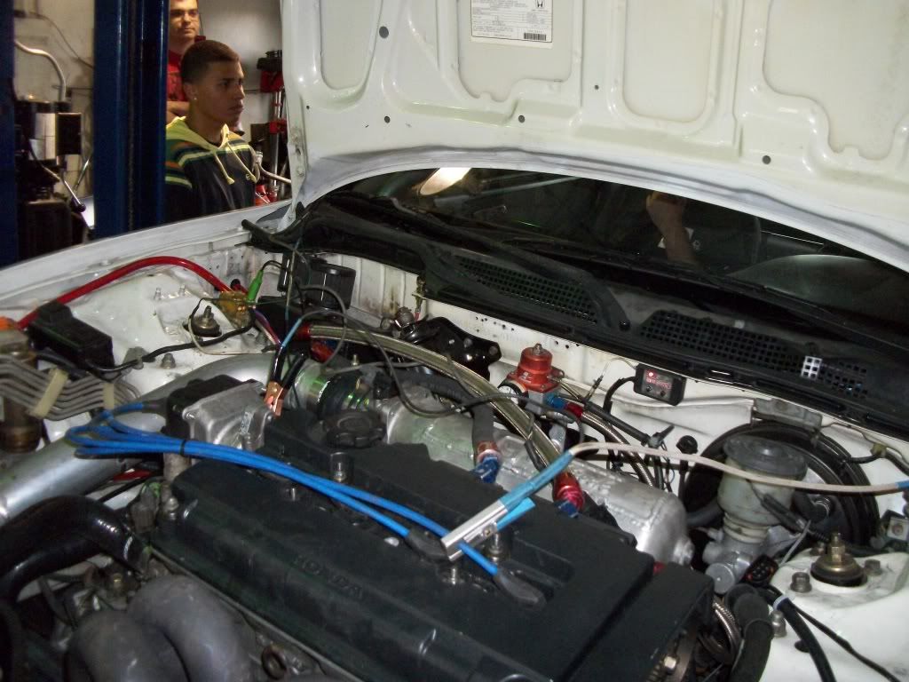

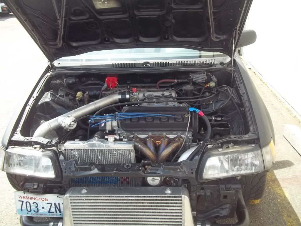

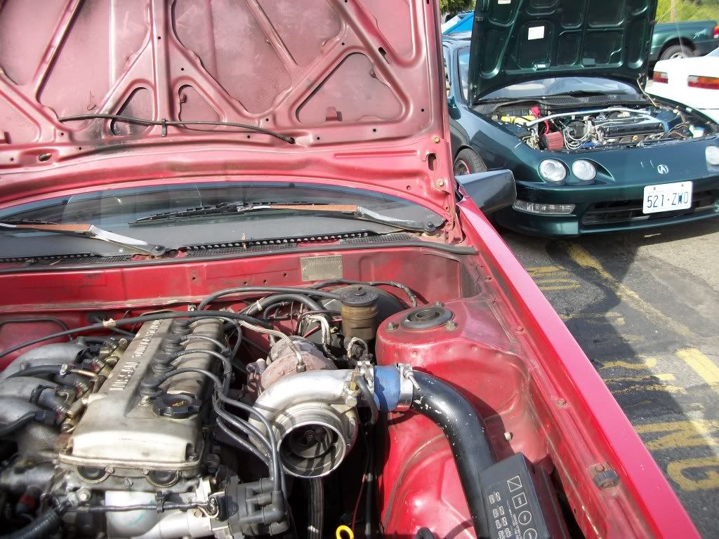

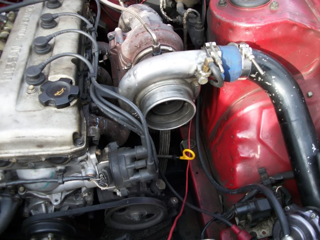

Get to Denver and Yuri (BoostedSchemes) and Matt (SOHCKLR657) talked me in getting my car down there and finsh getting it running.
More info. on how Yuri got there checkout this thread http://www.realhomemadeturbo.com/forum/index.php?topic=15220.0
While I waited for my car to be towed down to Denver for me.
I was checking out Matt's setup
Matt showing his Extra Fluffy pose
To Levi (UI) with love from Matt
At the track @ Bandi. RHMT represent.
I do not have picts. of my car at the track.
We did not tack it of the trailer because I could not keep the car running.
Got it back home and found the engine ground was not tightened down, and heater core hose connection was leaking really bad.

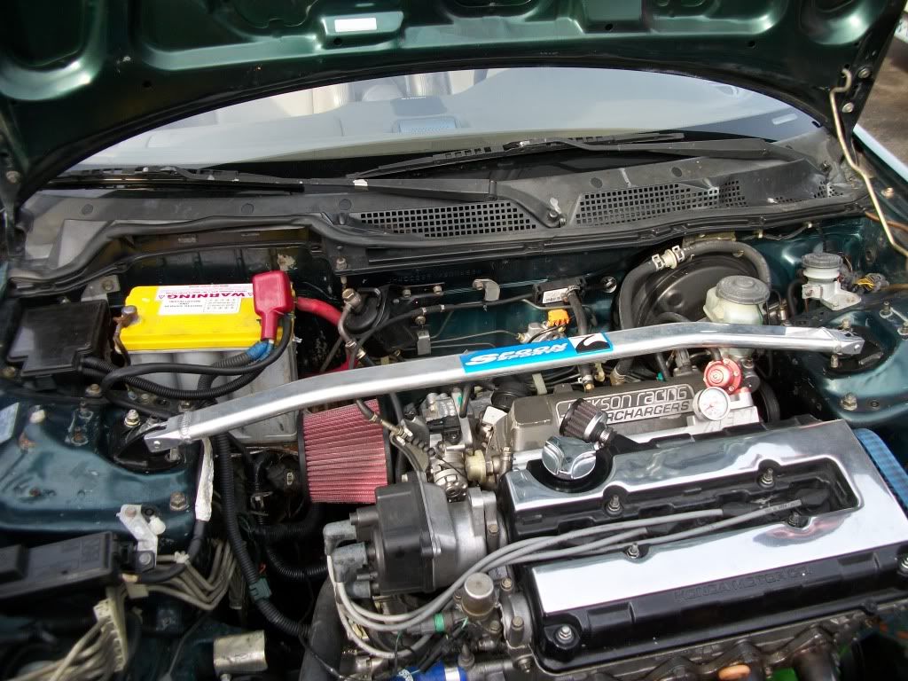

I have been working on my car since I got back from Denver.
Damn electrical Gremlins.
Found 2 ground issues, 1 bat. to power dist. box issue, and AEM WB gauge took a shit.
I've had to replace the ign. coil and igniter.
I'm moving my mechanical oil gauge to where the AEM WB was.
Installing my new 14point7 SLC the week of 9-26-10
I have to replace the heater core in the near future or winter is go to suck for me.
Then back to tuning.

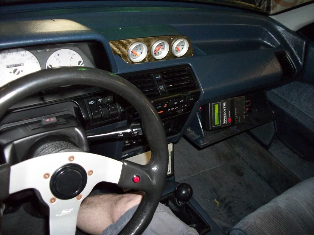

And Now Installation How-to of my 14point7 Pure Plus SLC
First read the instructions.
Look at your power (4pin w/ Orange, Red, Black, Brown wire) connector and figure where you want to get your 12v power and ground.
I used this Diagram
Hook up the red to the constant hot when key on
Put the fuses in the holders make sure you use the right size to the circuit based on the instructions.
Also make sure the spring tension in the holders are good.
I had to modify mine to get good contacts or I would lose voltage intermittently.
Now hook up the 6pin connector and route through the firewall to hook up to WB O2.
BTW the replacement O2 is  Bosch p/n 14017 approx. $55 locally.

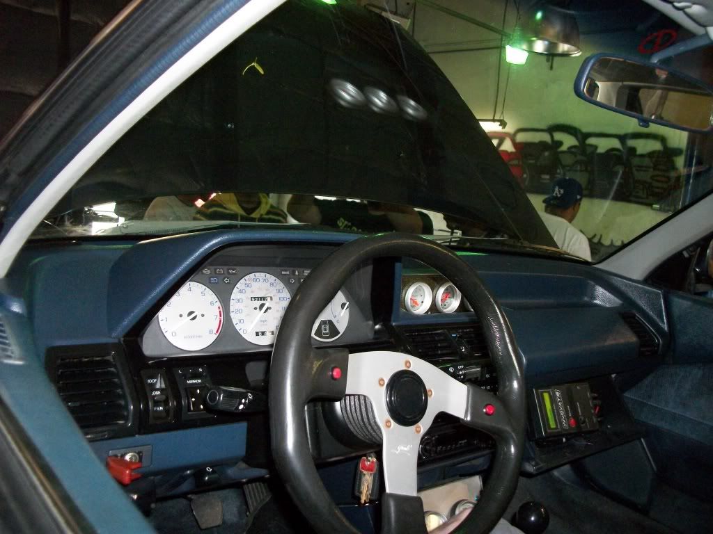

The Display has been moved to where the clock would be in the dash in March '11. (idea from Apex.)
Figure out where you want the display.
After everything is hooked up.
The display should look like this.
Then load up the SLC program on your lappy.
And open up the program.

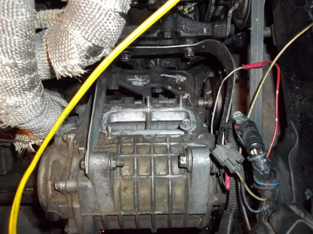

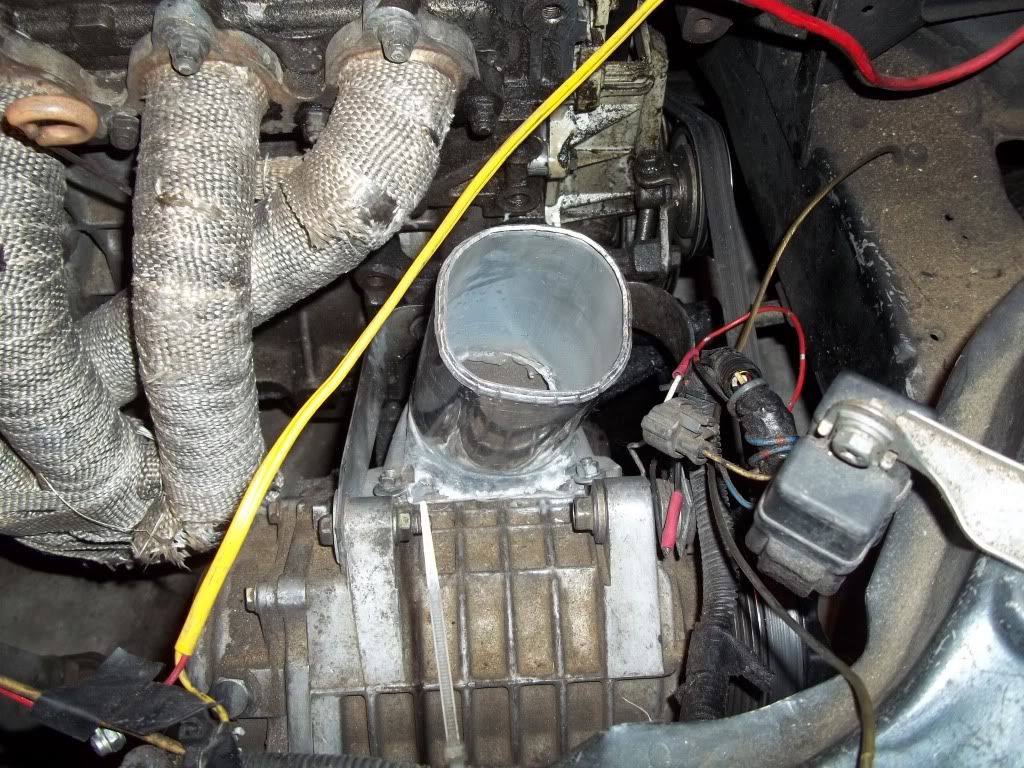

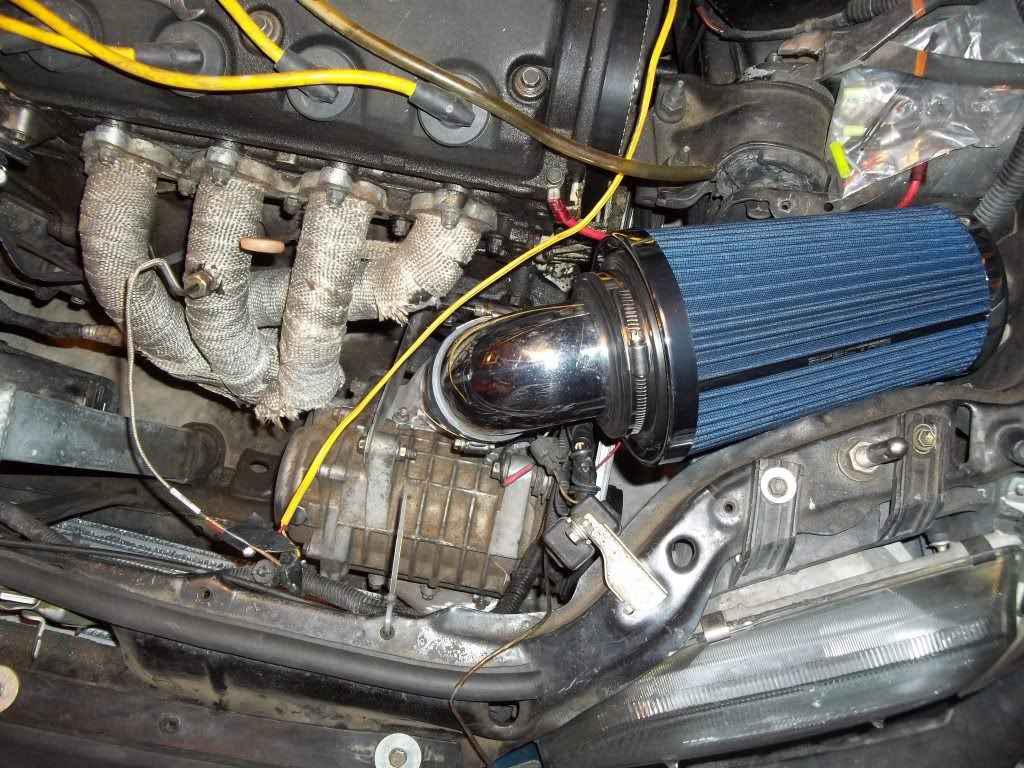

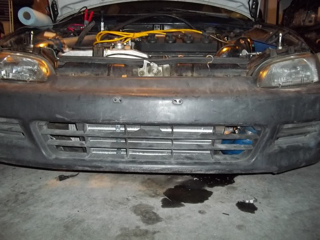

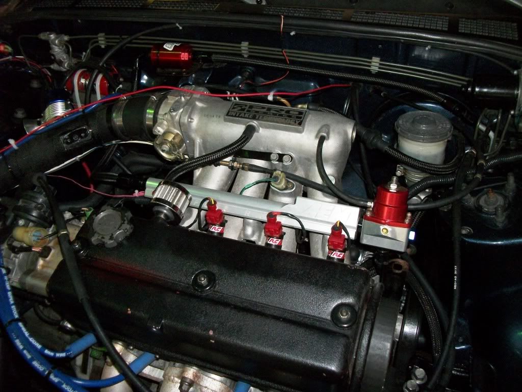

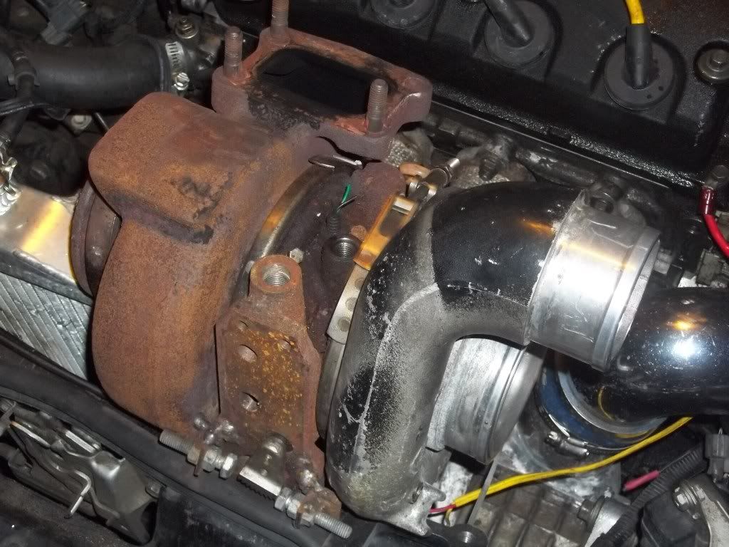

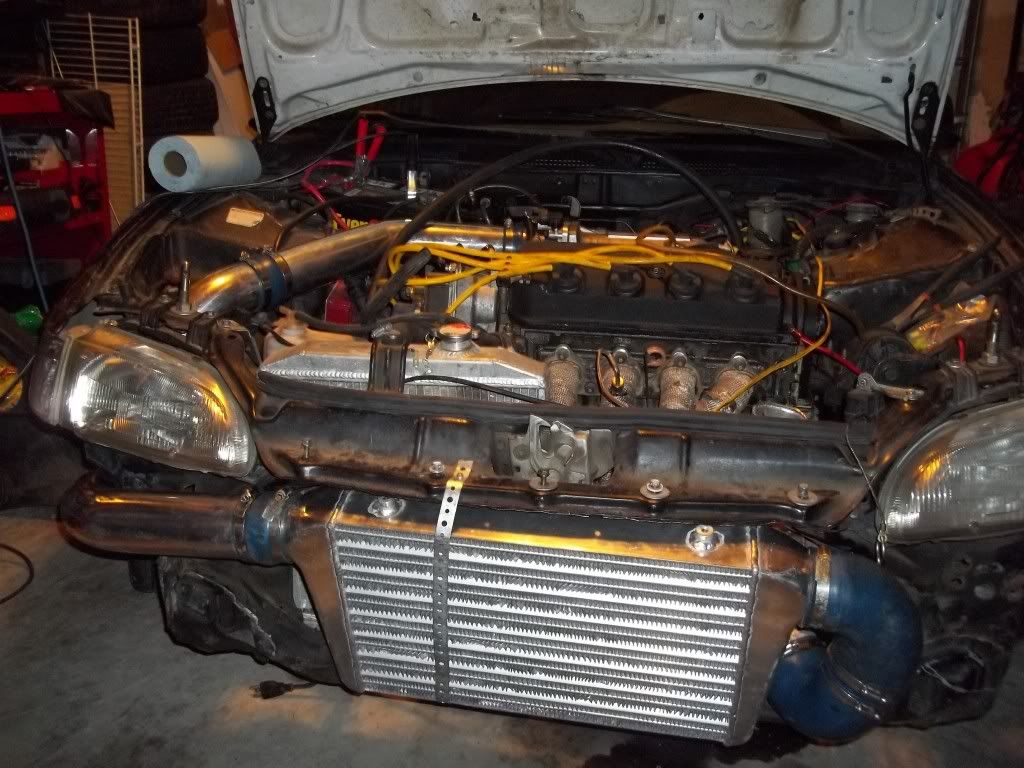

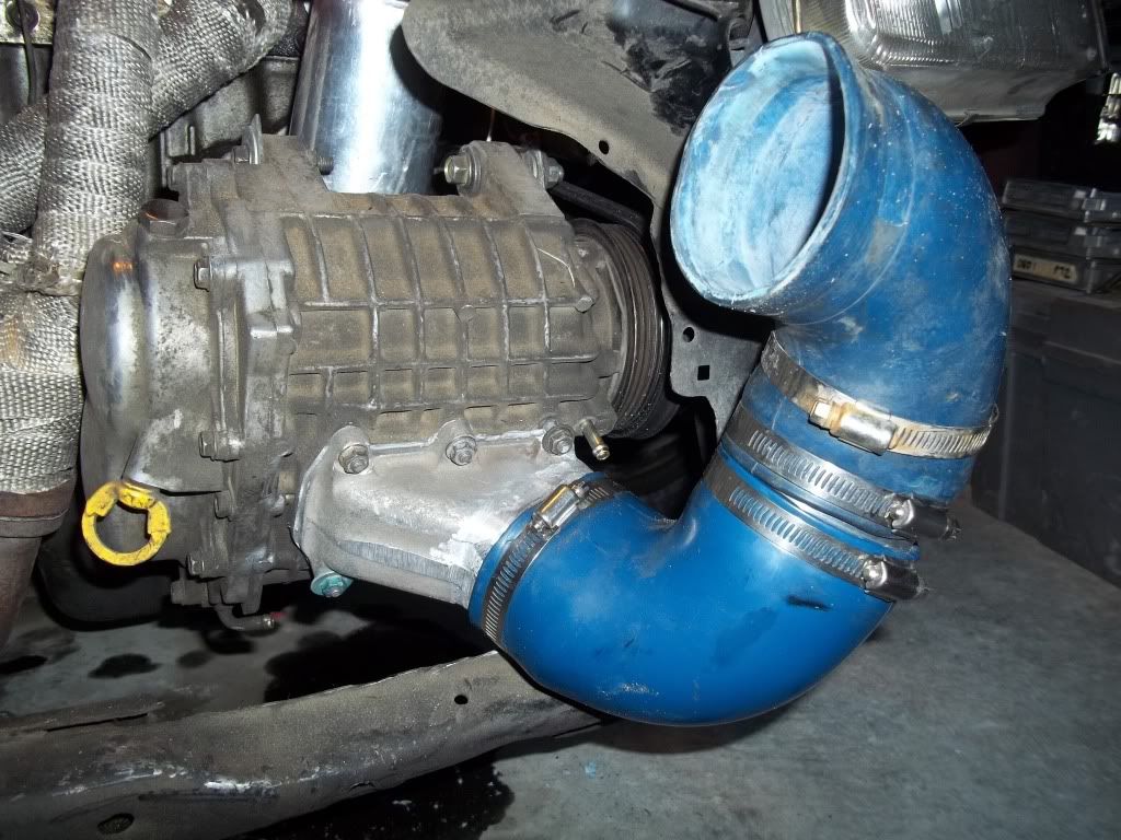

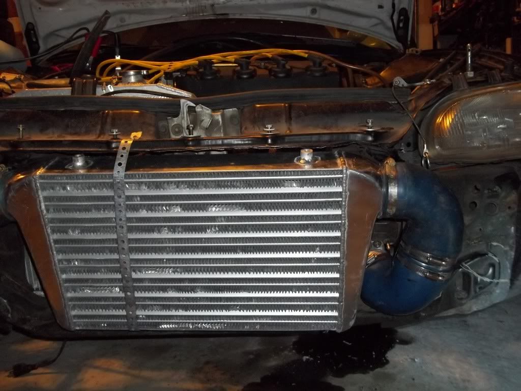

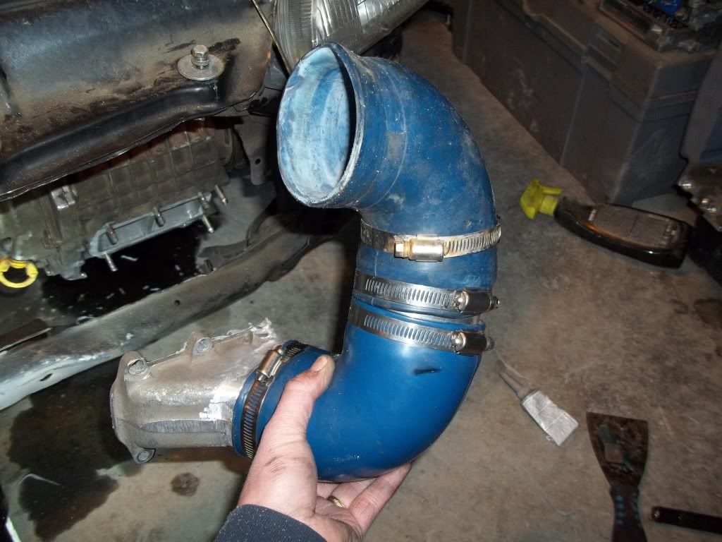

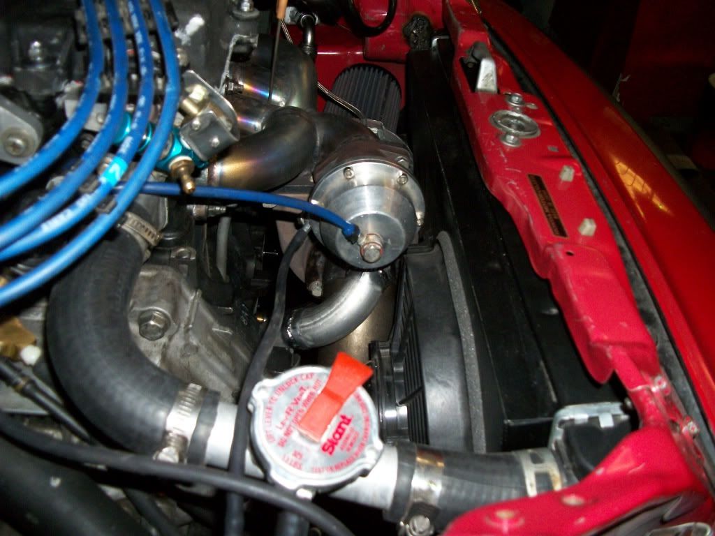

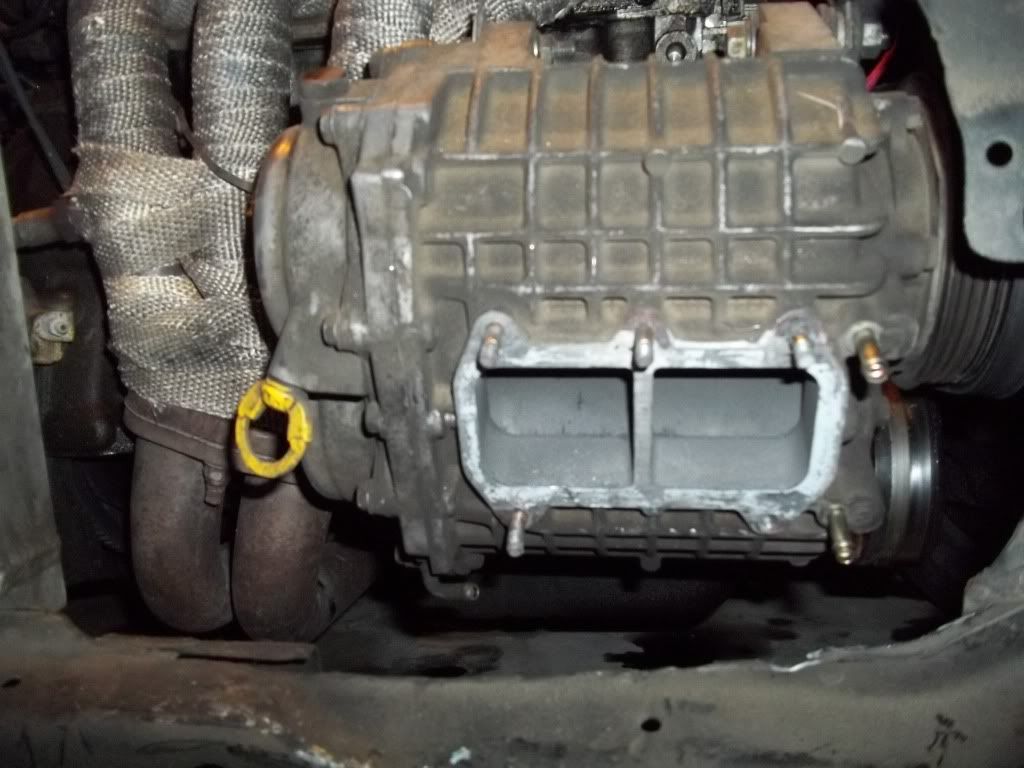

Now some picts before and after installing the 3" IC piping and new manifolds to S/C
Before manifold update.
After update
With new Intercooler

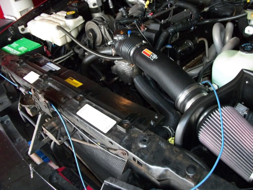

New filter
Tucked behind bumper

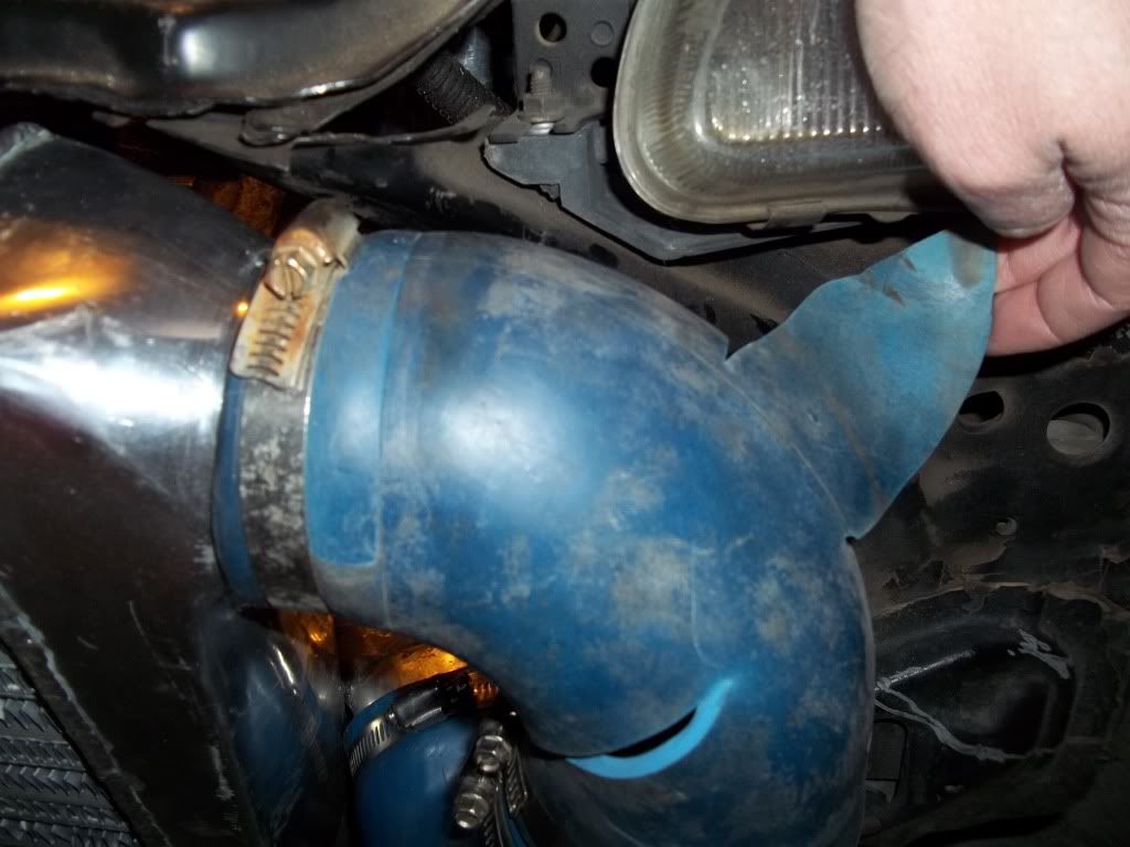

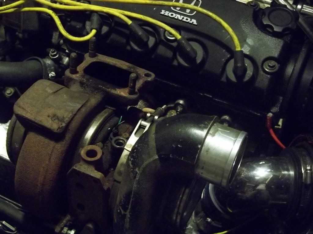

This is what happens when you use shitty couplers.
Bought all new black 4ply couplers and t-bolts.
So no more boost leaks and couplers bursting.

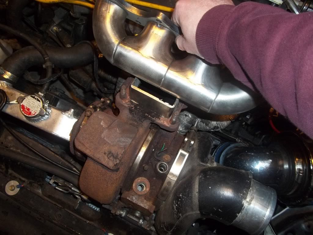

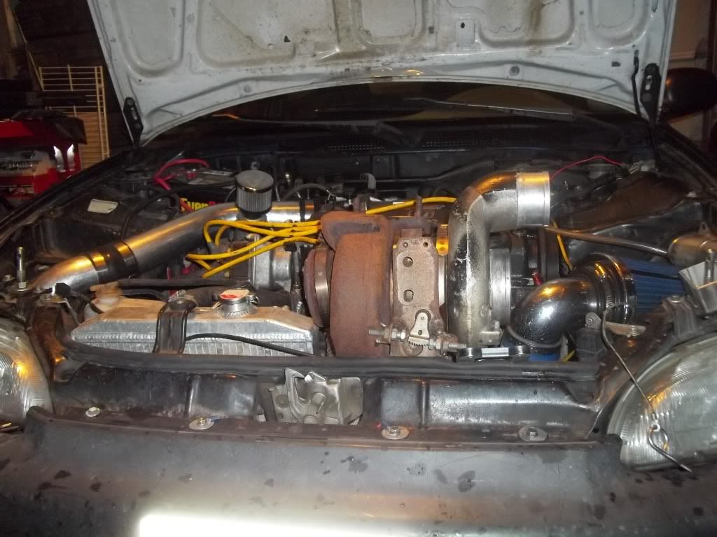

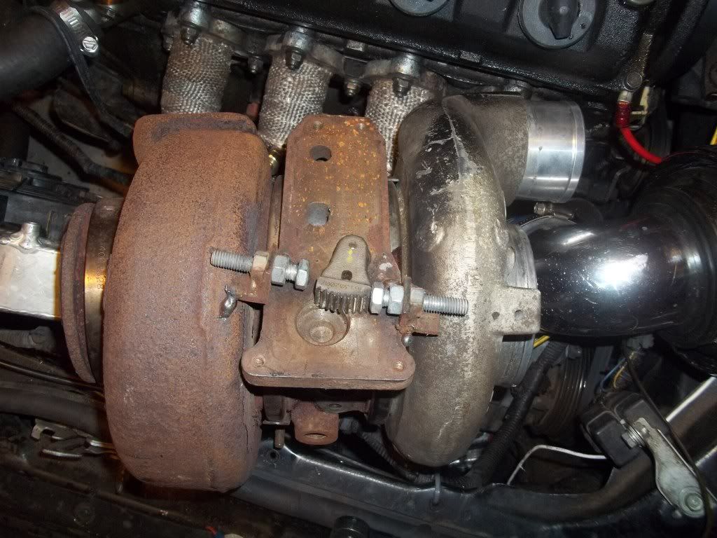

Finally got my HE351ve, already modified the way wanted.
Quick look at the room needed to get this beast in.
« Last Edit: October 16, 2011, 03:14:29 PM by 92CXyD »
I went to The '11 PNW RHMT fluffy Crew Dyno Day Meet.
Met up with Trevor (Daspoop) in Billings at a gas station.
I drive up and he new my car right off and said your leaking a lot water.
I looked at the leak and it was fuel.
I had installed a CDM FPR because I kept overpowering the stock FPR and pressures would shoot to 200psi.
I used the supplied hose from rail to FPR. it crack and leaked a lot of fuel.
We went to a parts store in Billings and got a new Fuel Injection Hose.
Fixed it and we drove around Billings a bit and found my alternator was making noise.
I had replaced it with a good one, since I saw too much voltage swings.
Noticed the bottom pivot bolt fell out so back to the parts store.

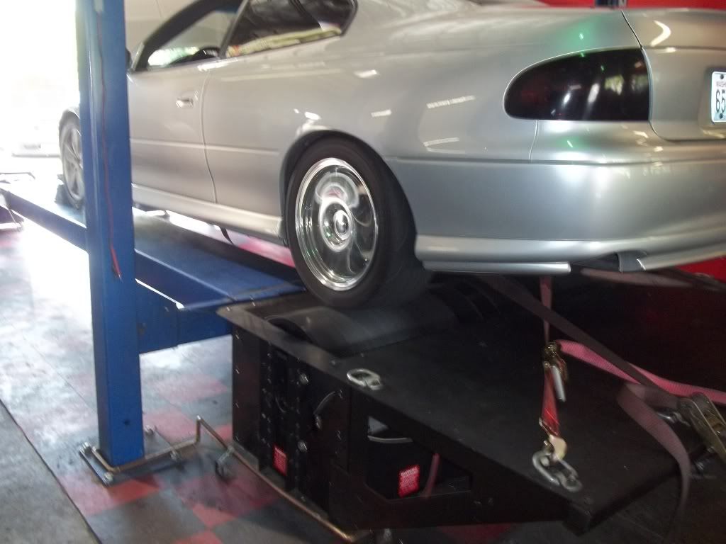

'11 Dyno picts.
Adam's (Mandrel-Bends) baller M5
My Dyno vids at 7psi an 7k max and no vtec engauged. The S/C belt kept getting shredded or thrown.
Later found one of the lower mounting for the S/C cam loose and fell out.
More Dyno vids
Spiker trying to hold 88DX's car (I think)
Antics at SPiker's garage. Look out Canadian with an assault rifle.

I took all of the s/c setup off so I can finally start straightening the nose of car up a bit.
