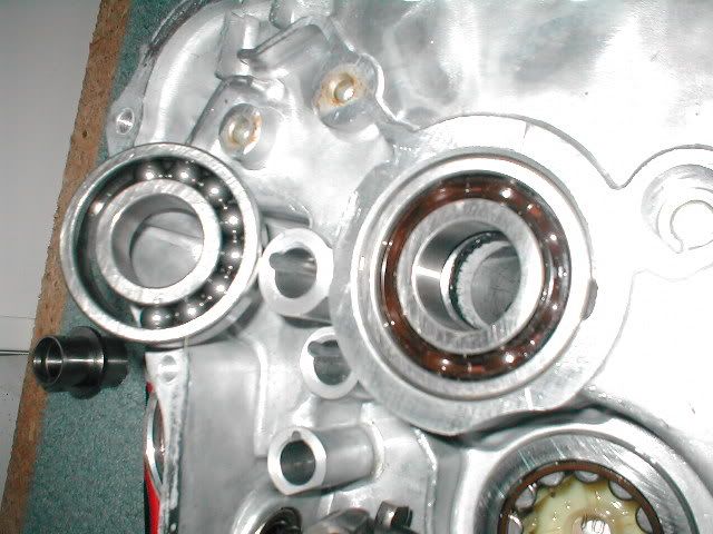

I did what Mista Bones said to do.
I reinstalled the ISB in the correct position.

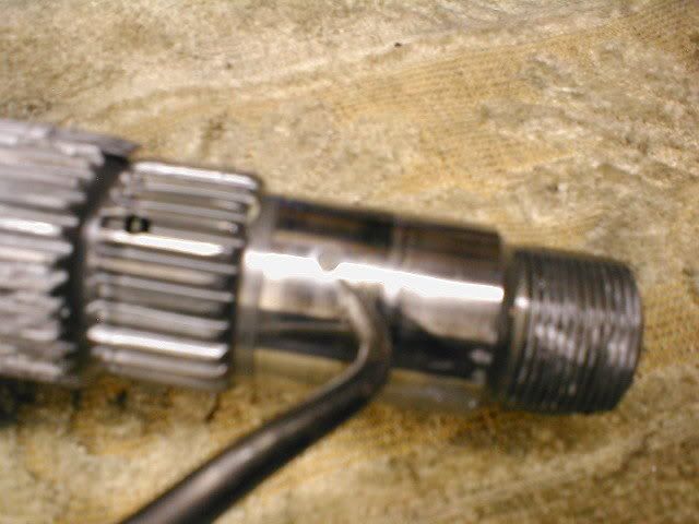

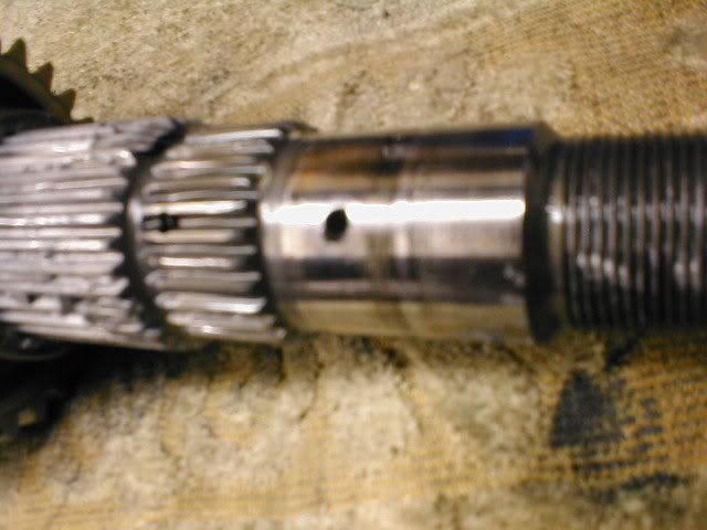

I staked the CSB after flushing out all the nylon bearing cage pieces trapped under the plastic under the CSB.
Then I stripped the shafts and cleaned all the oil passages. (there was a lot of nylon bearing cages pieces in those passages)
Then I put everything back together, I laid a smaller bead of silicone on the clutch housing, then I proceed to put the transmission casing back on.
I get within 1/8" of the snap ring seating in the groove of the ball bearing assembly on top of the CS with ring going around the bearing.
Then I use the casing to clutch housing bolts to pull the casing done to seat the snap ring in the groove  and  the bolts are almost seated.
I hear a sharp snap and decided to pull the casing back off and find this:
Part of the outer race is broke off.   :'(
So I have another bearing to be here tomorrow and try this all over again.
I was wondering do I have to have the transmission in any particular gear?
I did not see anything about needing it in neutral when getting the casing back on.
Any more tips out there guys before I do this again tomorrow?

NEVER pull the case down, now you see why.
You failed to fully expand the lock ring.
Have fun getting the old one out and new on in.
With snap ring expanded and case slid on there should be a .008-.010" gap between the cases.

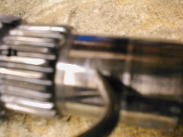

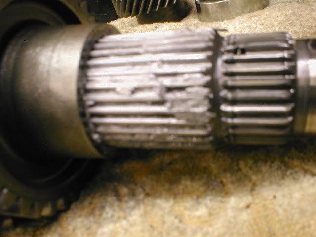

We found that the shaft that has shift forks, closest to the differential, keeps jamming in the casing.
So we are looking at my spare casing if it would work better.

Yeah everything is cool I had a shift fork and sincro sticking causing the shaft for the mainshaft forks to sit higher than they should.
Replace the sincro and selector and now everything is golden. ;D
