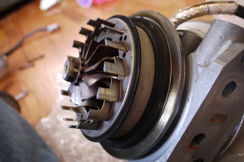

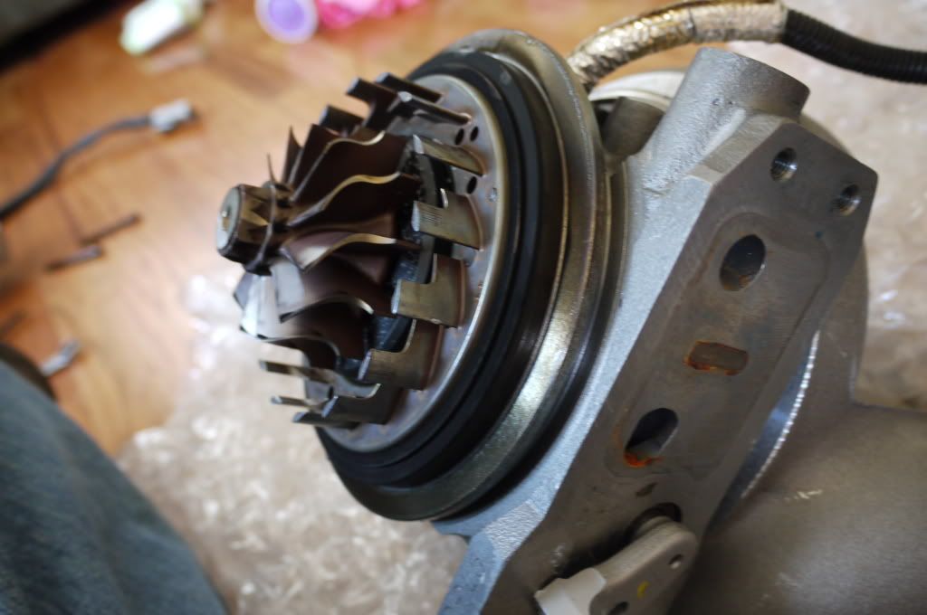

Alright I have turbo on with the radiator support clearance and the hood barely shuts.  :noel:
To get the He351ve to fit, I had to cut the mounting ear on the S/C not being used.
Ground for clearance
More grounding for clearance
Had to replace the mounting studs
Lucky I had this coupler going from 2.5" to 3.0 90deg, had to shorten it on the turbo side.
This where I'm at until tomorrow :noel:
Already ran the oil drain, not pictured here.
Next I'll work on the radiator and ducting setup.
Then finish 3" exhaust from turbo to resonator.
Ordered a turbo blanket and 50' of 1" wide header wrap, should see that this week.  :noel:

I bet grinding that off the housing took forever.

$5 says you warped the turbo housing with the grinding heat. ;DDD Fuck that must have been either a big grinder, or one that's now burnt out.

If ya talking about the turbine housing, I used an industrial grinding wheel at the foundry I work at.  :noel:
