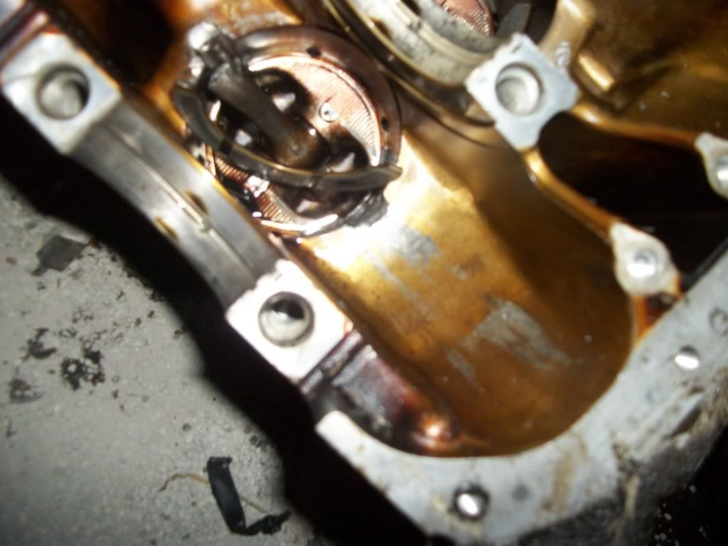

I drove this setup for 4 month with very little problems. Until I lost rod #4.

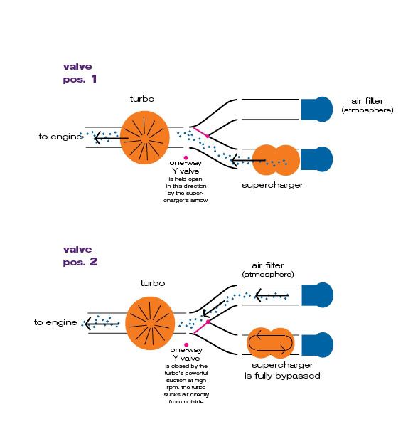

About the Twin setup.
There's a smart easy way to do it totally mechanic in which the transition from Sc to turbo is smooth and does not create problems. It's done with a "Y" one-way valve.
Once the turbo's pressure starts to overpower the SC's output, the valve gradually flips until it closes off the SC; at which point the SC bypass valve kicks in, and the SC is not absorbing energy anymore,since it's not compressing air.
And when you let off and the turbo fades, the SC (it's still there, spinning) pushes open the swing valve, the bypass automatically closes and the SC it starts compressing air and its boost flows to the engine.
And so on....
This is the system that was developed in the rally Lancia S4: they kept having trouble in the transition, so they went mechanical and it proved perfect.
For this system you need a bypass on the SC and one after the turbo. It works fine whether you have SC feeding the Turbo or viceversa, you just need to do the plumbing right.
« Last Edit: March 27, 2009, 03:06:03 PM by robus »
robus
  • Posts: 316
Re: My D16z6 w/ SC14 Suphercharger. Lots of Pictures and Long write-up
« Reply #16 on: March 27, 2009, 03:04:52 PM »
In other words the nice thing of this system is that you don't have to guesss, switch at 5k or at X psi, and then it's not smooth and the boost drops or the car bogs.
With the mechanical valve the boost grows and gradually and automatically switches on and off the SC. Also this way it's much easier to mate a large turbo to the SC.

If you get your pulleys and boost setting right, you can get manifold absolute pressure > pre-turbine absolute pressure. Then you can go wild with the cams and dial in huge overlap and make some serious power at high RPMs.
$0.02.
I'm probably going to use just one IC and it will be after both compressors b/c I use the S/C only when I need to aggressively accelerate.
I still have to keep this as a DD so I want to maintain some kind of mileage which I still get 30+mpg in town. :yes:
The turbo part based on two different programs I'm using for modeling I'll have to use a T57 to a T70 type compressor b/c
when sizing I treat the engine and S/C as a total package.
So instead of entering a 85% V.E. at 6k for engine I have to enter 182% to 187% V.E. to size turbo when using the S/C at the same time.
But the tricky part is the S/C turns off and I use a bypass valve(s) I run strictly on the turbo I will I have to use one of these turbos while their spooled up.
In other words the nice thing of this system is that you don't have to guess, switch at 5k or at X psi, and then it's not smooth and the boost drops or the car bogs.
Is there some kind of diagram to explain this being done mechanically?
I'm using DSM 1g BOV as a bypass now but it does not release enough vol. of charged air fast enough so I'm picking up another one.
After I fix the boost leaks on this setup I think I would hitting 12-14psig with spikes of 18-20psig so I will need more vol. to bypass the s/c when I let the throttle go below 50% and the S/C pulley deactivates.
Thanks guy for the ideas keep them coming.
I like fresh thoughts for this project.

If I was to give it a shot, I'd do something like solenoid & throttle body as the bypass, assuming you have to SC->turbo->fmic->engine.
The problem is the SC turning off. Roger McDaniels has proof, not a guess, that an SC takes less power to turn than the power steering pump when it freewheels, meaning fully bypassed. I'd run it SC->turbo->fmic->engine, then just have a LARGE bypass between the SC & turbo. When the bypass opens, the SC is just moving air, not compressing it.
In short, the SC clutch is ONLY useful with a good working bypass. If you could make an MS PAINT version of your idea, then I could understand it & help out.
I'll try to MSPaint when I get home but I'm good at it.
I may just draw it out on some Engineerin Comp. paper and take a picture instead.

If I were you though, I'd pulley the SC to make say 12 PSI. Then air goes:
airfilter>bigfuckingturbo>small 60%+ efficient IC>inlet of SC> out of SC> big fucking IC> engine.
The turbo's WG would be referenced to the turbo's outlet such that it maintains a certain pressure pre-SC. Then let the SC compound this by w/e pressure ratio you pulley it to.
$0.02.
I'm probably going to use just one IC and it will be after both compressors b/c I use the S/C only when I need to aggresively accelerate.
The turbo part part based on two different programs I'm using for modeling I'll have to use a T57 to a T70 type compressor b/c
But the tricky part is the S/C turns off and I use a bypass valve(s) I run strickly on the turbo I wil I have to use one of these turbos while their spooled up.
After I fix the boost leaks on this setup I think I would hitting 12-14psig with spikes of 18-20psig so I will need more vol. to bypass the s/c when I let the trottle go below 50% and the S/C pulley deactivates.
I will have the new engine done by middle Apr.
Yeah. Well, your way will work. My way won't hurt your mileage any more though. And then you wouldn't need any bypass valves either...
Here's what I drew at one time:
I didn't put the BOVs there but they're obvious—one (recirculating) after SC and before the valve, the other between Turbo and TB.
