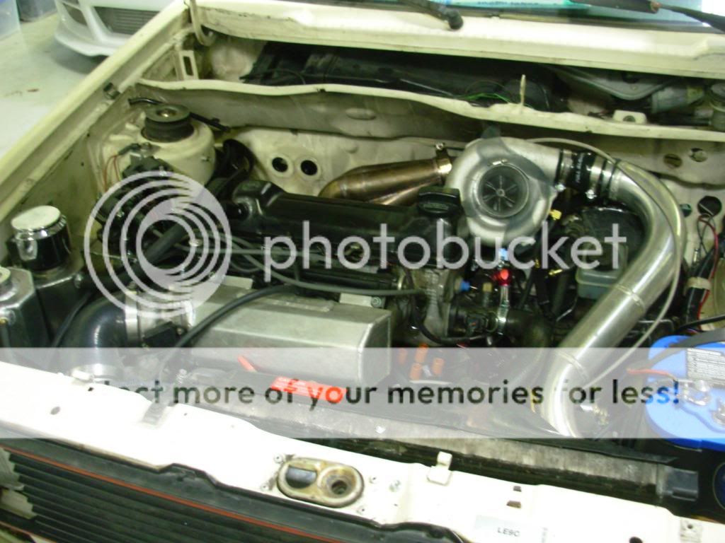

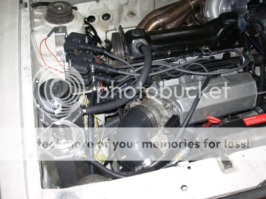

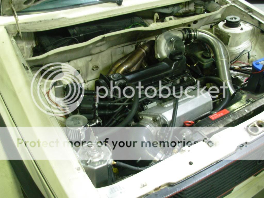

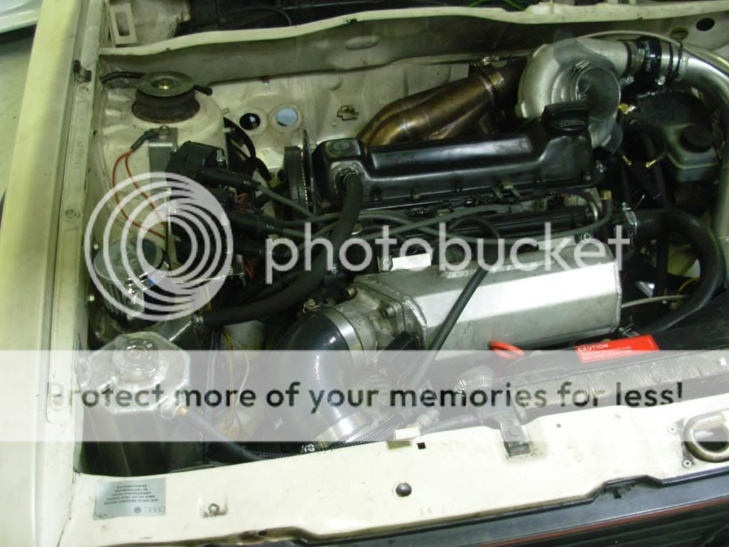

« Reply #83 on: June 13, 2010, 06:52:49 PM »
Re: The super slappynuts attack rabbit.
« Reply #84 on: June 13, 2010, 08:41:53 PM »
Nice, simple, and clean!
DRFT
  • Posts: 9
« Reply #85 on: June 13, 2010, 11:48:02 PM »
thats a tad more angle than the 15 degrees that is reccomended as a max turbo angle.
but it looks like a serious setup. good work
Yes, I agree. Slappy has NO fucking clue how to fab ANYTHING. What a fucking tool...
Go drift in a fire, you faggot. Slappy has more than proven his ability.
« Reply #87 on: June 14, 2010, 10:31:23 AM »
Looks good Slappy. Glad to see it's running. Solid numbers too.
