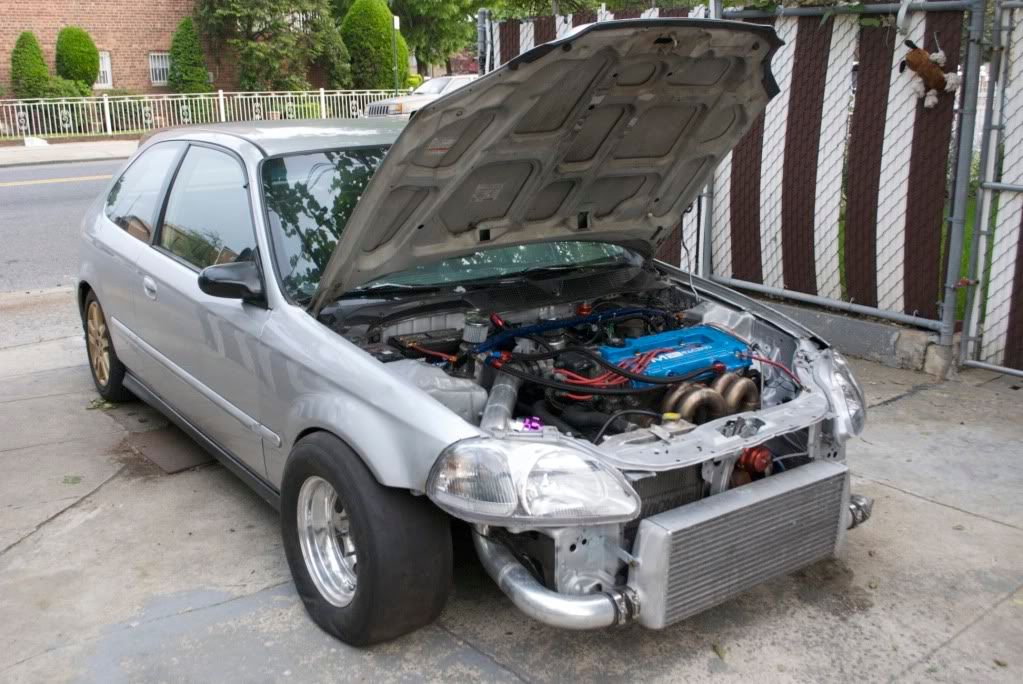

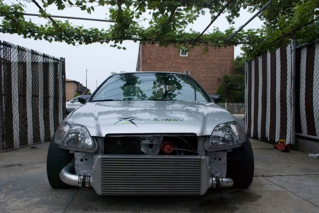

New and FINAL set up!!
Busted my ass for 12 hours changing and cleaning up the car.
the car has been READY and waiting for a damn good day without fucking rain to get some seat time and a goot ET out the car. I have a feeling i'll have to cage the car this weekend  ;D
« Last Edit: June 17, 2009, 03:32:44 PM by Pootie »

the car made 552whp@22psi
and a lil over 600whp@27psi (one more pound b4 i max out the 3 bar)
The car is now on C16 , but still on stock sleeves. Might be switching to E85 soon
« Last Edit: June 17, 2009, 03:48:28 PM by Pootie »

Stock sleeves on the Ls block? If so big ups man. Hope that shit lasts for you. I know some people will push 450 but 600 is nice to see. But for how long? Hope is last all summer. Good luck.
Pootie
  • Posts: 259
yea on the stock Ls block, with 9.7:1 piston and Eagle big bolt rods. Its a freshh build (less than 15 miles, all dyno miles) so i don't see why it wouldn't last as long as i don't abuse it and do something stupid..
the car will be on boost by gear , so it will only see 600whp for a fraction of the run in the higher gears (top of 3rd, and all of 4th).
Out the whole i will be launching at 7500rpm on the 2-step with 15psi.. Its set for 15psi in 2nd and a bit of 3rd.Then 22psi and 27psi in the other gears. (changes will be made once i start to get more seat time and figure out where could use more /less power). I don't want a 12.0 @140mph  car.
 I guess it would be different if i just ran it all out at 600whp.
 Plus this car is only going to make about 20 or so passes this year. By then the sleeved motor will be here. And we will really get to see what this lil stock sleeve bitch can hold!

i would raise that front up more, those slicks are gonna rub bad at the top end of the track and really really bad when you hit the brakes to slow.
