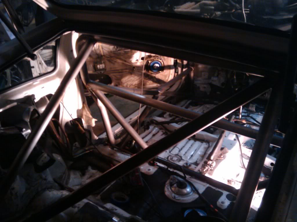

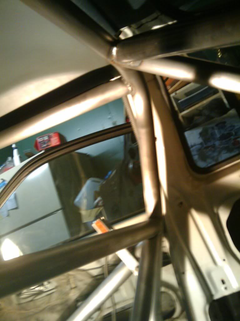

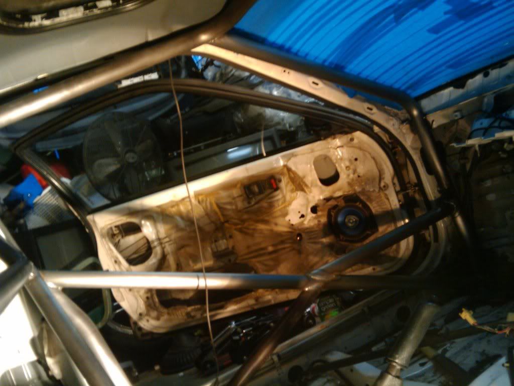

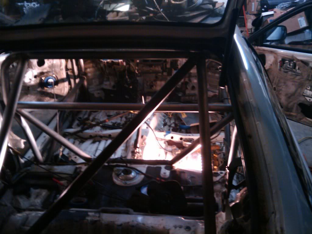

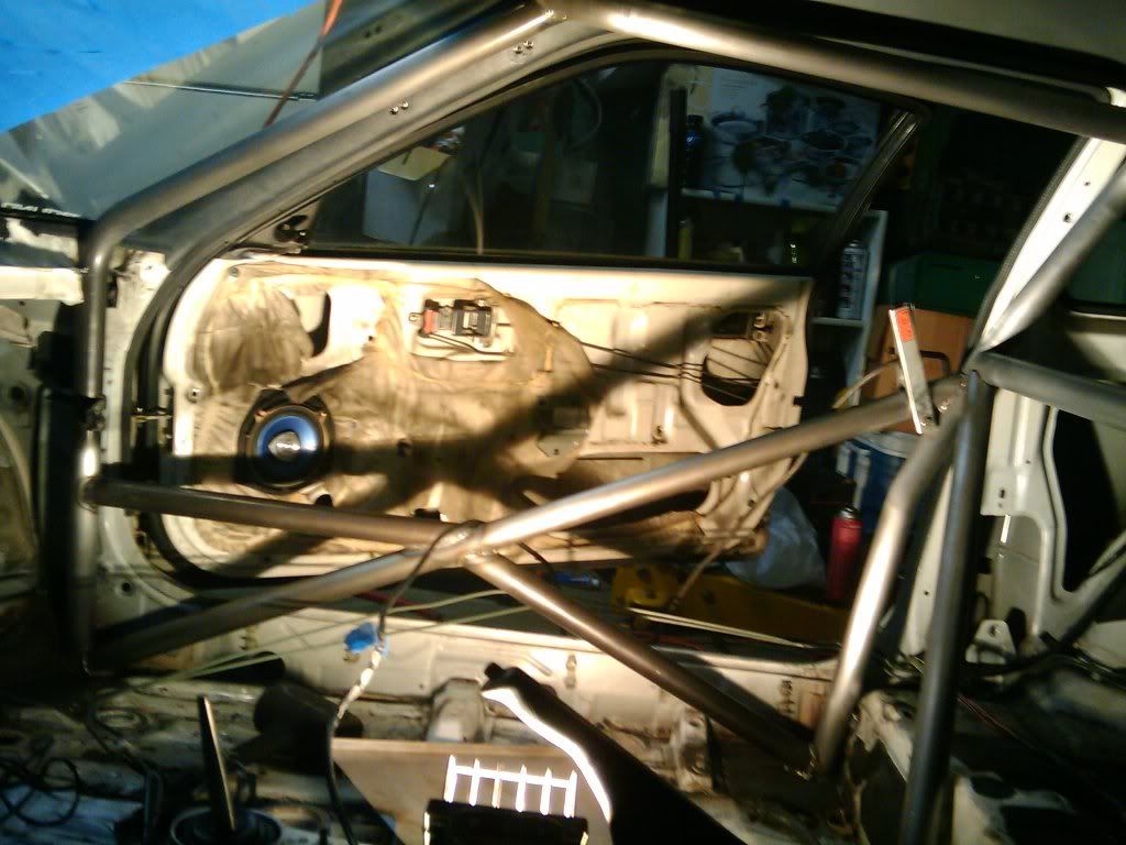

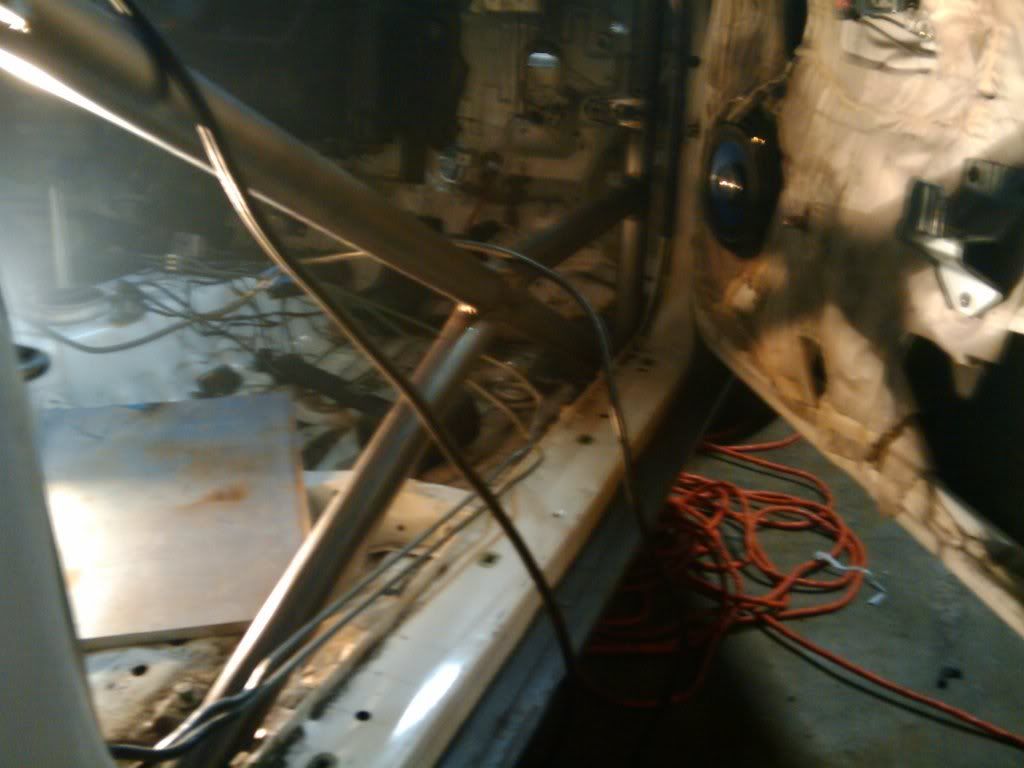

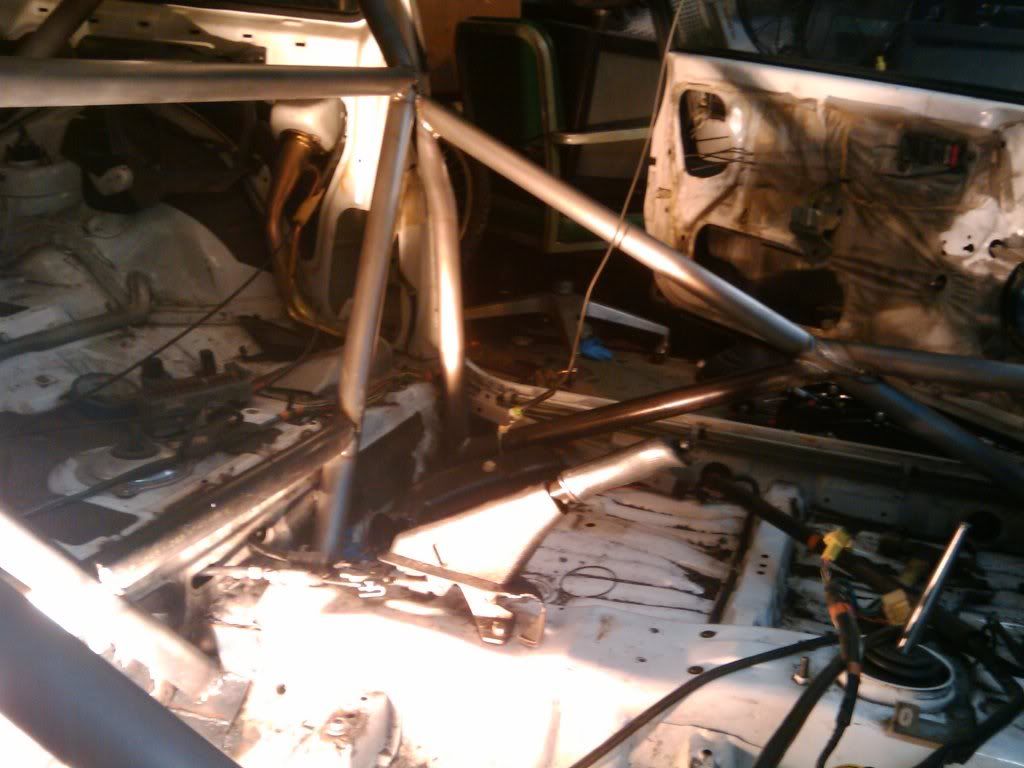

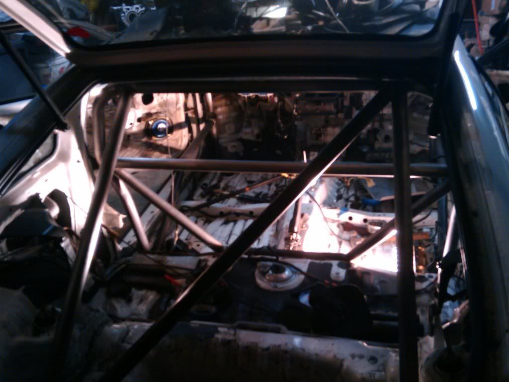

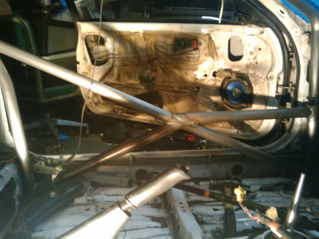

Here's a cage I'm almost done with (Doesn't show all the 1" gussets or the dimple die I'll post those when I'm done/painted)
Its in a 88 HF (1877lbs corner weighted before the cage) Its all chromoly 10PT and goes through the firewall to shock towers
I'll post engine pics in another thread
450whp p/r gsr
gt3076r
Best of all the interior still fits!

The pics are blurry as shit, but it looks like you mig'd it in?
I couldn't imagine tiging in a cage not only would it take years, but I know that for me after doing a couple cages the floor plates are always a pain even when wire feeding them in. In my experience the prep of the car and the floor plates are the "hard" parts of a cage.
Did you hole saw the floor first and drop the cage to get the top of the halo? From the pics it almost looks like you would have enough room where the halo meets the main hoop to get all the way around as is, but the A supports to halo look too tight.

what rulebook did you follow when building this cage?
Re: Recent Cage
« Reply #19 on: March 27, 2009, 02:19:00 PM »
Its NHRA legal.
Re: Recent Cage
« Reply #20 on: March 27, 2009, 02:39:54 PM »
Looks more like a road race cage. Over kill for a 8.50 spec, not that it is by any means is a bad thing.
Is it getting a Knee bar? I know it is not required as the foot wells are unmodded, but there are a number of other overkill pieces so...
Re: Recent Cage
« Reply #21 on: March 27, 2009, 02:55:03 PM »
LOL.
The door bar braces are more like a SCCA deal, but it makes getting in and out alot easier....  And yes. Too nuch is good, the DOM tubing is super light.

I like swing out's personally and they will meet spec to an 8.50 cage. Yeah the door bar x's and the rear cross support are all added "benefit" over the 8.50 spec.
